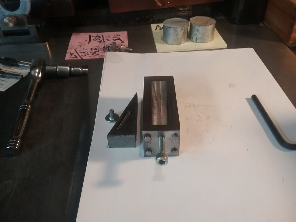

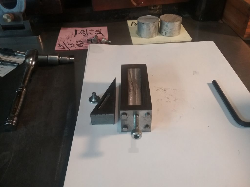

        Finished off a sliding jack saw on Doubleboost's (John Mills) channel on YT Mick 🇫🇴20200607_104716.jpg20200607_104717.jpg
        #478181
        Mick Henshall
          @mickhenshall99321
          Sorry the other pic that should havebeen on last post Mick 🇫🇴20200607_105303.jpg

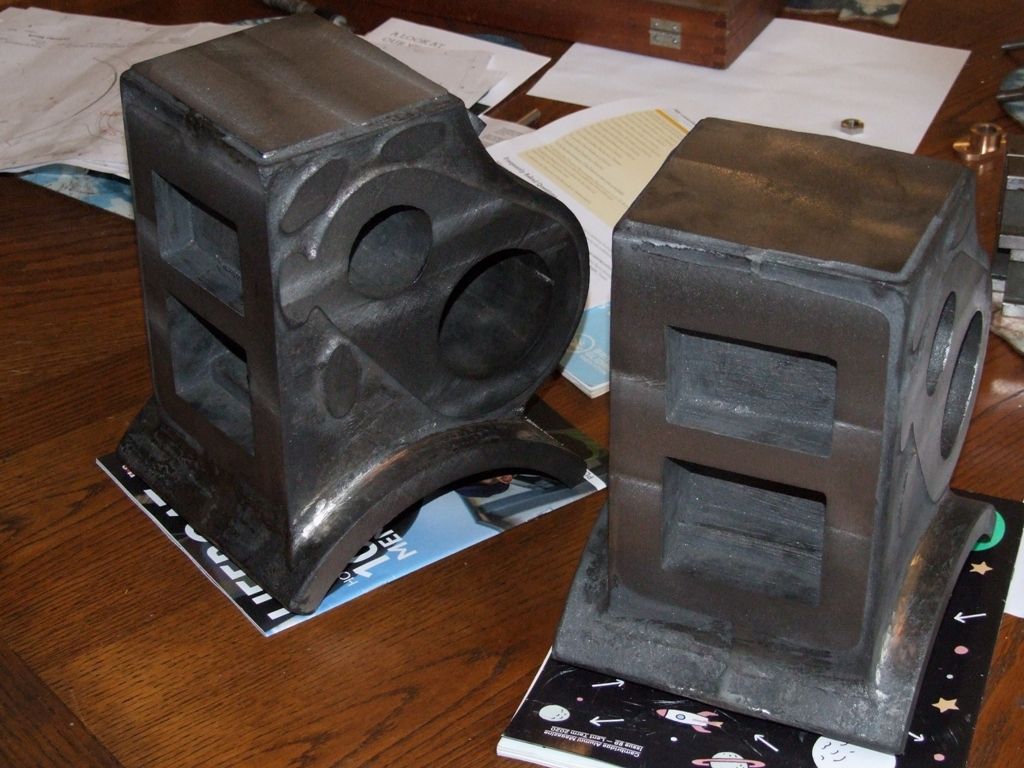

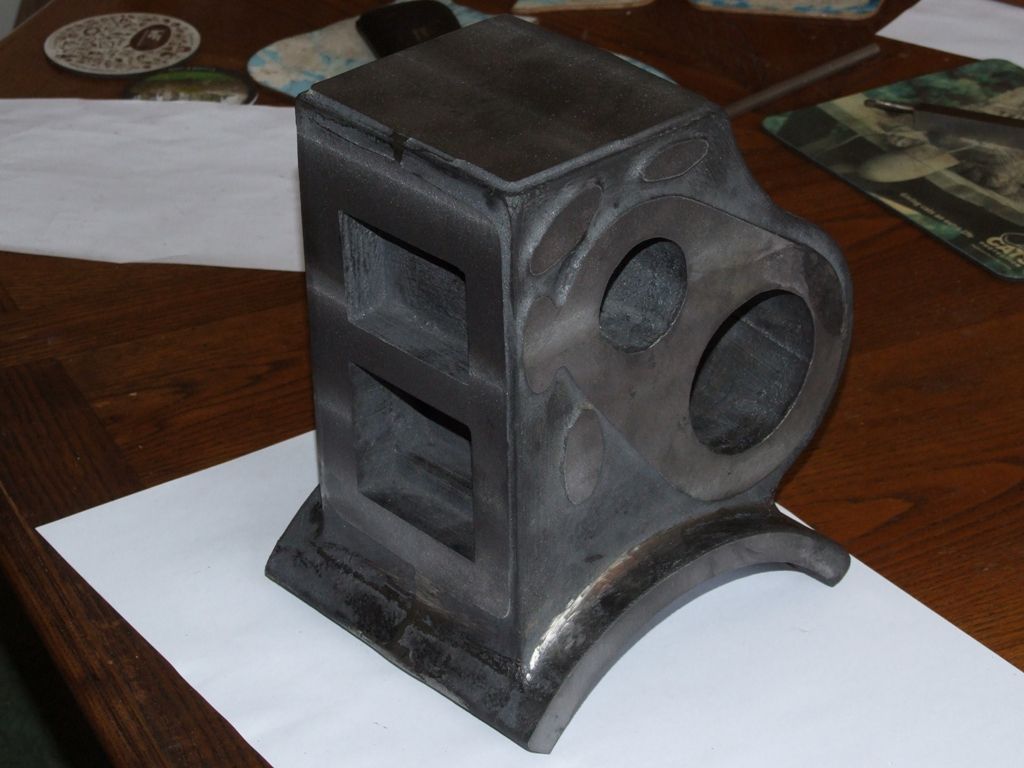

                  Today I've been doing the initial machining on one of my traction engine cylinder blocks. I have three sides, the top and the width of the flange done:
                  All machining has been done on the horizontal mill with an 80mm diameter insert cutter. Here's a typical set up:
                  The biggest cut was 2mm deep, full width, 420rpm and 420mm/min feed, not even a hint that the mill noticed it. I love it! And just to stir up the old versus new debate the horizontal mill cost me £175. smile
                  The iron casting machined beautifully, but was all over the place in terms of dimensions and squareness. At least I've ended up with all the sides and top square to each other and to dimension (in my CAD model) apart from the two faces parallel to the bores which are 15 thou under. The width of the parallel faces on the unmachined casting varied from 5 thou over nominal to 150 thou over, so somewhat on the skew. It's annoying to be a bit under, but it's not a problem in practice. Although I might tweak some of the port dimensions on the liners at a later stage.
                  The angle plates in the picture were indicated to be parallel to the Y-axis before using them. Just as well I checked, as setting them perpendicular to the front of the table with a set square meant they were many thou out. Since my horizontal mill is a universal (the table swivels for making helical cuts) I also indicated the table parallel to the column in X at the start.

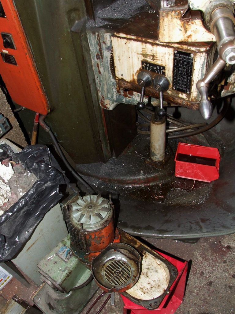

                      I decided to true up the second cylinder block. Having machined two surfaces square I started machining one of the faces perpendicular to the bores, with the casting slightly twisted to get the best alignment. I will true up the reference surface afterwards as there is still a lot of metal to remove from it. I was just starting the cuts with the second iteration of the twist when the power feed starting making intermittent noises. The immediate reaction was to ignore it. But if I do it'll only get worse, and there are no spares if something breaks. So I top up the gearbox from the motor to the feed gearbox – not much change. So next I fill up the feed gearbox, which due to poor design means I have to swivel the table (and lose my setup) to get to the filler. Do that and still not much change. The noise definitely sounds as if it is coming from the motor/gearbox. So take off the motor and gearbox combination:
                      A big gear on the feed gearbox input can just be seen to the left of the two levers that select the feedrate. It's a really messy job. Not only is the gearbox stripped, so was I as I don't want to get oil all over my decent shirt. On looking more closely I notice that the motor fan is loose as the bolt has unscrewed. The fan cover is removed and the fan is fixed. I ran the motor in this configuration and it "seemed" better. But annoyingly I damaged one of the rods holding the motor together. By the way the feed motor is 1hp.
                      The next tasks are to make a new rod, re-assemble the motor, refit the motor and gearbox and try it out. Then I might be able to get back to what I was doing.

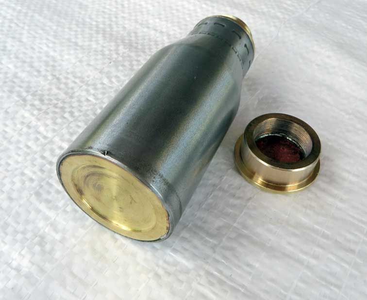

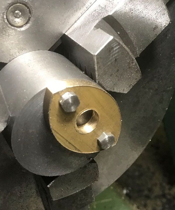

                        Hi All,

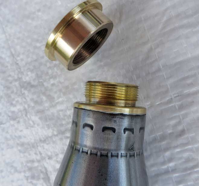

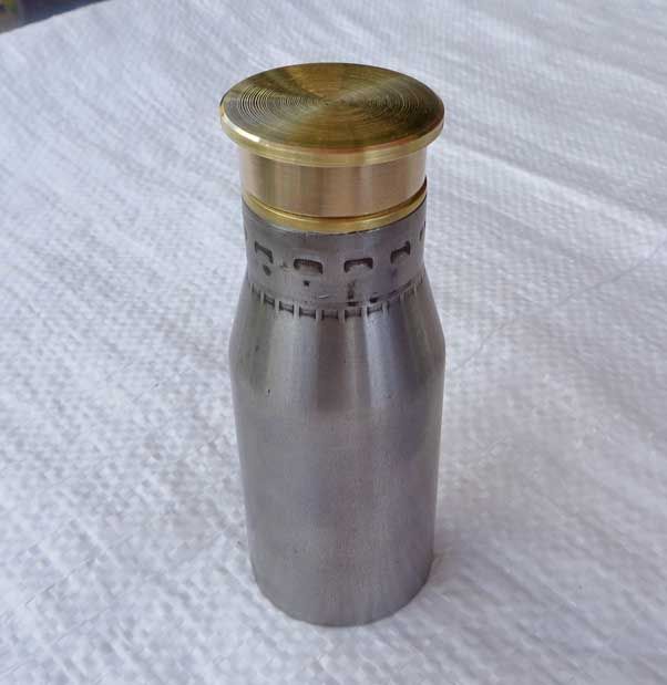

                        Completed the first of a few small flasks made from the top section on 30mm shell cases.
                        Good practice for my screw thread cutting, many thanks to Michael Gilligan for his help with that!
                        The interiors will be lined with a resin coating which has worked well on the shot "glasses" made from the bottom sections.
                        Quite a fun little job and good for ones confidence!
                        Cheers, Martin

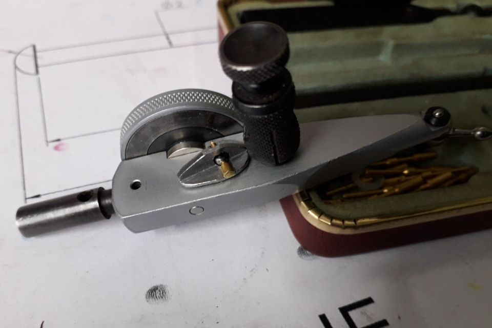

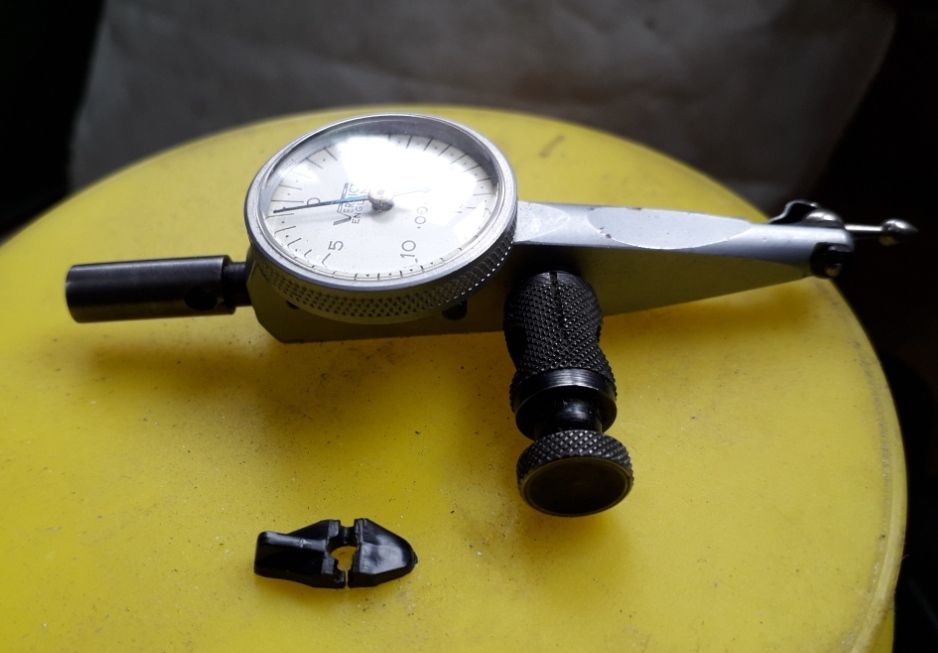

                            I picked a spares or repair Verdict finger type DTI up on fleabay, it cane yesterday and after a quick look it was apparent that the little lever that changes rotation of the indicator was broken. This horrible little thing was made of plastic and had split under the pin. I contacted Verdict and had a prompt response, £11.25 plus £5.00 P&P plus VAT a total of £19.50. It was stressed that the replacement was made of spring steel as the plastic ones degrade over time!
                            I thought that this was a bit steep, especially the P&P, so I grabbed a bit of gash steel and made one, in fact I made two because I was given another version of the Verdict finger gauge and that part was missing…
                            Just as I was putting the pin in for the last time it shot out of the pliers and went behind the lathe which is backed up against the wall so a small brass pin was fitted. Result – two working DTI's for a few hours in the shop.

                                  This afternoon I made a new tie rod for the feed motor on the horizontal mill. Fortunately I had a 3/16" BSF die to hand. This evening I reassembled the motor and gearbox. Fixing the motor fan may have cured the problem, although the feed seems a bit noiser than I remember. We'll find out tomorrow when I recommence machining the cylinder. Out of interest here's a picture of the internals of the feed gearbox:
                                  Seems logical; horizontal input shaft at the top and two sets of three gears to drive the lower shaft which then drives the vertical shaft via skew gears. That seems a bit odd as the drive must be transfered to the swivel point of the table to drive the leadscrew. It's many years since I've had the table off the mill so I can't remember the details.

                                        After the interregnum caused by the horizontal mill feed gearbox 'noise' both cylinders now have four faces machined square and to consistent dimensions, plus the sides of the flange have been cleaned up:
                                        It's now over to the vertical mill (and DRO) to machine one more reference surface and then start machining cutouts, bores and tapped holes for studs.
                                        It turned out that the loose motor cooling fan was the cause of the gearbox 'noise'. That's a relief in one sense, as it was an easy no cost fix. But if I'd known that from the start I wouldn't have needed to dismantle everything. I could have got to the fan simply by removing the sheet metal cover round the motor.

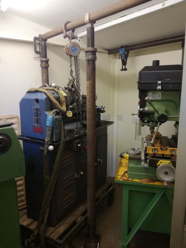

                                                      Hi, it was last week I decided that there was too much wasted space around my Major milling machine, so I set about making a special trolley that could be bolted together, to lift the mill with its stand and move it to a suitable new space. I used as much old bits and pieces of steel as I could find, as I didn't want to used new stuff that would only probably be used once, On Thursday last, my trolley was ready and was set up around and under the stand so it could be lifted to put the castors on, wooden bearers were put under the stand and trolley as a safety precaution while bolting on the castors.
                                                      It was then moved by a bit of manoeuvring forwards and backward using two swivelling castors at the front. Today my trolley was reconfigured without the castors or the side tie bars, so that the weight could be just taken off the feet, to allow a bit of sliding movement to get it into a position where I could get maximum X travel without the handles hitting adjacent walls while the table was at the closest position to the column.
                                                      Next job was to lift out my Boxford onto a different trolley and move it into the same room as the mill and my Warco lathe, which needed a bit of joggling and lifting just off the trolley, to enable the trolley to be realigned to the doorway and both the other two machines.
                                                      The Boxford is now ready to be put into its final position on Monday. In hindsight though, I should have mitred the front two corners of the tray under the milling machine, which would give me about 40/50mm more clearance between that and the Boxford when it's in position, but I may still do that or even both corners by hacksawing them off and bolting and sealing a bridge piece on.
