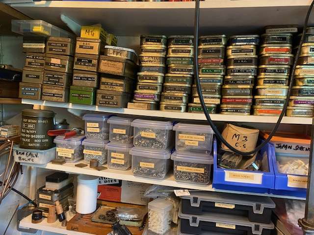

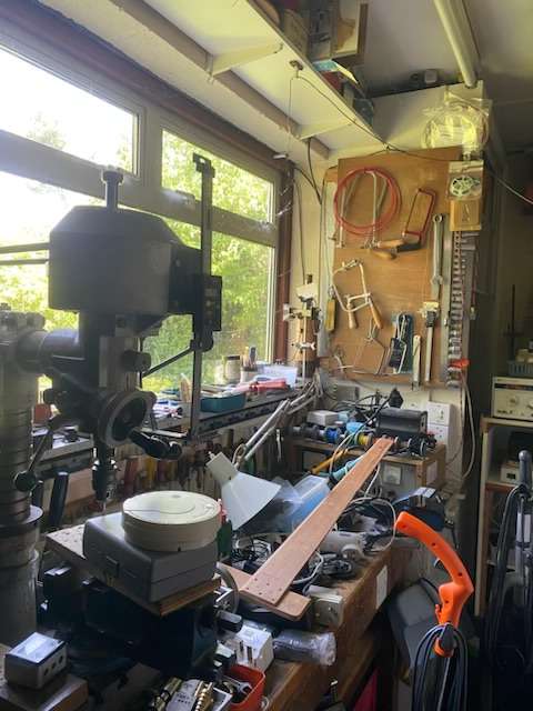

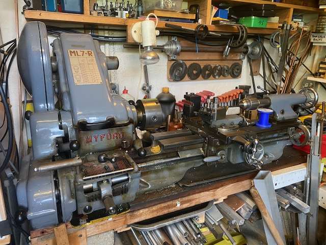

      Hi, I really need some advice please!
      My dad has sadly departed and I have his treasured workshop to clear. There is a huge amount of stuff in it including a Myford lathe. I don’t know where to start!
      He was a keen model engineer, amateur radio and electronics enthusiast.
      Im realistic but any advice please so I can avoid being totally ripped off!
      Many thanks in advance!
      Near High Wycombe if anyone is interested!

            IMG_3687

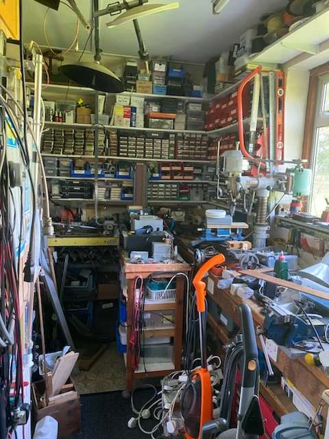

              IMG_3635IMG_3641

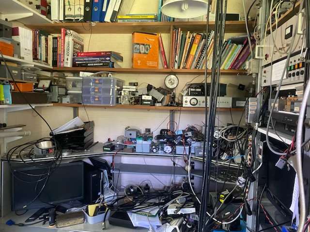

                IMG_3689IMG_3690IMG_3688

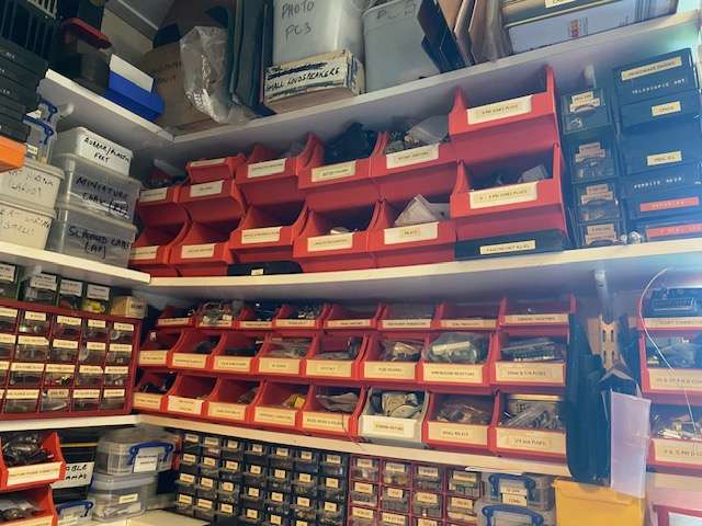

                  IMG_3644IMG_3642IMG_3641

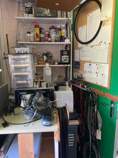

                    And there is probably more in the garage. Loads of cable etc

                            The Myford lathe should sell easily, here is one on Ebay here
                            the milling machine is a Dore Westbury. There are 3 on ebay with asking price a lot more than I would be prepared to give DoreW
                            The belt sander might fetch a bit, but we can’t see the details. I’d advertise them on the classifieds on this forum and/or https://homeworkshop.org.uk/
                            Last resort is a dealer, but they have to make a profit and so will offer much less than going rate.
                            Unless you’re prepared to do a lot of sorting and multiple small ads/ebay listings the myriad tins of nuts bolts etc are pretty much worthless, as are many hand tools. There is a model engineering club in High Wycombe https://www.hwmec.co.uk/, they might help, but most model engineers are already well set up and have enough surplus valuable stuff.
                            Can’t comment on the radio/electronic stuff

                              I’m afraid I agree with Duncan.  However there are probably some items that should be associated with the lathe and the milling machine such as chucks of various sorts and machine vices for which it would be worth trying to find someone local to help you identify.
                              With a bit of luck someone local to High Wycombe will read this and come to your aid.

                                          A list of the nuts and bolt sizes would be very advantagous..
                                          Forgot and iron,copper and brass rivets
                                          I will start off at 10.00 for the lot, as the dealers and shysters say, not much call nowadays, doing you a favour taking them off your hands etc….lol
                                          Seriously
                                          Cannot have too many i say  esp BA from 4 to 12 in in different lengths
                                          Worth looking at a site like EKP for an idea on current costs and start at 50% of their price ( or am i being a bit heavy on that?)
                                          And i love the baccy tin filing,  mine have lost all the lids over the years .

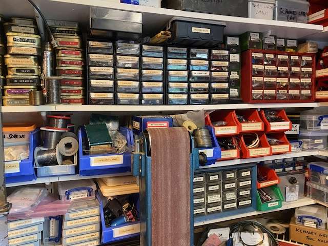

                                                  <p style=”text-align: left;”>Ron, anything you see that takes your fancy, let me know, I can box up and post!
                                                  Les, good shout on the Model Engineering club, I’ll see if he was a member.
                                                  I also have some aerials going cheap if anyone is interested……? No? 🙂IMG_3896</p>
                                                  #856374
                                                  ksw
                                                    @ksw
                                                    Ron, I can get close ups of the tins if you like? One saving Grace is that dad labelled everything!
