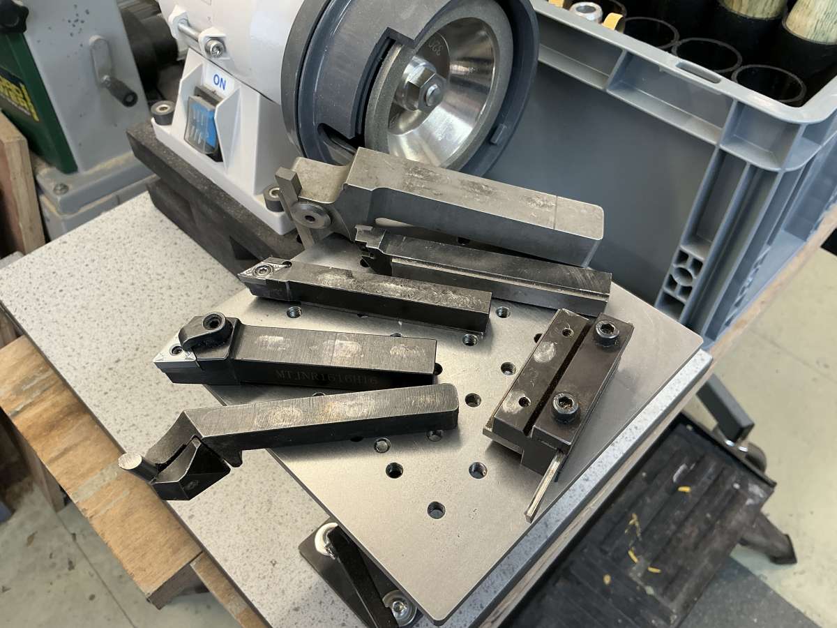

            These tools cater for about 95% of the stuff I do. Two Tangential Tools, one bought, one home made. Two carbide insert tools in 12mm holders, both with 2mm gauge plate glued to the underside. A 16mm shank TNMG tool which I trimmed down by 2mm to fit my four way. And a parting tool onto which I bolted a piece of gauge plate to bring that up to centre height.
            I also have a boring tool somewhere also set to centre height.
            IMG_2258
            One of the whole points of Carbide inserts is that fitted to the correct toolholder, on a suitable lathe, you never need to bother about height setting.
            Not my words but someone else: “The problem with a QCTP is that once a tool is fitted to a holder you’re loathe to remove it for another one”. As a result you quickly end up investing in lots of tool holders, many of which don’t get used very often”.
            If of course you grind a lot of custom HSS tools then I can see the justification, particularly if you’re a professional and every second counts.

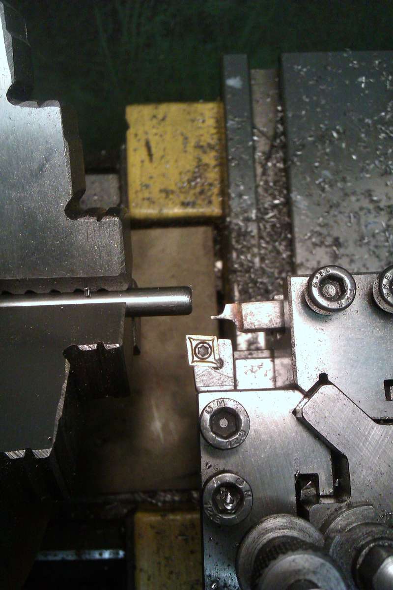

                  Depending on the QCTP you can also have two or three holders mounted so it is possible to rotate the post to change tools.
                  If the job suits the way two holders leave a “cut out” where they meet you can have two tools set to work on the same part, quicker as you do not need to rotate the toolpost, quicker as you don’t need to change holeders and quicker as you don’t have to wind the cross slide a long way to bring the rear mounted parting tool into position.
                  Set up here to do two ops in one, face and profile.
