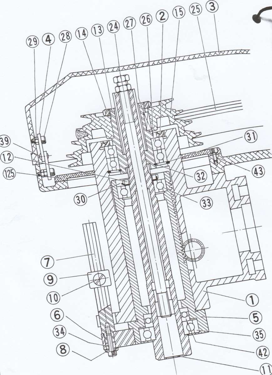

                            Well, the spindle is back in the quill… though I am not convinced it’s quite as it was.
                            The quill, all nicely cleaned up, Brasso-“lapped” to fit, and regreased, is back in the machine.
                            Return spring set to give slight “positive bouyancy.”
                            I’ve to refit the depth-stop and quill-lock, and will use washers to set the lock’s handle so it does not keep acting like a ratchet against the depth-stop.
                            Then it’s a matter of cleaning down and re-tramming the head.
                            I’d assumed it would all go back together is it came apart, but it hasn’t quite and I fail to see how.
                            The bottom radial bearing is a force-fit on the spindle, with its inner race located against a shoulder.
                            The outer race of said bearing is a fairly tight fit in the cylindrical quill, and locates against a step. Or at least, that’s what’s happened but I thought it was flush with the end of the quill.
                            Only, it can’t be because the top of the spindle, below the splines, is threaded for a ring-nut to retain it axially. If the lower bearing is flush with the quill, that thread is hidden inside the top bearing, which is also pushed down to a shoulder inside the quill.
                            It is these shoulders, clear on the drawing, that made me think it would all re-assemble as it was.
                            Yet the ring-nut, with tab-washer below it, is barely hanging on by a single turn of thread! I’m sure it was fully engaged previously, but there is nothing to account for this discrepancy.
                            Then we might ask, what of the thrust-bearing, sandwiched between the lower radial bearing and yet another step inside the quill. Since the main bearings are so tight on spindle and housing the spindle cannot move axially; therefore the unfortunate thrust-bearing is either under potentially huge compression or does nothing, set purely by the bearings and steps.
                            Despite that ring-nut and its elaborate tab-washer made to give a sort of angular Vernier spacing, there is no thrust-bearing adjustment. Or if there is, I have no way of setting it, nor know how and to what level.
                            Anyway, it’s all back together, quill sliding freely, new locating-pin for the tooling…
                            With any luck it’ll give me another decade or so of service!
                            So thankyou all Gentlemen for the advice and suggestions. Even where your sources were for rather better-designed machines, they did point me in the right directions.

                              I am concerned that you do not have a full engagement with the Ring Nut. Something is definitely awry.
                              The Thrust race tracks are as you describe. The one Track which should be a nice close sliding fit on the Spindle is smaller on the Outside diameter as this rotates with the Spindle and should have no contact with the inside of the Quill. The Other Track should be the opposite way around, in that the outer edge is in contact with the Quill but the inner surface free of the rotating Spindle.
                              Are sure these, and all the other bearings are assembled correctly?
                              The lack of proper thread engagement with the Ring nut is potentially an accident waiting to happen. There should be from memory be at least two threads showing above the Ring nut.
                              Regards
                              Gray,

                                I have found the VMC Spindle Assy drawing. It shows the Main Radial Bearing (35) below the Quill face. If the Ring nut is not fully engaging then I would expect that either this bearing is proud of the Quill or that the upper Bearing (33) is not fully seated.
                                Myford VMC Spindle assembly
                                Regards
                                Gray

                                    Yes, perhaps something is awry and I had guessed one bearing is not fully in; but that doesn’t seem so. In fact it is impossible to determine just what is wrong.
                                    The top bearing moved towards the surface as I pushed the lower bearings home. I gently eased that back down by tapping all round the outer race with a brass drift; but if all the bearings are fully home the upper end of the spindle should be exposed by more than it is. So maybe they are not fully home; but nothing I did would make them go any further so we have to assume they are.
                                    The ring-nut is as tight as it would go using a crude face-type peg-spanner I’d had to hacksaw and file from a slice of scaffold tube. (If I had a milling-machine I could make one properly). So it’s obviously found nothing to compress. I’d have been better leaving that thick tab-washer off and putting a spot of non-hardening locking glue on the thread. It would have won another turn or two.
                                    There is nowhere for the bearings to go except hard against internal ledges, and the bottom radial bearing is hard against the thrust-bearing as well, according to the drawing. There is no fancy thrust-load adjustment or anything like that – this isn’t a Drummond lathe!
                                    Said drawing also shows the thrust-bearing can be either way, as the stack relies on heights and depths, and both of its races are an easy sliding, almost loose, fit on the spindle. It is symmetrical.
                                    The problem with this assembly is that if you do put it together wrongly (how?) it is impossible to diagnose, let alone correct, without pulling it all apart again, wrecking the nice new bearing in the process.
                                    You can not withdraw any of the bearings while the spindle is still in the quill, but you can not remove the spindle without a massive load concentrated on the poor bearing’s inner race in forcing that out of the quill at one with the spindle.
                                    Then the bearing is an extremely tight fit on the spindle, and I had to use a plumber’s pipe-freezing kit on the shaft to give a tiny bit of help to remove it. Even then it yielded only to a hefty great mallet to ram the spindle down through it, with the bearing’s outer shell supported. You can’t use a puller, nor support the inner race, for that.
                                    I think that despite the fancy parts diagram this machine was never designed to be overhauled. Making it repairable would have increased the complexity, hence cost; and its Taiwanese factory would far rather sell a new machine than just a bearing. Myford does not even try to sell milling-machines any more. Nor does it repair any of its products.

                                              The 1/4″ movement equates roughly to the thickness of the adjusting Ring-nut. From what has happened I would say the Ring nut is now sitting proud of the Top bearing, (33), or this bearing is now sitting higher than it should be, under the Ring-nut.
                                              This bearing ideally wants to be a “sliding”, or “hand push fit” on the spindle. Having this bearing a press-fit here makes the adjustment of the Spindle end-play very difficult.
                                              No doubt when you tapped bearing 33 into the housing you tapped the bottom bearing out, because this bearing is tight on the Spindle
                                              The reasoning behind having this bearing such that it can slide,
                                              Suppose the bearing assembly is overtightened in an attempt to reduce end-float. The Ring-nut is then backed off slightly to ease the adjustment, but nothing happens because the bearing is a press-fit on the shaft, and it just sits there. In use this bearing will move, and what was a previously well adjusted Spindle, now becomes a problem.
                                              I have always eased the journals of the Far-Easter machines with Crocus paper or similar. The problem is the original bearings are very slightly larger in the bore than Branded bearings like SKF, FAG, or Koyo. Thus what may have been a sliding-fit from the manufacturer with the old bearing, this is now a press-fit with the better quality bearing.
                                              I hope these notes help?
                                              Regards
                                              Gray,

                                                That seemed to be what was happening. Pushing one bearing in pushes the other out!
                                                The lower bearing is a force-fit on the spindle, not in the quill, and hard against a shoulder on the spindle. So the spindle can only drift one way, downwards. Unfortunately, once on, I don’t think its possible to remove it without damage thanks to the shaft shoulder barring access to a puller… which would need be one with very long legs.
                                                The “original” bearing is by SKF, my replacement by FAG (Portuguese). The Parts List says “6207ZZ” – but not who makes it. I take it this is a trade-standard description because the FAG packet (!) says “6207-C-2Z”. I wonder if the bearing I replaced was itself a replacement by a previous owner.
                                                If I end up having to replace my replacement I’ll follow your suggestion to very lightly reduce the journal by crocus paper. I do wonder if the force fit will have tightened the balls against the side walls.
                                                It does look as if I’ll have to remove the pinion-shaft and the quill, with spindle, again to find what’s happening.
                                                I’m afraid a collet-chuck spanner won’t work here. At least, the flat one for my ER32 set won’t. The nut is just inside the quill so needs a spanner with axial rather than radial “teeth”. Hence my carving one out of a bit of scaffold tube: I could probably create a better one using the BCA jig-borer in not much more time!
                                                I wondered if the poor SKF unit is still serviceable after all this abuse. Gently manipulating it by fingers it seemed smooth enough, but doing so while holding it near one ear, I could hear a slight ticking noise as it turns. A pitted or chipped track?

                                                    Hi Nigel,
                                                    I don’t think any damage will have been done to the Main bearing No 35, or the top bearing No 33. There should be no need to remove the Main bearing No 35. The Top bearing No 33 is the only bearing you need to have a sliding fit on the Spindle.
                                                    The likelihood that you will need to replace the No 35 bearing again is very small, but if you do then the Crocus paper is the way to go. As this will make putting it together, and getting it apart in the future so much easier.
                                                    Grease in a new bearing can often give the impression that the bearing is clicking. Rotating the bearing in the lathe on a stub mandrel and a screwdriver on the outside diameter with the handle to your ear, will soon tell you if it is damaged. (You will need to hold the outer track stationary with your free hand).
                                                    I would also suggest Slideway oil on the Quill diameter, with grease in the rack portion.
                                                    Regards
                                                    Gray,

                                                      Making progress…
                                                      The spindle was far too tight in both bearings.
                                                      I can’t do much about the lower one but have just been honing the top journal down using very fine abrasives until it is a light push-fit in its bearing. I did this with it rotating between the chuck and a running centre in the tailstock, stopping at intervals to try its fit.
                                                      I’ve left both components in the cool of the workshop and will test the fit again before putting it all back together. The bearing did leave slight witness marks on the shaft even with that gentle push-fit, but it gave the impression of the journal not being truly cylindrical, so what might be a push-fit here might be slack there. Hard to tell as I don’t have sub-thou’ level measurement tools.
                                                      The clicking bearing was the old one.
