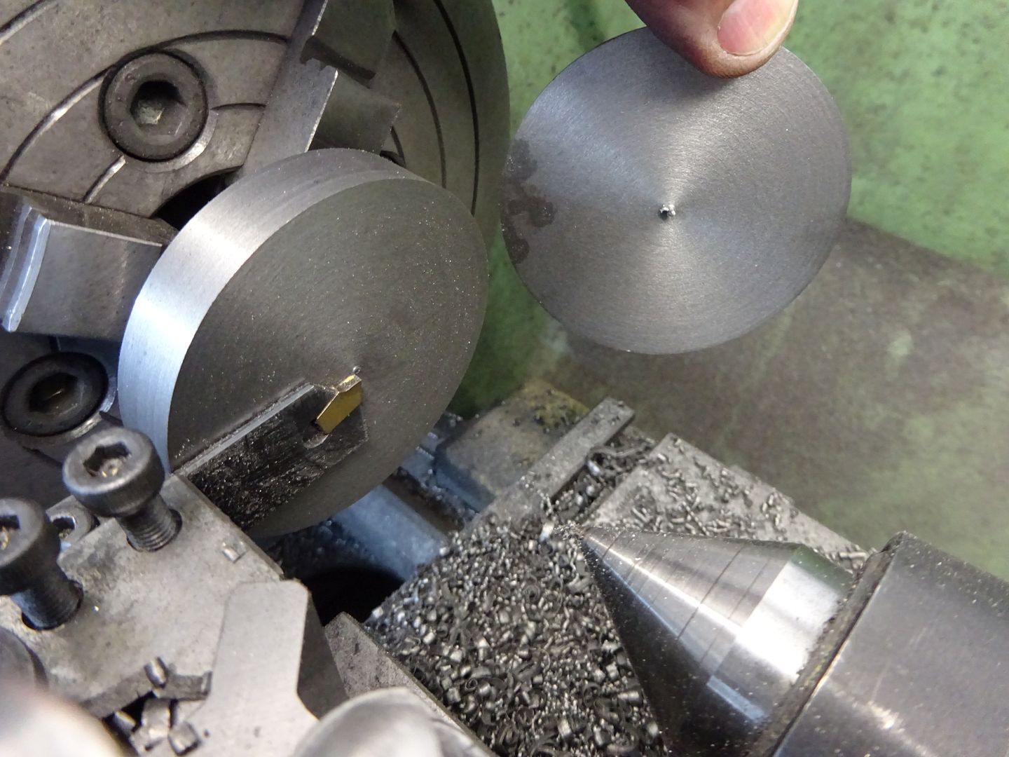

                                                    #856646
                                                    Roderick Jenkins
                                                      @roderickjenkins93242
                                                      On JA Said:
                                                      One further question. Can carbide inserts take an intermittent cut such as turning a square bar or fly cutting?
                                                      JA
                                                      3/8″ thick steel with CCGT 060204
                                                      h69
                                                      Rod
