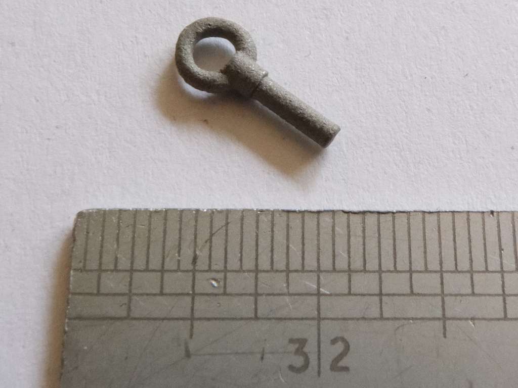

      The tension spring on the reversing levers on my traction engines goes from an eyelet on the tongue to the reversing lever, rather than the more common extended pin on the operating lever to the reversing lever.
      The use of an eyelet is prototypical Burrell according to Gilbert, so I wanted to replicate same. Designing an eyelet in 3D CAD was simple. But I could see making them being rather fiddly. So I decided to get them 3D printed in stainless steel. If nothing else this would be in the nature of an experiment to see how a fairly small part would turn out. The answer was surprisingly well:
      Eyelet
      I went with PCBWay as craftcloud3d use external printing companies and the prices are now astronomic. I only needed two eyelets but bought ten. Total cost was $60 of which half was shipping. I was charged £45 on my credit card which is not far off the normal exchange rate. Delivery was eight days.
      The shank is a few thou undersize which means I will have to rethink my means of attaching the eyelets to the tongue. I was going to use a 10BA thread, but don’t really want to buy 11BA taps and dies as I can’t see myself ever using them again. Since I have spare eyelets I can afford to experiment with a few ideas.
      Julie

                  The shank as printed is a shade under 1.5mm, which is not a standard metric size although taps and dies are available at a price.
                  The force from the tension spring is at right angles to the shank so, in theory, a thread is not needed. I am going to experiment with Loctiting the shank in place, or just hammering over the end of the shank into a small chamfer. As designed the shank is a little longer than needed specifically so that was available as an option.

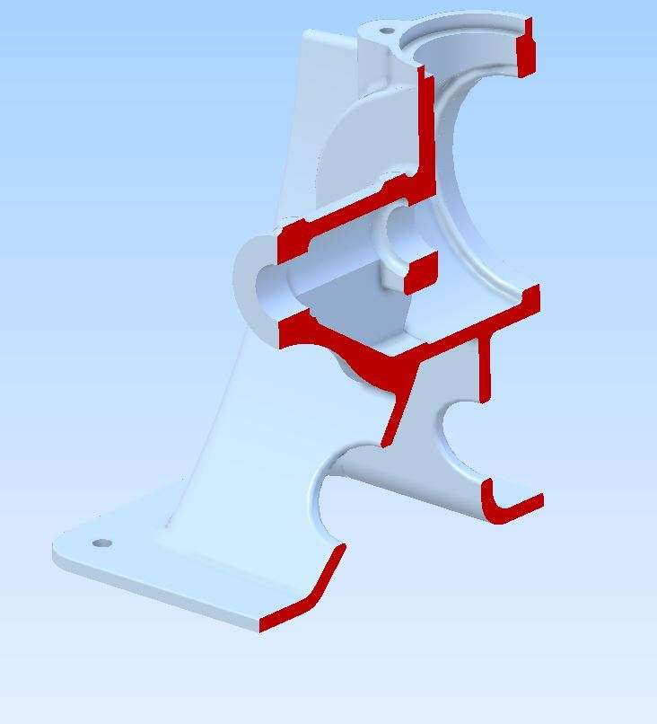

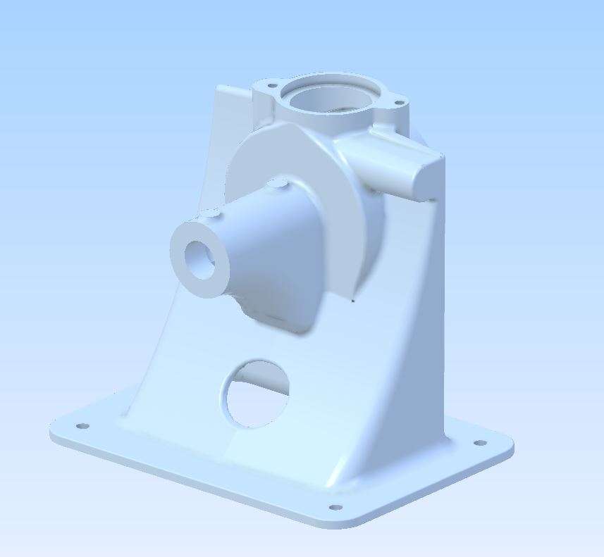

                      This is likely to be the next one I get printed, 120mm high. I will also need a cylinder head which I will get prices for as a separate item and also attached at the top on a couple of posts. Originally I drew it with the intension to do it on the CNC with the base flange separate and not much in the way of internal cavities. Now with 3D printing I can get it all as one, complex cavities and every cavity added reduces the cost as it needs less powder.
                      creamy section 3d
                      Creamy 3D
                      106
                      I had intended to do the flat fin cylinder that can be seen in the background of the photo above. But maybe I should also go with this version as it would be easy with a 3D print?
                      24

                        #861870
                        Julie Ann
                          @julieann

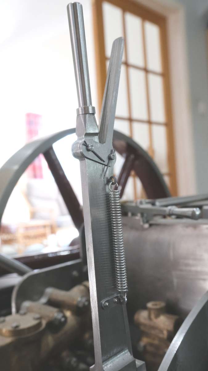

                          Just to round off this thread here is a picture of the finished reversing lever, and tension spring, with the eyelet at the top:
                          Reversing Lever - Eyelet and Spring
                          The eyelet shank was threaded 11BA and all worked well.
                          Once again thanks to Frank for sending the 11BA taps and die.
