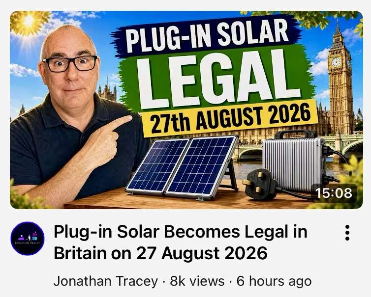

                            John Haine
                              @johnhaine32865
                              They generate an alternating voltage in phase with the main supply and at a slightly higher voltage.  They don’t supply *any* power at all until a current is drawn and then only supply the maximum of which they are capable.  It’s not as if any excess power has nowhere to go! Your question is like asking where the excess power from a battery goes.
                              #857844
                              Robert Atkinson 2
                                @robertatkinson2
                                The intent is that all the power from a plug-in solar system is used by the household it is installed in, not exported to the grid. Practice may be different.
                                John is not quite right. The micro-inverters are constant power devices. They will increase their output voltage (within limits) until all the power supplied by the solar cells is injected into the house wiring up to a maximum of 800W.
                                If the solar cells are producing 500W and there is more than 500W being consumed by the household (TV, fridge, everything else) all the power will be used in the house and you will use 500W less from your supplier. and not be charged for it. If the household load is 100W then 400W will go to the electricity network and you will not be charged for the 100W you are using. You don’t get anything for the 400W going to the grid but the supplier will charge someone else for it.
                                If you considered to houses sharing a long supply cable to the nearest transformer if the second house had no solar and a > 400W load they would use all the excess from the first’s solar and be charged by the electricity company for it…
                                Robert.

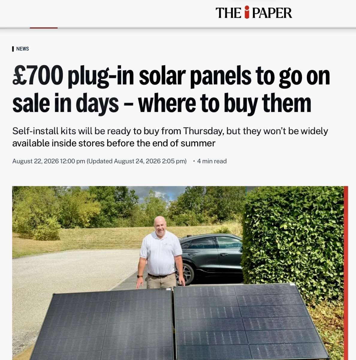

                                            Adrian R2
                                              @adrianr2
                                              Enthusiasts only at that price, they were supposed to be £400 or less based on comparisons to European offerings.
                                              #862177
                                              bernard towers
                                                @bernardtowers37738
                                                It made it on to mainstream tv yesterday and they were quoting £400!!!!!!
