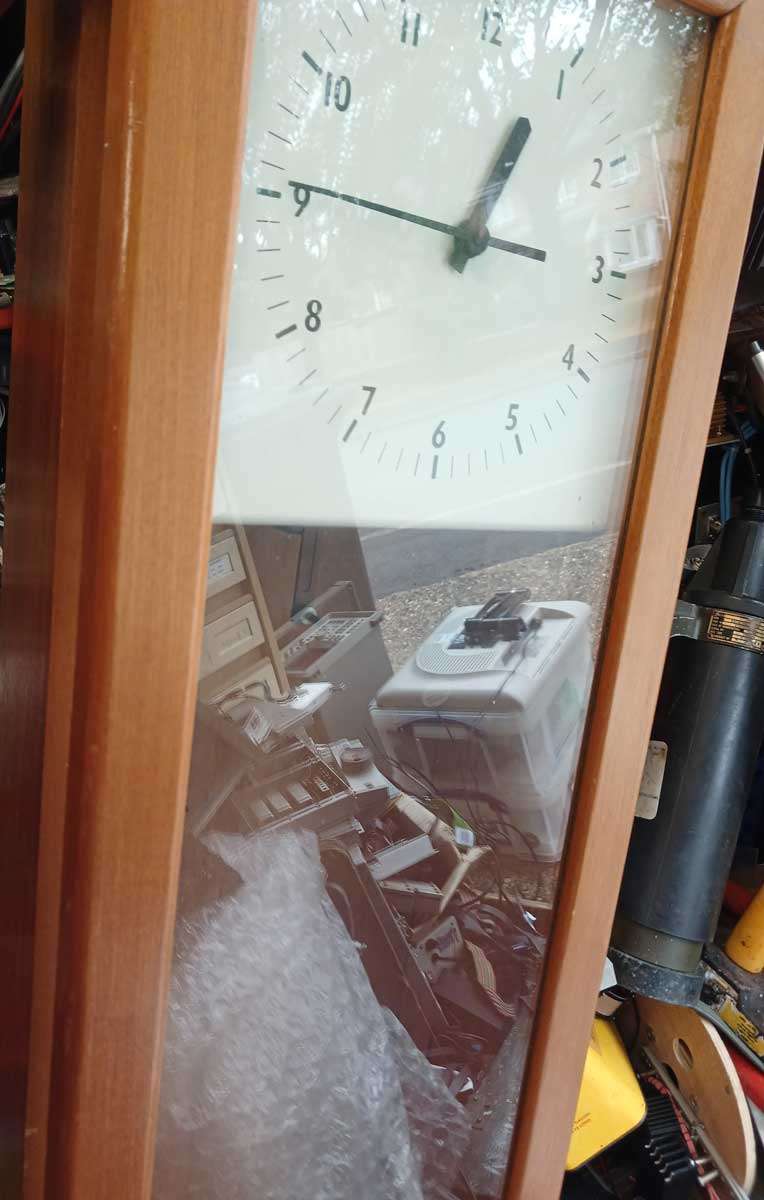

      I’ve always fancied a electromechanical Master Clock system. When a member of an electronics forum offered a Gents master clock and two slaves free for collection I was interested. Unfortunately collection was a 3 hour drive away. However, it was only a short distance from a family member who was coming to visit me about a week later. So I asked if they would pick up a couple clocks for me. They said yes. Seems I forgot to tell them one was five foot long! In my defence I hadn’t actually asked what the clocks were. Turns out to be a later mode C7 with integral slave and a couple mid-sized slaves.

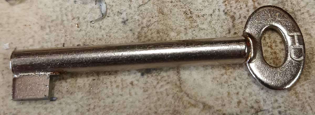

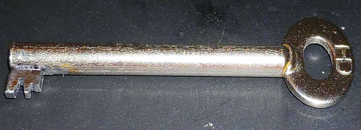

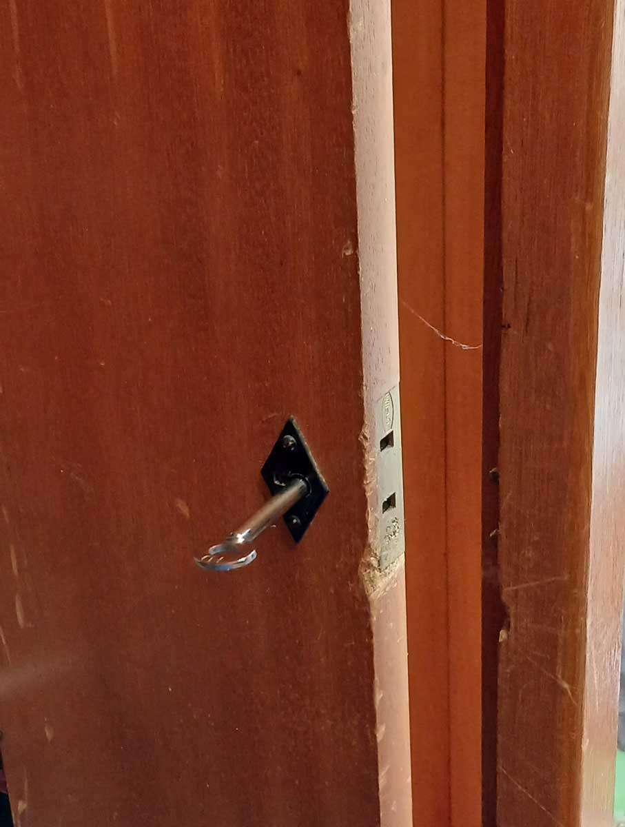

      First issue was while the pendulum had been removed to prevent damage, the case was locked and there was no key. Someone had slightly damaged the wood trying to force it. Thus a bit of locksmithing was in order. Lock appeared to be a high quality cabinet lock with claw keeper and pipe (tubular shaft) key. Having made a few measurements of the slot I visited the local Timpsons to buy a blank. They actually gave me a blank free of charge and said come back and pay for it if you can make it work. The bit on the blank was much too large So reduced that on the mill so it would go in and turn. Then blued it up, turned in the lock and then hand filed according to the witness marks. One more blue and file and it unlocked. Not pretty but it works.

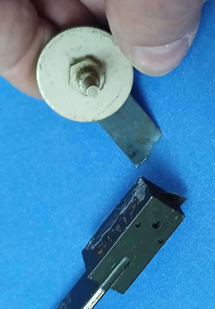

              Already joined the I.O. group. Further investigation of the parts shows the pendulum suspension spring is broken. Fortunately all the bits are there and the dimensions of the spring strip are available. I now need to get a bit of 15 thou thick, or more likely 0.4mm spring steel. As usual I’ll likely have to buy far more material than I need.

                    One material that is sometime suggested for use as suspension springs is feeler gauges. However a set costs more than a big bit of stock. Additionally I would not particularly trust the material quality of some modern gauges.
                    While looking for suitable material I came across a seller on ebay with new old stock Peter stubs feeler gauge shim stock. They had the right thickness and width and 300mm length. Cost was a bargain £4.99 including postage in a plastic tube. So a length has been ordered.

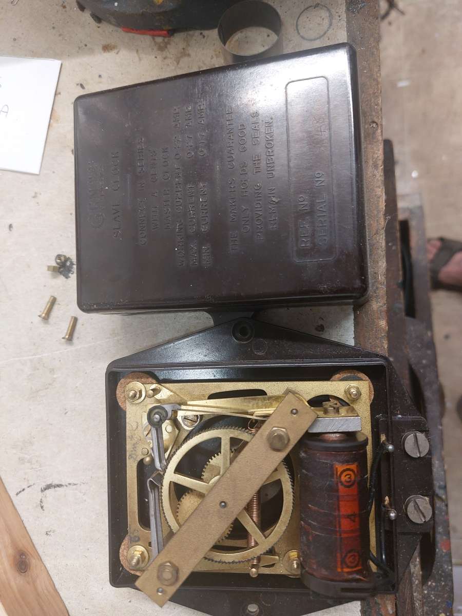

                      I’ll probably clast some icons by saying this, but they seem much better engineered than Synchronomes, the suspension is a lot more rigid. I was given this slave mechanism some time ago, probably will never use it, so if you want it it’s yours for the cost of postage.1000014889

                        I use 0.1mm beryllium copper shim for suspension springs – I have enough of the stuff for the worldwide horological construction community supplied as a free sample a few years ago, happy to send small amounts.
