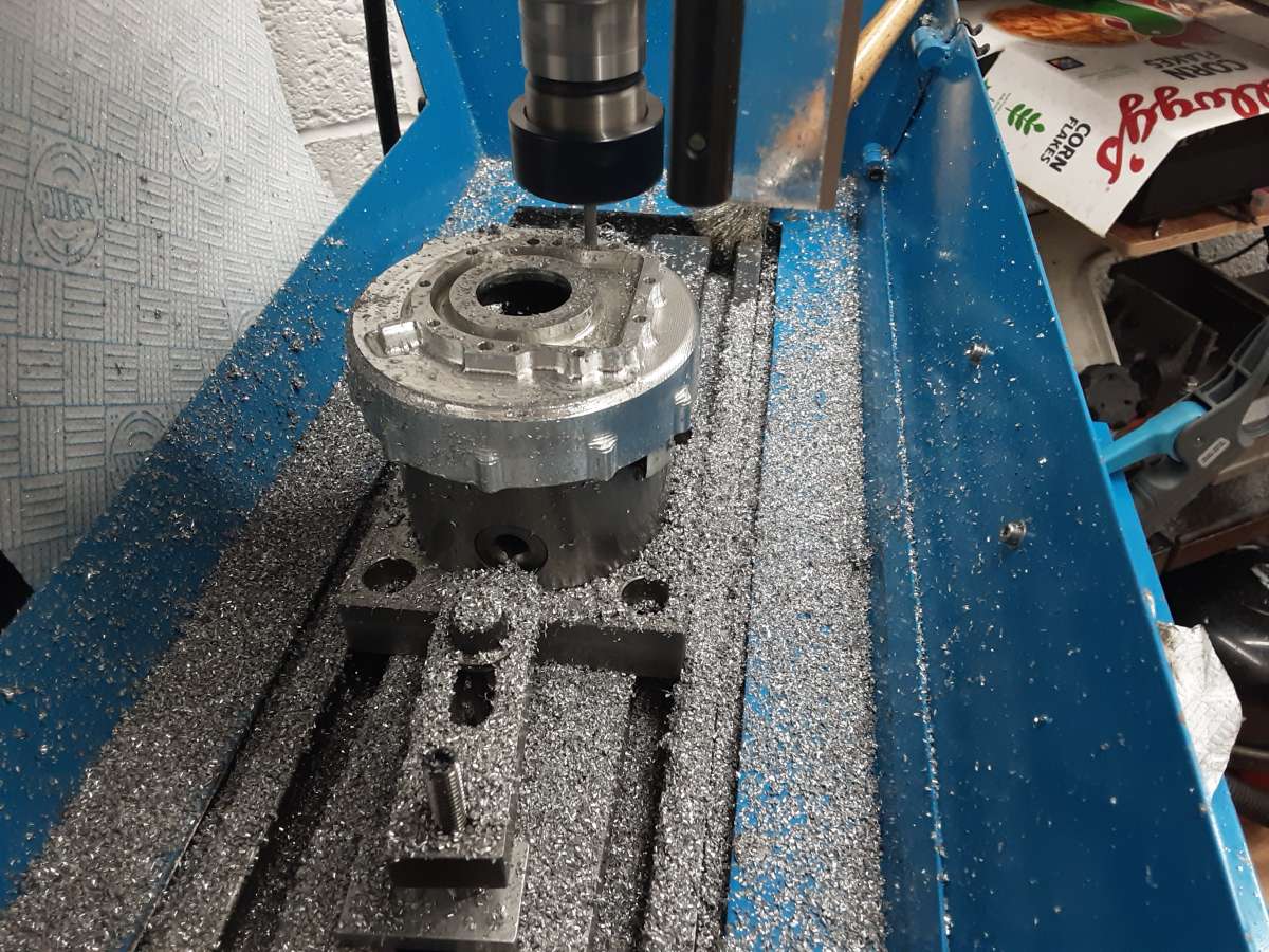

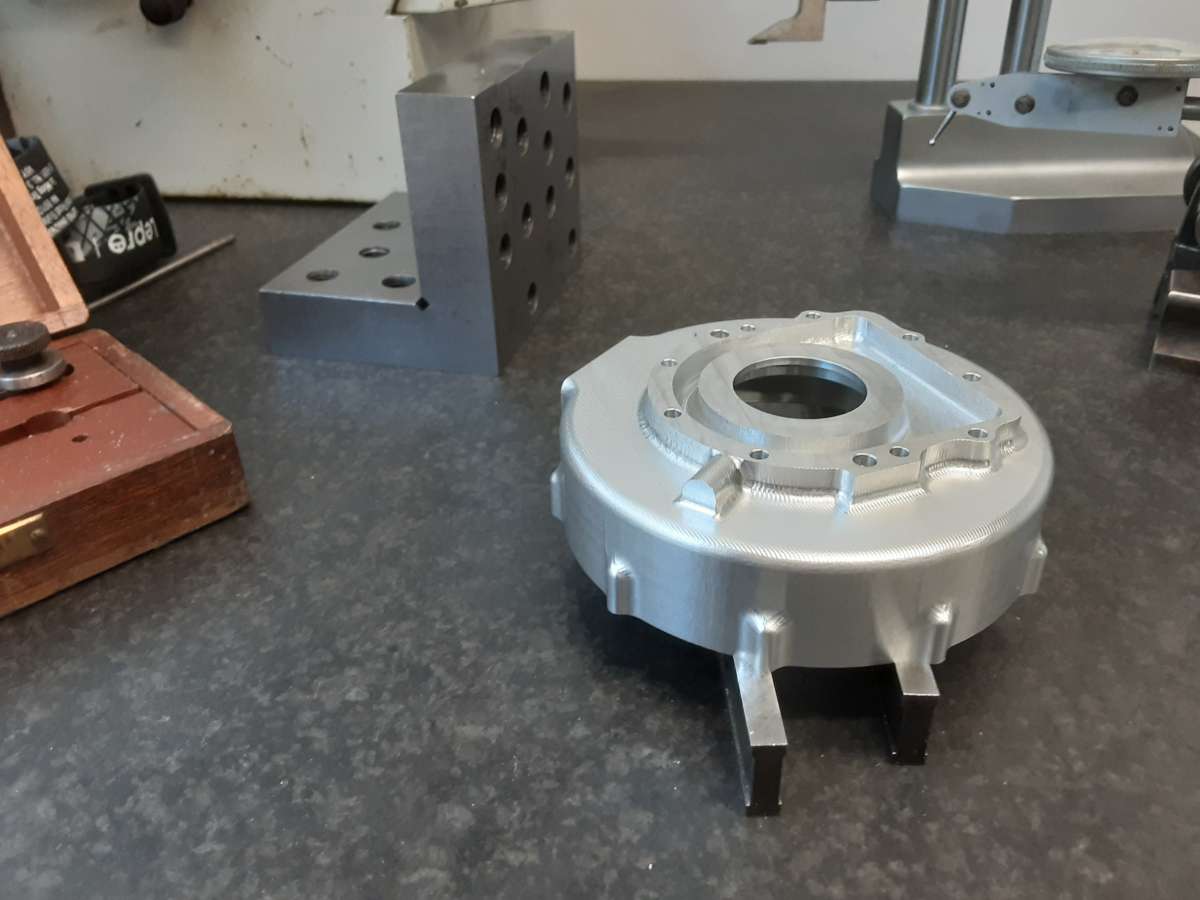

      SteveP

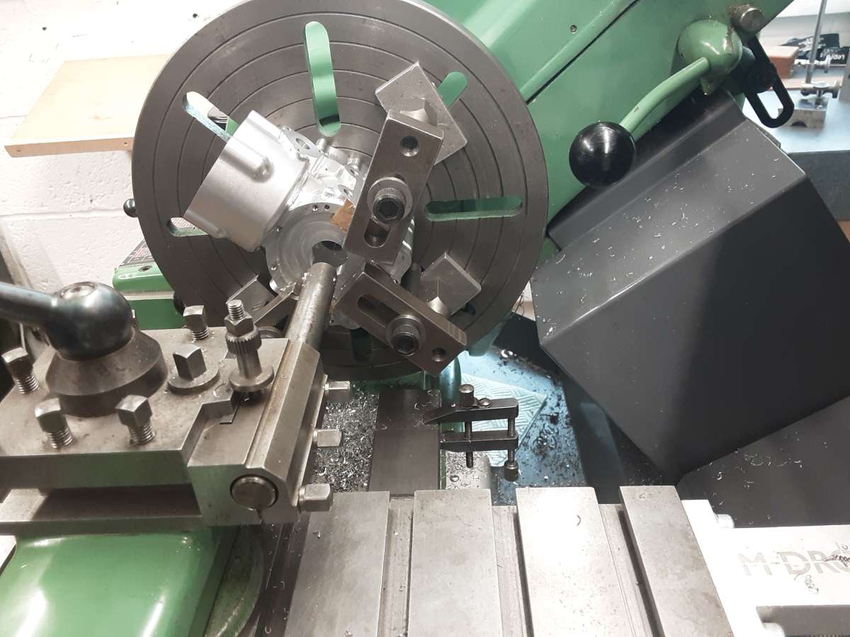

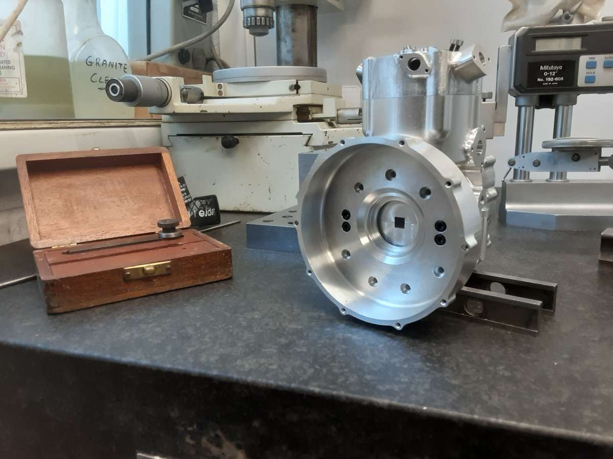

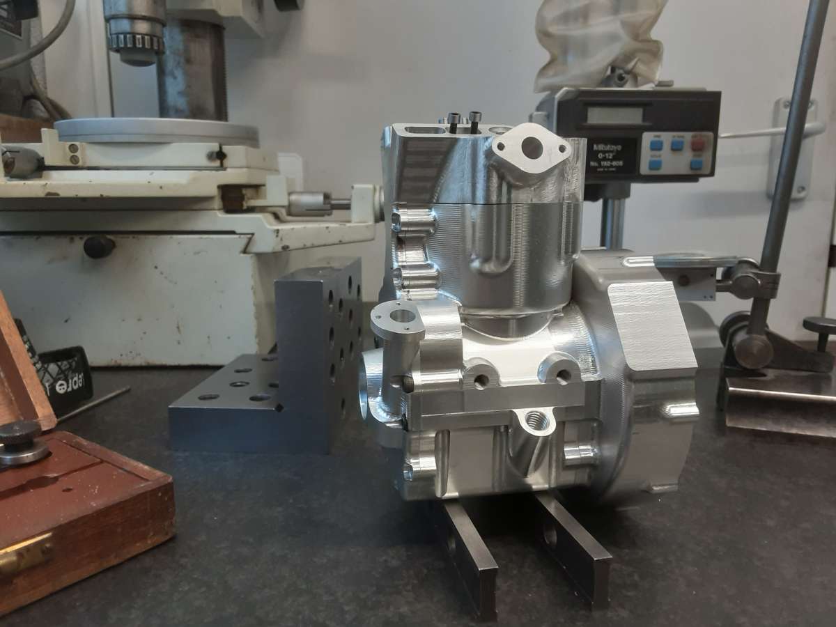

        @stevepye68246
        Another part nearly finished, the Flywheel housing. 20260716_18000920260716_17561420260716_15374620260716_17554820260716_175521
        I’ve now completed  most of the larger structural parts, now time to start on the the moving parts.
        Steve

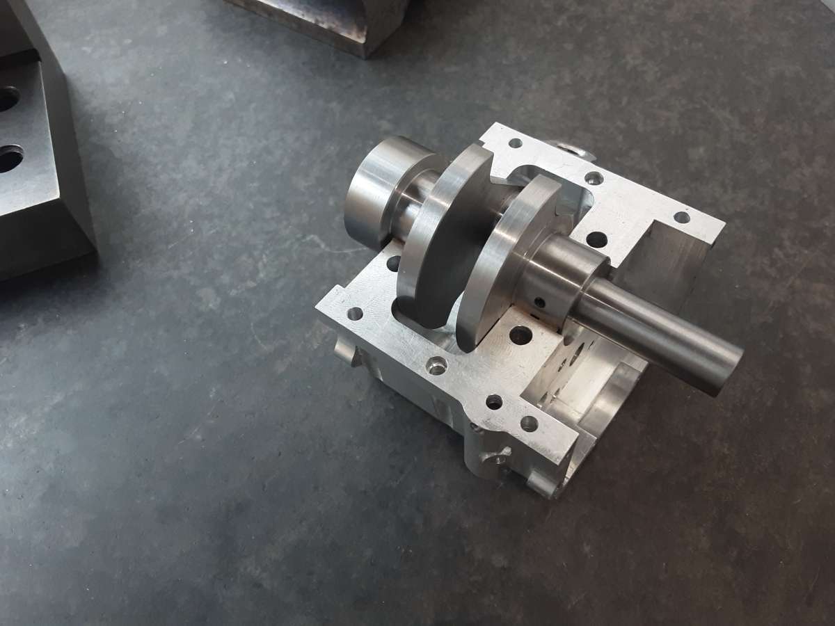

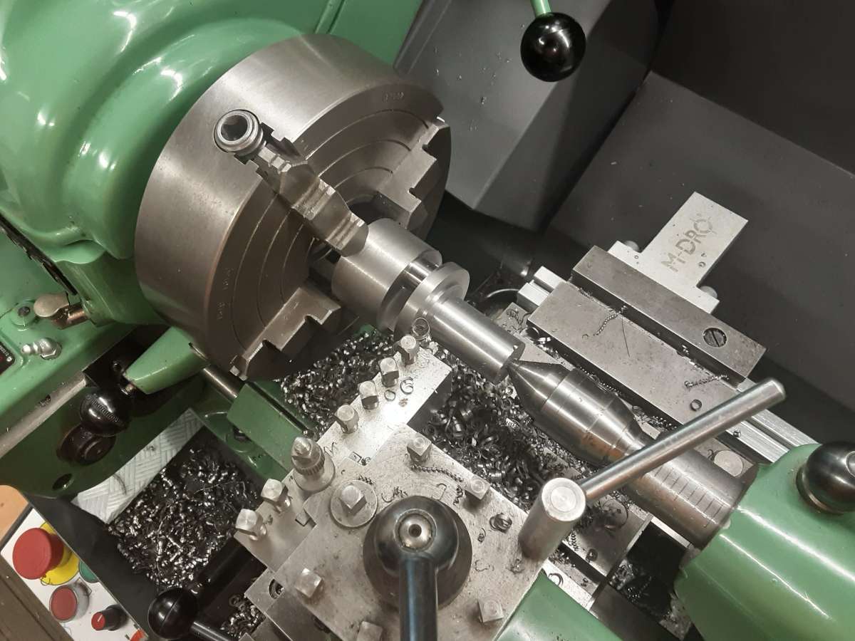

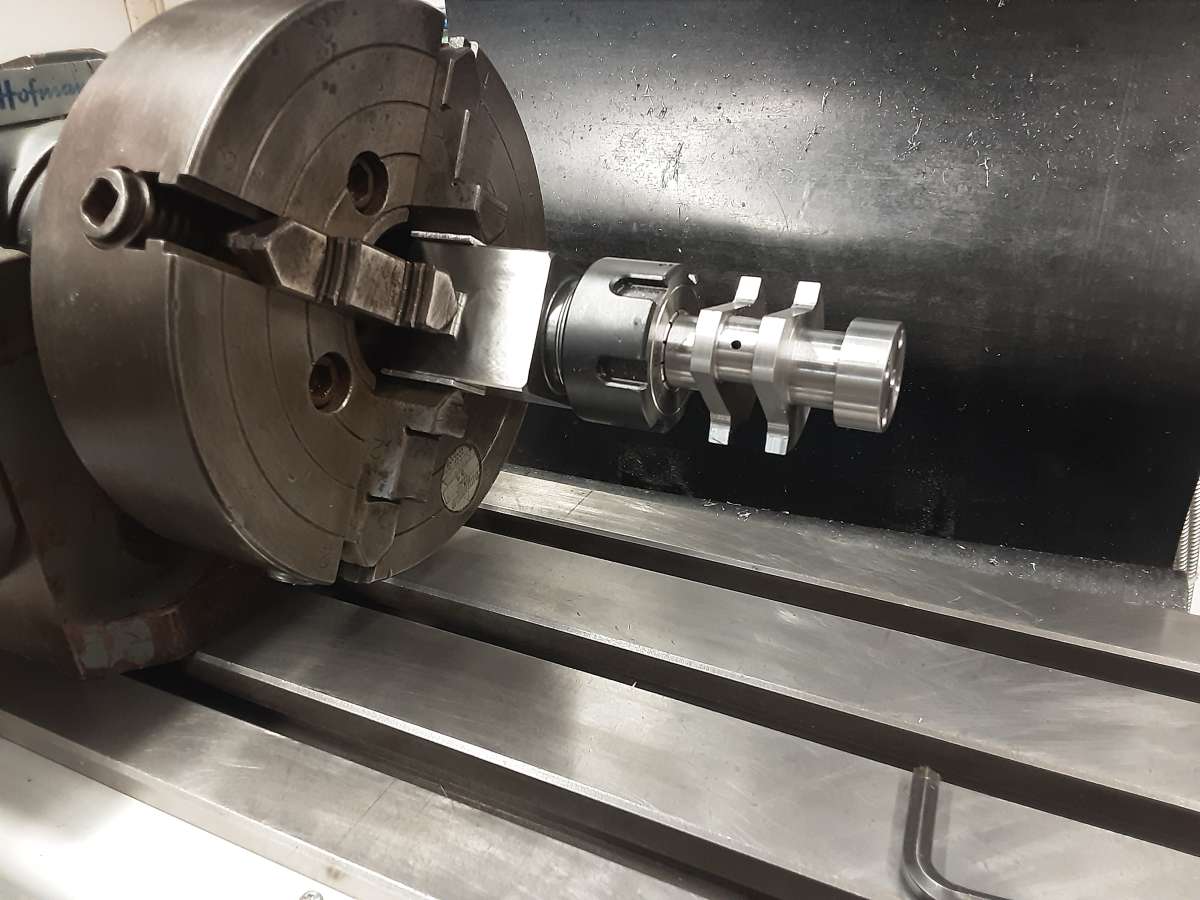

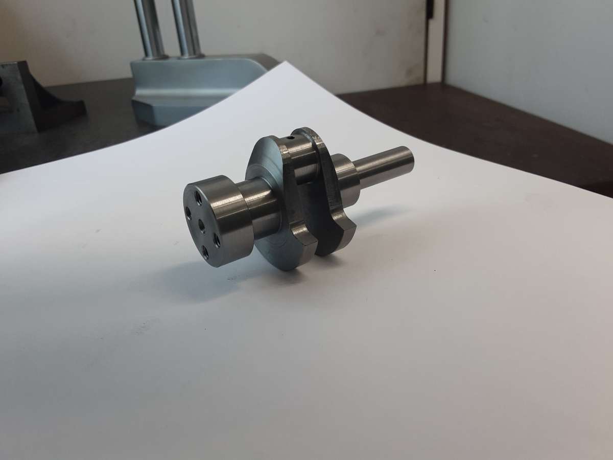

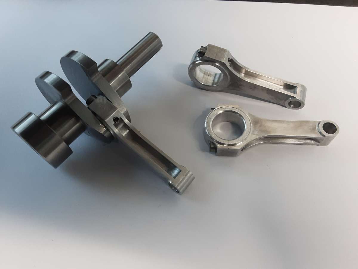

              #859624
              SteveP
                @stevepye68246

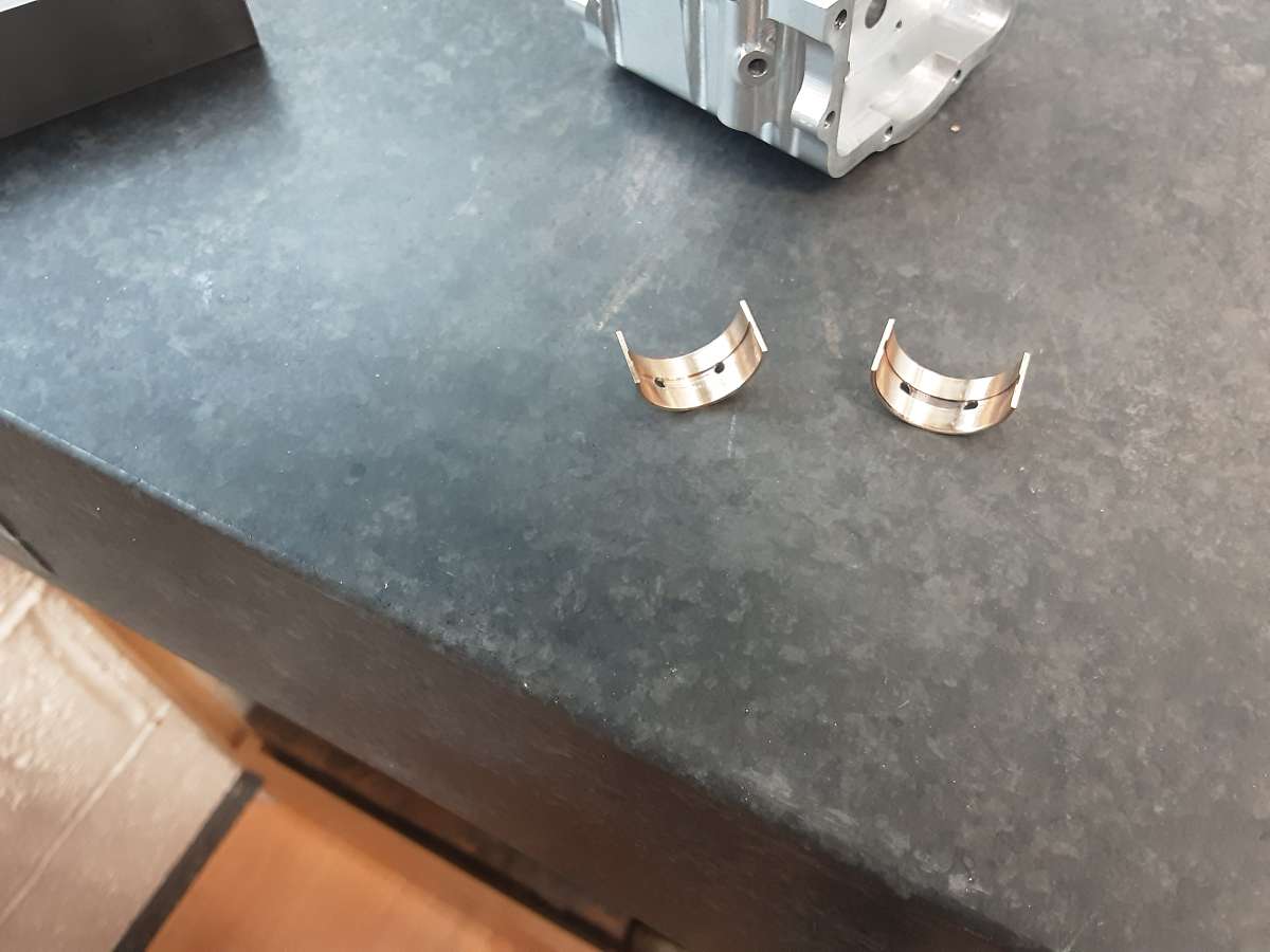

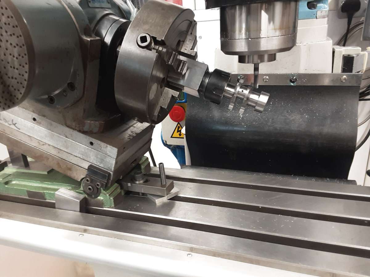

                A little more progress.
                Conrod and piston next.
                Steve P20260724_12274720260731_15044720260806_10064420260806_12053720260806_12391920260806_12443320260806_124359

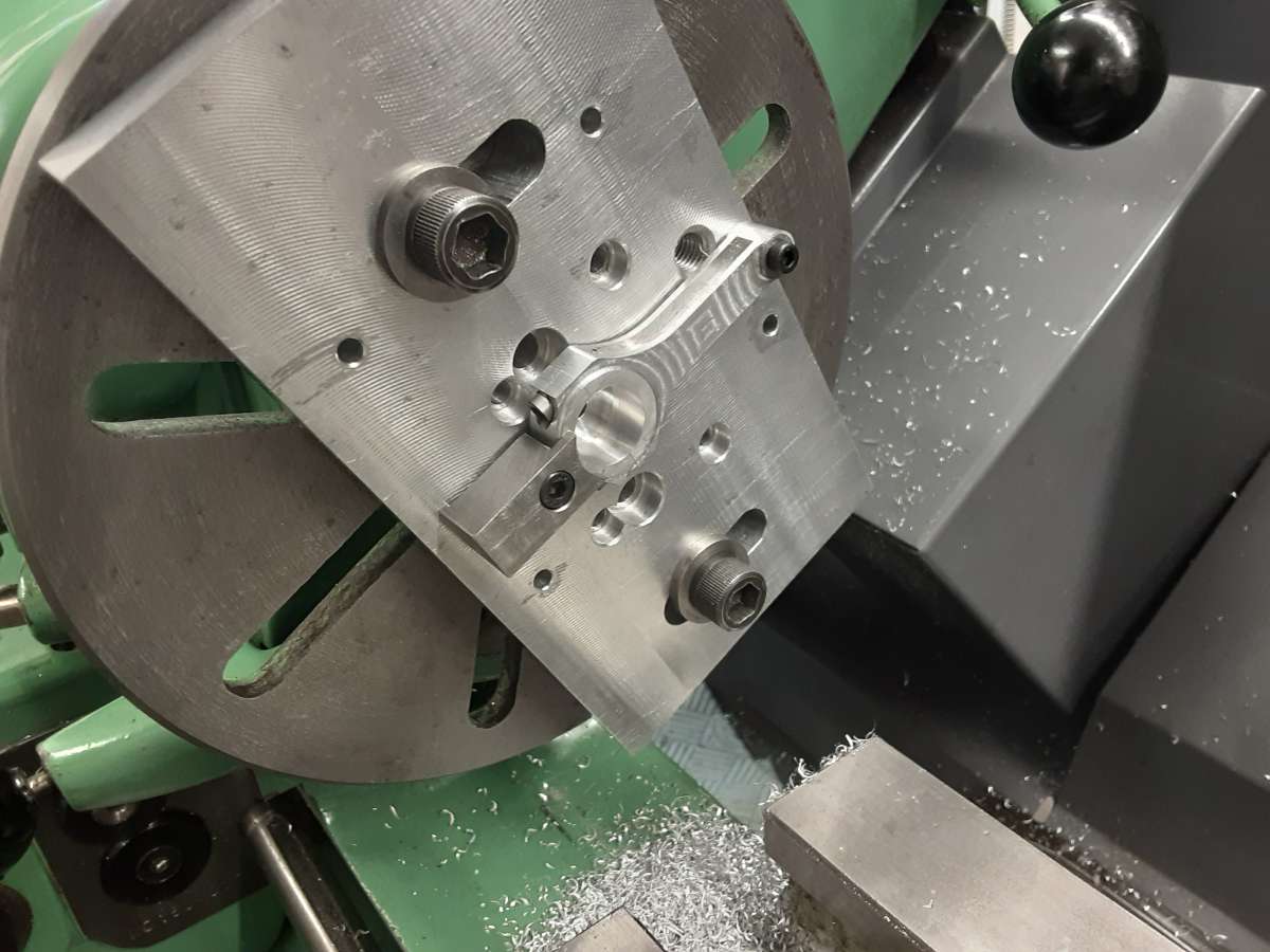

                #859629
                renardiere7
                  @renardiere7
                  Stunning workmanship!  That’s a hell of a sine table to take a dividing head.
                  #859717
                  SteveP
                    @stevepye68246
                    Thank you renardiere7, I think the photographs flatter.
                    The sine table was manufactured  by a company called HABIT ,it has a magnetic chuck attached and it’s really for using on a surface grinder ,not for abusing on a milling machine , it was just an easy setup for the last operation and I  only took very light cuts, another drawback ,everything has to be demagnetized afterwards.
                    Steve

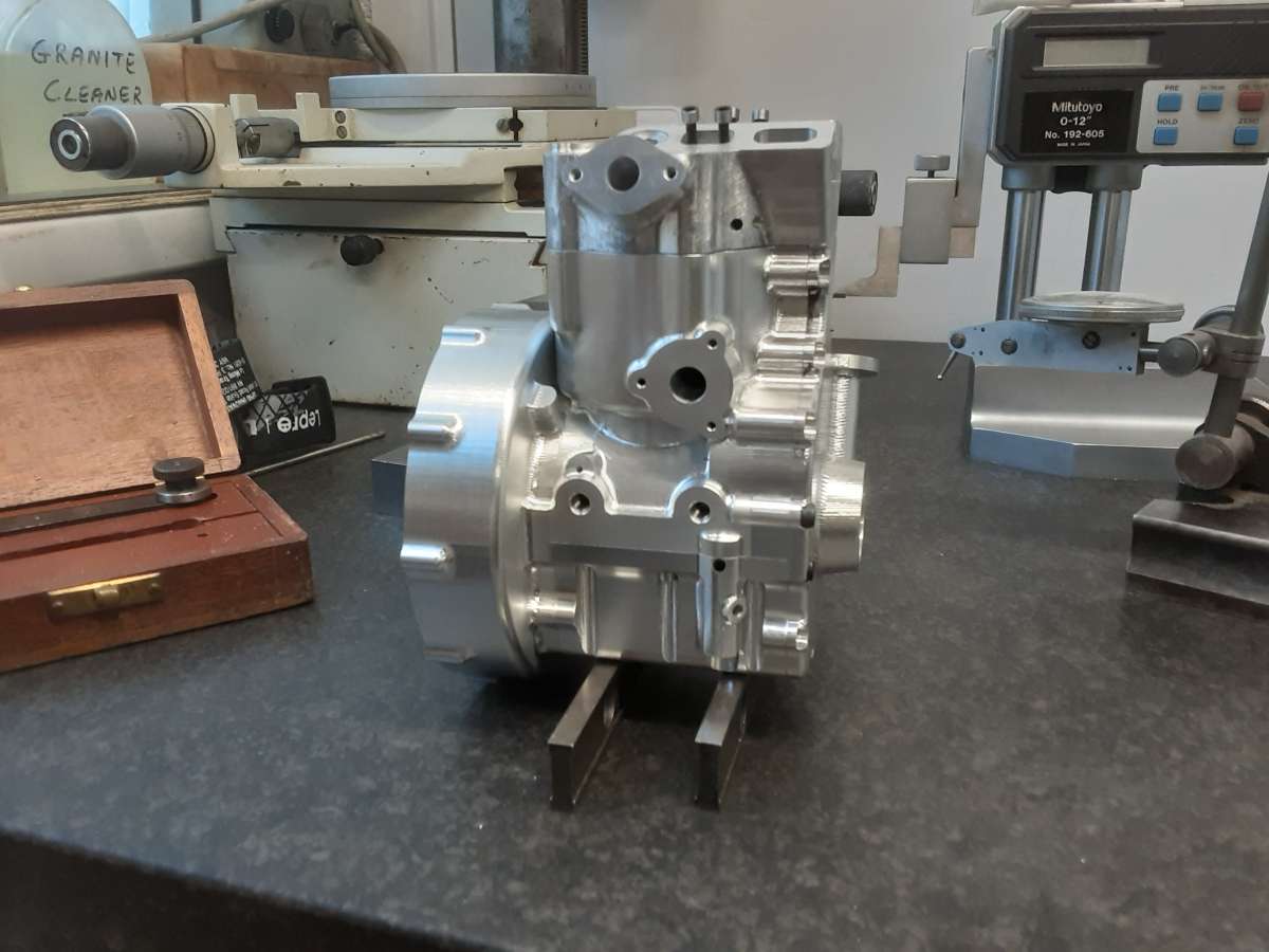

                      #865387
                      SteveP
                        @stevepye68246
                        After Parovoz post a picture of his beautiful Su252_53 locomotive
                        my offering is definitely in the shade. 20260915_16150420260917_155922Steve
