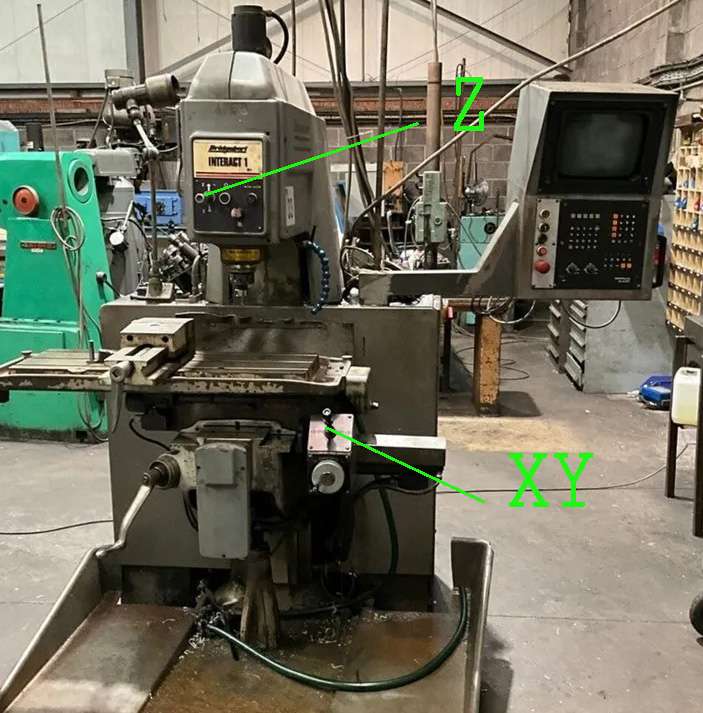

        As for what stuff I am going to do I will be cutting metal etc. I want to learn how to work a milling machine and
        this is a good start. Perhaps in at the deeper end but the machine is a bargain. All basic stuff for now.
        About moving the quill, this is an Interact machine and not a ‘CNC Bridgeport’ as pictured at the top of the thread.
        There is a joy stick for the Z axis that will hopefully work. The quill motor sticks out of the top. It drives two quill screws via a toothed belt.
        There is a joystick for X and Y too + a mechanical wheel. I think the machine needs to be switched on for the mechanical wheel to operate. You flick a switch for X and flick the opposite way  for Y ( I think).
        The machine came out off a working environment so hopefully all will simply work.

          The screen is ‘gone’ I was informed but then another guy said it was serviceable and was in the process of ‘going’ (getting hard to see the figures and stuff) for years.
          You can see some sore of figures on it with the machine turned off. Burned in I guess.
              Interact is the model name for their first CNC machines. They didn’t fit the steppers etc to save delicate little machinists the effort of turning handles. So while you can use it manually you will also be able to run it as a CNC in due course.
              Did you get any tool holders? I expect you have seen that useful post on CNCzone about modifying various 30 taper types to fit.
              As for the screen you might need to find out what the interface is and whether you can get to the data before the video scan generation.

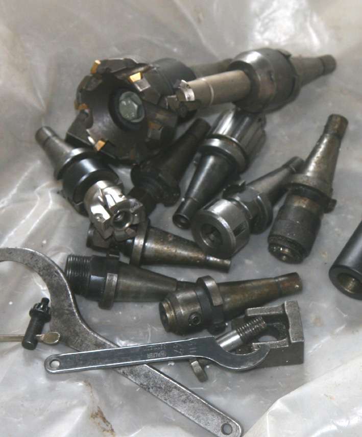

                #842808
                tomcnc
                  @tomcnc
                  Some cutters and stuff that came with the Bridgeport
                  IMG_2557
                  #842810
                  John Haine
                    @johnhaine32865
                    I’d stick with the 30int taper personally.

                            Generally MPG pendants and handwheels are used for rough positioning, lining up centre finding devices and similar work rather than manual machining.
                            As you have no manual milling experience to get it the way its probably just as easy to go straight to basic conversational CNC using the machine control to enter cut starting and finishing positions then work up from there. The “book” will give you suitable speeds and feeds for the cutter you choose. Probably best to derate to about 1/2 given values in the home shop environment where long life is more important than material removal rate. its quite scary the first few time when the machine just takes off on its own going exactly where you told it to go. Especially when where you told it wasn’t where you intended! Practice doing lots of air cutting with the cutter well clear of the table first. Maybe appointed rather than a cutter so it can be bought down onto a sacrificial surface to see where things went.
                            It is said in some quarters that corian is good practice material as it cuts cleanly and doesn’t abrade ordinary milling cutters. Time to chat up a kitchen fitter for offcuts perhaps.
                            Pretty sure that controller will let you work with simple point to point moves rather than needing to go straight to G code.

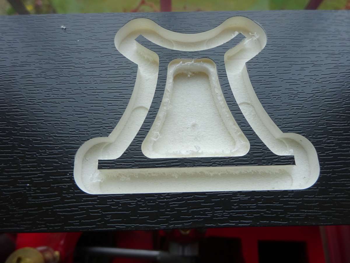

                            #842837
                              I occasionaly use the jog function to “manually” machine on my CNC just by holding the mouse on the relevant arrow on the screen. I am able to slow the jog to a usable rate, not sure if your older machine will allow that or the small handwheel may be too fine and need silly twiddling speeds. Typical manual things might be taking a quick clean up pass off the top of a block and drilling a couple of holes so the workpiece can be screwed to that for CNC machining.
                              As for practice you can put a fine Sharpie in a collet and do simple contours, unlike air cutting this checks you have Z set and operating as expected.
                              I did my first few practice cuts on some scrap UPVC facia which is very forgiving and as the outer surface was a different colour to the core easy to see what had been cut. Soon moved onto metal.
                              DSC03554
                              20190303_122727

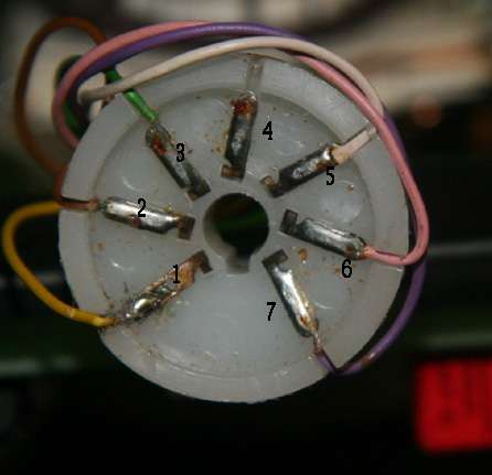

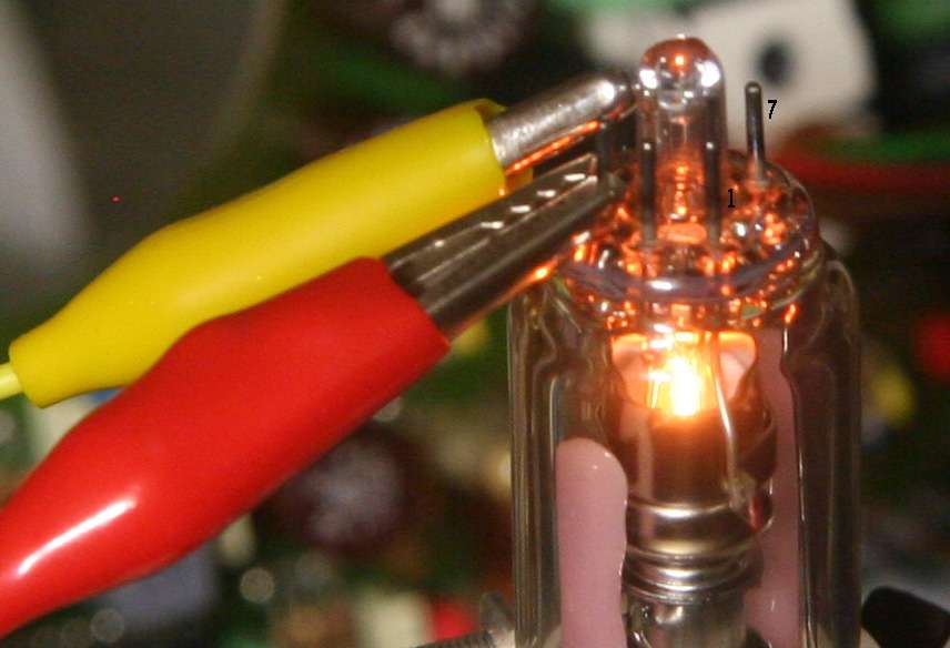

                                  I removed the monitor from the controller to have a look at the CRT.
                                  The CRT is a Philips M31_340 LM/ED . These CRT’s have high resolution and were recommended for data display and ‘high end’ computers back in the day. It is a green screen I think. The LM/ED is the phosphor colour and glass tint (or no tint) and are not electrical parameters (not important unless you are particular).
                                  There are other tubes that will substitute I believe but it is very hard to get data or info on them.
                                  The Orion 310GNB31 seems to be a contender. It is available fairly cheap on ebay. About 50 quid second hand from monitors from an Amstrad GT-65. The resolution may be lower.
                                  Also commodore pet 4032 but they are too expensive and hard to come by.
                                  I may not need a monitor. You can purchase replacements but they range from 500 to 1000 quid.
                                  There is a second hand M31-340 Philips monitor available on EBAY from the USA for about 300 quid + postage (an arm and a leg on top of the price!).
                                  Anyhow on opening up the monitor I discovered that the heater of the CRT was not connected up as shown in the  photos. I believe the yellow wire (going to pin 1) should be going to pin 4. Pins 3 and 4 are for the CRT heater connection. Pin 1  needs no connection (so long as pin 5 has a connection) as it is common to pin 5 . This info. I took from a Philips tube publication namely “Philips Monochrome tubes and deflection units  T16” ,page 242. It is available on the web.
                                  The last dude that was servicing the machine must have made a mistake and put the yellow wire to pin 1 instead of pin 4. The soldering on pin 1 is poor though the photo does not show it clearly. I connected up a 12v supply to pins 3 and 4 and the heater lights up OK as per the photo. It draws about 130mA (as per the publication above).
                                  There is absolutely no way the tube would work without power going to the Cathode heater.
                                  Still have not gotton around to pluging in the machine.B7G_DHeat_on

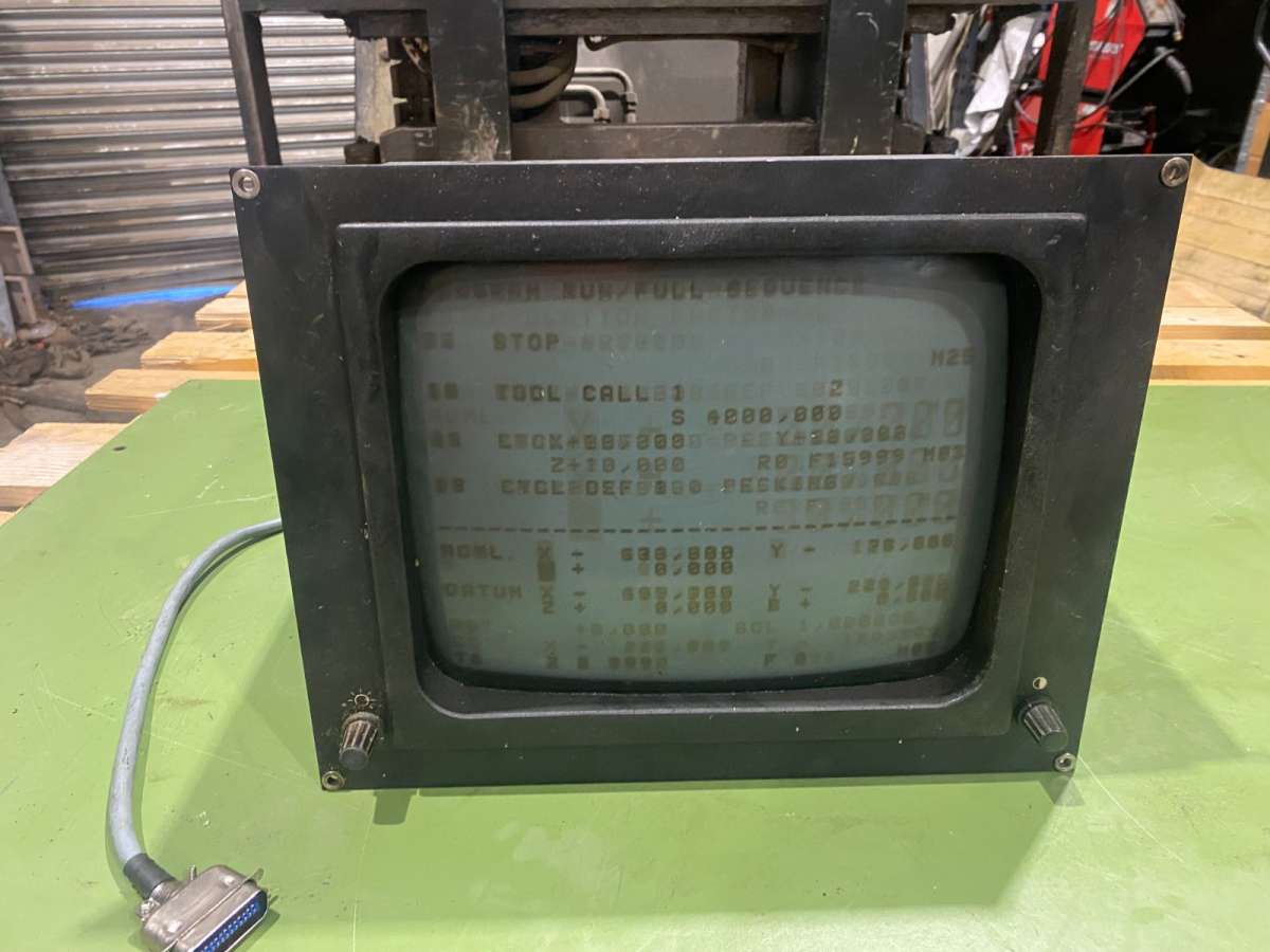

                                  #844181
                                  Clive Foster
                                    @clivefoster55965
                                    tomcnc
                                    How is your google-fu! Over the years I’ve seen several references / how to do it instructions covering DIY replacements of the Heidenhain CRT with a LCD panel. No way of knowing how good the results were or even if the panels and driver circuitry can still be got.
                                    Commercial kits are still around but seriously expensive. Looks like there is a “used once to test” one on E-Bay for £450 (ish) right now which is still way spendy.
                                    Clive
                                    #844246
                                    tomcnc
                                      @tomcnc
                                      @ Clive
                                      My “google-fu” is highly advanced, acting as a professional information detective to quickly extract precise, relevant information from the web. I utilize specialized search operators (like “”, -, site:) to bypass clutter and find exact answers, essentially acting as a “black belt” in digital research  “”
                                      At least that what Google came up with when I Google ‘Google Fu’  s-l1600  🙂
                                      I will admit all my statement about substituting this tube and that tube are from Google.
                                      I am not trying to do something difficult like putting in a plasma or LCD or whatever, just replacing the tube.
                                      There is a Philips M31-340 available 300 quid or so.. It is easy to simple replace a tube. I was hoping that another type of cheaper tube (old green screen and probably less resolution) could simply be dropped in. I don’t mean to replace the monitor, just the tube.
                                      I need to get the machine plugged in and see if the monitor (tube) lights up. Perhaps I have fixed it by moving that wire from pin 1 to 4.
                                      Looking on ebay I see a monitor (same as mine, a B211) for 220 pounds. Picture attached.
                                      The state of that thing. What would it look like when powered up. Would the figures coming up on it be readable?
                                      I have never seen a milling machine actually working (with a new or old monitor).
                                      The monitor I have does not look half as bad as that ebay monitor.
                                      That picture went into the post in the wrong place.
                                      Cheers,
                                      Tom

                                        #844269
                                        Clive Foster
                                          @clivefoster55965
                                          Tom
                                          This looks pretty good. E-Bay 186865248465. £420 isn’t pocket change but if, it really is all but new, thats half the new price and you know it will fit.
                                          On something that old I’d be worrying about electronic issues in the CRT drive circuit surfacing in the not too far distant future if you simply change the tube.
                                          Clive

                                                • What’s the mill for? Though good for producing many copies of the same part, it won’t link easily to a modern CAD/CAM setup where the ability to cut unusual shapes is wonderful, even if only one part is needed. If ‘unusual shapes’ are wanted, this machine is far from ideal.  It is worth owning for repetition work, otherwise, think again.   Full CAD/CAM could be implemented by dumping the TNC150 in favour of a modern CNC control system, and these are cheaper than Heidenhain spares.  But it’s more time and money,
                                                • Is the machine in good mechanical order?  The obviously broken VDU could be the tip of an iceberg.  Do the motors work?  Are the electrics OK?  Is the machine worn – bearings, lead-screws, ways etc.  Alignment and run-out OK?  Any damage, or signs that “Bill Bodger” has been at the old girl?  I would start with a full survey, because finding problems one after the other is so expensive.  I’d rather know what’s wrong in advance than be slapped down by a succession of surprises!
                                                • Is a doer-upper a good use of your time?  Sorting this machine out could take years. Some enjoy restoration projects as their main hobby.  Not me.  I use tools to make things, and dislike having to mend them before I can start real work. This mill is an interesting project for a restorer, rather than an efficient way for a maker to get into the hobby.
                                                • Is a doer-upper a good use of money?  £500 for a Bridgeport sounds like a bargain, but getting the beast working could be a money pit for the reasons outlined above and more. Though loads of dosh can be saved by DIY, it’s not unusual for projects like this to fail. Lack of time is probably the biggest killer, especially when several new skills have to be developed, and one only has a limited workshop.   Not having the right tools is a huge time-waster too.  Far quicker to debug that VDU with a £600 oscilloscope than a £6 multimeter…

                                                      My Interact was quite happy to run on drip feed from a PC on complicated items.
                                                      The machine was eventually modified when the CRT screen packed up and it would have cost £1000 plus to get a replacement screen.
                                                      I ripped out the TNC 150 and replaced it with an old PC, used a touch screen from eBay and retro fitted modern encoders to the motors and it now runs on Mach three.
