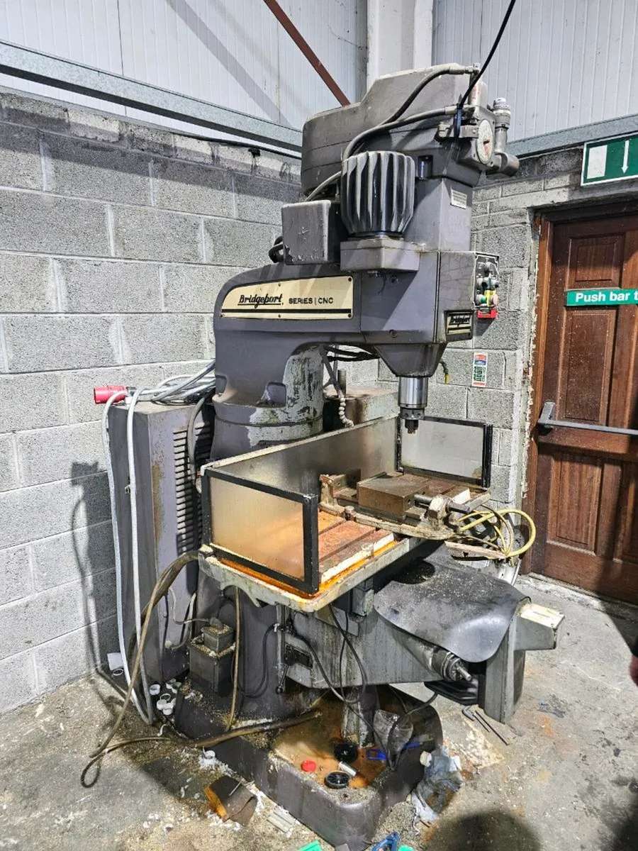

      I have in my sights a Bridgeport Series 1 CNC milling machine as pictured.
      There appears to be no manual way of moving the quill.
      If the software or electrics etc is not working or give up in the future and I am unable to fix them, will this be a large problem?
      Being unable to move the quill manually sounds like a non starter.
      Is it possible to put a manual handle on the machine to move the quill (as a kit or something)?
      The machine is run from a PC. I have yet to find out what software is running the machine. While computers are not
      new to me, running CNC machines is new to me. What type of software would be controlling the machine can anyone guess?

          I think Interact was the name and originally use BOSS but Protrack sounds familiar
          There are cetrainly members here who are quite happy using mills with no quill, just cranking the knee up and down when needed. Myself as I do allmost all my drilling on teh mill too would miss not having a quill.
          I’m not sure that even had a quill, probably just ran the spindle in the head for rigidity so adding a handle won’t work. Edit. Looks like X axis was with a ball nut driven quill and the table was not under CNC control in Z so may be another limiting factor.

              From the stepper motor on the quill drive that would have had a Boss control originally.
              Retrofitted a lot of those in the mid to late 80s – replaced the steppers with SEM DC servo motors, 3 axis  Indramat amplifier & the control with a Heidenhain TNC145/150/151/155. IIRC Bridgeport offered them later with TNC131/135 point-to-point controls or the TNC145 2 1/2D contouring control.
              IIRC they quill drive uses an “odd” hollow ballscrew attached to the top of the quill, with a timing belt driven rotating nut arrangement. The spindle drive shaft ran down the middle of the hollow screw. Good from the POV that the thrust on the quill was along it’s axis, not offset. Not good from a replacement of old bespoke hardware POV
              Protorack was a later system, originally brought into the UK by XYZ Machine Tools on Taiwanese carcasses. Don’t recall seeing it on Bridgeports, which were mainly Heidenhain.

                There is no way of driving the machine manually. Everything depends on the CNC control and motor drives operating correctly.
                Depending on what has been used for the PC conversion there may be facilities for driving via a pendant MPG system so the machine goes to where you tell it.
                Still seems to have its original motors and drives which is worry as these are now very old and not exactly compatible with the modern way of doing things. As Ex-contributor says the usual upgrade path was to replace drivers, motors and control as one package. Expensive then and now, but reliably effective.
                You must verify that the PC based conversion has been properly done and all works as it should. A fair few amateur attempts got abandoned part way through. If it’s an older, professional conversion the software is unlikely to be user friendly. No way round learning things properly.

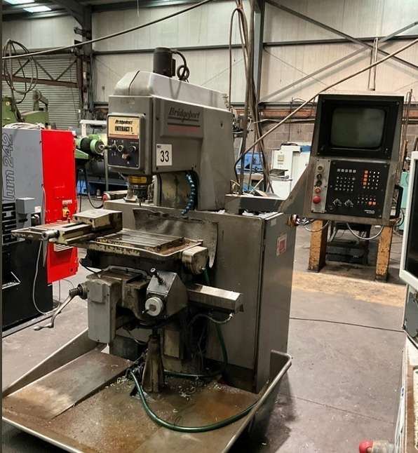

                  I attach a picture of another BridgePort Interect series 1 milling machine.
                  Where do i start???
                  I have been looking into obtaining diagrams in a .svg (scalable vector graphics) format using inkscape (free).
                  Then running the .svg file through a post processor like GaterCAM (40 dollars or so from here https://www.ebay.co.uk/itm/376775357212  ).
                  I then input this G CODE into the interact and off I go?
                  How do you get G CODE from a pc into the CNC INTERACT controllerInteract?
                  Is that basically how it works?

                      I have a machine similar to your second photo. It originally worked on Heidenhain code and was not so easy to use as G code. They are supposed to work on G code as an alternative but mine didn’t seem interested.
                      I used CamBam software to create the code then used a post processor for the Heidenhain code. The processor was found on the CamBam forum by ‘Ade’.
                      My screen packed up and it was cheaper to update the whole machine to Mach 3 and now runs straightforward G code, but that’s another story…
                      Good accurate and solid machines.

                        Don’t underestimate the learning curve involved in getting up to speed with a CNC machine. There is a lot to take in and understand before you can use it whether simple “pseudo-manual” control via an MPG pendant, G-Code input or full on direct from CAD file.
                        Trying to learn on a complicated old school machine with an ageing, possibly flakey, control set-up or knife and fork conversion without proper documentation isn’t going to help. As was these old machines were made to be used by specialists who had the training to handle them helped by the rather sketchy onscreen data. It’s not like a modern 3D printer set-up where all the complicated software side not only (mostly) just works but also gives you pretty pictures. Don’t forget that most of the work these old machines were intended to do was rather simple by modern standards. The sort of work that Jason routinely does would have been assigned to the “best guy”.
                        If you are going to do something like this make sure you have the dedication to see it through and access to all the information you will need. People here will help if they can but, frankly it’s not the sort of thing many of us do. RE-vitalising and old Prototrak or Series 1 clone with Animal or similar control is probably an easier way.

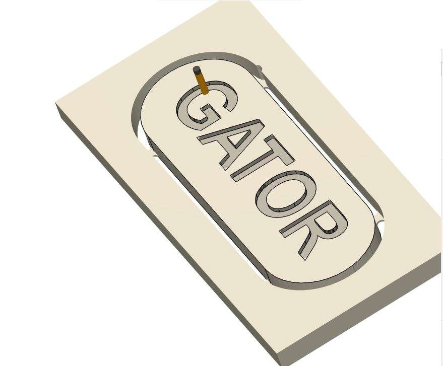

                            I just looked at that Gator Cam and for $40 it seems a bit basic plus you then need to design in something else and then use another free program to view the toolpaths which is all a bit long winded.
                            Why not try something like the free vesion of Fusion360 where you can do the design, CAM, simulations and post process the g-code all in one place. If you have to make a small alteration to the design it is carried through in F360, that won’t be the case using 3 diferent sets of software as you will have to alterthe inscape file then the gator, then check paths.
                            I expect there are a lot more machines listed in F360s post processor than Gator which may reduce any manual tweaking needed to get th eold software to work.
                            Just like the demo video of the Inkscape + Gator + Camotics it can all be done in F360 for free as below
                            gator

                                Not all Heidenhain controls on Bridgeports had the ability to change to ISO programming – IIRC the TNC150 was the first to have the facility & the TNC151/155 were the first to have drip-feed capability from an external source. Drip feeding was desirable for large complex files, as the standard maximum program length in memory on that vintage of controls was 1000 blocks (memory on some could hold up to 3000 blocks, but maximum single program was still 1000).
                                The ISO option was a bit of a kludge, as the controls were natively “Conversational” – that was Heidenhain’s USP after all & IIRC the controls internally converted the ISO files to Conversational before execution. The ISO files were just a G Code interpretation of a Conversational “block”
                                This wasn’t an issue for most users, as these controls were typically programmed manually at the machine by the operator, not fed remotely with CAM generated files. Last employer had 6 Heidenhain controlled milling machines and one natively ISO (Mitsubishi control) & the ISO machine was very rarely used. The operators could program in ISO (manually, long hand) but Conversational was just easier. Reality is that many industrial operations are not complex 3D contouring features & conversational programming can cope fine with 2D contouring, drilling, tapping etc.
                                Of the two Ebay items that Clive linked to – the “converted” one has a real rat’s nest installation for the “update” – may well work, but I wouldn’t fancy going in to that mess to fault find it. And I have always been wary of Haas machines because they are a closed eco-system – everything on them is Haas made (control, drives, motors – everything AFAIK) which means they have a monopoly on parts supply. Same goes for Hurco & Mazak. There are detractors of Haas capabilities in an industrial environment, but a hobby user would likely not push one hard enough to find it’s limitations. What may matter more is that at least some smaller models were limited in clearance between spindle nose & table – one of my old customers (a university workshop) had had one donated & when I asked how it performed was told thay hadn’t used it as by the time a tool was put in the spindle and vice on the table there wasn’t enough room left for a meaningful part.
                                Gate machines were a good carcass – Spanish Anayak machines. Ajax Bridegport clones were Spanish Lagun carcasses & Matchmaker were Japanese Shizuokas. Don’t know what the repair situation would be on the old Anilam Crusaders, but Anilam were taken over by Heidenhain & Heidenhain can’t get the bits to repair some faults on the controls that were fitted to Bridegports so I would not be too hopeful of support. But this stuff is 40+ years old now, so hardly a suprise !

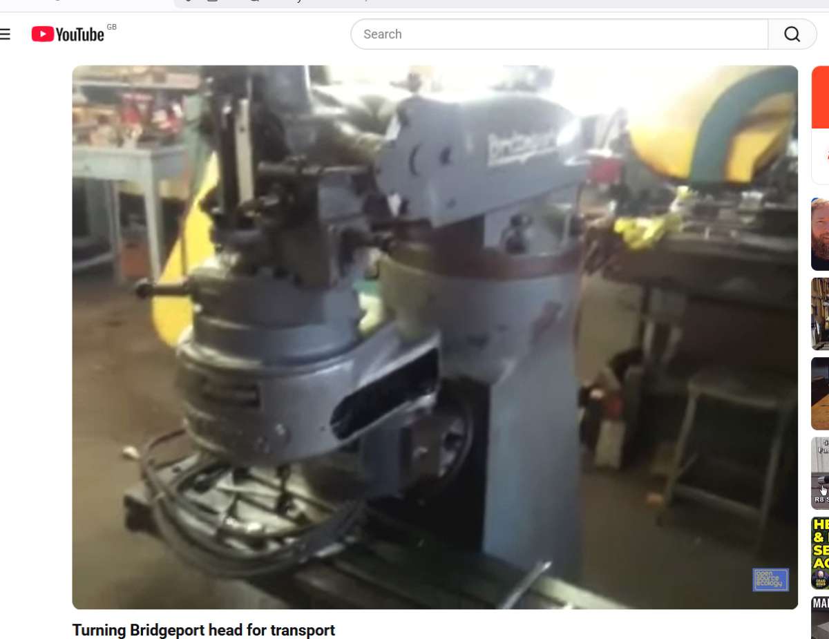

                                  I am now the proud (I hope) owner of the Bridgeport Interact 1 shown above.
                                  I have to transport it home. I am going to use a car transporter.
                                  Any hints on doing this job.
                                  I presume you cannot ‘turn the head down’ like you do on ‘ordinary’ Bridgeport millers like in this video.
                                  Picture grab below:
                                  There is a lifting loop on the top of the Interact. Can you lift the whole machine with that loop.
                                  I think its only for lifting off the head?

                                    There is a threaded hole on top for an eyebolt. You can lift the whole machine with it.
                                    The only thing I had to remove was the quill feed motor to get the machine under my garage door lintel.
                                    The rest of the head is one big fixed lump.

                                                  Bridgeport interact Series 1 Mark 2 now home still in one piece. I had a job getting it lifted off the trailer. Got there eventually.
                                                  Had to take off the quill motor to allow me to lift as it was sticking up in the way.
                                                  It did not balance too badly on the 6 by 8 ft trailer. I put the knee at its lowest.
