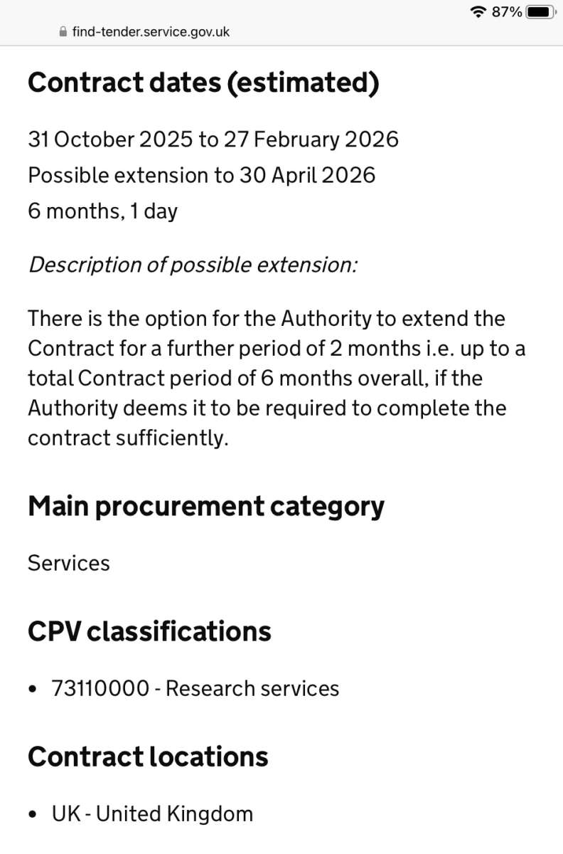

                The Arceio contract should have finished yesterday
                https://www.find-tender.service.gov.uk/Notice/066722-2025#:~:text=Description.%20The%20objective%20of%20this%20study%20is,for%20plug%2Din%20solar%20PV%20in%20the%20UK
                I wonder when the results will be published

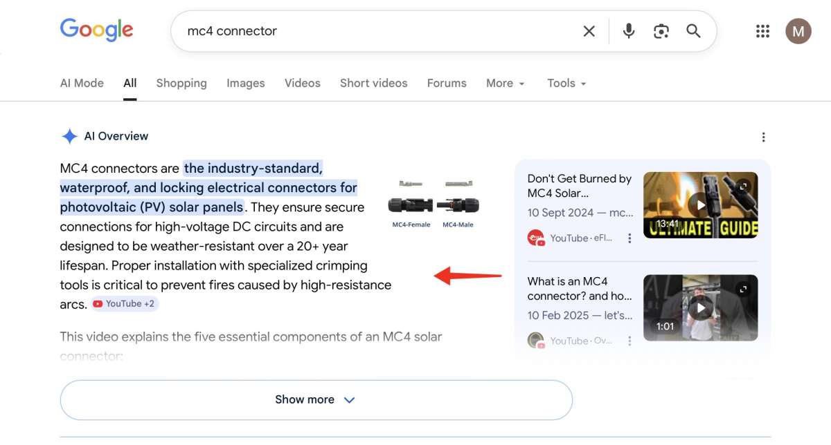

                                      #843002
                                        A word of warning from Aunty Google …
                                        IMG_1551

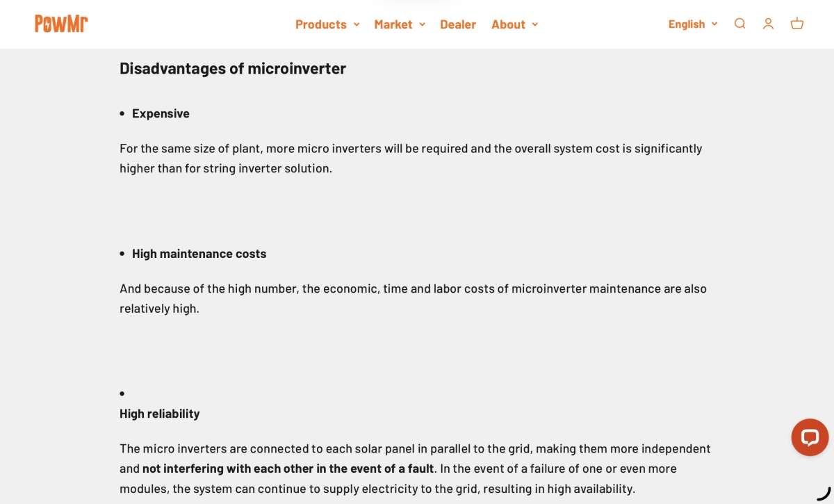

                                        Robert Atkinson 2
                                          @robertatkinson2
                                          On not done it yet Said:
                                          My view is this:  Which is more likely to cause a fire on a roof?
                                          60V (or 72V) DC solar with just a pair of MC4 connectors – and thereafter the usual mains AC voltage at less than 2A
                                          or
                                          Several hundred volts DC @ up to 6A, all the way across the roof with as many as 16 high voltage DC connections via MC4 connectors, then down to an inverter with several hundred volts DC input to the inverter which then converts the power to mains supply.
                                          I know which I consider the safer option, regarding fire risk on the roof.
                                          Anyone think different?
                                          Impossible to say which is more likely to cause a fire, you are comparing apples and oranges.
                                          In terms of classical reliability analysis the micro inverter configuration will be less reliable purely becuse it has more components and connections.
                                          I’m not aware of the exact failure mechanisim(s) involved in the fires but either insulation failure (arcing, typically voltage driven) or poor contact (I2R heating current driven) can cause a fire.
                                          Robert.
