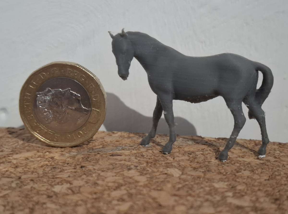

      I recently found myself needing some 1:35 scale horse figures for a model.
      I scanned a roughly 7″ tall china ornament with my Creality scanner, and printed it on my K1 max. I made a miscalculation and scaled it to be far too small.
      I was astounded by the print quality. I used adaptive layer heights and smoothing (not even at the highest settings) and I was using a near new nozzle (my first in over 2½ years -a steel one lasts much, much longer than brass). This was an economy brand of PLA+, about £11 a kg.
      20260612_164937
      I put down nearly all of the recent improvements in quality to three things:
      1. Continual improvements in slicing software, such as arachne walls and better support.
      2. Better filament including knowing which budget brands work reliably.
      3. Good filament care, including drying.
      Even five years ago, I would not have thought this quality was possible.
      What are your views / experiences?

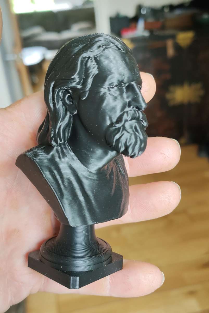

          I uploaded a really bad ‘selfi’ to Bambu Makerworld and it created a mini statue. Printed on my A1 mini. 6 month old filament left on the printer. No fiddling with parameters, no obsessive cleaning of print plate – just click click click. Absolutely amazed at the quality of the model and the quality of the print. It even got my big nose from a front-on selfie.
          I upgraded my old Ender 3 to the max including linear rail, twin leadscrew, stiffened frame, direct drive extruder, dynamic feedback control, auto bed levelling. The A1 mini does it all better – it goes through bed levelling when asked, and dynaminc compensation and flow calibration before every print. Ah, and all for £150. So I would add the printer control software to your list.
          IMG_20260614_173558

            What layer height was that jack?

                .2mm – I didn’t pay any attention at the time – just trusted the defaults.
                By ‘dynaminc compensation’ I meant active damping.

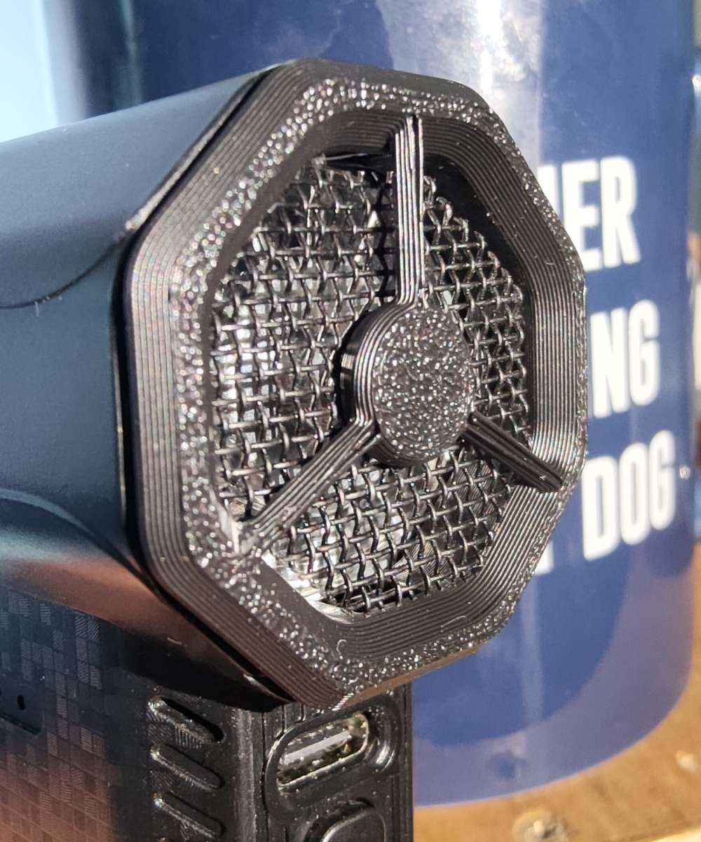

                                    Bed adehsion! The textured, flexible, magnetic print plate on the A1 mini is amazing.
                                    Latest example, while trying to fit a mesh to the intake of my new pocket fan duster, I lost the back. Quick F360 model, send to print, no support, no brim – just direct onto plate with .2 wide first layer for spokes, and 1.5mm wide layer for outer rim – no problems!
                                    IMG_20260616_100608

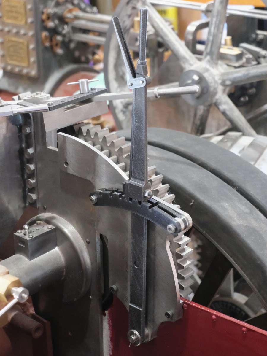

                                      I bought my first 3D filament printer (Ultimaker2) in 2013. The printer was extensively used for work and home; making thousands of parts for prototyping, modelling, client requests and production runs for electronics equipment. I used Cura for slicing. I’ve been using Alibre for 3D CAD for over 20 years. Eighteen months ago I bought a resin printer (Prusa SL1S) primarily for making patterns for investment casting. The resin printer is a bit fiddly to use but the detail level is amazing. More recently the Ultimaker2 failed and was replaced with a Prusa Core One. I am very impressed with the quality of prints from the Core One. Basically it just works and the prints look and feel very good. I have had very few failures, almost always due to inadequate support structures. For both Prusa printers I use PrusaSlicer.
                                      The filament printer is now used for making equipment like my paint tin roller, fixtures for holding parts for painting and prototyping to check fit and feel before committing to metal. An example of the latter is the reversing lever for my traction engine:
                                      Reversing Gear

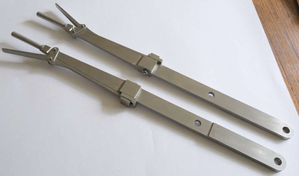

                                      And in metal:
                                      Reversing Levers
                                      The printers are just another tool in the arsenal to be used as needed. I am planning to buy the new multi-filament adaptor for the Prusa Core One once the initial pre-ordered batch has been supplied.

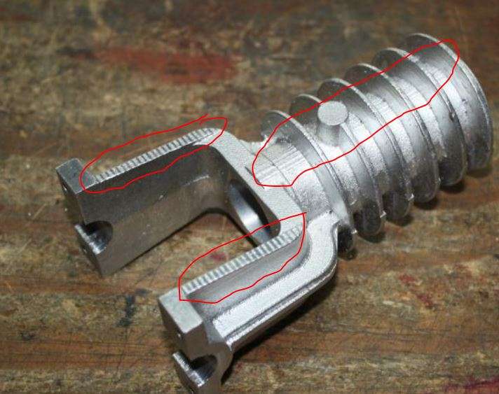

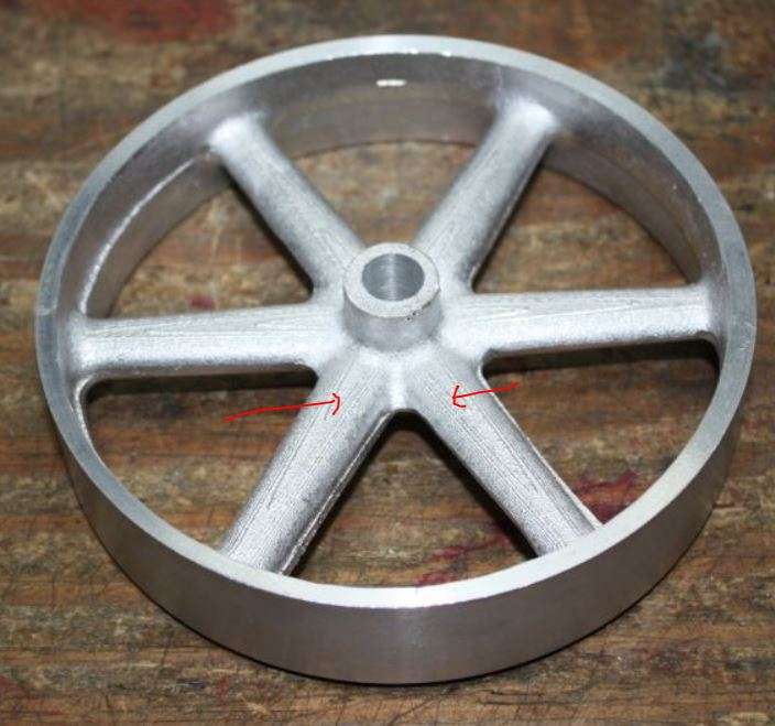

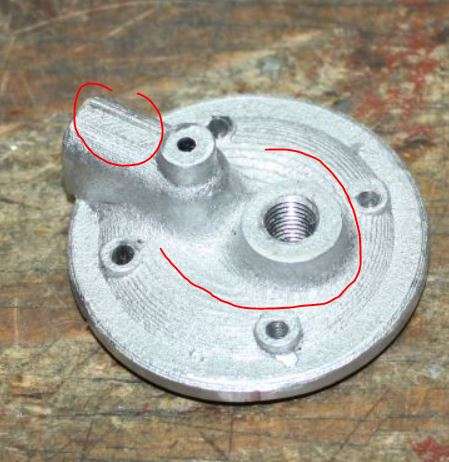

                                        One of the possible uses I would have is to make patterns for casting. However is still see layer lines that I don’t get if I use the CNC to make the patterns. Looking at Jack’s bust although near vertical surfaces like his chest seem very good when I look at the lower part of the base or his shoulders I see a lot of layer lines which would require extra work to remove. I’ve seen plenty of castings that replicate these layer lines and they look pants to me.

                                          The layer lines in the pillar are dissapointing. Maybe tweaking slicer could help. The prints look better in real life than in photos… maybe if I don’t have my glasses on.
                                          3D Printing is still very slow for large objects but you can now just ‘leave it alone’ and it is usually successful. The 1 minute Benchy benchmark has sort of been met – but you wouldn’t like the quality. The first printer to do it seems to have massive vibrations – the active damping must be flipping amazing on that and the whole approach seems practical for mass market so speeds may increase. (Another achiever of 1min Benchy uses massive granite slab, air bearings, and all sorts of other special tricks which seem less practical but it does show the rate of development and how significant developments in the technology can still be made by individuals).
                                          A1 Mini has limited print area but is not speed limited so for small jobs it is fantastic and so cheap.

                                            …..I’ve seen plenty of castings that replicate these layer lines and they look pants to me.

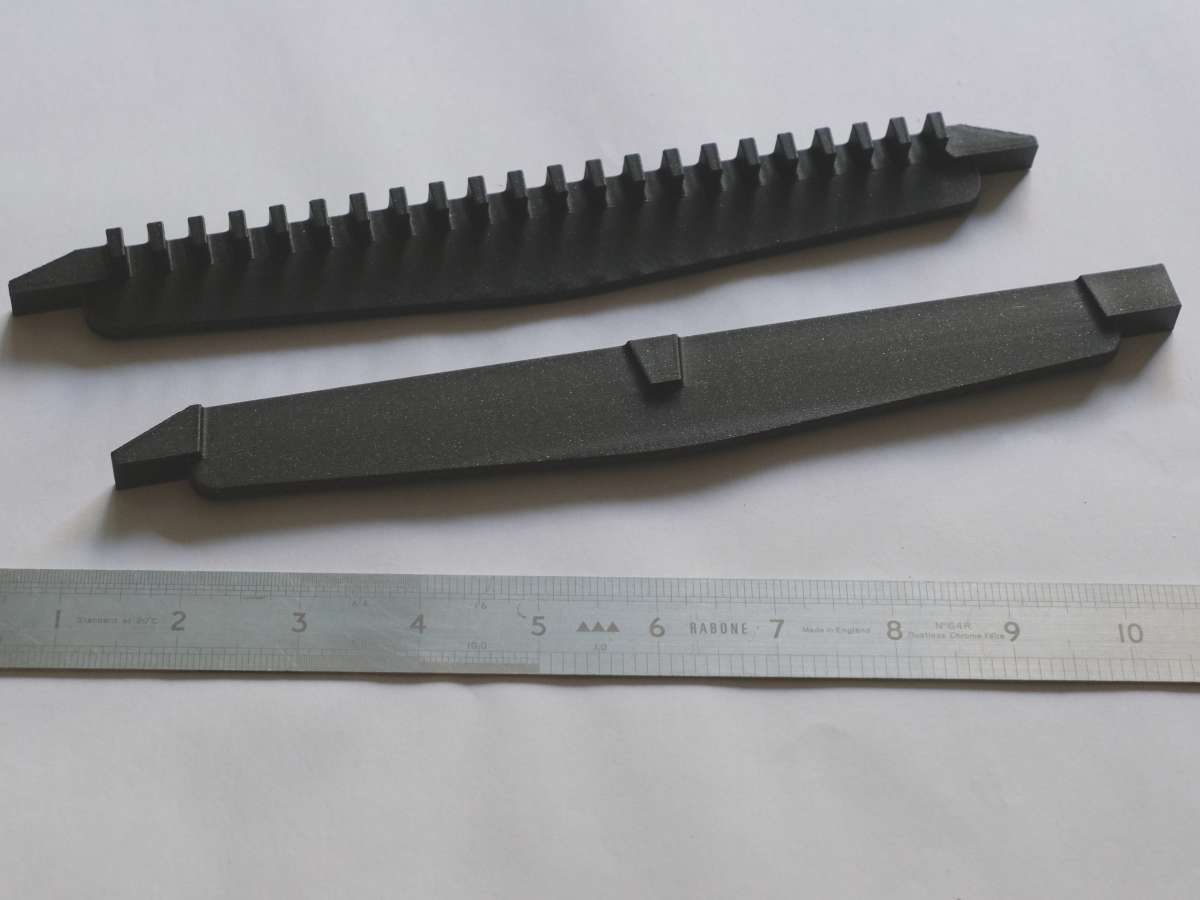

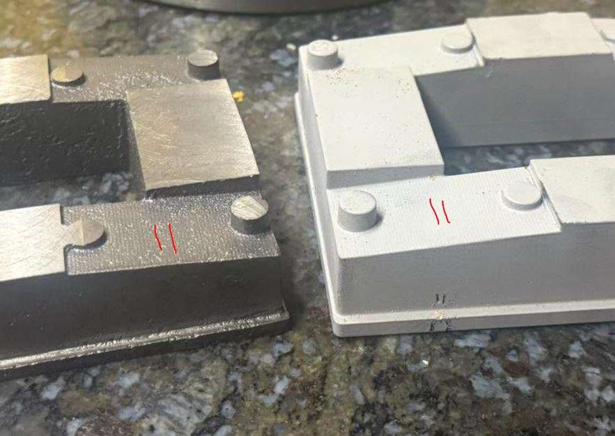

                                            It will be interesting to see how iron castings from my 3D printed patterns for traction engine firebars turn out:
                                            3D Printed Firebars
                                            Doing a quick finger nail test comparing to a Rubert scale indicates that the side walls are around 2 microns Ra. I doubt an iron casting would be able to replicate that level of detail.
                                            The top surfaces of the chamfered ends are a bit rough, but I won’t be including those on the final patterns. I want the top surface to be flat so the firebars can be open cast. The tapered ends can be machined afterwards.
                                            I considered CNC machining the patterns but it would be time consuming with multiple setups as all features have draft and fillets.
                                            Julie

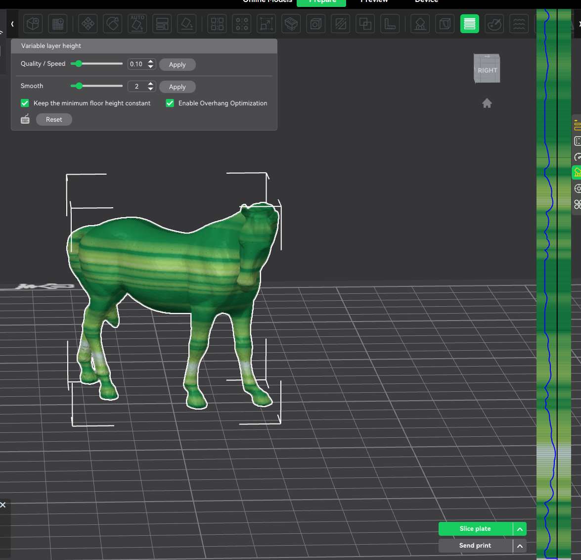

                                                There’s a setting in Creality Print/Cura that uses adaptive layer heights to massively reduce the impact of layer lines without the time overhead of using very low layer heights.
                                                Here’s an example of using it with my scanned horse:
                                                temp
                                                  Providing a good key for the filler?

                                                    Julie, your fire bars are relatively flat or vertical, I assume they were printed top side against the bed so draft will only be a few degrees off vertical. The shadow prevents a good view of the shallower slope of the underside. Were I see the problem the most is on the crests of rounded parts,or where the top surfaces are just a little off horizontal. these for example. Draft being near vertical does not give the problem unless you are printing the part on it’s side. All done on new printers, would have to check the aluminium castings but the last iron one was a Bambu p1Sand I did say to use their variable layer height, not sure if they did. Light grey pattern on right had had a few coats of highbuild primer yet layesr still on the casting left. All airset type sand not even petrobond.
