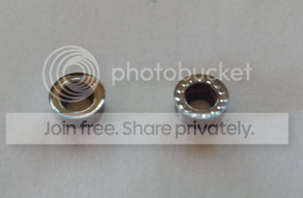

      Hi All,
      I'm trying to find some inserts which I think are a type of uncoated RCxT 0602's – I'm looking for both number and supplier please.
      I want them for turning hardwoods but I'm pretty sure that they are intended to turn Ali and plastics because they are very sharp and have a pretty aggressive chip-breaker.
      I tried some RCGT 0602MO ALU AK10's from shop-apt (**LINK**) but they are noticably less sharp than the one I bought from a specialist woodturning outlet.
      I'd happily support the woodturning outlet were it not for the £10 a pop + P&P price tag which I think is taking the P a bit.
      Photo below shows the sharper one on the left and the RCGT 0602MO ALU AK10 on the right – sorry the focus is off.
      The clearance angles, thickness and countersink are pretty much identical – it's just the chip-breaker depth and honed edge perhaps.
      Any help would be very much approeciated.
      Very many thanks
      Jon

                I think some folks sharpen their inserts. I've seen a picture somewhere of an RCGT mounted on a mandrel in a lathe. I believe the inside was sharpened with a round diamond tool in a dremel. The flat inserts are easily sharpened on a diamond plate. The 9mm flat inserts are quite handy for hollowing.

                  Jon I have a few boxes of the ones on the left. 6,10.12 Ø. My ones are made by CERATIZIT.
                  I get mine from a seller on Ebay called Tooling solutions.

                                I think the F in the MOFN of "RCGT 0602MOFN-27 H10T" means sharp – see **LINK**.
                                The APT naming doesn't seem to have anything after the MO.

                                        Jon, I had this reply from Ceratizit this morning:
                                        Hello Vic
                                        There is an ISO designation system used by carbide insert manufacturers that gives you a breakdown of the key features.
                                        I have attached a flyer that explains what each letter & number refers to.
                                        The key to whether the insert has a sharp edge is point 8, in the case of your insert this is “F” which denotes a sharp edge.
                                        So you were right Jon "F" denotes sharp. Exactly how sharp they are remains to be seen.

                                            It looks as if you were right all along with this link…
                                            **LINK**
                                            They will supply 10 for just over £40. I just need to pluck up the courage to part with my well earned dosh and take the risk now.

                                                  Hi Jon / Vic, The Ceratizit inserts are the ones I mentioned , and take it from me they are VERY sharp. I must have around 6 or 7 boxes of 6 10 and 12 Ø. What a superb finish they leave on steel or any metal I have used then on. although they are for non ferrous or plastics. If you want one to try just pm me and I will fire one off to you.

                                                      Thanks very much to Raymond for providing some inserts for Vic and I to try. I've now had a chance to try hollowing with them and I'm convinced they are spot on! Result!! ☺
                                                      …and Raymond's eBay source has come up trumps as well. 30 inserts for £30 – a heck of a lot better than £10 each.
