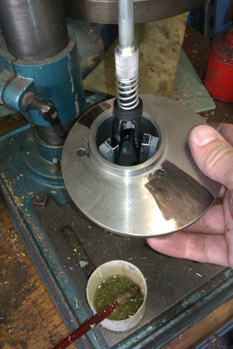

                You also need to give some thought as to the type of rings you are going to use, A hone which leave sa cross hatch is best for iron rings but if you are going for O rings oreven ringless then a lap is the better bet.
                When Honing with the brake cylinder type hones I tend to use the drill press
                IMAG0342
