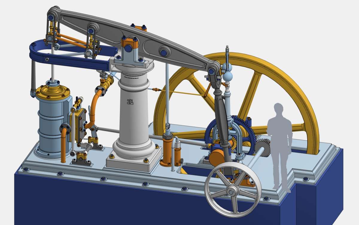

      Hi,
      Long time Model Engineer subscriber, first time poster :).  Hopefully this is the right forum for this post.
      Recently, I was reading through Richard L Hills “Power from Steam”, and “Power in the Industrial Revolution”.  The books are wonderful, but it’s sometimes difficult to build an intuition for the concepts from static pictures.  That led me to do a deep dive into the beam engine: how it works, the history behind it, and the engineering tradeoffs the builders faced.  The article has quite a few interactive figures that I hope make the concepts easier to see.
      Article: https://glinscott.github.io/beam-engine/
      engine-large
      The engine is based on this great CAD model: https://grabcad.com/library/horizontal-beam-engine-1, which is in turn based on https://www.ajreeves.com/model-engineer-beam-engine-me-beam.html.  I rigged it on OnShape, and wrote a custom exporter so the article could show the different mechanisms clearly.
      I would be very grateful for any corrections or feedback.

            In the grand scheme of things, Gary … this seems very trivial, but you did invite comment:
            It would seem more logical, to me, if you started the story with Newcomen’s atmospheric engine, instead of starting with a high-pressure Boiler
            I must leave it to the forum’s steam experts to peer-review the technicalities … but for myself, the article is a joy !

                Feedback is always great :).  Do you mean the first steam vessel, where the water is boiling?  It’s meant to illustrate the relationship between heat and steam – but I see what you mean, it does look like a high pressure vessel.
                I’ll have to think on that – the Newcomen engine needs the concept of a steam-created vacuum to be explained.

                      On glinscott Said:
                      […] Do you mean the first steam vessel, where the water is boiling?  It’s meant to illustrate the relationship between heat and steam – but I see what you mean […]
                      I think the problem is more to do with the conceptual flow of your text
                      The illustration is fine if it just shows water boiling to steam …
                      The genius of Newcomen’s design was that he used the shrinkage of the low-pressure steam when cooled.

                        But I’ll have a go…maybe grey text on a white background makes it a little bit more difficult to read, some of the graphics’ labelling could be one or two font sizes larger….but these are pretty insignificant things.
                        I liked the ‘Measuring the work’ interactive graphic….and how Watt and colleagues kept adding fresh developments over time to help make the profit margins larger and larger.

                          Yes, agreed – I was trying to show the potential power of steam, but you are right, it’s not available to Newcomen.  I mention they can’t use high pressure steam in the piston section, but that’s not really well defined in the early parts of the article.  Will keep thinking on it, thanks!

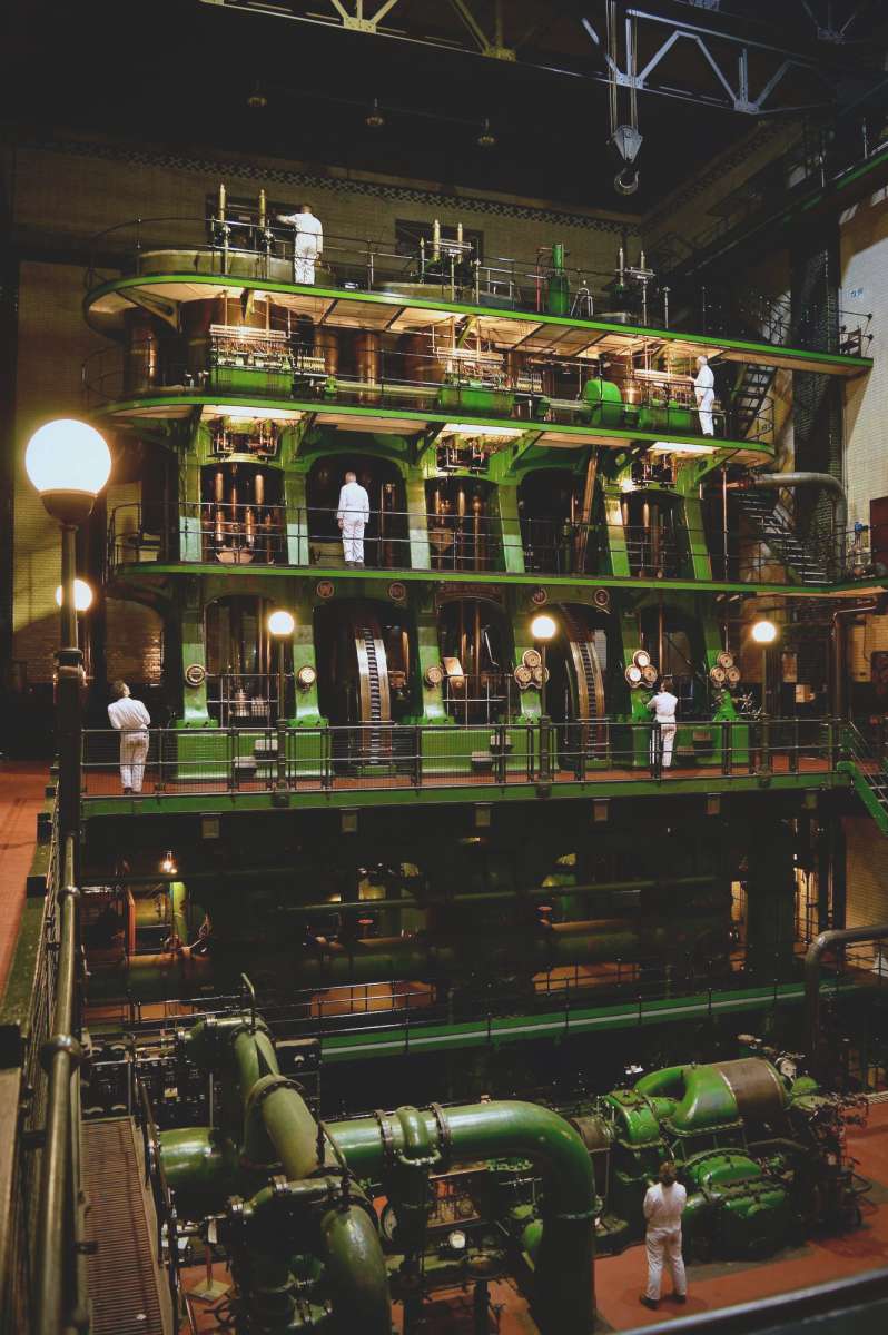

                                      Kempton Steam Museum may disagree on who has the largest working triple expansion engine.
                                      kempton
                                      This one is quite large, about 800tons and 62ft tall. Quite impressive when it is running. They actually have two but only one runs. You can get a walking tour of the out of service one!
                                      Gary’s guide is great for the theory but the real things, whether at Hereford or Kempton are impressive.
