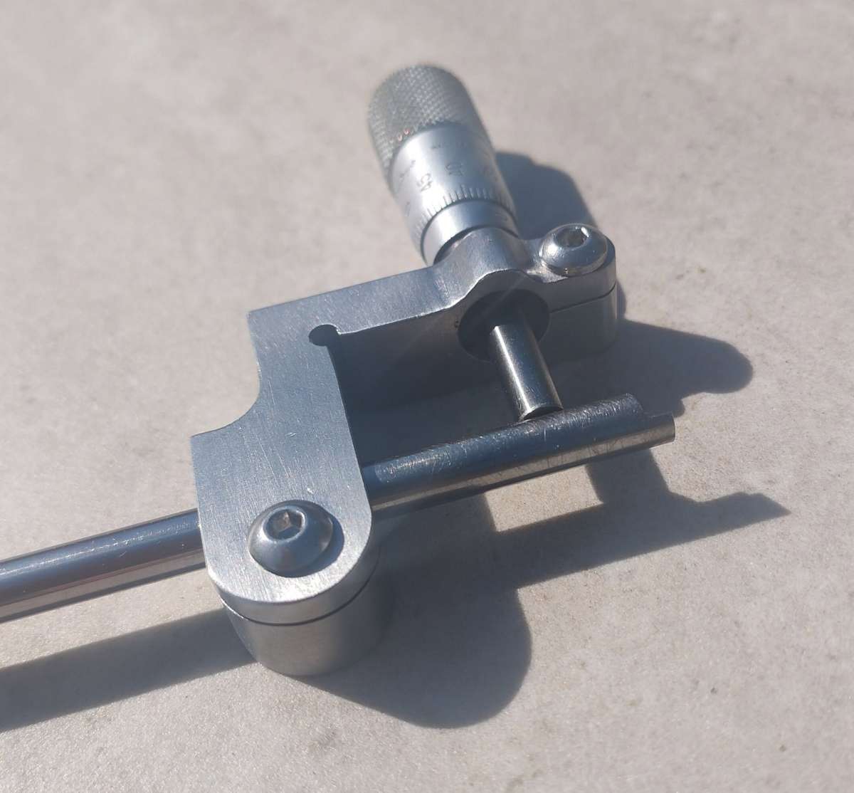

                                  Spent some time on the centre micrometer I bodged to make it look a bit better.

                                    Hardly a “bodge” to start with given the way you have finished it, Jack!

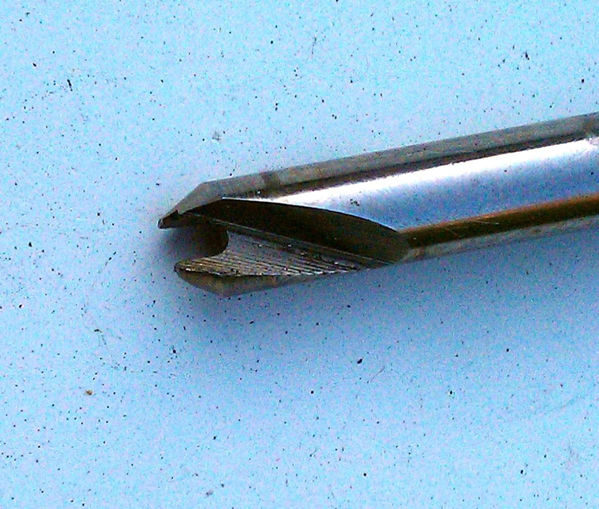

                                                Saved by a carbide end milling cutter – There I was, just putting a 1/8″ diameter centre into a piece of steel work that had taken 4 hours to prepare and ‘ting’ the pilot end snapped off. I tried tapping it out, using a dental probe, even my wife’s micro crochet hook for fine lace wouldn’t hook it out.  Then I remembered that a friend had given me a few carbide milling cutters used for shaping glass based circuit boards.
                                                In for a penny and it’s the first time I have attempted drilling out HSS drills. Great success and a happy boy once again.

                                                    Hi Speedy builder, it for that very reason that I very rarely use centre drills any more. I use the 1/8” shanks of small carbide drills that are broken and grind 3 facets at 60deg which seems to be all that’s needed for most drills. My drills are all 4 facet sharpened.

                                                      The end off a 1/4″ centre drill seized is some 316 stainless (after I had foolishly completed some external diameters) and I did not want to start all over again. I Dremel’d a notch and was able to use this to free the snapped off tip.
                                                      Ian P
                                                      Reground Centre Drill
