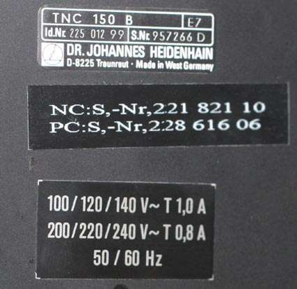

          I don’t know exactly what sort of TNC 150 I have. Is it a B or whatever. Will have a look. How would you know?
          On the back of the controller box there will be a sticker which should have the model number and software versions.  The TNC151B and TNC155B have the sticker in the top left corner as viewed from the back.

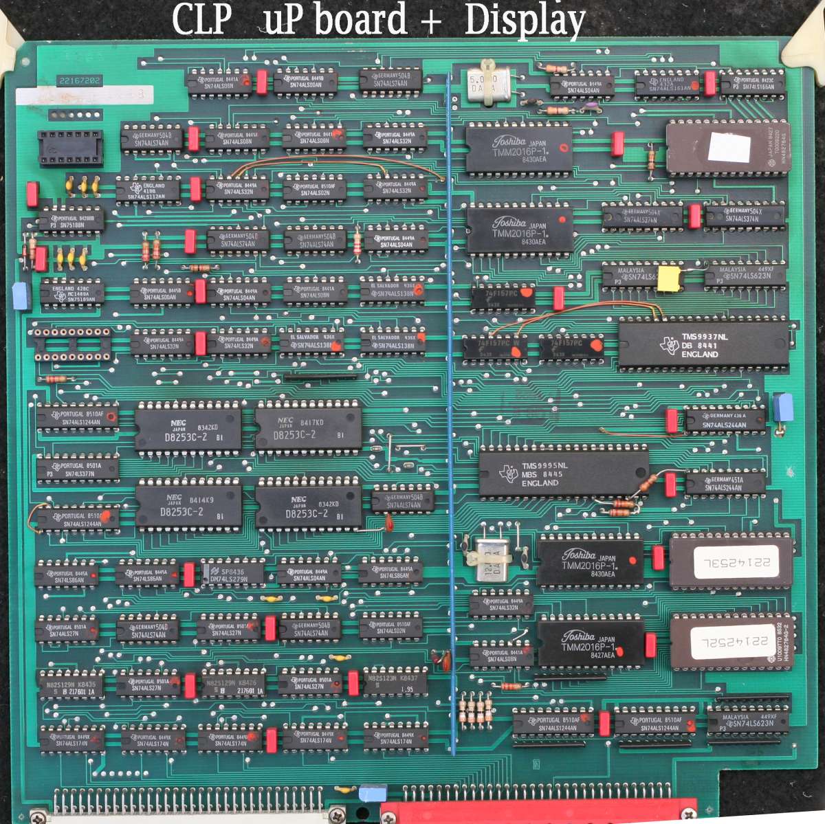

              I have a TNC 150 B as per the picture.

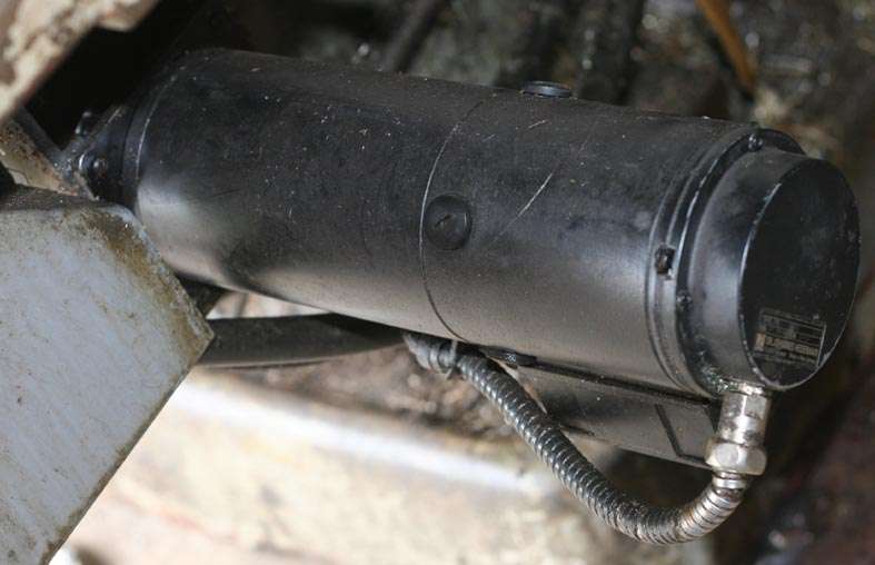

              Also I have a picture of the DC servo motors. Is there a gear box in this motor?
              MOTORSWITCHTNC150B

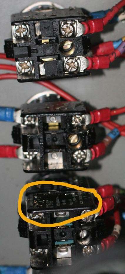

              I have also uploaded a picture of the switches inside the controller box, the box with all the buttons on it.
              There are metal chips in there sitting on the switch (circled) and on the bottom of the box. There seems to be metal chips in all the cabinets. This may account for all the blown fuses that I see in the bottom of the cabinets.

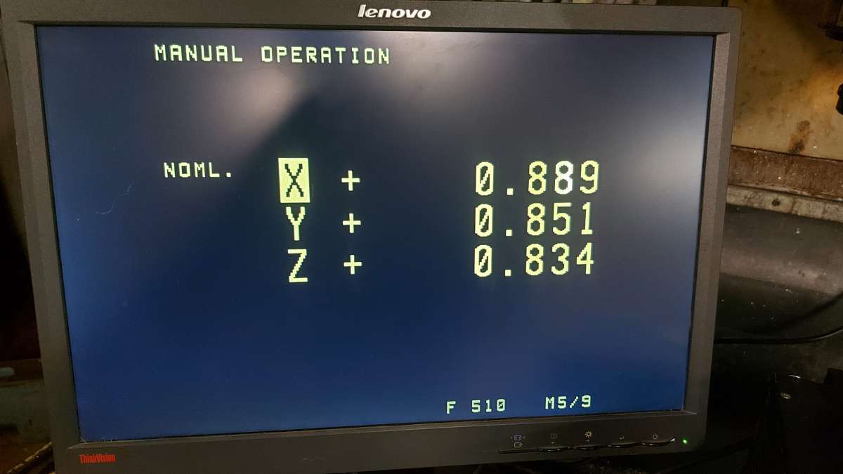

                  I have changed 10 of the capacitors in the BC 211 monitor board ( the circuit that drives the CRT tube).
                  It was doing what google said was a classic problem with old monitor boards. Giving some thick horizontal lines for a few seconds and then going off altogether. This indicates faulty capacitors. I purchased an ESR (effective series resistance) meter. You can test electrolytic capacitors in circuit. Very useful. Had not heard of such a device until a few week ago (and I am as old as the hills).
                  I have attached a file describing how/what it does.  Cannot attach file. There is a utuber instead.
                  https://www.youtube.com/watch?v=I1yasX2SzLY&source_ve_path=OTY3MTQ&embeds_referring_euri=https%3A%2F%2Fwww.altronics.com.au%2F
                  The capacitors  cost about 7 quid.
                  I have also changed the original monochrome amber-coloured tube (the original tube that I thought may be the problem) with a vintage computer green screen of the same (very similar ) size from an Amstrad from ebay.
                  That cost about 30 quid. The new tube has no ‘burn-in’ writhing on it. The tube was not the problem but I will leave the ‘new’ one in there to see how it looks. I can always swap in the original amber tube if  wanted.

                      Cranked up generator but got only a blank screen. I removed monitor and removed monitor box to see if the heater was lighting up in the tube only to discover that I had forgot to connect the HV wire to the anode and the plug from the deflection coils. (Deary me).
                      Hopes up again but the monitor went back to doing what it was doing before I replaced the caps. Alas.

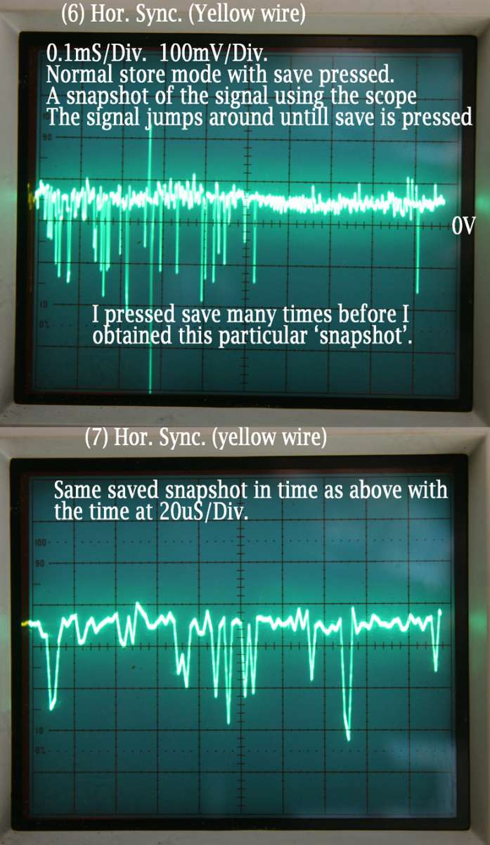

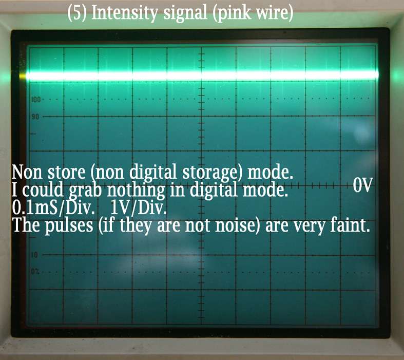

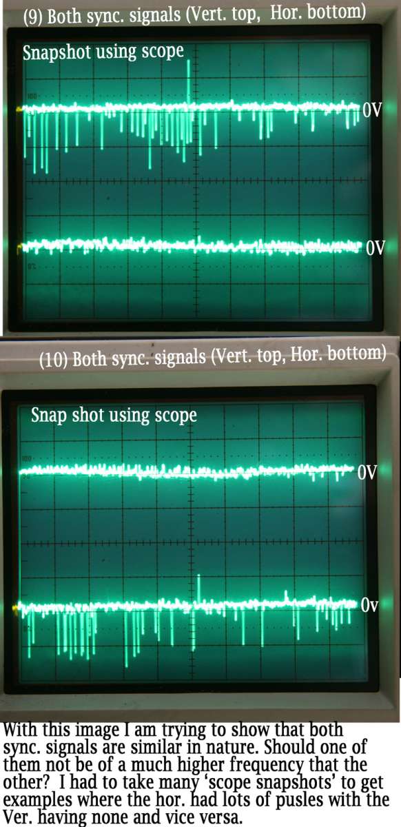

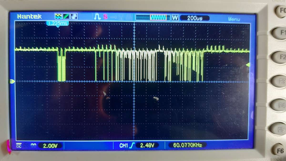

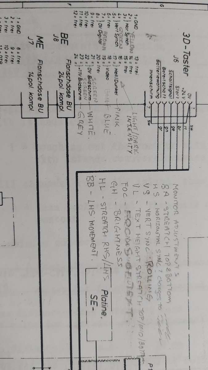

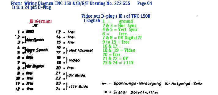

                      I was study the monitor-out (24 pin ‘D’ plug) pins in the manual. It is hard to make out as it is smudged and in German. This is the monitor plug on the back of the TNC control, J8 it is called.
                      Can you suggest what pins 16/17 are (they are joined together like other pins on the plug)?

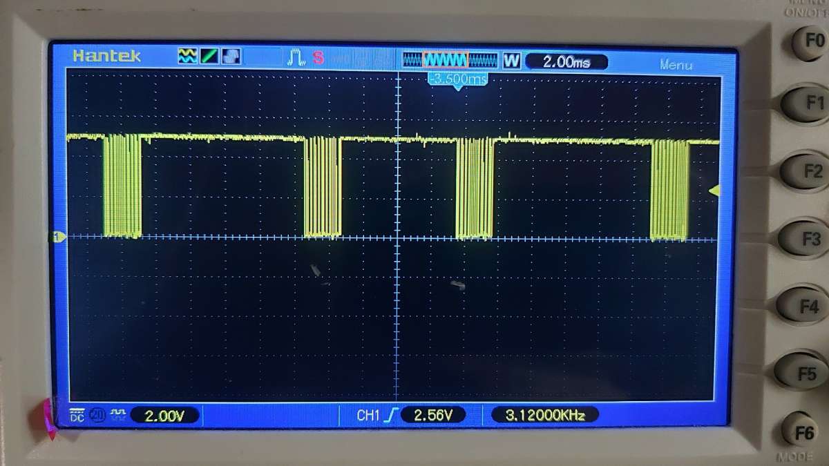

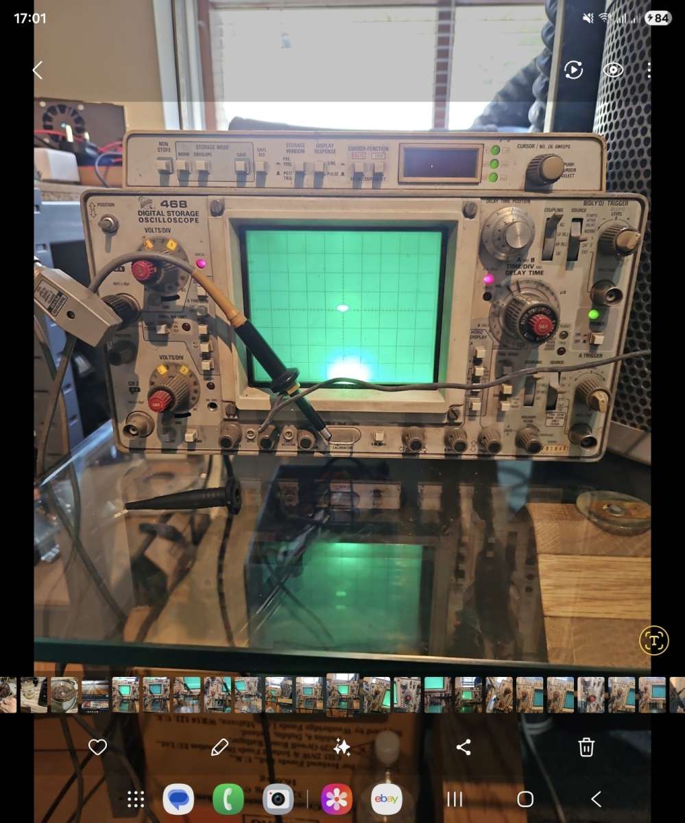

                      The picture shows my attempt at translating what he pins are. I put a scope on the pins to see if I  could get any readable signals (don’t know what to expect) from the pins (monitor not connected).
                      TNC150_VIDEO D PLUG copy
                      11 Volts shows up OK on pins 23/24. A steady 5 Volts is showing on pins 16/17.
                      Pins 21/22 are earth.

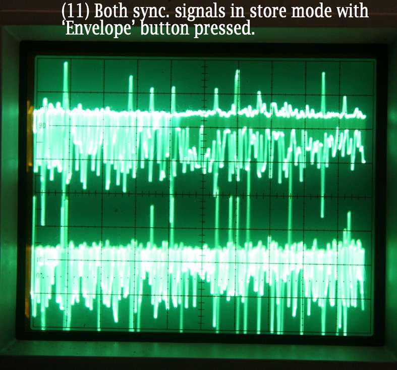

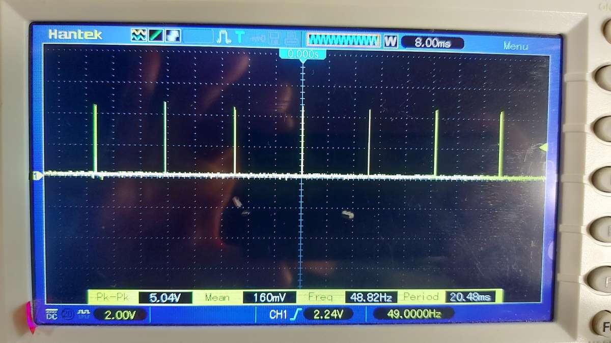

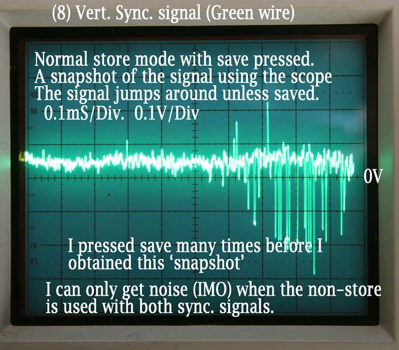

                      I can get some sore to signal on Vert and Hor. sync but it is not steady (if they are hor. and vert. sync. ????).
                      I would have thought that the sync. signals would be generated by the BE 211 board and not the TNC 150.

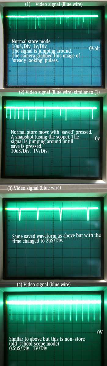

                      Video has some sort of signal. I have photo’s of scope and will post.

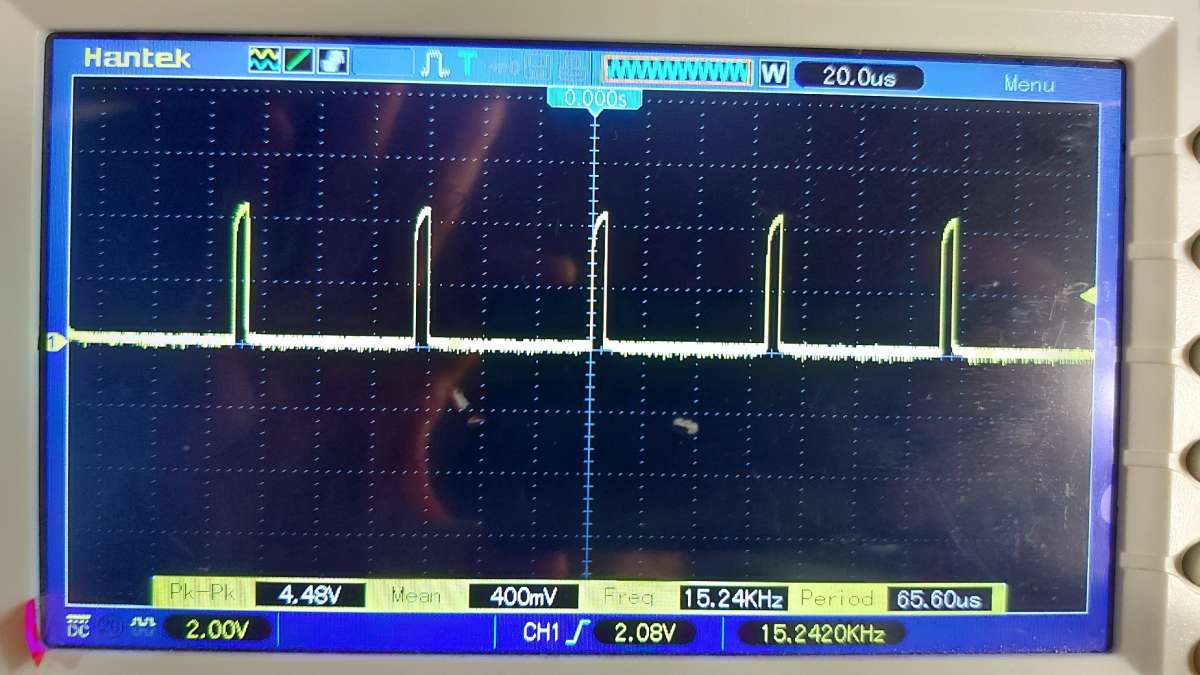

                      #856401
                      seemack
                        @seemack
                        Hi Tomtnc
                        Good choice on the caps. Best way to deal with them.
                        The TNC has a video card in it so it generates all the video and sync signals. It’s the second board behind the keyboard.
                        So for me to run my 151B as a 155B I need to swap out that display board and the 1st board which is the processor board. The screen needs to stay with the display board. Ie be411 with 155B and be211 with 151B. Also the keyboard needs to be swapped out if I want to use the 4 graphics buttons otherwise all other parts can remain. Note the lower board has the J8 video plug soldered to it so I had to make converter cables so I didn’t need to swap that board out.
                        Here are the pinouts and screen adjustments ramblings I’ve sketched and you are correct in your pins with pins 16/17 being intensity to give the light and dark highlights on the screen.
                        17841822475123051302946294011699
                        Here is also my comparison of pins and measurements between the 155B and 151B. Note the H and V sync frequency are not to any standard and also why the be211 and be411 monitors cannot be swapped between each system.
                        17841832208711448071214587297457
                        The video and Intensity pins will show around 5V and then dropping down towards 0V to indicate what graphics and intensity to display so is not a constant.
                        The H and V sync will be a constant spike of around 5V and the oscilloscope can measure the frequency as shown in my scratching above.
                        You will need an oscilloscope not a multimeter to measure these.
                        Hope this helps explain it.

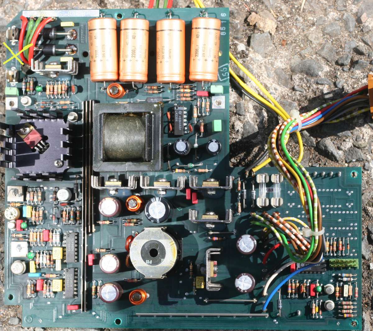

                          Tool out the TNC 150 control box and removed power supply.
                          It would appear that some of the capacitors are already changed as they look new and the solder is different to the original.
                          There was one original (amongst others) I changed as it was reading high on the ESR meter.
                          I have to purchase more caps. to change the rest (same with the display).

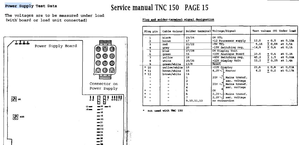

                          The power supply was not working, most of the outputs dead (or so I thought). The supply to the main processor board was showing 2.5 volts instead of 12 Volts, thats between pins (on plug) one and two.
                          The -15Volts (switching reg., pin 4 on plug) was showing 2V.
                          After some toing and froeing I realized that you MUST have the power supply loaded to get it to come on at all.
                          There should be a low volume, high pitched buzz coming from the board as I see a high frequency transformer (ferrite transformer) (the switching regulator referened above???). There was no audible buzz. But eventually I decided to plug in the power supply and it came on.
                          It’s like those switched mode power supplies you can take from a desktop to power something else. You must load them to get them to fire up and come on at all.
                          x power supply
                          The picture is the power supply board. There is a fuse missing at the yellow X (top left). I put in a 60mA fuse.
                          Is this fuse needed. Seems strange to have a fuse holder and
                          no fuse. There is no label to tell what size fuse to use.
                          I can take it out now and see if it is needed since I got the supply to work.
                          All voltage seem to be OK except the + 45V (pin 7, yellow wire). It is showing 65 Volts.
                          What is the function of the outputs on the plug labeled ”switching reg.” Pin 4 and 7, (-15V and +45V ) ?
                          Are all voltages (except the display power, pins 5 and 8) measured with respect to Pin 1 described as 0V TTL or is it relative to earth?
                          powerSup_plug
                          I will try again with the display plugged in as I am not too sure if that missing fuse was stopping the whole thing from coming on last time.
                          Thanks for your time.

                          #856734
                          seemack
                            @seemack
                            Looks the same power supply as my 151B but I don’t remember a fuse there. Those 4 very large gold caps will be OK. Looks like all the others are OK.
                            Yes it’s a switch mode power supply hence why the manual has loads next to the voltage settings.
                            I couldn’t get the voltage levels set as per the manual either and 65V rings a bell which worried my but it’s been fine for a long time. My display voltage was over 12v and when I run the screen with the 11v from a power supply you could hardly see the screen with its brightest settings  so I was happy with that.
                            I’m not exactly sure on the -15v and 45v.
                            I don’t think it makes a difference on the earth for measuring
                            Plug it in and see how it goes. It might be your screen

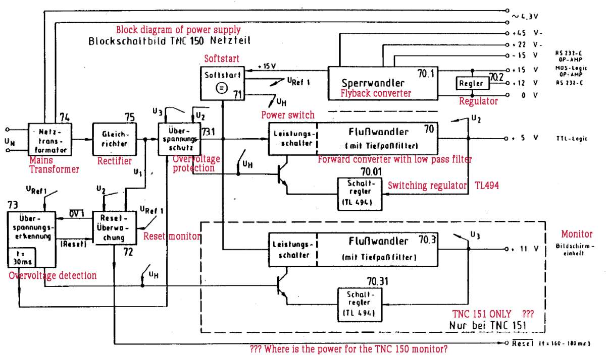

                              Block diagram of power supply translated to english courtesy of google.
                              Power_supp_block_diagram
                              Would you think the display power is totally independent from the other supplies looking at the block diagram?
                              There seems to be a bit of an error in the TNC manual as it says in the block diagram that only the TNC 151 has the 11v output. But it must include the TNC 150 too (surely!) There are two TL494 in my power supply.
                              I could try running my display from (say 12 or 13 volts) a bench power supply. I don’t think that’s the problem as it shows bright when the machine is switched on at the very start (then it goes off).
                              Will connect it back up today.

                                  Yes the 11V power circuit is totally separate from the rest of the circuit. I’ve actually spent a long time tracking all the circuit and drawn it up when I was having issues. I have also powered the system like you on the bench and have used a separate power supply for the 11v to the monitor.

                                    I took photos of all the boards. There are 5 boards after the key board namely (from front to back).
                                    Firstly the key pad is in front, then:
                                    Memory board.
                                    Main uP board.
                                    CLP uP board (+ display driver).
                                    Analogue board (has x, y, z, IV, + handwheel inputs).
                                    SE board.
                                    Then comes the power supply + Terminal board (connections at the back).
                                    The connector board is the ‘mother board’ that all the boards above slot into and lies on the bottom of the box.
                                    There is an IC missing from top left of the CLP uP board (+ display driver) or was it never there?
                                    One side of the socket only seems to have tracts coming from it.
                                    There is also two eproms missing from the memory board (two empty sockets) but it may be because there
                                    is no IV axis?

                                    I will obtain some data sheets and see can I make any progress with the video driver signals and put up some scope pictures of my ‘sync’ pulsed (or lack thereof).
                                    I am looking at what maybe sync. (x and y) pulses coming out of the display driver D (centronics) plug (on the back of the TNC)
                                    They are short duration pulses. What should they look like. I am not getting square waves.
                                    There is also some stuff coming on the video wire.

                                      Yes the lower board is the motherboard that I was talking about.
                                      The display output is not a square wave. The Hsync and Vsync are ~5V pulses while the video and Intensity are 5v dropping towards 0v in a very scramble way. Post the oscilloscope views and let me have a look at them.

                                        Cranked up the scope. I am not an expert scope operator. It is dual trace digital storage scope. It also has non digital (non store) old school shall we call it.
                                        I obtained the signals below. It can be frustrating having someone else do scope work especially if they are not too sure about what they are doing! All signals are relative to the brown wire (the 0V Digital) and measured from the opened-up video D plug that sticks into the back of the TNC 150. It is a BE 211 display.
                                        small Video
                                        small Intensity
                                        small hor_sync
                                        small vertical
                                        Small Dual_Hor_Vert
                                        small sync_Envelopes
                                        They don’t look as you described.
                                        Tomtnc

                                          ok here are my scope photos for TNC151B with BE211 monitor. 24pin display connector on back of controller. All ground to pins 7&8 0V digital as you have done.
                                          Vsync from pin 4&5 49 Hz
                                          20260722_162037
                                          Hsync from pin 2&3 15.24 kHz
                                          20260722_162129
                                          Video from pins 18&19 ~5Volts with dropping values (Inverse TTL signal)
                                          20260722_162515
                                          Intensity from pins 16&17  ~5Volt again inverst TTL with dropping values.
                                          20260722_174045
                                          The V and H sync are easy signals to capture with auto setting but the video and Intensity are not as easy as they are jumping around a lot but expanding the screen time and then doing a screen capture allows you to then retract the time period and see these signals but they may be different to mine due to different points in time. The important thing is they are 5 Volts with the dropping values.
                                          Yes the V and H sync are very different with H measured in the kilo Hertz range while the V is measured in the hertz only.
                                          Now on startup you should have some LEDs coming on and off. Wait 20 seconds as it will be doing a memory test by default where some LEDs are turning on and off. Screen will then say “Operating Parameters Deleted” in German in my case. All LEDs will be on at this stage. Then, press the CE button. Screen will say “PLC: Program Memory Deleted” in German All LEDs will be on. Press CE again and all LEDs will go out. Screen will be saying “Machine Parameter Programing” in German which is the MP input screen. All LEDs are out as shown below.
                                          20260722_172507
                                          Hope this helps
                                          Craig

                                            I will go back and have another look with the scope. I don’t believe those signals are coming from my port.
                                            The scope is old (from the 80’s) I have it this many a year. It is a Tektronics 468 as per the picture (from ebay). I will test it on a signal generator just to make sure is is operating correctly.
                                            The operator is not an expert!
                                            TEK_468
                                            Where would you start if there are no signals coming from the port?
                                            I can purchase a new 9937 Video controller chip (£20, its on  the CLP uP + display board) and replace it but I would imagine that would be a long shot.
                                            Google suggested removing all the eprom’s and replacing them into the sockets with perhaps some switch cleaner.
                                            Tom

                                                Not much to add about the signals just a recap.
                                                Tested scope on signal generator and it is OK.
                                                Went back to signals. Disconnected the actual screen plug from the TNC and connected
                                                scope to wires on the back of the D plug. (No load on the signals).
                                                Similar story to above.
                                                The intensity signal is noise.
                                                It has +5V DC out. ‘Signals’ consist of spikes about 0.4V peak to peak. I can only see the ‘signals’ with the AC input chosen (DC blocked) otherwise the trace goes off screen.
                                                Intensity not working.
                                                The Video signal is +4.5V. Negative going pulses are appearing, some dropping down about 2 Volts. Most of the pulses only drop down 0.5 Volts.
                                                Perhaps there is something sensible coming from the video wire?
                                                H. Sync. +0.1V DC with some positive going spikes of approx. 0.3 Volts magnitude. 0.03mS between pulses. (approx.)
                                                V. Sync. Similar to H. Sync. but with more pulses.
                                                V & H not working.
