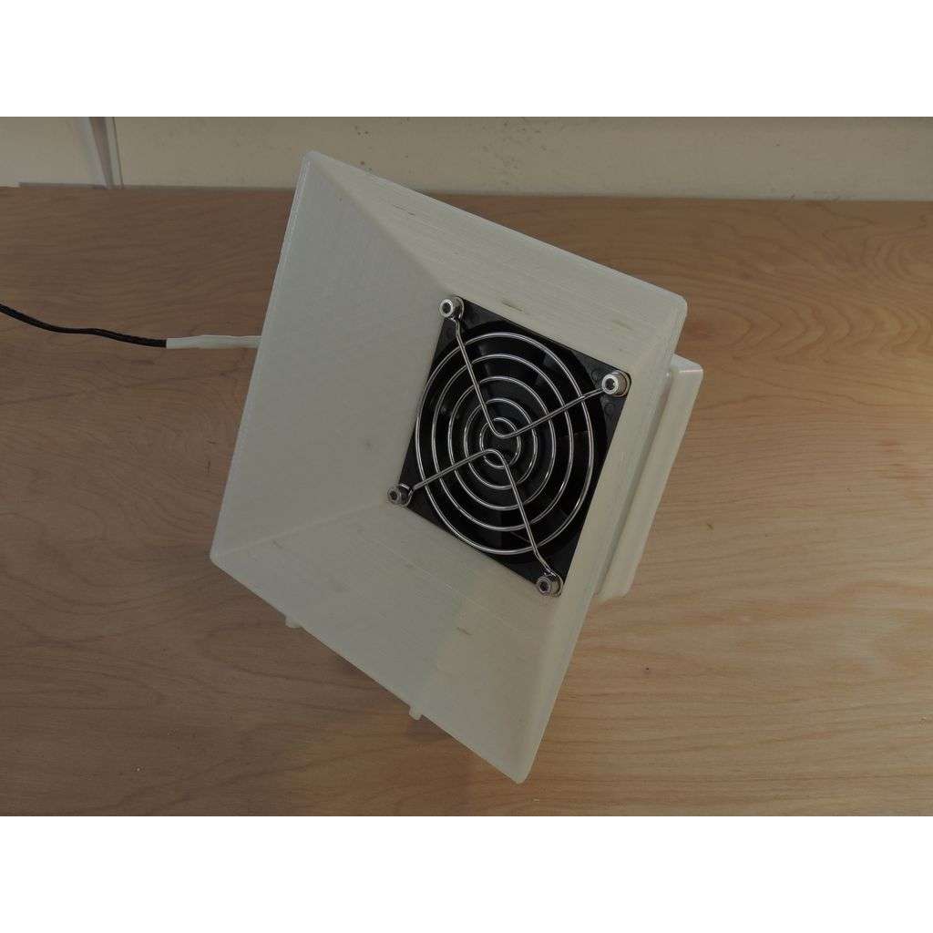

        I haven’t uploaded many of my workshop accessories to Thingiverse – many of them are either too basic or specialised.
        This one is a solder fume fan I made a good few years ago, it uses a 4″ computer fan to suck fumes through a double layer of carbon filter from generic cooker hood refill material.
        https://www.thingiverse.com/thing:6922387

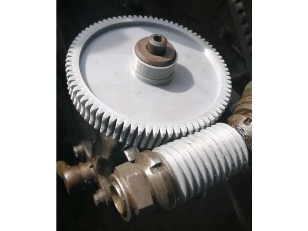

                And, more workshop related,  Worms and wheels for a Pittler B2 lathe.
                https://www.thingiverse.com/thing:5983017

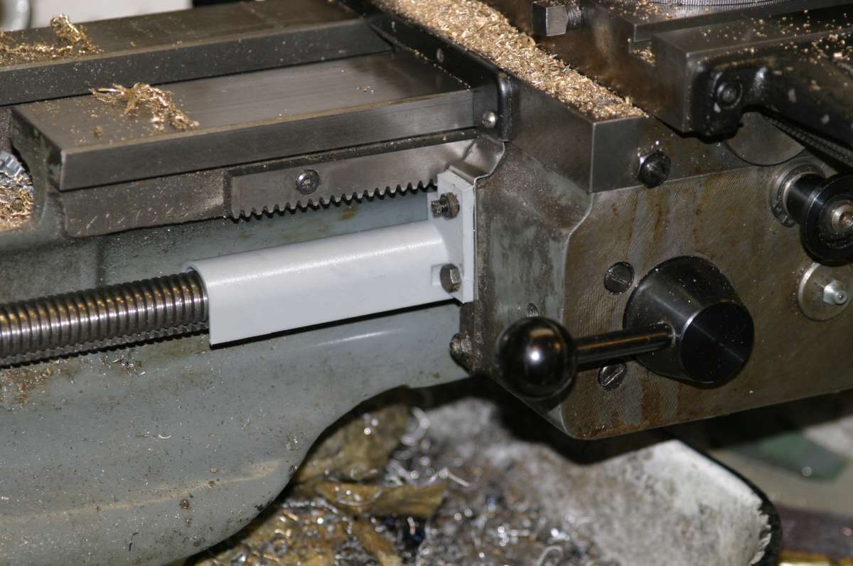

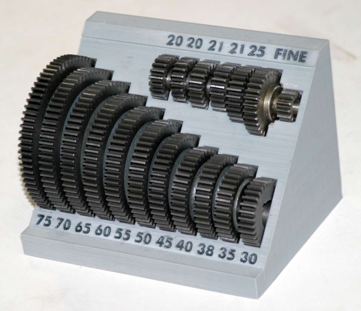

                    A Myford change gear rack including two 21 tooth and the fine feed cluster with dust cover.
                    https://www.thingiverse.com/thing:7376094
                    Myford Change Gear Holder
                    Gear Holder Cover

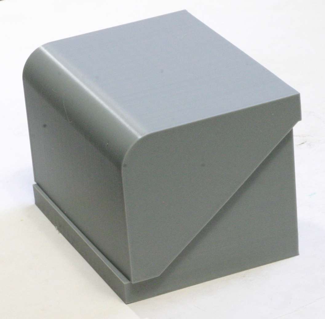

                    A lead screw swarf guard to replace the original marginally effective Myford one.
                    https://www.thingiverse.com/thing:7376087
                    Leadscrew Swarf Guard

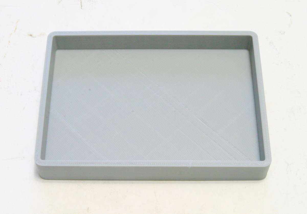

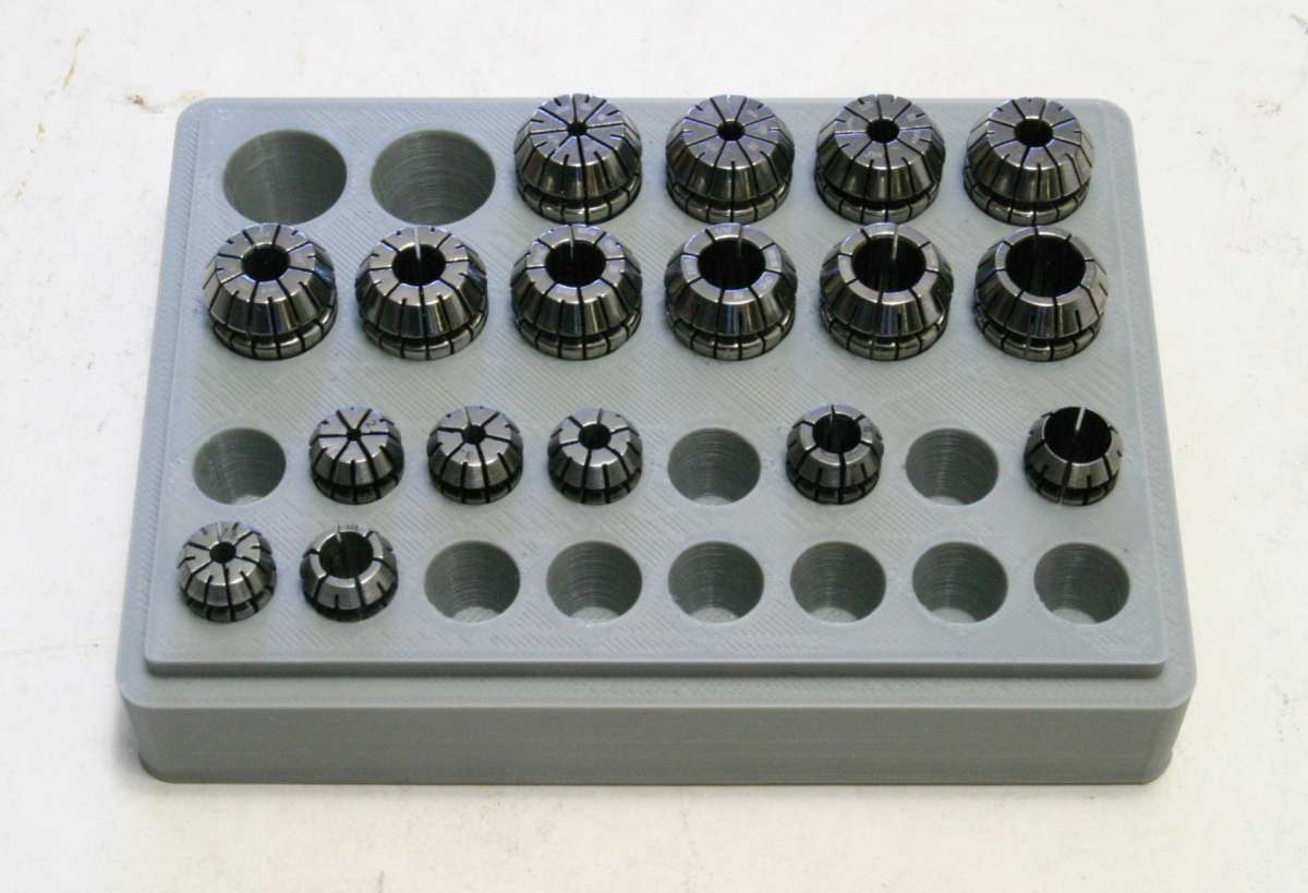

                    A ER11/ER16 collet storage tray with cover.
                    ER11_ER16 Collet Rack
                    Cover1

                        I just noticed that I forgot the link in my post above for the collet holder. Could you maybe add it to my post? Senior moment!       https://www.thingiverse.com/thing:7376090

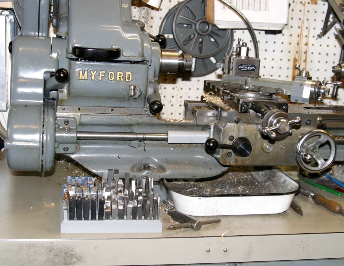

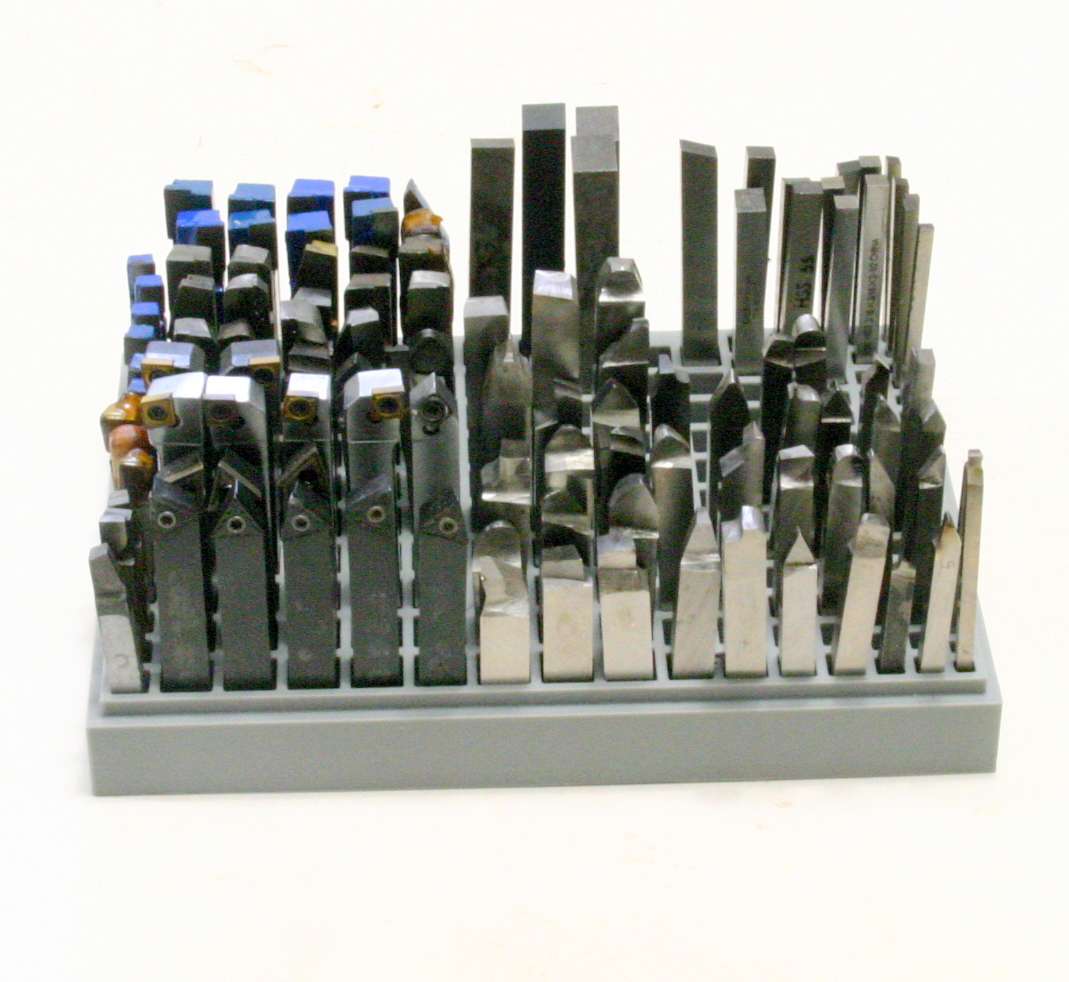

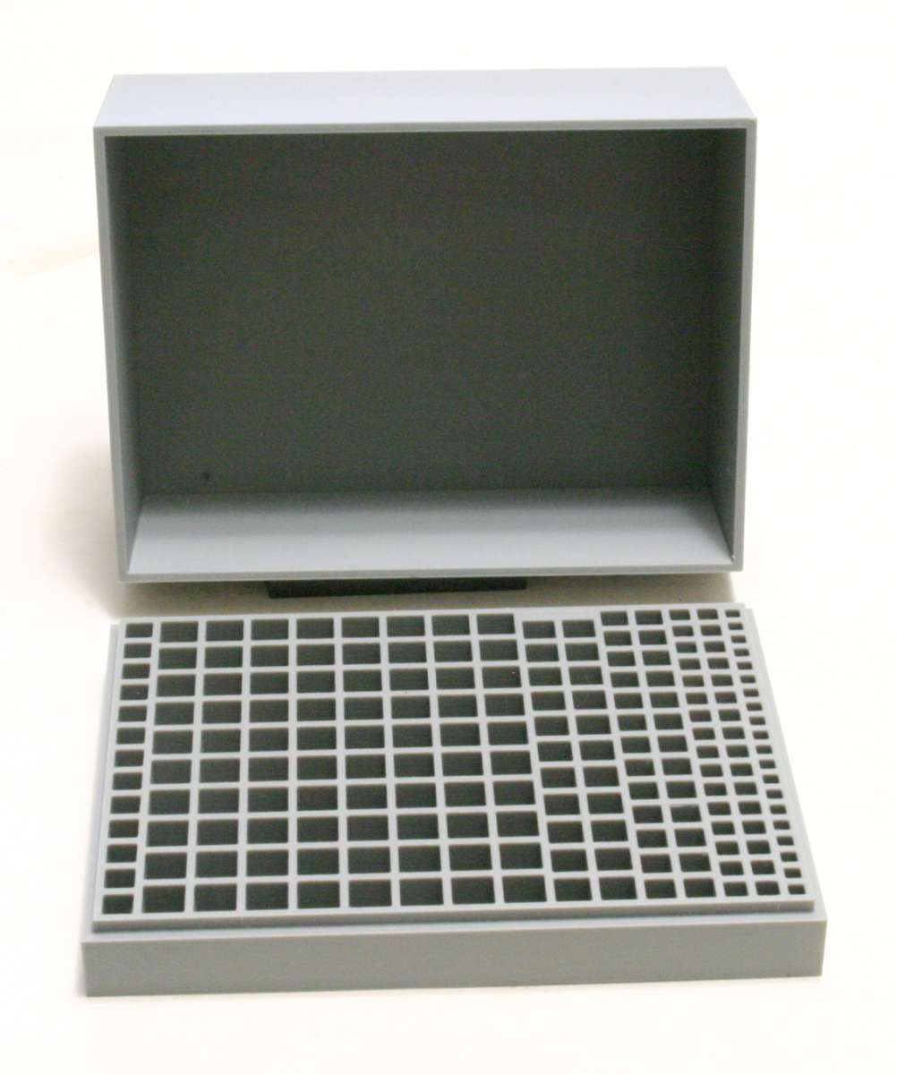

                              Having gotten fed up with cleaning the swarf off the tool bits stored in a plastic container on the lathe bench, I came up with this:
                              https://www.thingiverse.com/thing:7384593
                              ToolBitHolder
                              ToolBitHolder1
                              ToolBitHolder2

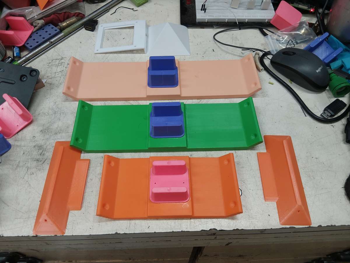

                                This is not my own work!
                                downloads
                                This is the work of ‘ Olfoundryman’ on another forum and presented as a series of videos by him on youtube.
                                Hopefully I’ll get the furnace going in the near future and make some, since I had a few MDF moulding boxes suffer from flooding in the pit under the shed…
                                These are my prints of his patterns, the ghastly mess on the bench is all mine as well. 😮
                                20260718_161428
