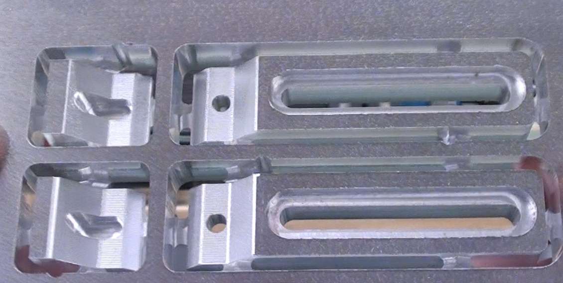

                                      #852249
                                      John Hinkley
                                        @johnhinkley26699
                                        I did get out into the workshop and ran the parallel cutting G-code.  I had been too conservative with the number of passes and it took one hour of actual machining to do all four pockets.  This is being edited down to a merciful few minute clips on the video but I’m glad to say that no milling cutters were harmed during those operations.
                                        Here is a still from the video hopefully showing the finish achieved.
                                        off the machine
                                        As Julie has said, little or no burs except perhaps on the top edges of the long recesses.  I’ll be attacking it next with the Dremel and cutting discs before the final clean up and tapping.

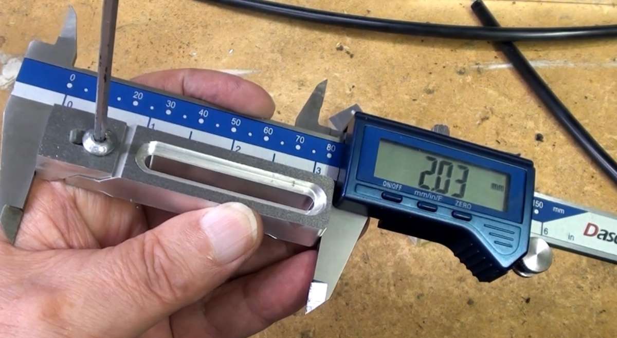

                                        #856524
                                        John Hinkley
                                          @johnhinkley26699
                                          At long last, and not before time, I’ve shifted my backside into gear and ventured out into the workshop to finish off the sliding clamps that I started ages ago.  Once you’ve watched the video on YouTube, you’ll be able to spot the machining error that I didn’t see in time to correct on the Carvera Air.  And I was standing right next to it!
                                          The parts could still do with a bit of tidying up with some very fine carborundum paper on a flat surface to pretty them up, but that won’t improve their performance any.
                                          Here’s a still from the video for those that don’t want to watch it:
                                          Measure end
                                          #856541
                                            Thanks for the update John. Look forward to seeing them in use when you get round to making something else.

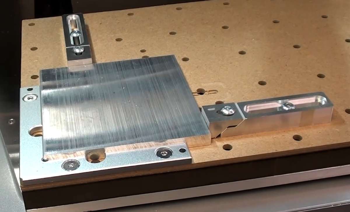

                                            #859062
                                            John Hinkley
                                              @johnhinkley26699
                                              Here you are, Jason, better late than never.  The clamps actually performing useful work.
                                              Clamps in use

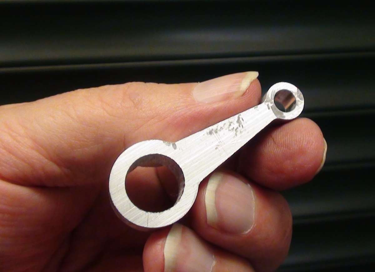

                                              Spurred on by the recent thread about collaboration with an engine design and production, my interest was rekindled in an internal combustion engine that I started a couple of years ago, but in which I lost interest.  I have been playing around with ideas of a modular engine; that is to say, one which is fundamentally constructed from separate crankcases, cylinders and all the other paraphernalia associated with it but can be simply “ganged” together and elongated from a single cylinder unit into a two- or four-cylinder combination with the necessary extension of the crankshaft, camshaft etc, with the possibility, with suitable design of the crankcase, to be inline, Vee or horizontally opposed.  (I’m thinking perhaps a hexagonal shape to the crankcase together with the appropriate style of crankshaft.)
                                              Every journey starts with a single step,so they say, so I took my original design for a conrod, modified it several times and finally (for now!) decided that a built-up crankshaft was probably the way to go – rather than one made from a single piece of material.  This would allow me to use one-piece conrods instead of my first iteration with split big ends.
                                              Back to Fusion with the design done in Alibre Atom for the production of G-code.  Of course, this didn’t go without mistakes as you can see in the upcoming video (still in production) but I did end up with four connecting rods.
                                              This is a sneak preview of one of them
                                              sneak peek
                                              I’ll be the first to admit that I’m not the most proficient with a file, as witness the marks on the face, but I’m hoping to polish the blemishes out with fine carborundum paper and oil or water.

                                                    They have come out quite well
                                                    You could start the ramp from 1mm above the work which does reduce the amount of air cutting and also have the ramp speed the same as the main cutting speed as you are not going that deep per pass.
                                                    The heavy engagement at the end of the contour where the tool moves away into the stock can be avoided if you set the ramp out to zero degrees, have a look back at the clamp thread where I suggested that.
                                                    Big ends I would use Pocket to do those which does not leave that spigot in the middle waiting to jam the tool when it breaks loose. I suspect you have a positive number for the bottom height rather than a negative to take you just below or your axial stock to be left was greater than what the bottom height was below the work.
                                                    If you are going to put a reasonable size chamfer on parts then you can leave a thin layer of metal all round and not use the tabs, the chamfer will remove the material left around the work.
                                                    #859206

                                                      Thanks for your comment.  Great progress? – I don’t think so -but maybe one step forward …. you know the rest.
                                                      Jason,
                                                      I agree, Pocket would have been a far better choice for the big ends.  I should have picked that up during simulation runs, but didn’t.  I use Fusion so rarely, it’s almost like having to re-learn it every time.  I set the bottom height to stock bottom -0.2mm.  I thought that would be enough.  Maybe the material is not uniformly thick – unlike me.
                                                      Anyway, I bought two pieces of material anticipating a minor catastrophe like this, so I’ve decided to revisit the design, make a few minor tweaks and take up cudgels with Fusion so that I can do it all over again, hopefully with a better result this time.  At least I’ll end up with eight con rods to play with!
