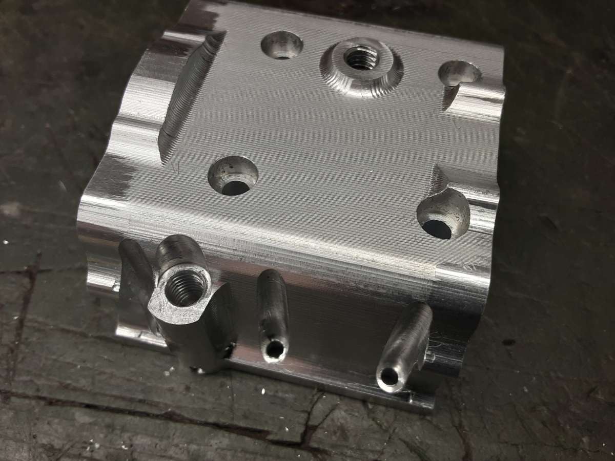

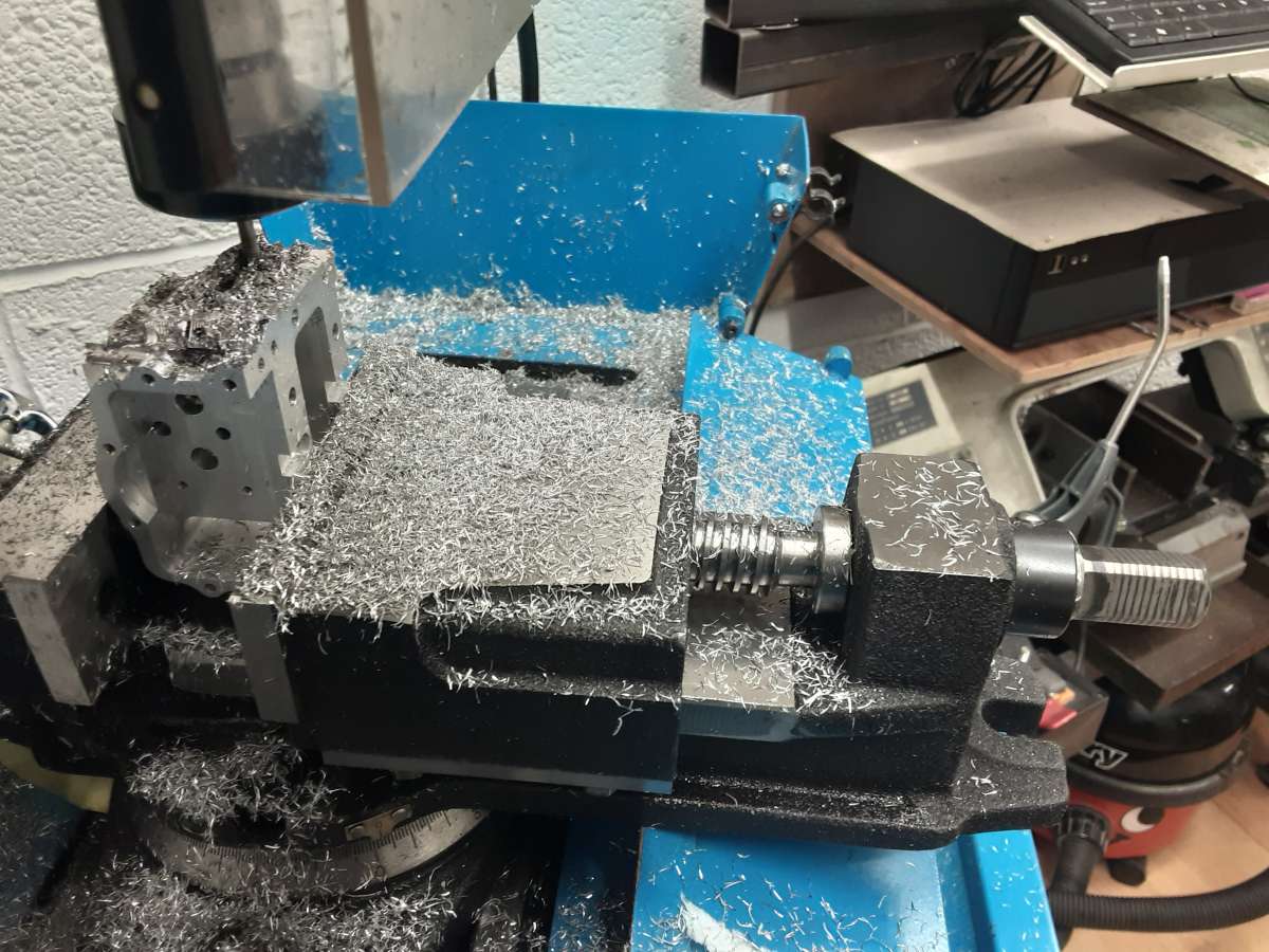

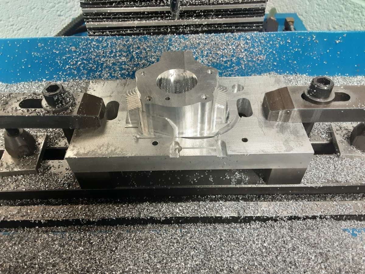

                Slowly turning blocks of Aluminium in to engine parts ,that I hope, resemble my CAD models.
                Steve20251118_14483320251118_18320020251119_155445

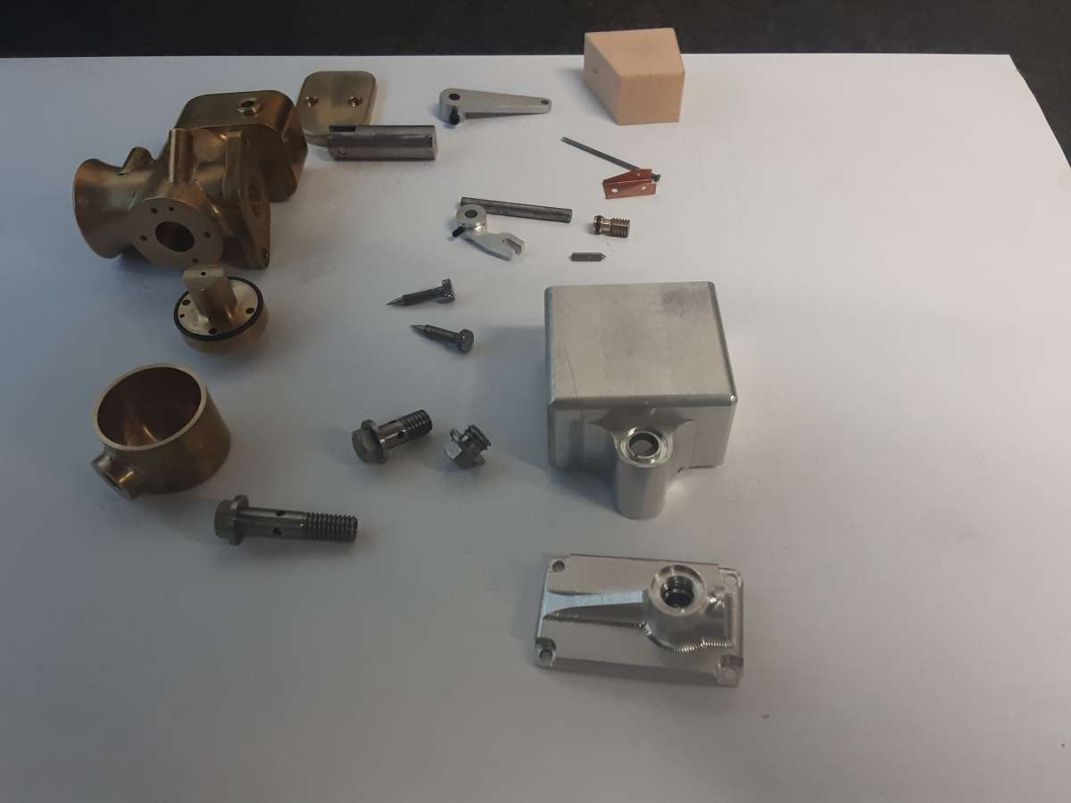

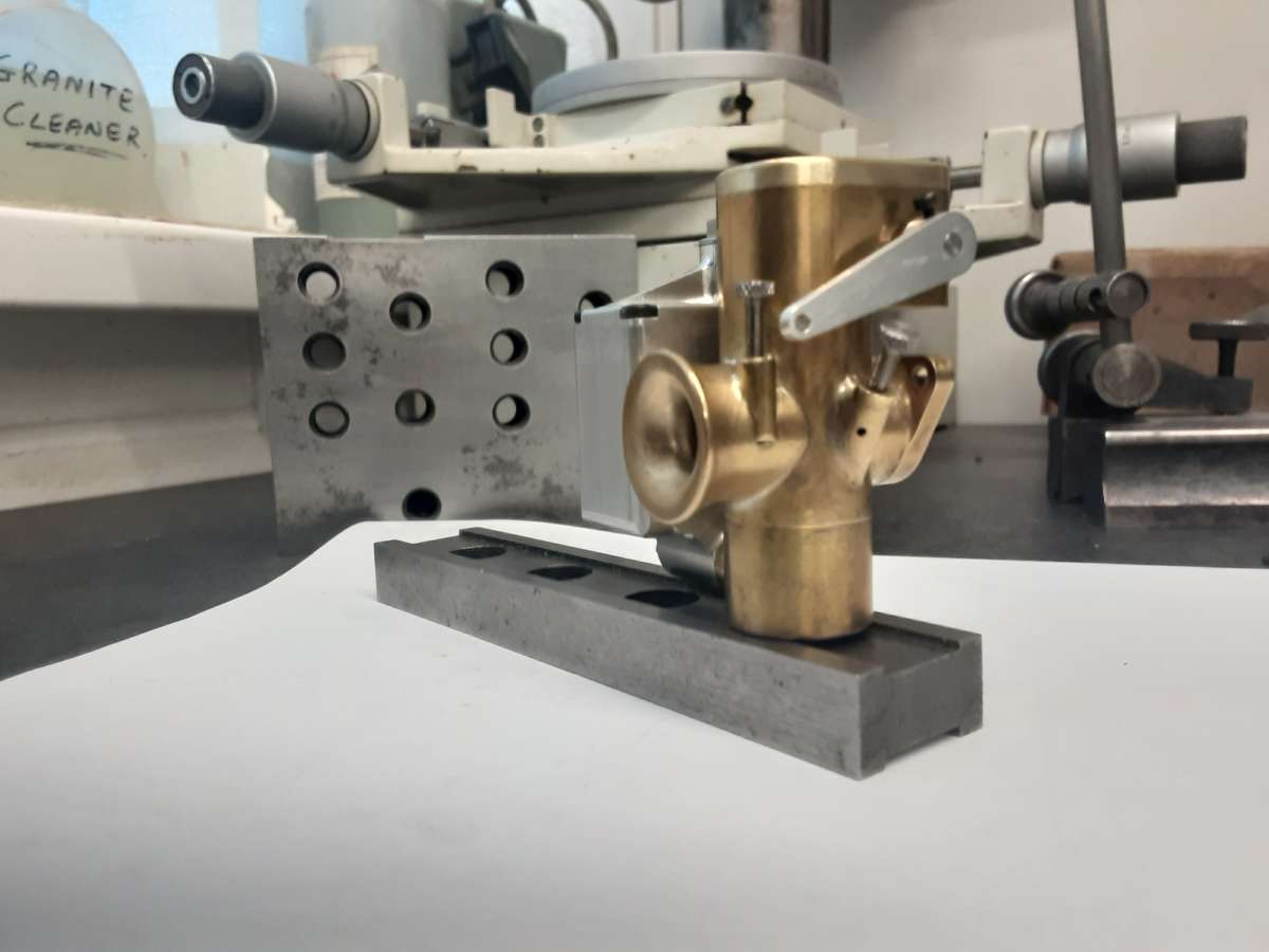

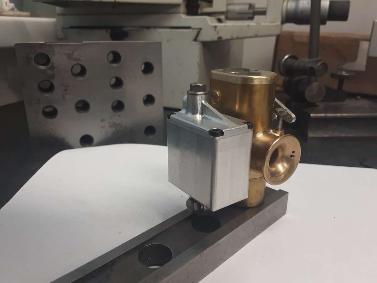

                  SteveP
                    @stevepye68246

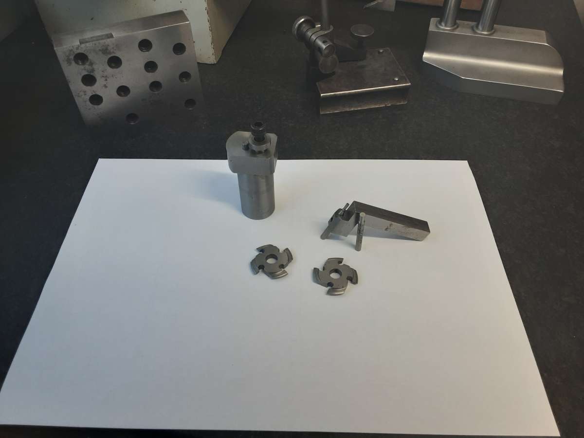

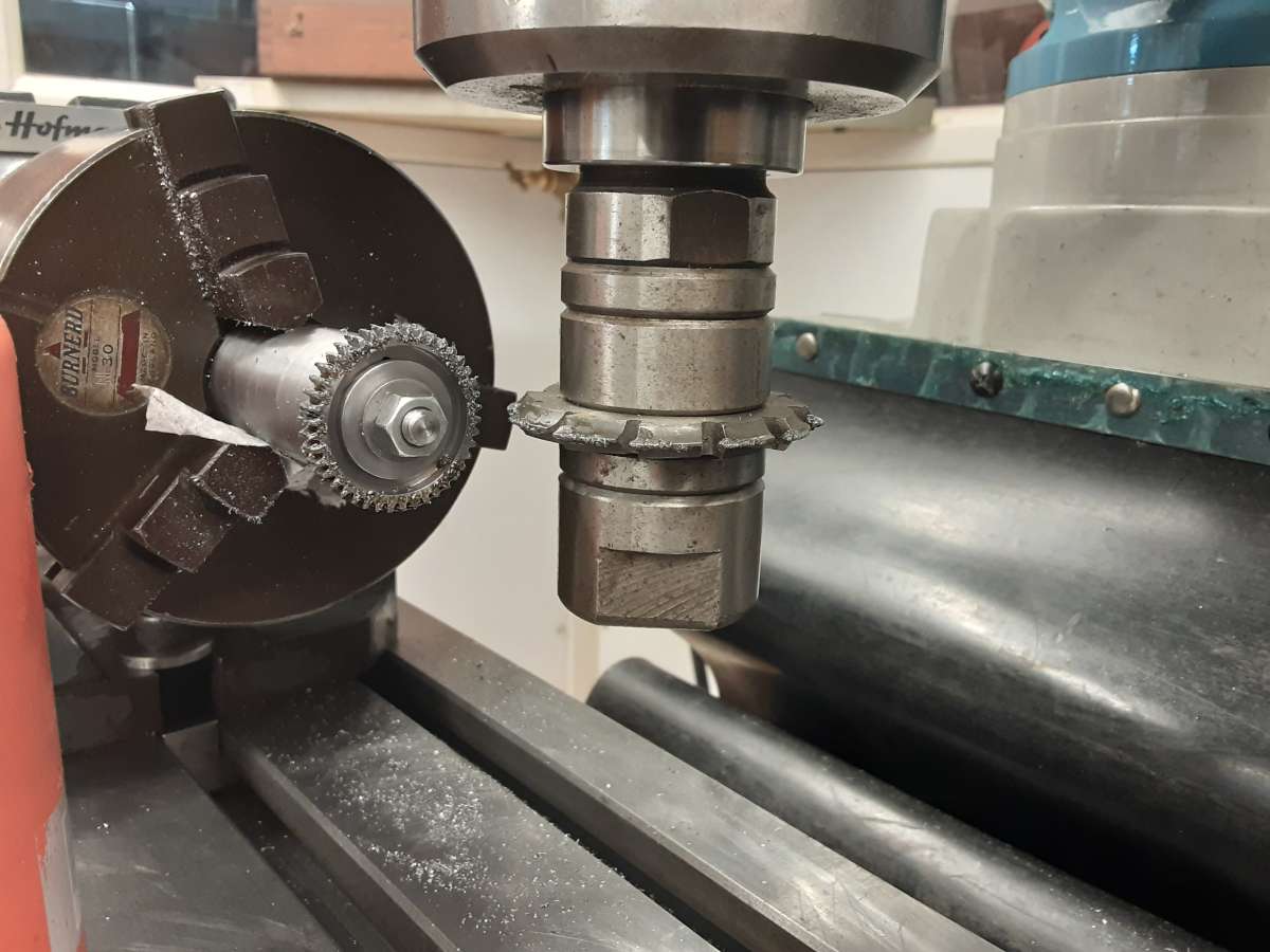

                    20251120_143636Gear cutters for crossed helical distributor drive.20251120_15401120251120_15253020251120_153952Individual Carburettor parts and assembled Carburettor.
                    Steve

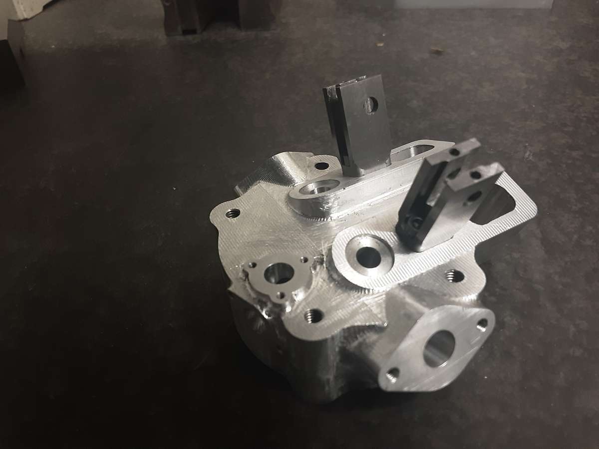

                        #827800

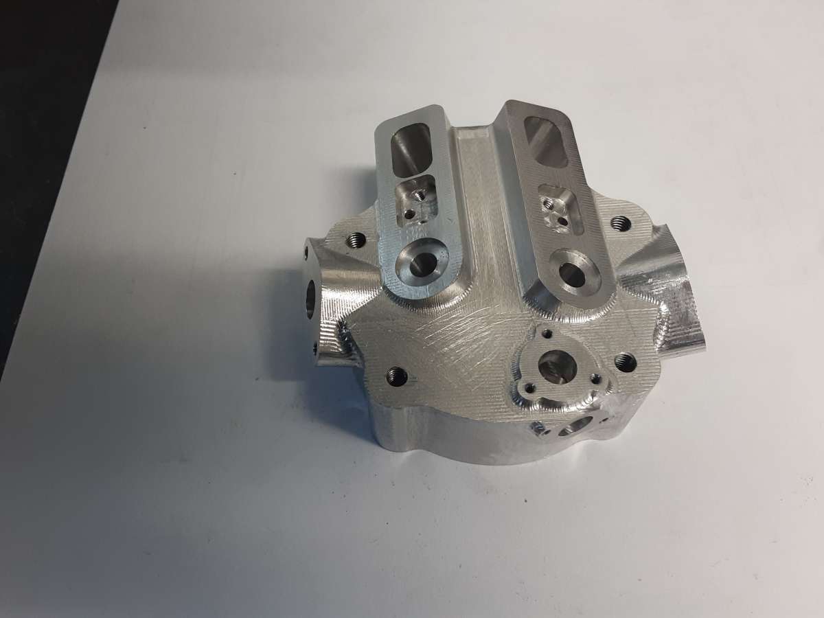

                        SteveP
                          @stevepye68246

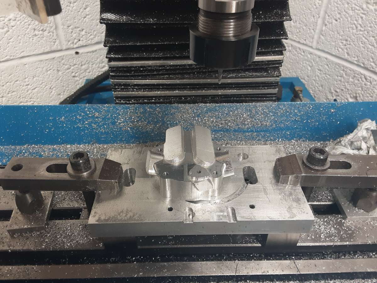

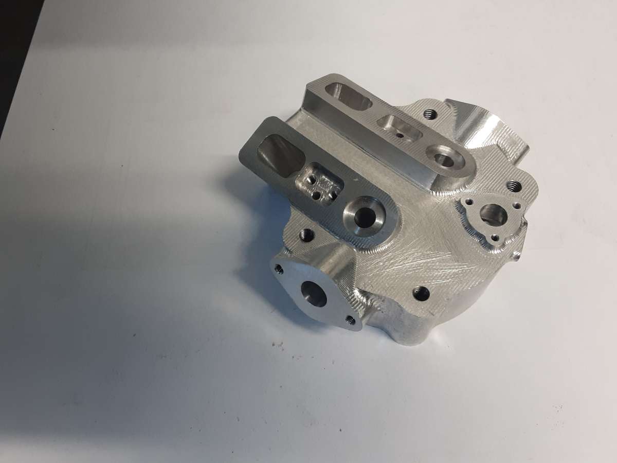

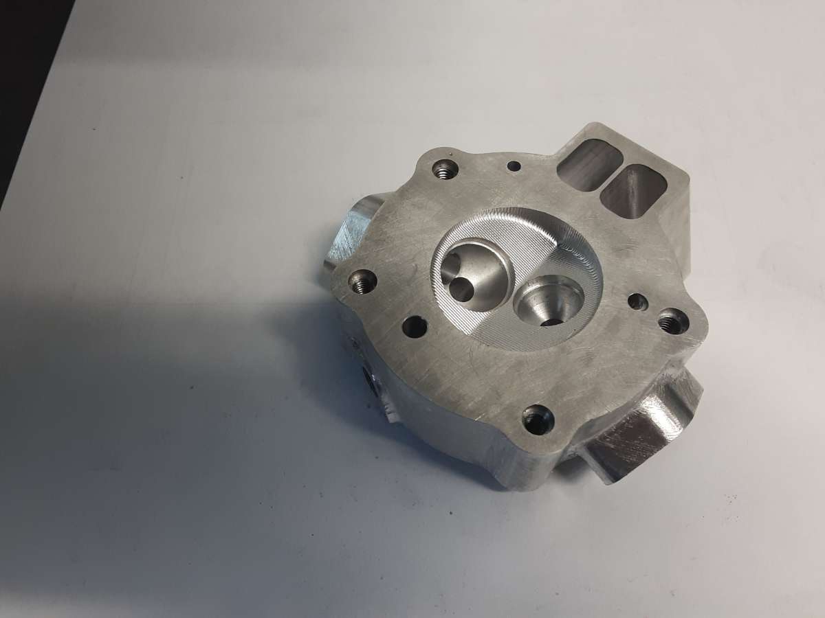

                          20251205_12224720251205_12221920251205_122234Head  nearly finished , just the spark plug hole and head stud holes to complete.
                          Still a number of individual parts to make, for a finished head assembly.
                          Steve

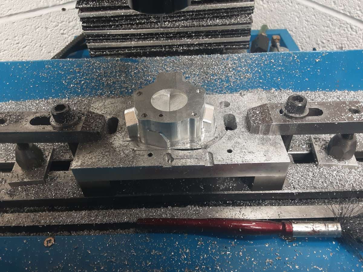

                          #827806
                            Looking good, can you remind me what machine you are using?
                            #827966
                            SteveP
                              @stevepye68246
                              Thank you Roger B, renardiere7 and Jason for your positive comments.
                              Jason .

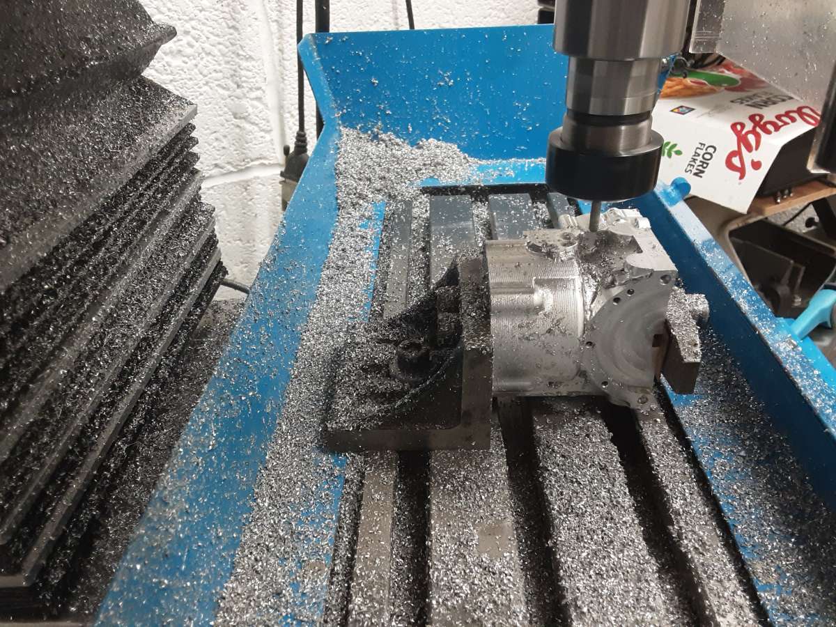

                              I have a KX3 CNC clone which I bought from SPG in Leicester, it stood idle for a number of years for various reasons and when I actually got around to using it, I was really disappointed. It took me at least 12 months to get it working cutting metal, the more I use it, the more problems I find, I think another strip down is needed.
                              Other than the outside profile of the cylinder head all other features are machined on a Myford VME milling machine and Super 7 lathe.
                              I use Alibre Workshop for producing cutter paths, I’m not sure it was designed for cutting metal. I’m fairly satisfied with the results , I learn something new ever time I use the Meshcam CAM software and Alibre Atom3D CAD, which I love using.
                              The cylinder block is next on my list for my CNC machine, this part needs all 4 sides machining separately, all sides need to align. I’ve found a way of achieving this in Meshcam which I couldn’t do when I first started using the software.
                              Anyone else using Alibre Workshop to machine parts?

                                That’s a shame about the machine not working as it should. Mine was a customer return and once I found what they had damaged was able to put it just about right and the machine has been fine ever since. I do need to revisit again as I have a very small amount of Backlash in Z and that is where the damage was.
                                I did have a quick trial of the Meshcam when Alibre first offered it but found it very limited compared with F360 (free version) which I had already been using for CAM. As you say it seems more aimed at the ganty router type user doing craft projects rather than engineering.
                                F360 is quite happy working from all sides, even angled ones as you just select that surface as your top and then a datum for X&Y

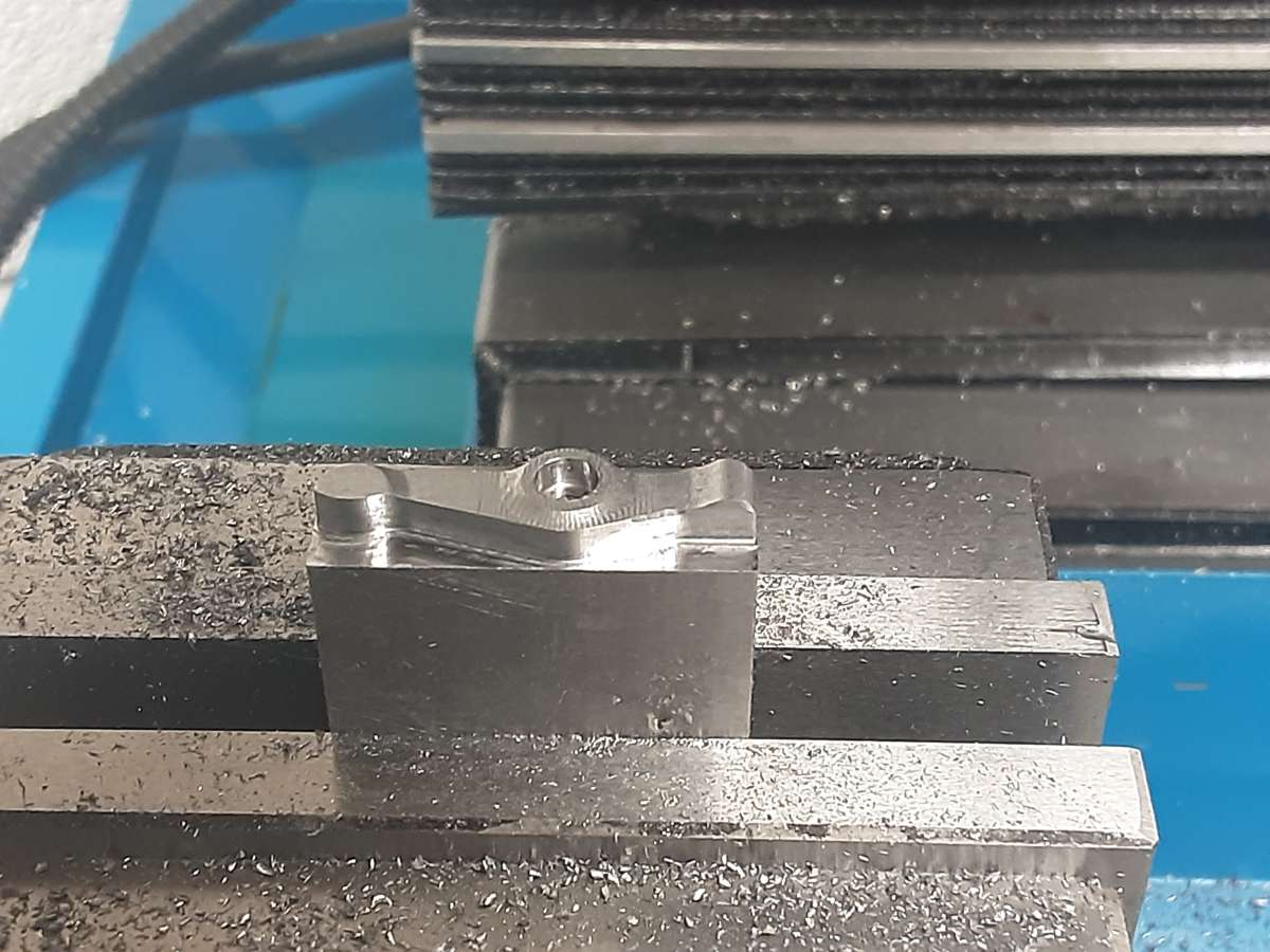

                                        Rocker pedestals finished and fitted.
                                        20251212_194821
                                        Fledgling Valve Rocker.20251212_195558

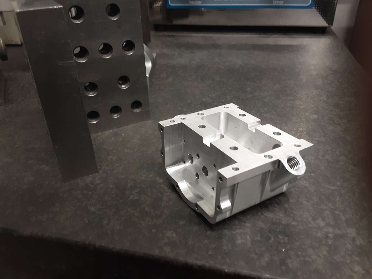

                                        #844490

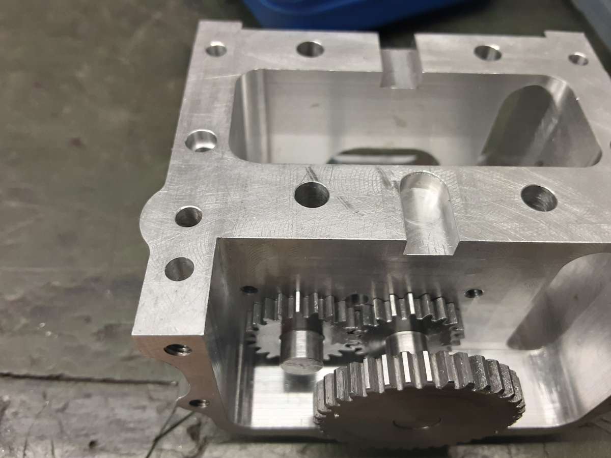

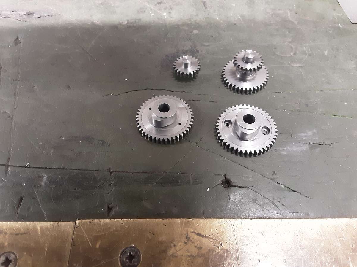

                                        SteveP
                                          @stevepye68246
                                          Working at a snails pace a few more parts have been completed.
                                          Sump, oil pump gears and drive gear ,inlet and exhaust cams with drive gears.20260414_21315320260414_21303720260413_21041420260413_20374820260311_15335420260414_213537

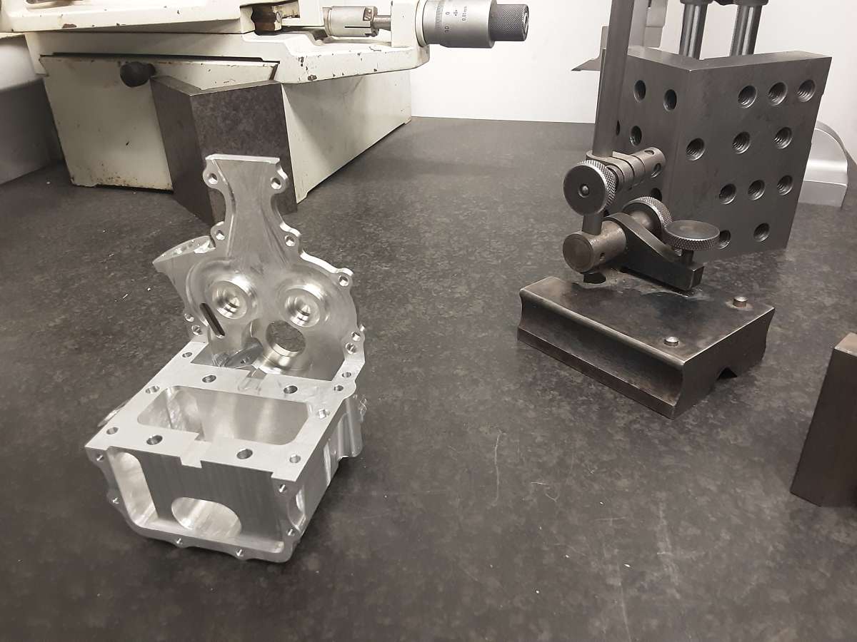

                                          SteveP
                                            @stevepye68246
                                            20260414_212336The main bearings will be bored on assembly of the sump and block.
                                            Steve

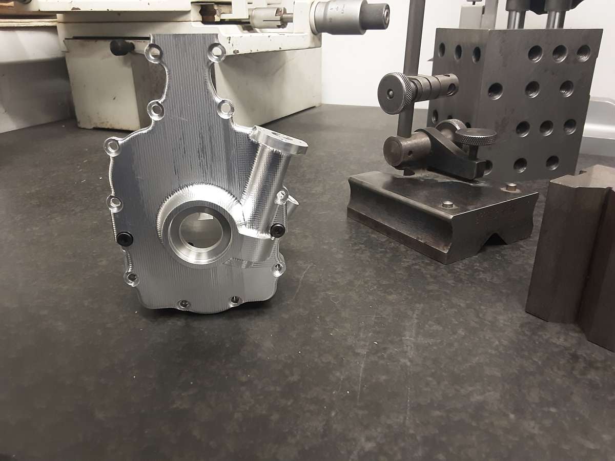

                                                Cam cover completed,  another part ticked off.
                                                Steve

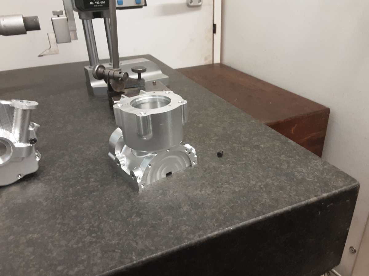

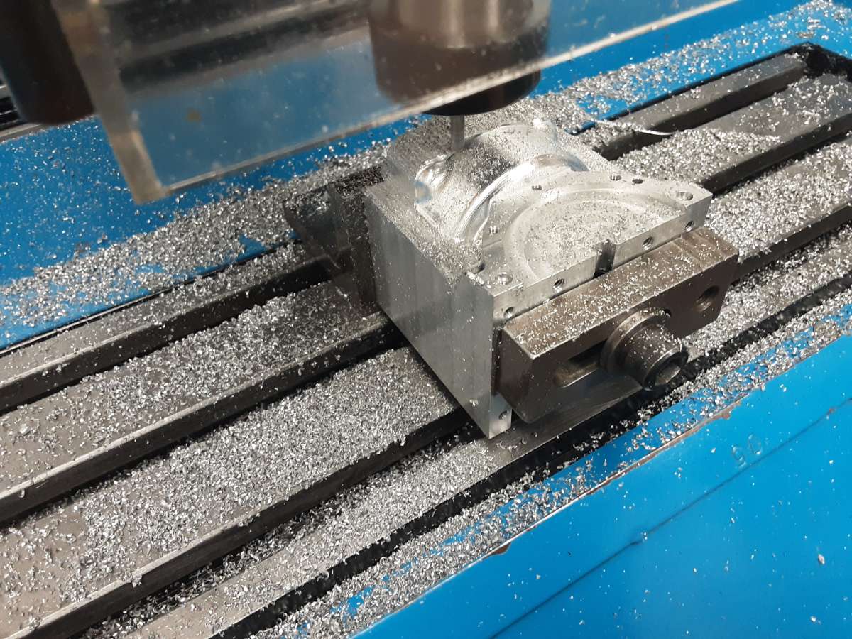

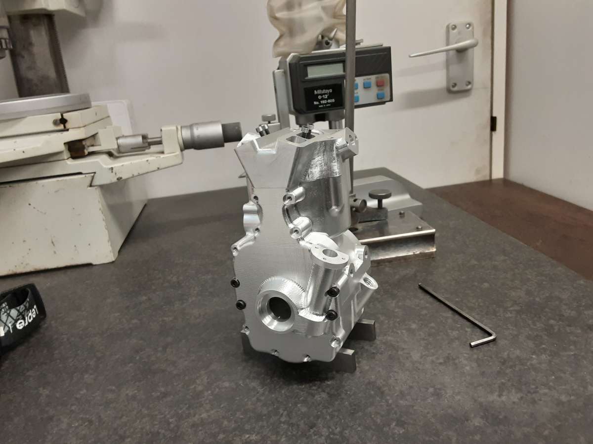

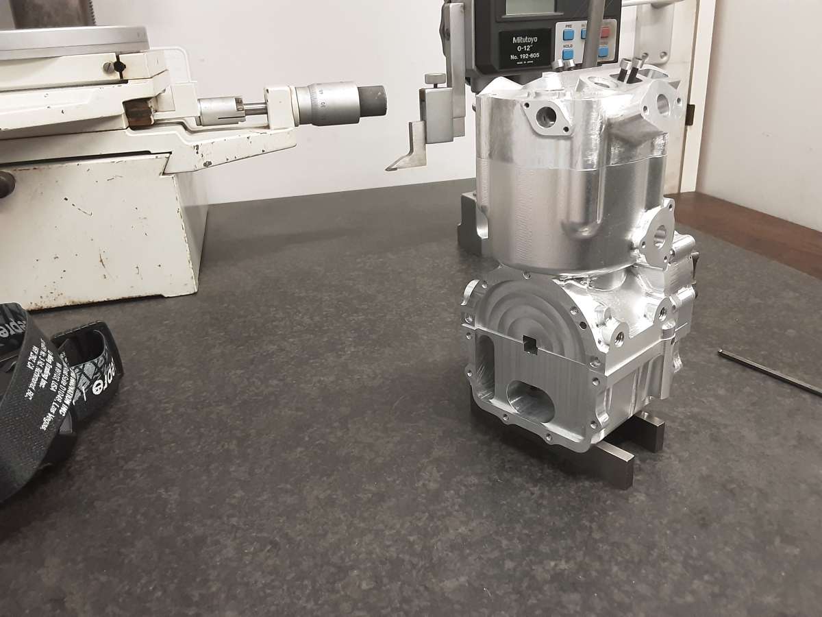

                                                #854662
                                                SteveP
                                                  @stevepye68246

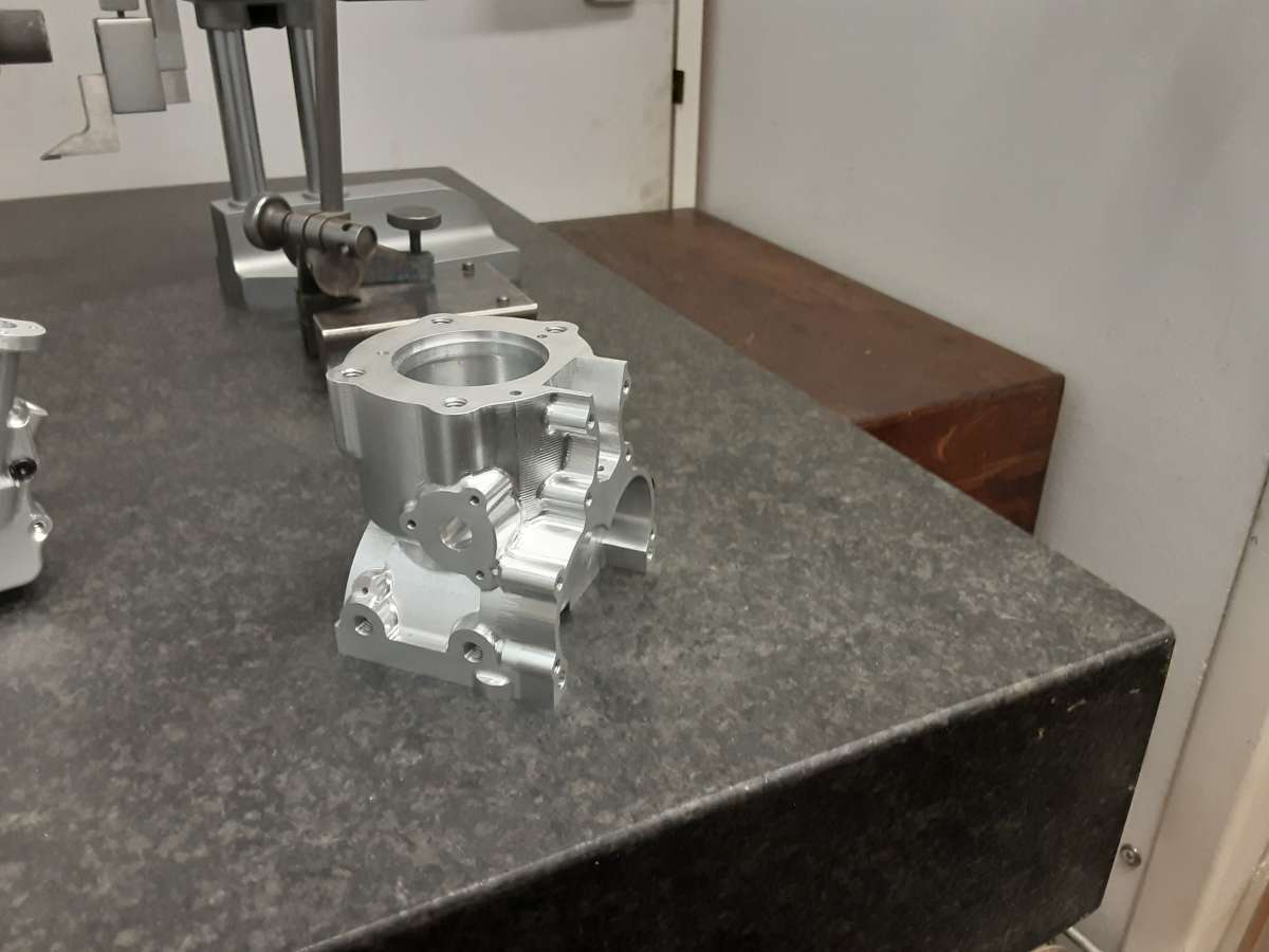

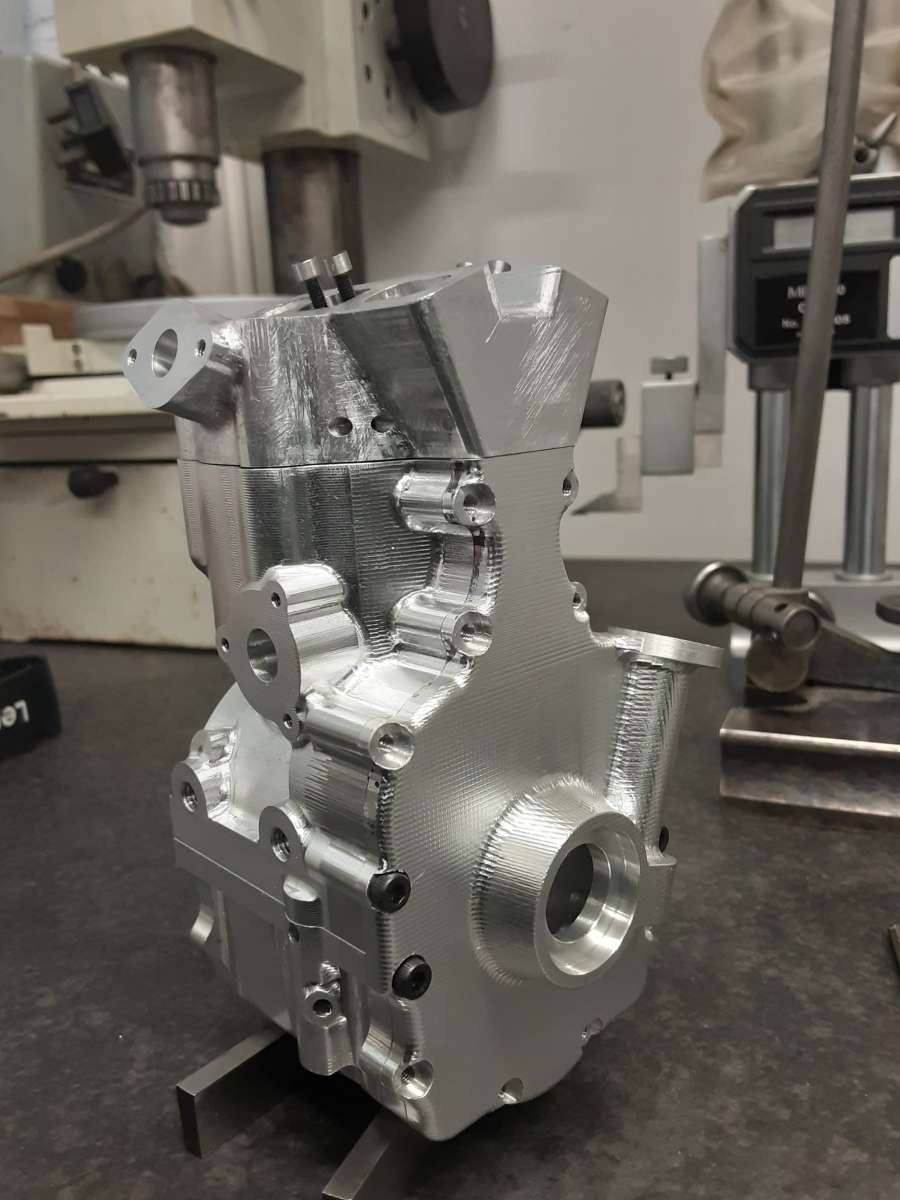

                                                  A little more progress.
                                                  20260630_22403820260702_19242820260703_21283720260703_21282820260703_21315620260703_21324820260703_213437
                                                  #854685
                                                  Diogenes
                                                    @diogenes
                                                    That’s looking great, must feel like a landmark to have the machining of those completed..
                                                    #854688
                                                      It’s looking more and more like an engine.
                                                      Does your CAM have a path similar to what F360 calls  “Pencil” ? If it does it would be worth using as it will go round the fillet where that large boss meets the end of the case and remove a lot of the material that has been left. It reduces the needle file work considerably
