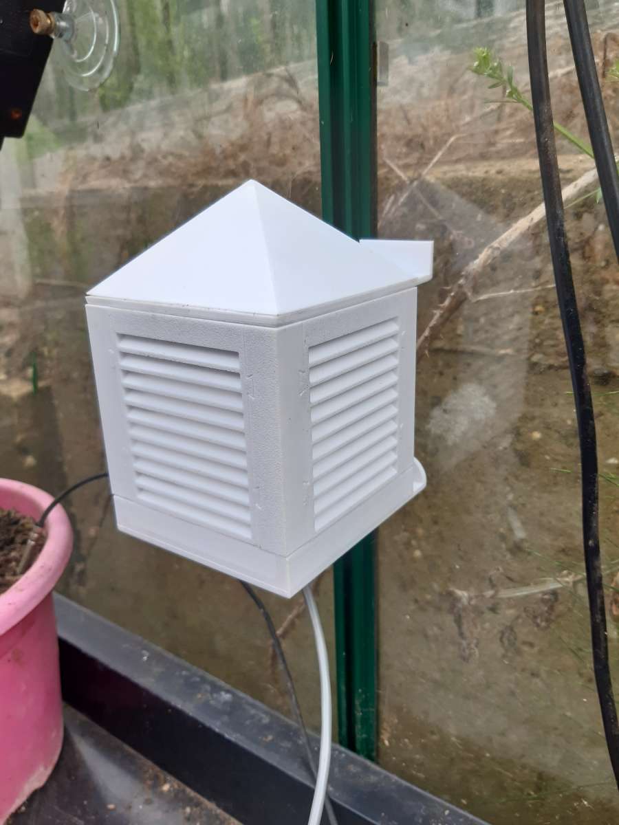

      Recently installed a couple of Stevenson Screen temperature and humidity probe housings to check on the greenhouse and garden. PETG. Mostly clip together with pinned and dovetailed joints. ‘Double glazed’ roof and floor, double louvres. No support needed for printing. A squirt of solvent cement holds them together more closely on the roof to side joints, but this was the first working prototype. Forgot the circular fillet on the top bracket 🙁 :-
      20260605_174213

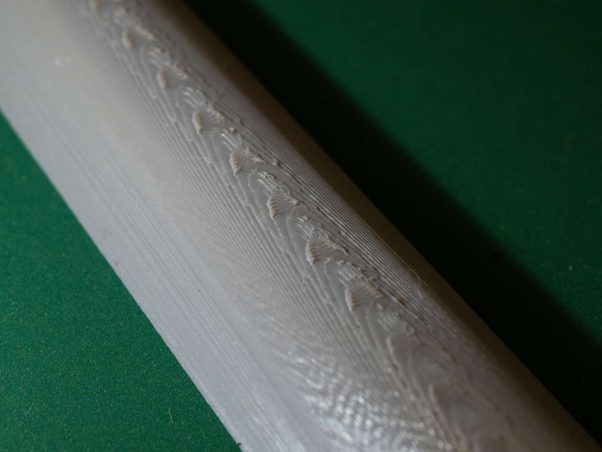

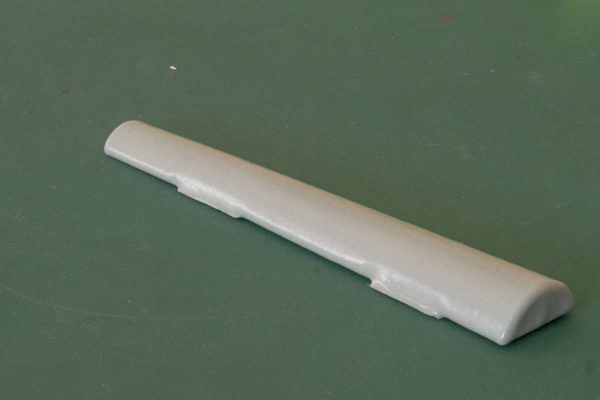

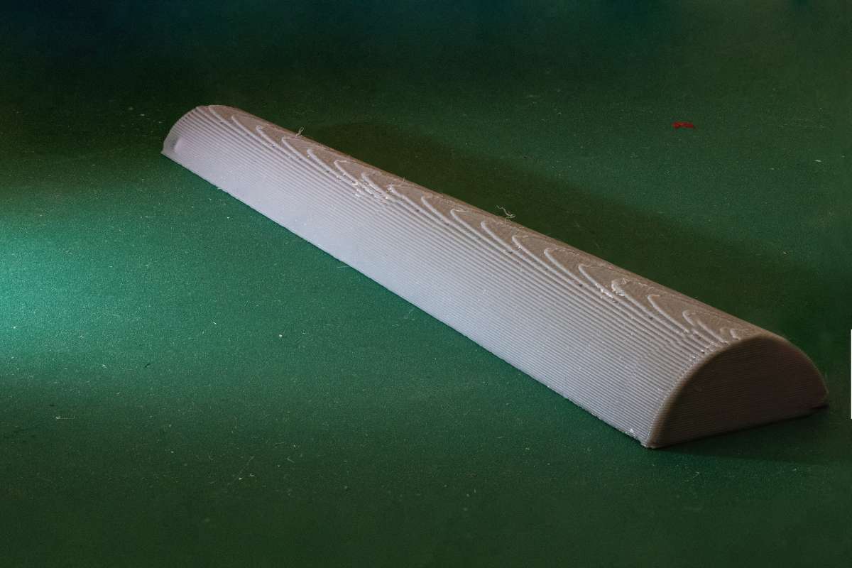

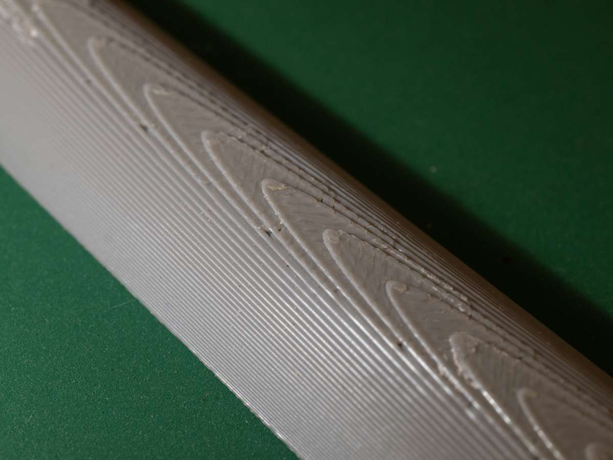

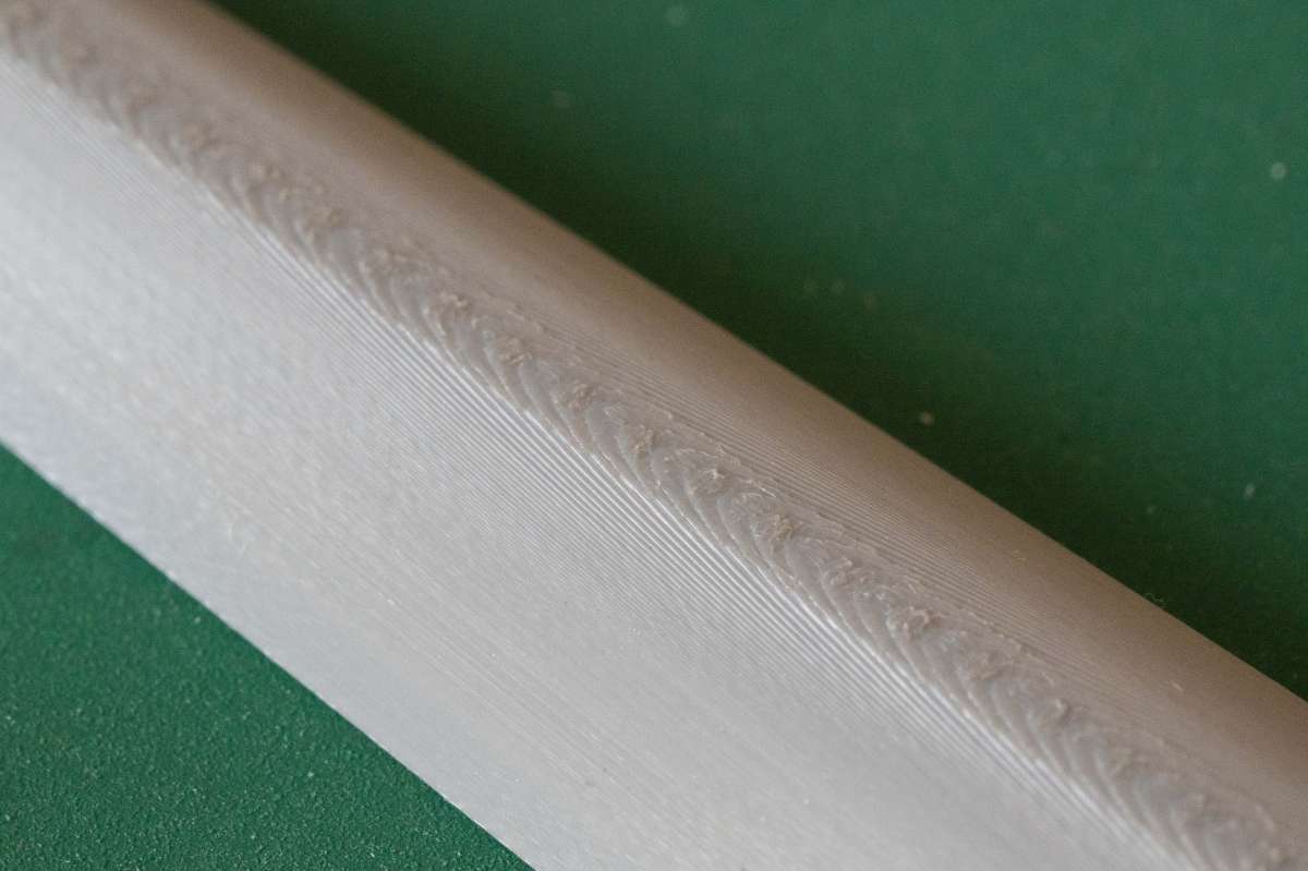

                    Jason has mentioned the problem of layer lines in 3D prints used as patterns for casting.  I’ve done some trials on an object that represents a flywheel spoke that tapers both in width and height.
                    This printed in PLA with a 0.2mm layer height
                    a Spoke PLA
                    Here’s a close up of the layers:
                    a Spoke cu PLA
                    and here’s a close up of the print done with variable layer height:
                    a Spoke Variable layer PLA cu

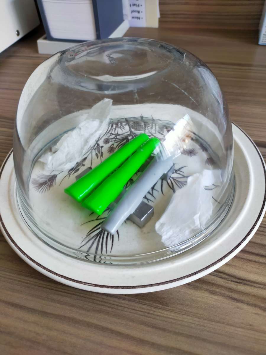

                    ABS is easier to sand than PLA but is also capable of being smoothed by immersing in Acetone vapour.  This spoke was printed in Glass Fibre ABS and then left in a vapour bath (for too long, the surface as oozed!)
                    a smoothed ABS GF

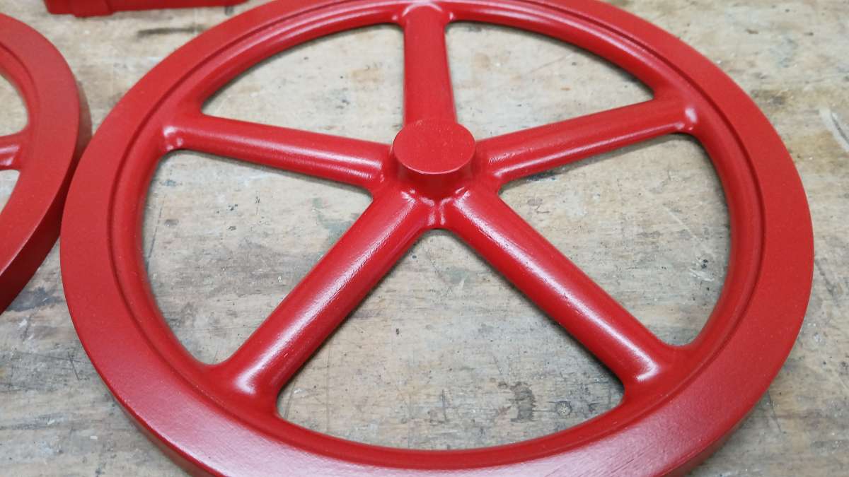

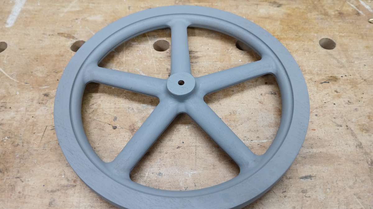

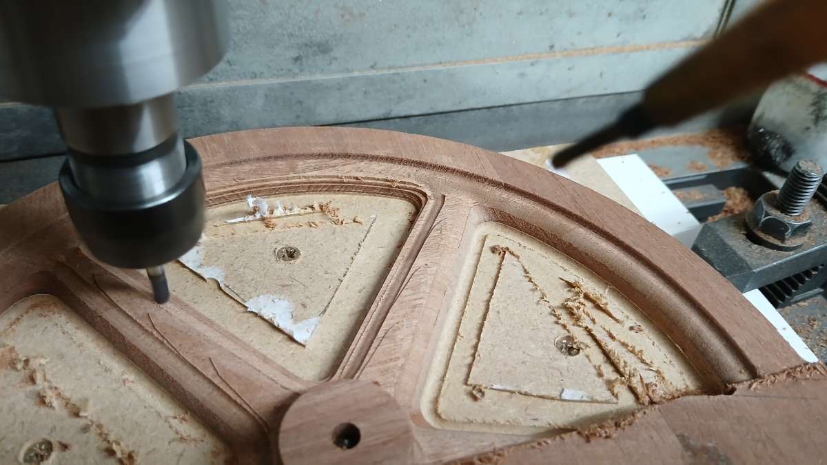

                      Thanks for the tests Rod. The variable height has helped but not wat I can get off the CNC
                      Interesting that you mention PLA ABS as I did have a pair of flywheel patterns done in that and had a go with the acetone. I think for my one off trial I did not have the ideal setup and it had little effect on the surface so I had to spend a couple or three hours sanding and then several coats of high build primer sanding between each. How did you use the Acetone, it may be worth me trying again?

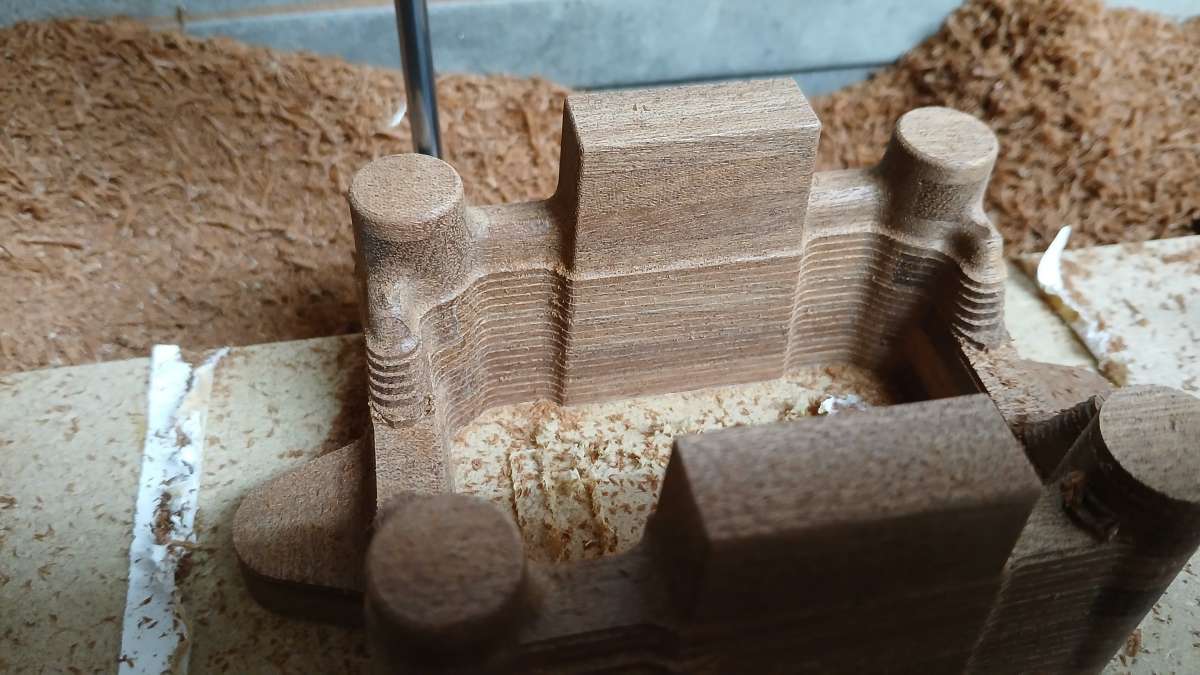

                      I had previously made the patterns from glued up layes of Sapelle using the CNC which only needed a light sand and a coat of standard primer. Where I came a cropper was bringing the wood patterns into the house to help some epoxy filler to set which had been used to fill the location pin holes. The wood was not from my usual sources and likely had a slightly higher moisture content and promptly warped in the centrally heated room. It went back flat after a couple of days in the workshop but I did not want to risk it moving again when sent to a hot foundry so bought the PLA Prints.
                      Half way through the finish cuts, you can see the similar layer hight lines that the previous roughing cut sleave, much like the prints but I think they were 0.5mm stepdown. Approx 9″ flywheel
                      20251024_155115
                      After a light rub with 180g and coat of rattle can primer
                      20251110_091523

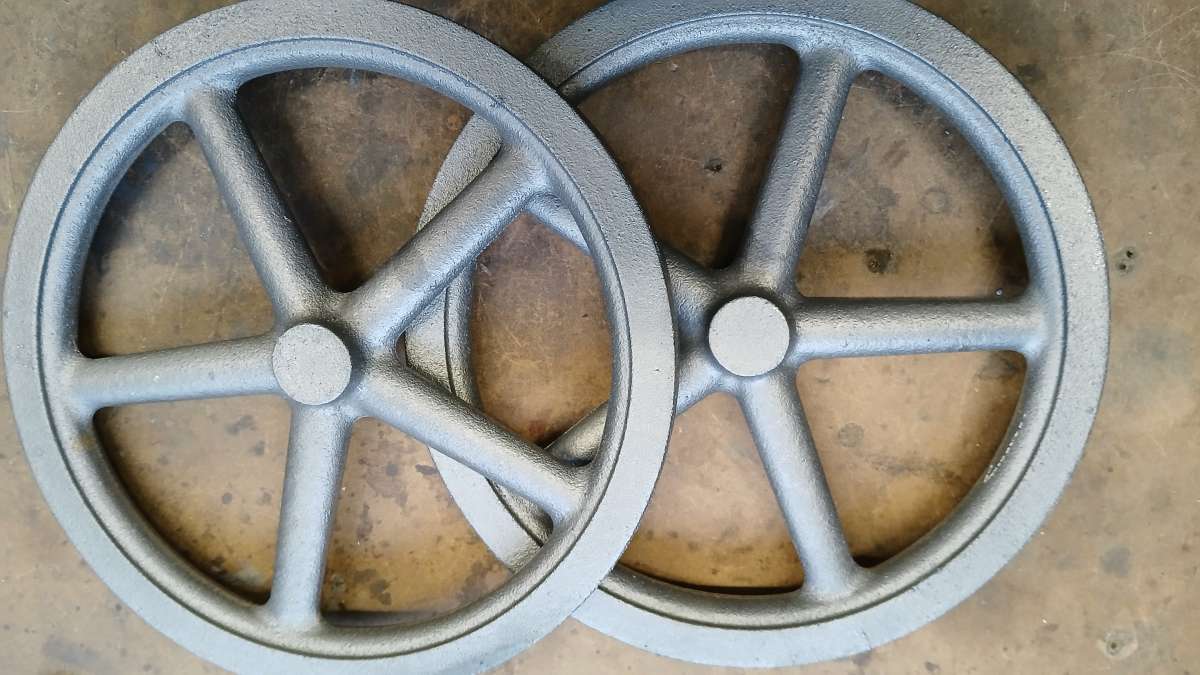

                      The PLA Prints after 3hrs sanding and several layers of paint, wish I had taken an “as printed” photo
                      20251110_091453

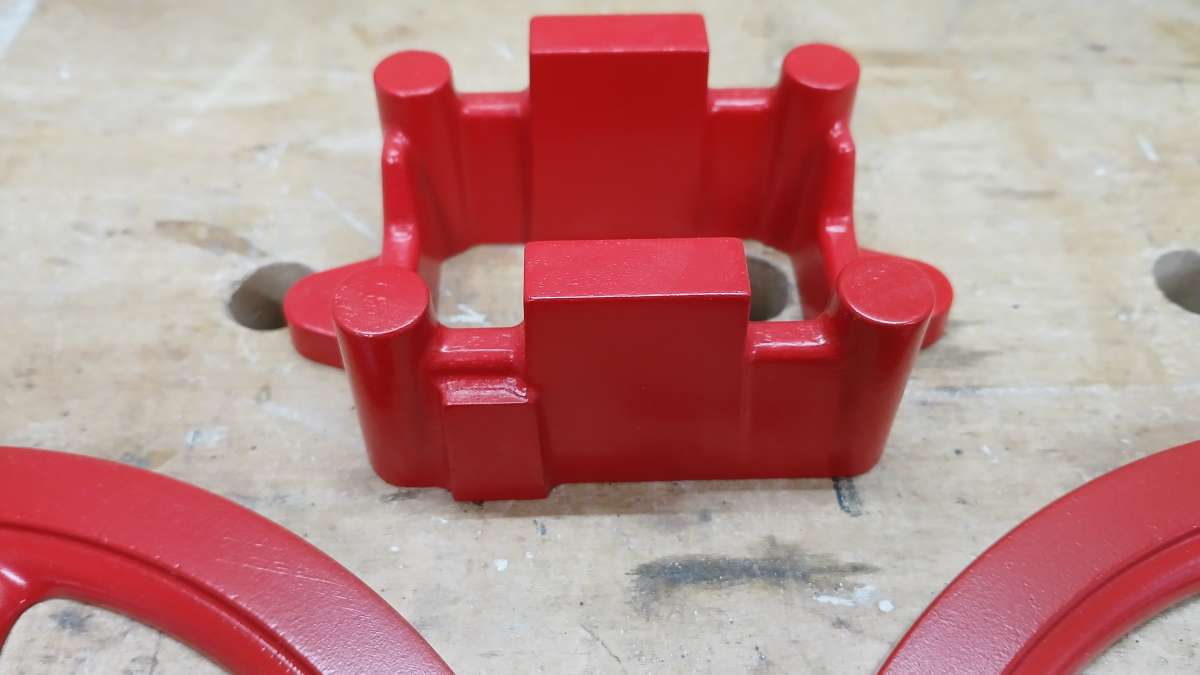

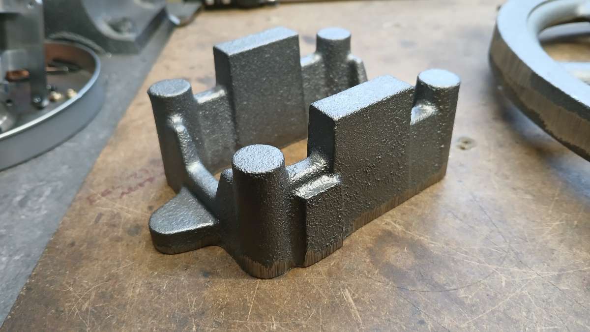

                      The base casting to go with them, CNC from hardwood, light sand, primer and gloss
                      20251110_091458
                      20251127_133633
                      20251127_133700

                          Bearing in mind that the Acetone smoothed sample was in ABS, my set up was to use a dining plate with a Pyrex bowl on top and a couple of scraps of kitchen paper to act as wicks.  I put a couple of mm depth of Acetone on the plate.  Here’s a reconstruction for you (I’m Hi Tech me)
                          vapour smoothing kit
                          As far as the smoothing went, nothing seemed to happen for 15 minutes so I went away for an hour or so and it was too much – needs constant monitoring.
                          The variable layer height is a bit of a red herring.  The whole thing could be printed at the smallest layer height but the variable option just saves time by only printing small thickness layers where it benefits the minimisation of layer lines, usually at the top of curved surfaces.

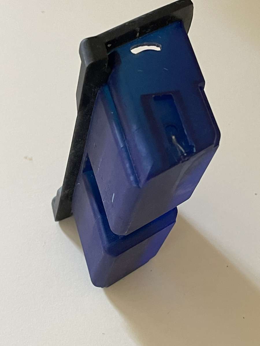

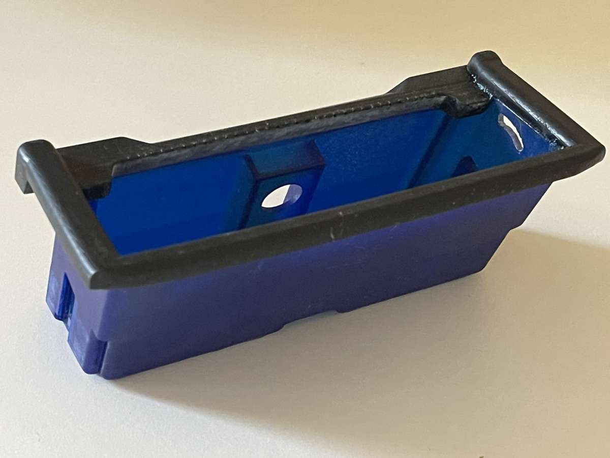

                                  I build larger components from multiple pieces – given the accuracy of the resin prints, I am happy to split a component into two or more parts in the CAD, add keys if necessary and print separately. To join, I drip a little resin onto the join surfaces, push together and take outside for a very swift cure.
                                  The photos here show a complex box reproduced from a broken original where the box in blue just fitted the baseplate of my printer. The surround in black was eventually printed diagonally across the print plate resting on the long edge – after several attempts.
                                  IMG_6289
                                  IMG_6290
                                  Hopefully food for thought…

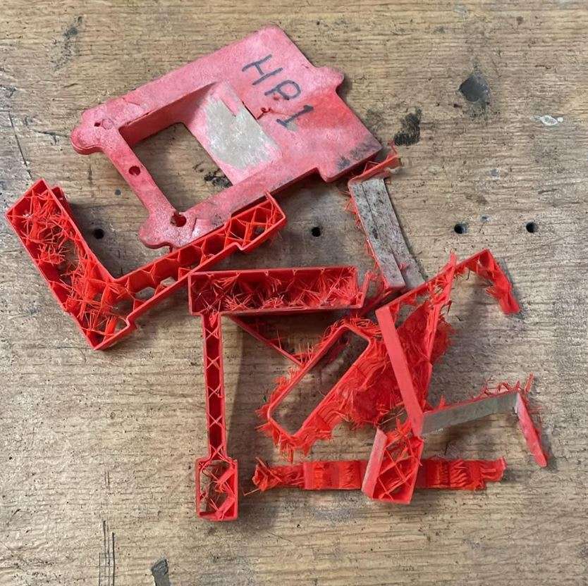

                                    Having had numerous 3D printed patterns sent to me for casting, I gave up accepting them. Only with a great deal of finishing were they going to be any good as casting patterns. 3D printing is an easy way to get the basic pattern, PROVIDED you understand pattern making, draft angles, shrinkage allowance, machining allowance and finally the surface finish which MUST be perfect. The sand will pick up even the smallest detail and will often cause the sand to break away leaving a defective mold or more rectification to be done.
                                    In the right hands 3D printing is a great help – it is not the answer to the patternmakers prayer some might think. Noel.
                                    #856540
                                      And don’t forget to go with at least 50% fill if you are printing patterns, they can get treated quite roughly at the foundry and modern airsetting sands tend to need a bit mor eforce to pull the pattern from the sand. This can happen if you use a default fill of maybe 10% I only did the CAD, not the printing.
                                      fail
                                      #856546
                                      Roderick Jenkins
                                        @roderickjenkins93242
                                        I think it’s generally considered that strength is better improved by adding more walls rather than the infill but that does look particularly skimpy all round.

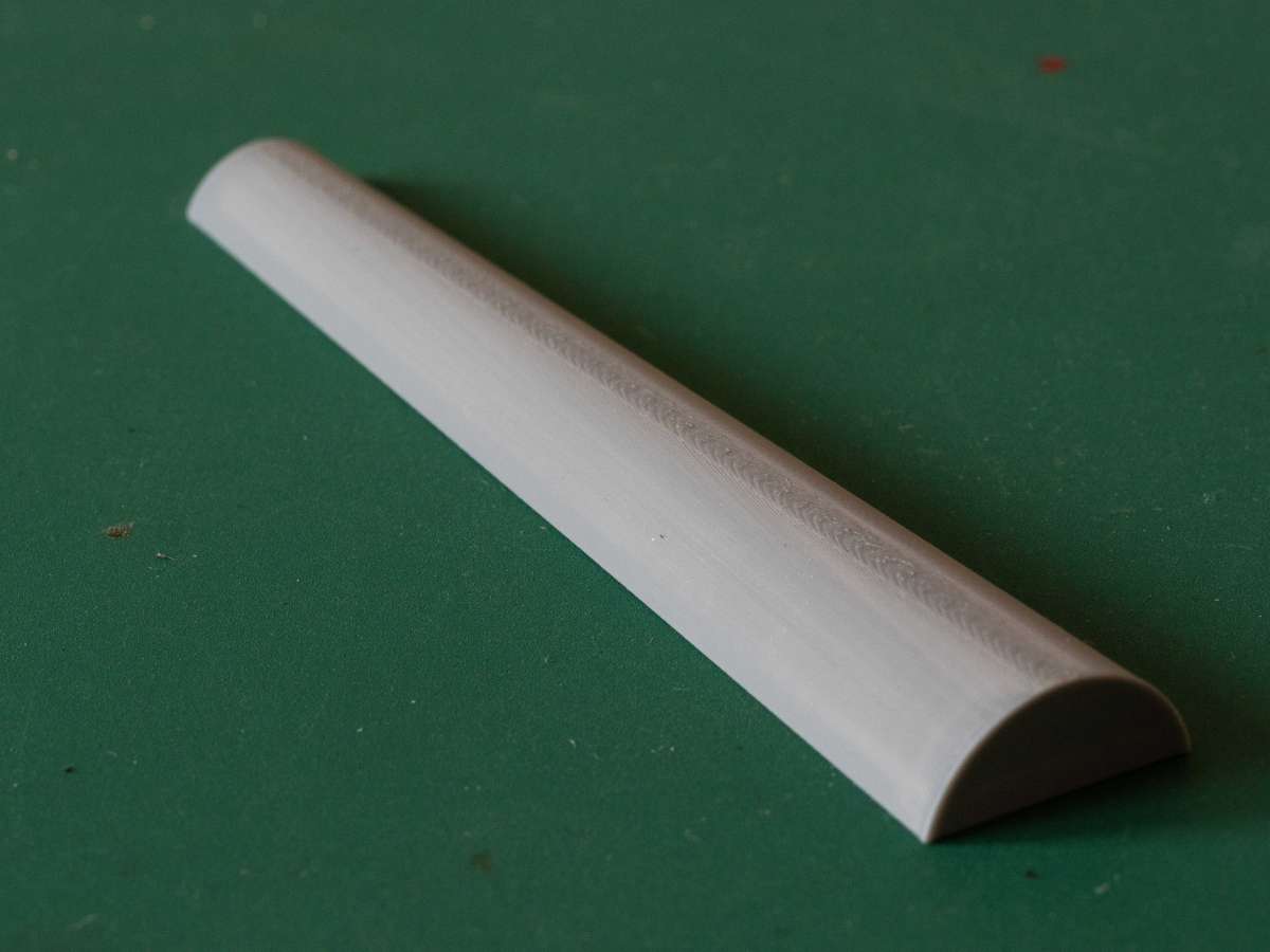

                                        I’ve thrown every suggestion that AI offers to minimise surface layers including using a 0.2mm nozzle:
                                        a spoke point 2 noz lr
                                        That ridgeback should sand off fairly easily
                                        a spoke point 2 noz 3 lr
                                        That’s PLA.  I might have another go with ABS when I’ve got some more acetone
