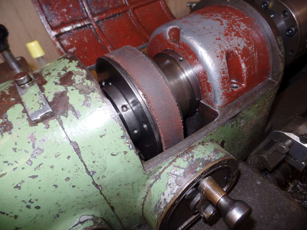

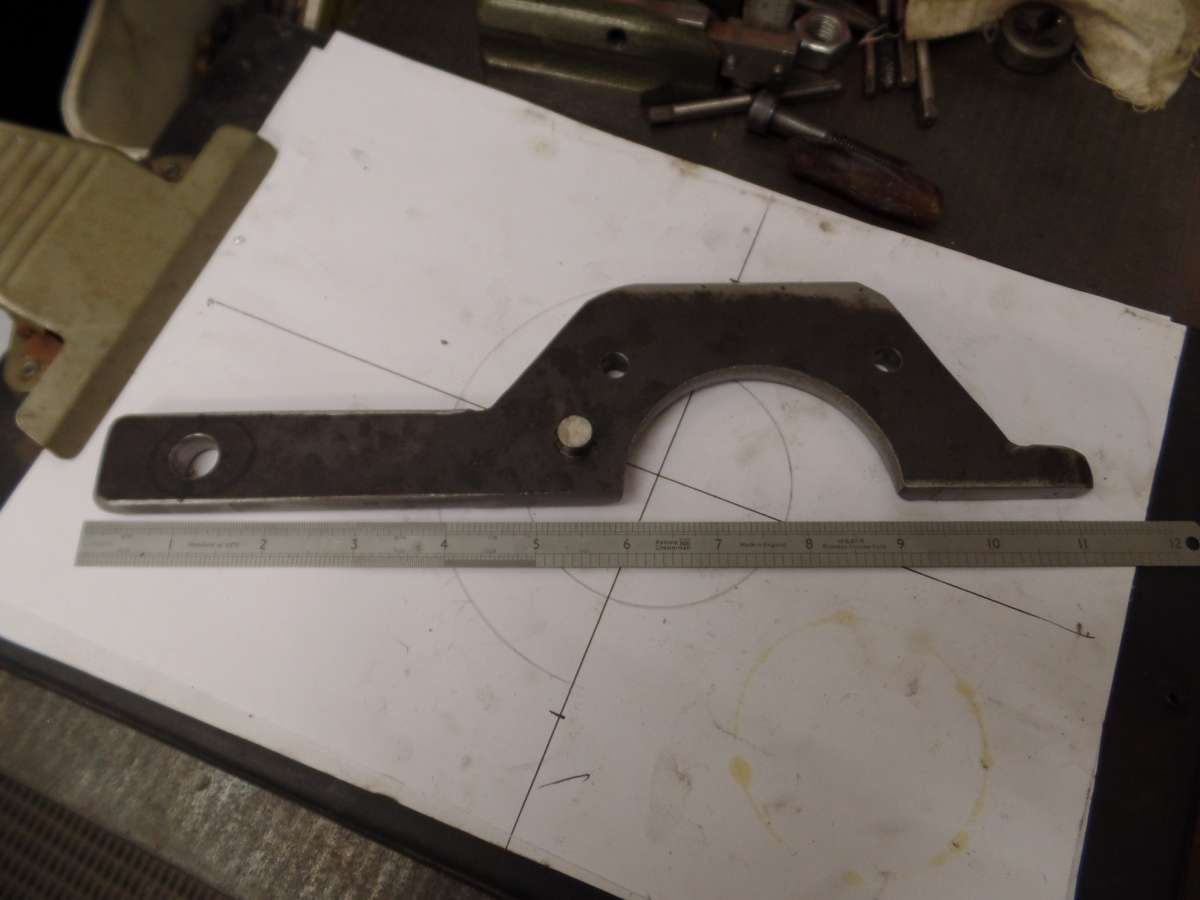

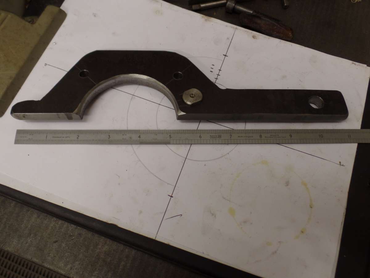

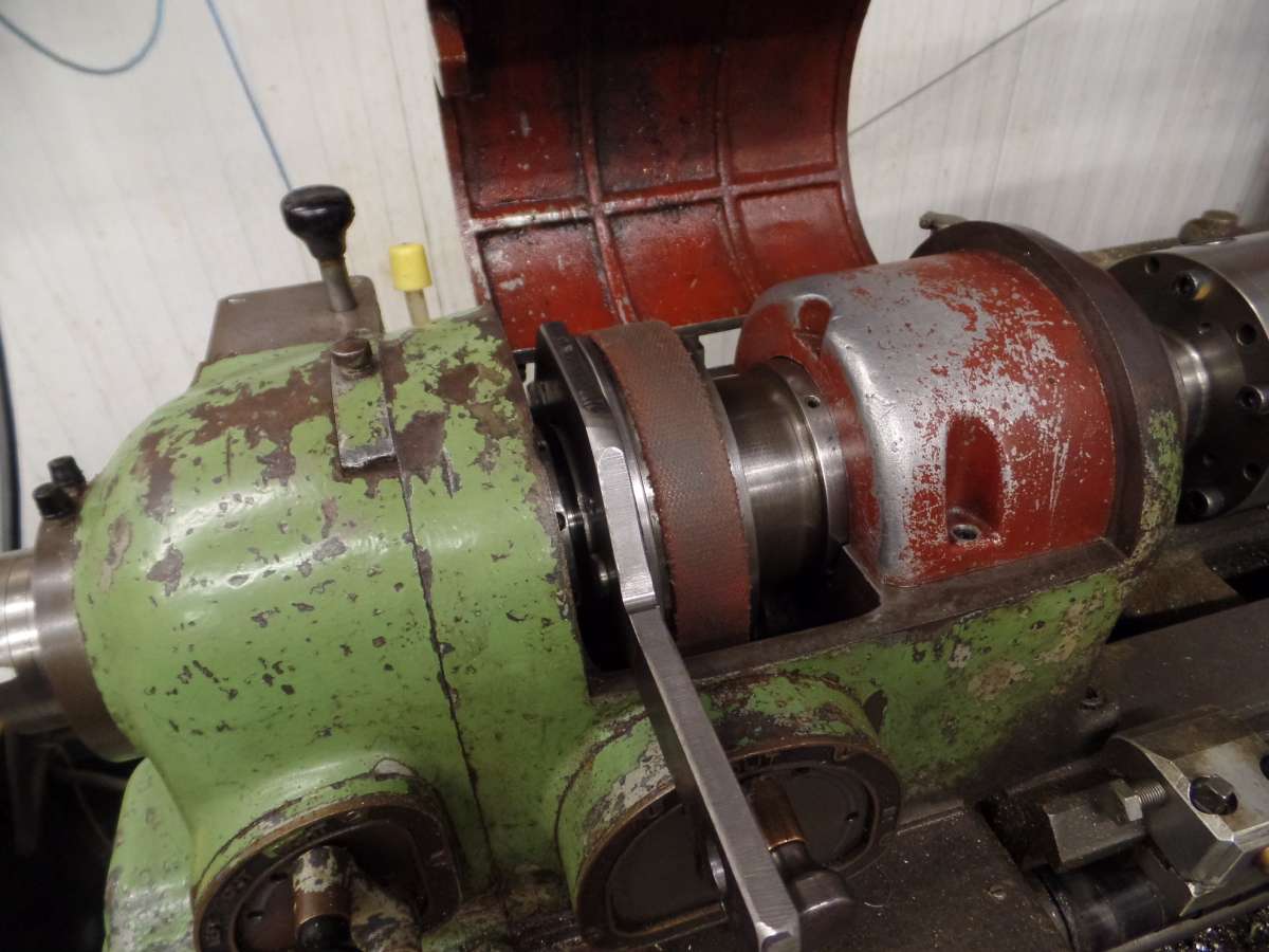

      I have just finished making a spindle lock for the earlier model A lathes up to Mk1.5. On the earlier type of pin operated pulley to spindle lock there is an extra hole at the left side of the large drive belt pulley. Almost opposite the lock pin mechanism is a 3/8″ hole in the casting and I found a gash bit of steel plate to make a Q-D lock. The exact pin position was a challenge, so it was made oversize in the plate and slightly eccentric at the projecting 3/8″ diameter end. That way I could turn the pin to align exactly with the hole in the pulley before securing it in place. Although I could if needed, remove the spindle in 15 minutes, I really couldn’t be bothered to make that much effort just to make measuring easier. Now there is no danger of straining the back gears when removing chucks and other kit from the spindle. I don’t know enough about the later improved pulley to spindle mechanism to venture advice on how to lock the spindle, perhaps the lucky owner of a Mk2 could see if they could make something similar.

        Here are some pictures.
        SAM_1227SAM_1229SAM_1230SAM_1231

          I’ve got a mark 2 version, good to use and makes it possible for easy screw cutting by someone like me with limited experience, but the chucks, faceplate etc are heavy and not easy to fit/remove from the spindle.
          I did ponder some type of spindle lock because I don’t like the idea of using the back gear to lock the spindle while trying to remove a reluctant chuck. The best idea I could come up with was to make something similar in shape to yours but with a tooth or preferably several teeth to engage with the steel back-gear bull wheel under the cast aluminium alloy cover (yours is painted brown in the photo). It would have meant having to take that cover off and then use the two cover screws to hold the toothed spindle lock in place. Not very convenient and I’m basically lazy so never got round to trying it

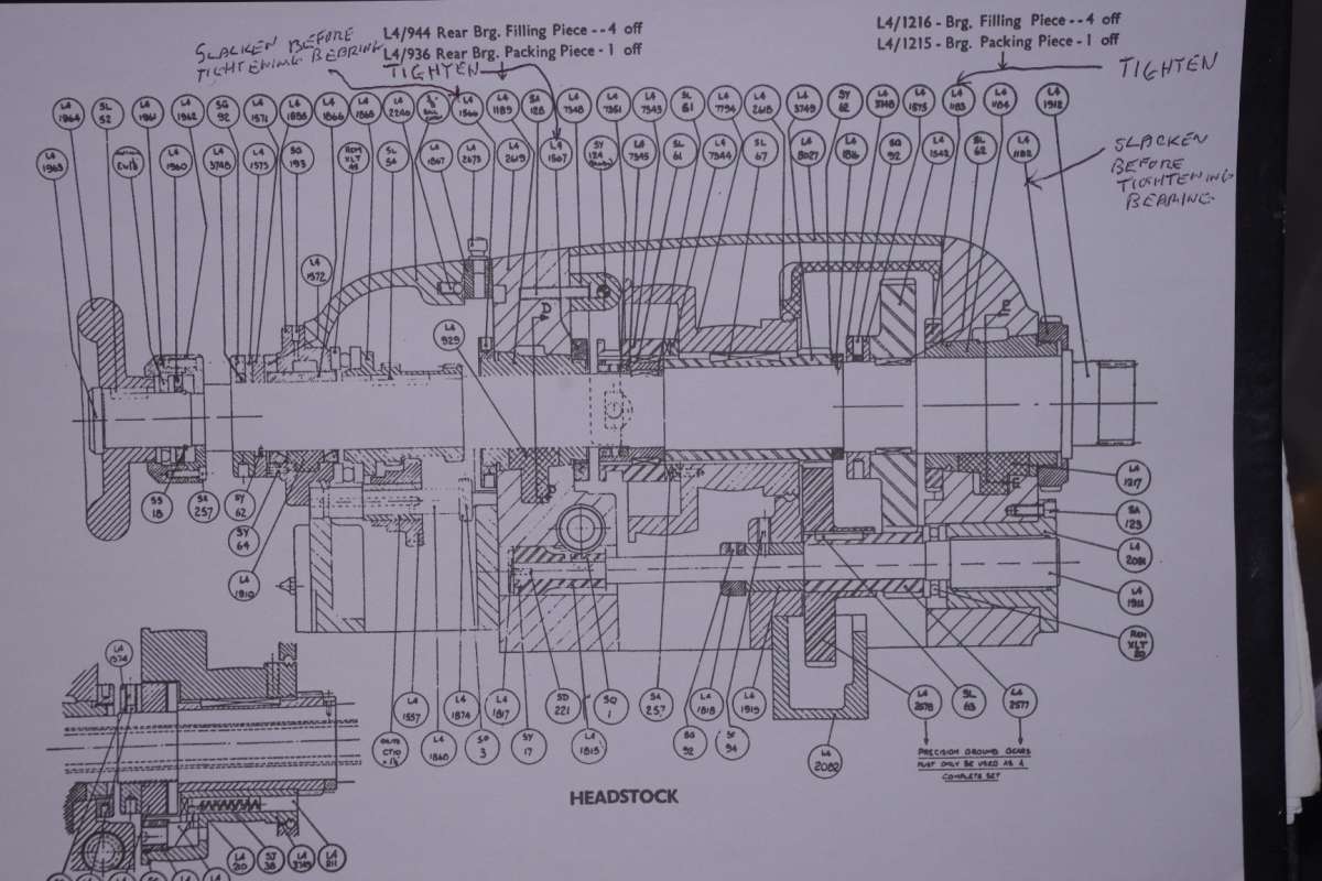

                  Our Model A Mk1.5 at the museum is 77 years old and there is only 0.0005″ wear in the spindle front bearing area and less at the rear one. The bearings are made like er collets and can be adjusted easily. You simply adjust a tiny bit at a time and then run at max rpm for about 15 minutes. The headstock should only get luke warm in that time. We lubricate exclusively with 5W30 fully synthetic motor oil, its superior lubricating properties are light years ahead of what was good in the 1940’s.
                  Do you have the manuals for the lathe, they show how to adjust the bearing.

                    I bought a copy of the manual from Bracehand shortly after buying the machine and used the drawings in that to strip it right down for cleaning and replacing the bits that were obviously duff and within my ability to get or make. Quite a game. I found the front headstock bearing to be extremely worn – the bore out of round by up to 5 thou or so but I’ve got it well tightened down and the lathe seems to turn and bore accurately enough for me. The rear bearing was much less worn.
                    I did toy with the idea of making a replacement front bearing but what a job – buttress threads, tapered exterior and various slitting saw cuts on top of the need to produce a good bore for the spindle. One day perhaps, but it would be a steep learning curve.
