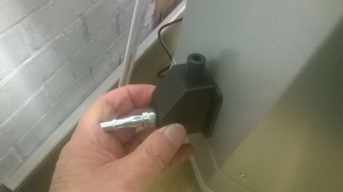

          My, how time flies when you contemplating what to do next.  Managed to get the mill out of its substantial amount of packaging and stowed away the 4th axis accessory and laser module for another day.  The extra 26 bits free gift arrived a while after the mill and the end mill holder pictured earlier is now fully populated with still some left over.  Mostly duplicates.
          With the help of a (much younger) neighbour got the mill up onto its dedicated bench and spent a long while reading the manual – for a change. I had difficulty getting the laptop to talk to the mill, not because there was anything wrong with either bit of kit, rather my inability to follow simple, clear instructions.  I decided to try with a cheap tablet which I duly ordered from eBay.  While waiting for this and the pipe and fittings for the air assist supply to arrive, I amused myself designing an angled block to neaten up the pipe run at the rear of the machine.  Here I am, holding it in position.
          Position of block on case
          Still waiting for the female push fit connector to arrive to fit the pipe in place.
          Everything is all set up for the first cuts tomorrow.  I have been holding off until the air assist is working and I couldn’t work out in my mind whether, if I put the z-axis probe in the spindle and ran the g-code for the first operation, it would try to run the spindle and ruin the probe.  After a bit more digging and searching, I believe that uploading the g-code file and clicking the Z-probe box in the settings, it will probe the workpiece for the height offset before returning to the “rest” position and signalling for a tool change.  Then it’s just a matter of changing the z-probe for the 4mm end mill and pressing “GO”.  I hope.  I’ll let you know how I get on later.  There are four more operations with the same bit, so no more probing required until I have to change to the 2mm ball end mill for smoothing operation.  Then back to the 4mm bit for final cutting out.  I’m expecting the entire machining process to take several hours, so I will spread it over a number of days.  Obviously it’ll look a lot quicker in the video.

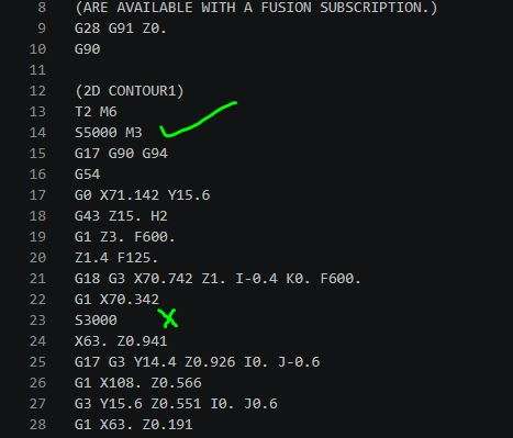

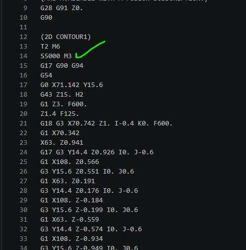

                      John I suspect what you have done when changing the speed is only change the spindle speed. A couple of boxes lower down is the ramp spindle speed which would also need to be increased to 12000.
                      Looking at the G-code for all the three first 4mm tooling paths I only have one spindle speed right at the start (line 14) if I alter my ramp to something different then the second “S” spindle speed line appears.
                      Correct code with spindle & ramp set the same
                      correct speed

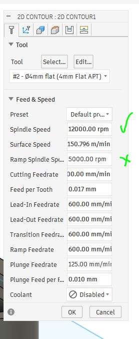

                      If I change the Ramp spindle speed to 3000
                      slow ramp
                      And the two boxes which you should have at 12000
                      dialogue

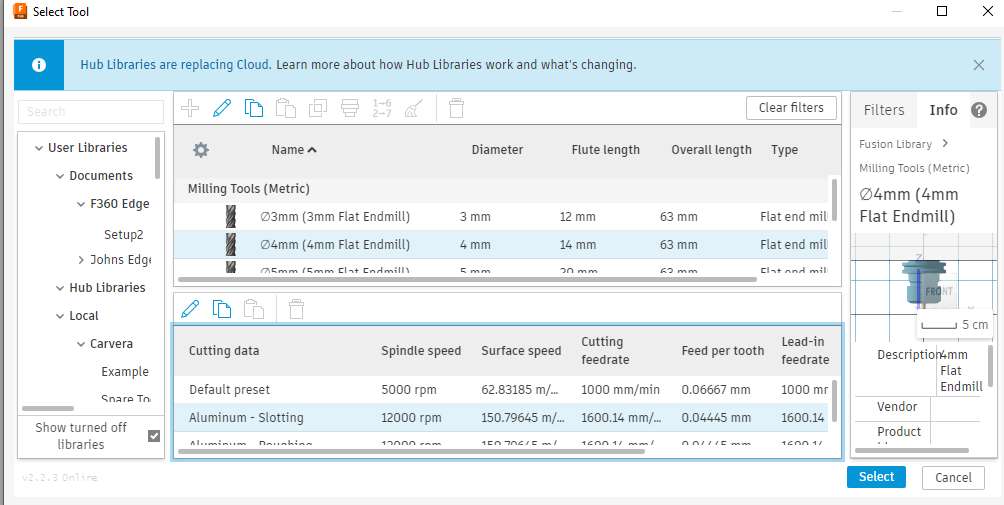

                        Looking back at the thread I did you wil see that I suggested selecting a 4mm tool from the F360 library and then coming down to the aluminium slotting option. this would have given you the 12000 an that would also have come up in the ramp speed box.
                        Photo 11

                          Thanks Jason.  Unfortunately the tool management window shown in your screenshot above isn’t in my version of  Fusion, so I’m reliant on the Makera imported tool definitions, which do not include a 4mm end mill.  I’ve had to make up a custom definition.
                          I looked, yet again, at the set-ups for the individual operations and you are right.  In some, although the spindle speed was correctly set at 12000 rpm, the ramp speed was reverting to 5000 and in a couple of cases, it was 10 (ten!) rpm.  Go figure.  I didn’t do it, honest guv’nor.

                            Forget what I just said about the tool manager page.  I’ve just found it with a little further (that is more than superficial) digging.
                            #849175
                              They should all be there in the background even in the free version, you may need to turn them on as and when you first need them. This will change them from greyed out to black text.
                              turn on

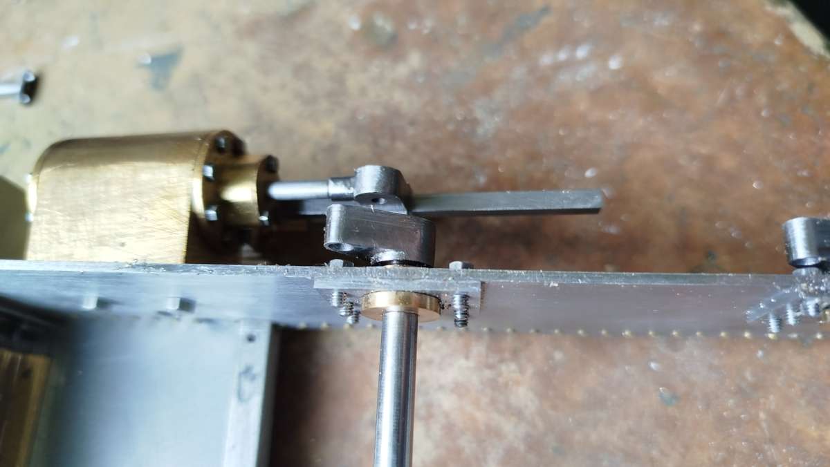

                                                    All the steel parts here were machined on the Carvera Air. Thr cranks were profiled from 1/4″ mild steel.
                                                    It’s quite capable. Use smaller tools and cuts.
