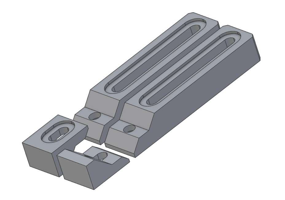

      clamps
      (I’ve flipped one sliding part to show the underside.)
      It will involve machining from both sides, so I’ll have to alter the work coordinate system accordingly, but I’m  certain that I’ll beat it into submission somehow.

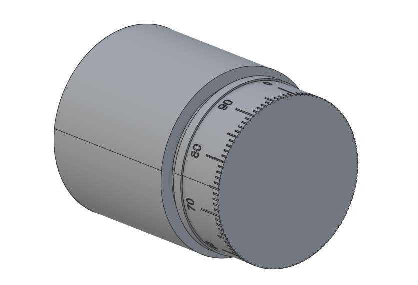

      Graduated scale on stock
      I’ve had a couple of goes with Fusion 360 and Makera’s own CAM software, Makeras CAM, but can’t see it very well as the theme they’ve chosen doesn’t suit me.  For example, the “drawing area” is black and I prefer white and the icons on the toolbar have black text on a blue background.  Maybe its just me, but I have to get within a gnat’s of the screen to read anything, so for the moment I’ve given up with that.  I emailed Makera to query whether it’s possible to change the colour scheme, but, no, it’s not.  They suggest that I be patient and wait for the release of their Makera Studio software in May.  As I don’t expect the machine to arrive any day soon, I’m content to do that.
      If anybody has any good ideas about how I should attack the 4th axis conundrum, I’d be pleased to get their input.  Just don’t tell me I’ve made a terrible mistake buying what I have and should instead have bought such-and-such.  It’s too late for that!  Otherwise I’ll plug on with a suck-it-and see basis, until I’ve done it.

        Looks a very nice machine, and a 4th axis is always worth having. The engraving ought to be straightforward but I am not familiar with Fusion or Makera CAM so cannot offer detailed advice.
        It is possible to simplify the design of the clamps so they can be machined in one setup. I would get rid of the recesses for the screw heads and add small fillets to the internal angles so that the slopes can be roughed with an endmill and finished with an ballnose mill without having to reclamp the part.

                Specifically, I have decided to completely remodel the clamps in Fusion, dispensing with the recess for the captive nut and just threading directly into the major part, particularly as I’ve re-read the list of included bits and see that there’s two thread milling bits in the original set.  That’s probably a whole day’s work at least as I try to learn Fusion’s foibles.  That will allow me to mill out the whole thing from one side, just leaving small tabs to stabilise everything.

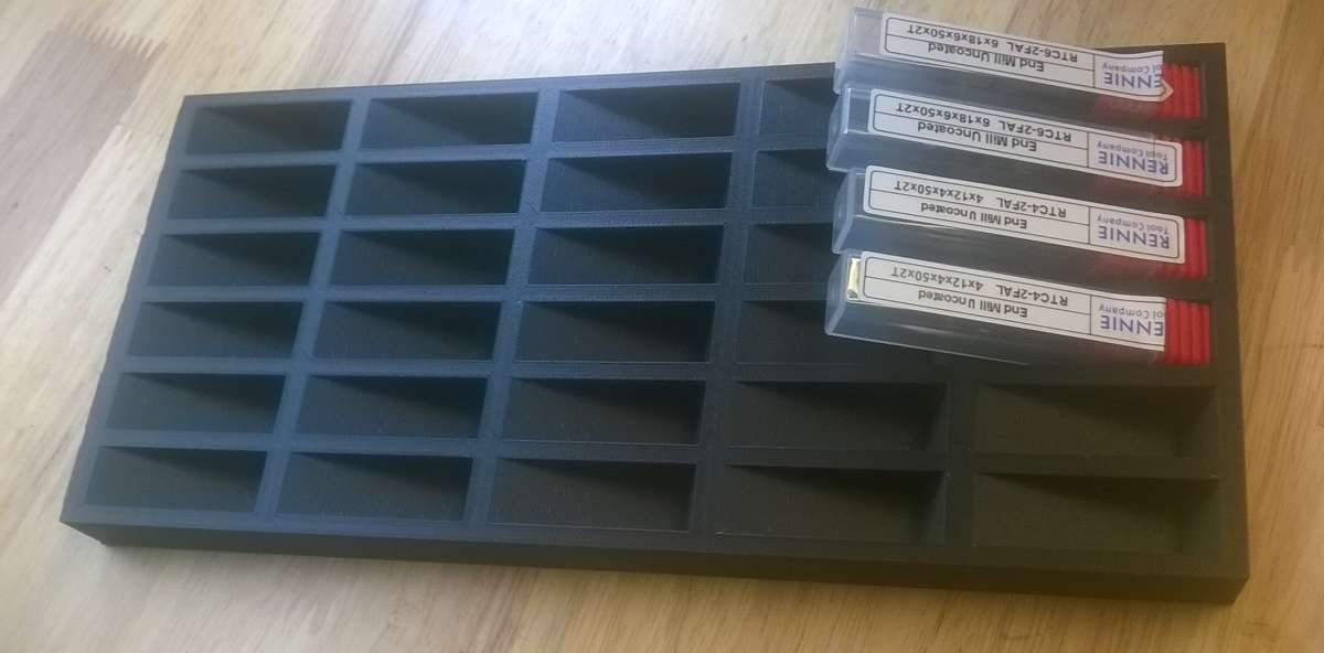

                I have designed and 3D printed a storage rack for the end mills that come with the machine and it also accommodates the 4mm and 6mm diameter 2-flute end mills that I’ve bought separately.  I’ve also purchased a pair of extra collets (4mm and 6mmØ) to accept the end mills of those diameters.  Actually, I bought them twice because the first pair got as far as transfer to the handover to the delivery driver whereupon  the courier mysteriously “lost” them.  Later, the package turned up, damaged, minus its contents.  Uncle Ali promptly refunded my money and a different supplier got the collets to me despite using the same courier.  (I think you all know which one.)
                If you’re interested, and even if you’re  not, here’s a photo of the end mill stacking tray anyway:
                end mill rack
                It took nearly six hours to print in PLA-CF, that being the only filament that have in stock that I could guarantee wouldn’t run out half way through the print.  At least it shouldn’t break!

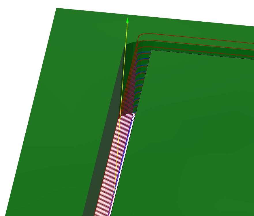

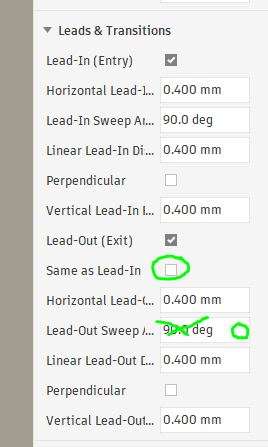

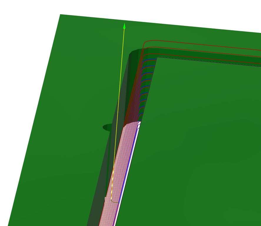

                      It will still do it if you ramp down as the ramp starts above the top surface you don’t have  a problem with the lead in. However F360 by default has the lead out the same as the lead in so both default to 90deg.
                      This is the simulation where the red is the tool ramping down and then at the end it moves away from the work before lifting up out of the cut so you get that full depth notch which will quite probably damage the tool. Green is the job, purple the waste stock around it.
                      lead out 1
                      Looking at the path with the tabs removed you can see more clearly how the tool moves out ( little squiggle) then up (yellow)
                      lead out 2
                      So to cure that go into Linking and untick the box so lead out is not teh same as lead in. Change the default 90deg to zero.

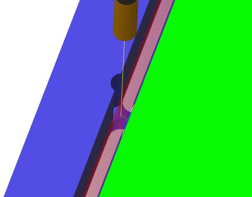

                      lead in 3
                      Then when you look at the tool path again teh cutter just curves up in the same directon it has been cutting before lifting vertically.
                      lead out 4

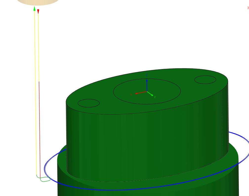

                          I found a part that better shows how the cutter moves with the default settings. This flange was roughed out with an adaptive to leave 0.3mm axial. I then did the contour shown, one roughing pass of 0.2mm and a final of 0.1mm. You can see how the tool moves out and up in a curve before retracting vertically. OK on a job like this where there is no material for it to move into but in a case like that shown in teh video you will get a nick.
                          lead out 7

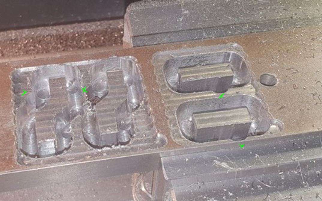

                          I also snipped this image from another forum which shows a similar nick a sthe tool has retracted and in the case of the one in the foreground almost cut into the vice jaws.
                          nicks

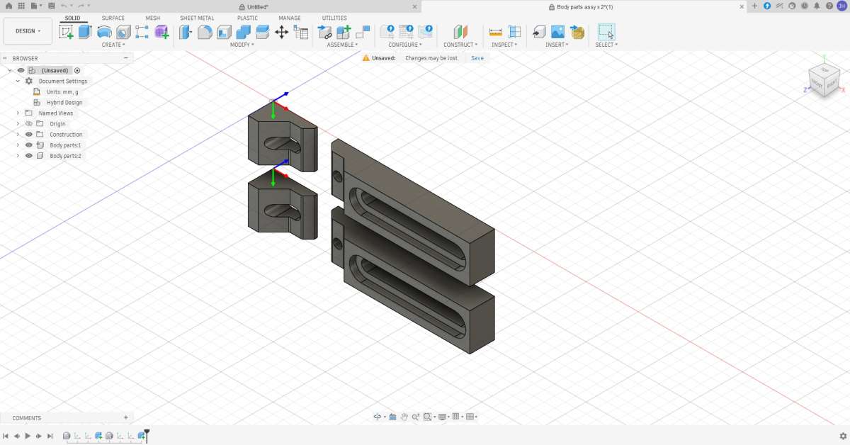

                            Two days ago I rashly said that I would draw out the design in Fusion from square one.  That didn’t happen.  I can’t seem to “get” how the drawing tools work.  So, back to Alibre Atom and knocked it up in pretty short order.  Exported in STEP format as Fusion can’t read Alibre format, only to find the axes all over the place and not at all where I wanted them,  Persevering, I thought I might be able to fix it in in the Manufacture workspace but when I ran a simulation of the long recess 2D contour cut, it started inside the stock and worked its way out – quite the reverse of what was intended!  Flipping the Z-axis didn’t solve the problem so I’ve left it for now to have a cup of tea, a biscuit and a long think, aided by Google, probably.  I just don’t get it. I did it before when doing NC files for the router, but then I wasn’t starting with STEP files.  Perhaps I ought to persevere with drawing in Fusion.  I’ve tried watching YouTube videos but they are mostly so poorly produced, I can’t follow the mouse movements even slowing the replay to ½ or ¼ speed and rarely understand the spoken word. Ah well, time will tell I suppose.  And patience …..   Something I’m fast running out of!
                            #846030
                              Alibre orientates X&Y as though you are looking at a vertical drawing board, F360 as though flat on a mill table.
                              I often have imported items on their side but as you need to enter the orientation of the part anyway it is not a problem and something that is worth learning if you need to use more than one setup to machine opposite faces, sides or ends.
                              Post a screen shot of how the part appears when you first open the step file in F360 and I’ll talk you through it. Both setup and tool paths. Also are you cutting both from a piece of 2″ wide stock like in the video?

                                That’s a very generous offer of assistance and one that I would be grateful to take up.  Perhaps it would be better to conduct the exchange by PM, rather than clutter this thread, unless you think others may benefit.
                                Here’s the screenshot requested.  I hope that the resolution is adequate.
                                Fusion screenshot
                                I will be using a piece of 12mm aluminium plate 100mm x 150mm.
                                #846050
                                  If it is OK with you I’ll do it on the forum as it may be of use or just interest to others. If you want me to start a new thread then let me know otherwise I will post here. I will PM you shortly anyway.
                                  I did have a quick play with the downloadable STP file and apart from the parts being a bit too close together for my liking, managed to do the CAM ok, I did not do the thread milling. Quick idea of what I came up with from 1/2″ material.
