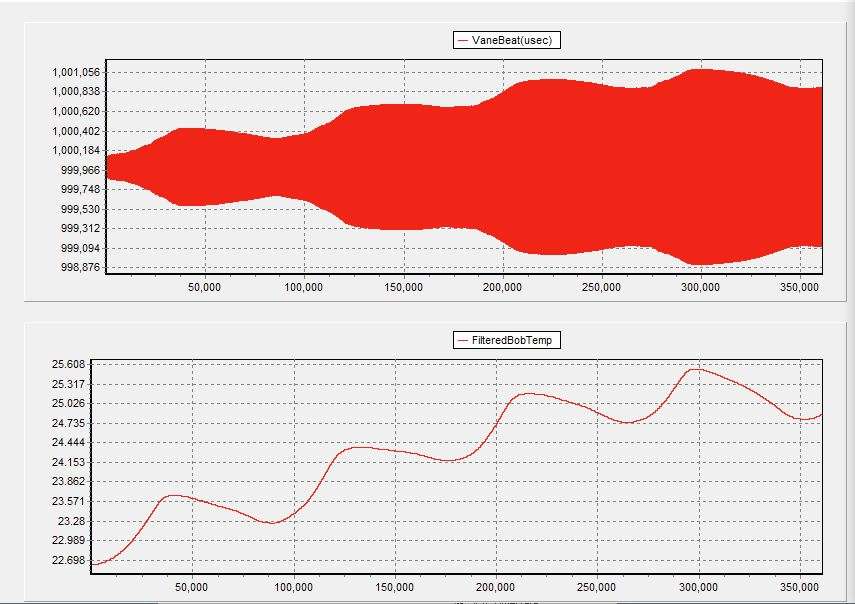

      I’m not sure is the same as any of them, but my approach would be to –
      • Have a separate amplitude detector (AD) photogate offset from BDC by the required amplitude
      • When this is triggered, inhibit the next impulse
      • Examine the average hit/miss sequence from the AD and adjust the impulse to drive this to hit/miss/hit etc.
      I would apply constant length impulses, ideally symmetrical around BDC, and adjust their strength using a DAC.  This could either be a real DAC driving a variable power supply or possibly use PWM of the coil current.

          How do you cope with Tilt with this method? – Tilt will be seen as an amplitude change.

                Joseph Noci 1
                  @josephnoci1
                  I hope I am not unique in my pendulum’s tilt affinity…
                  You will have seen these in my posts on the other forum- How the odd/even beat delta increases with environmental Temp increase – This was verified as being due to tilt – with Doug’s help some time back.
                  Also not sure its only ground level moving that is the issue – a lot depends on the Pendulum mounting – the pivot is a meter above the photogate and that’s a long lever arm when the target is microseconds, or even less. Sitting on a average home floor, or bolted to its wall – there will be tilt..
                  Tilt
