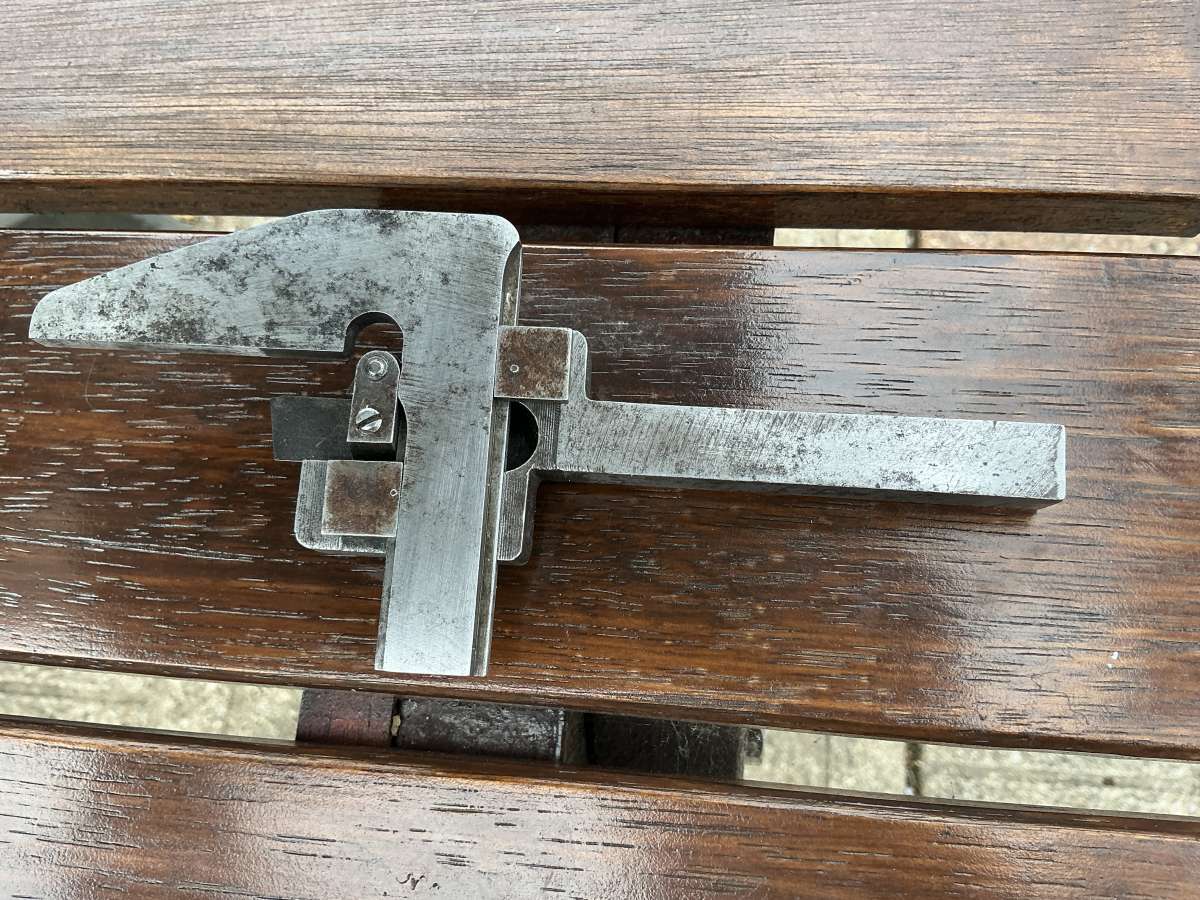

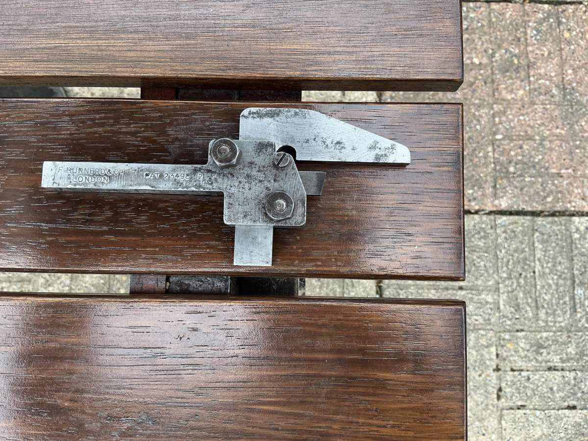

        #861278
        bernard towers
          @bernardtowers37738

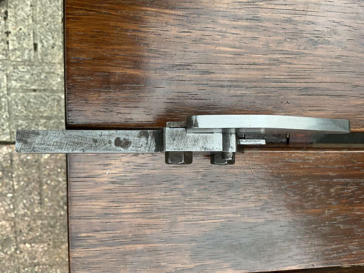

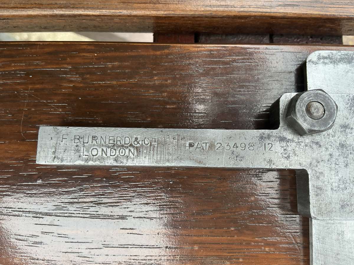

          Out of interest aquired this the other day and wondered if a design like this might be helpful, especially a smaller version for the lighter lathes. I has a well known chuck makers name on it so it was a commercial item.IMG_4143IMG_4144IMG_4141IMG_4142
          #861290
            Clearly made for front tool post use if the writing is anything to go by. It would certainly stop the work riding up or the cutter getting pulled down on a flexible machine.

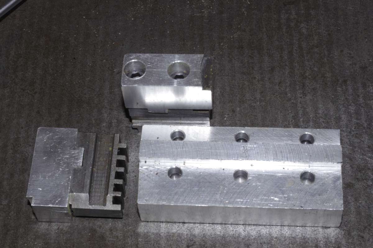

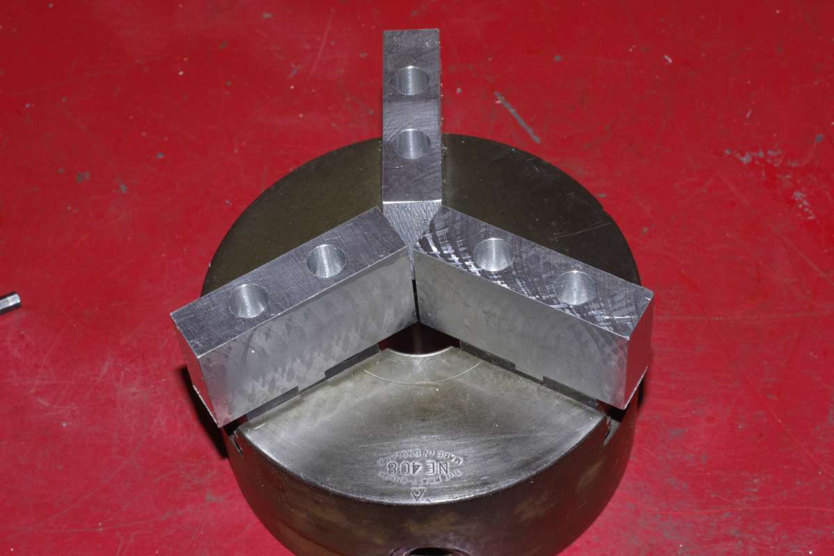

              Thanks for the responses. I’m not quite grasping what the soft jaw concept is? I don’t have soft jaws so maybe a moot point for me.
              The bearing idea… how do I grip a round bearing and also grip my part if they are different diameters?

                bernard towers:
                You have a vintage gem there!
                E T Westbury said:
                “One of the most satisfactory parting-tool holders ever produced commercially was that made by Burnerd, which incorporated a special steadying device, by means of which the prevalent tendency to dig in, nearly always experienced with any form of parting tool, could be entirely prevented. So far as can be ascertained, this tool is not at present [1943] on the market.”
                This approach reminds me of the tangential tools favoured by T D Walshaw where the downward force on the tool is directly transmitted to the cross slide.

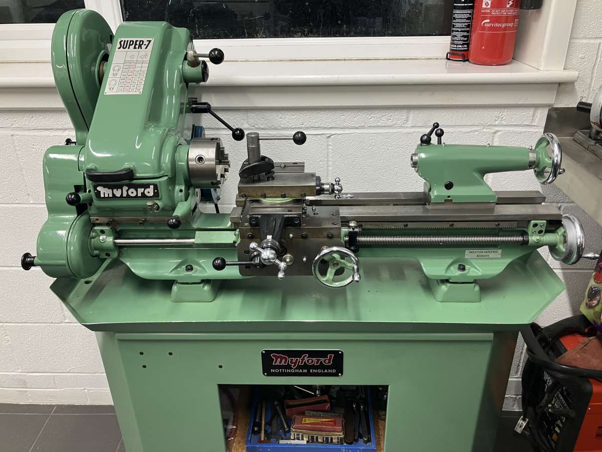

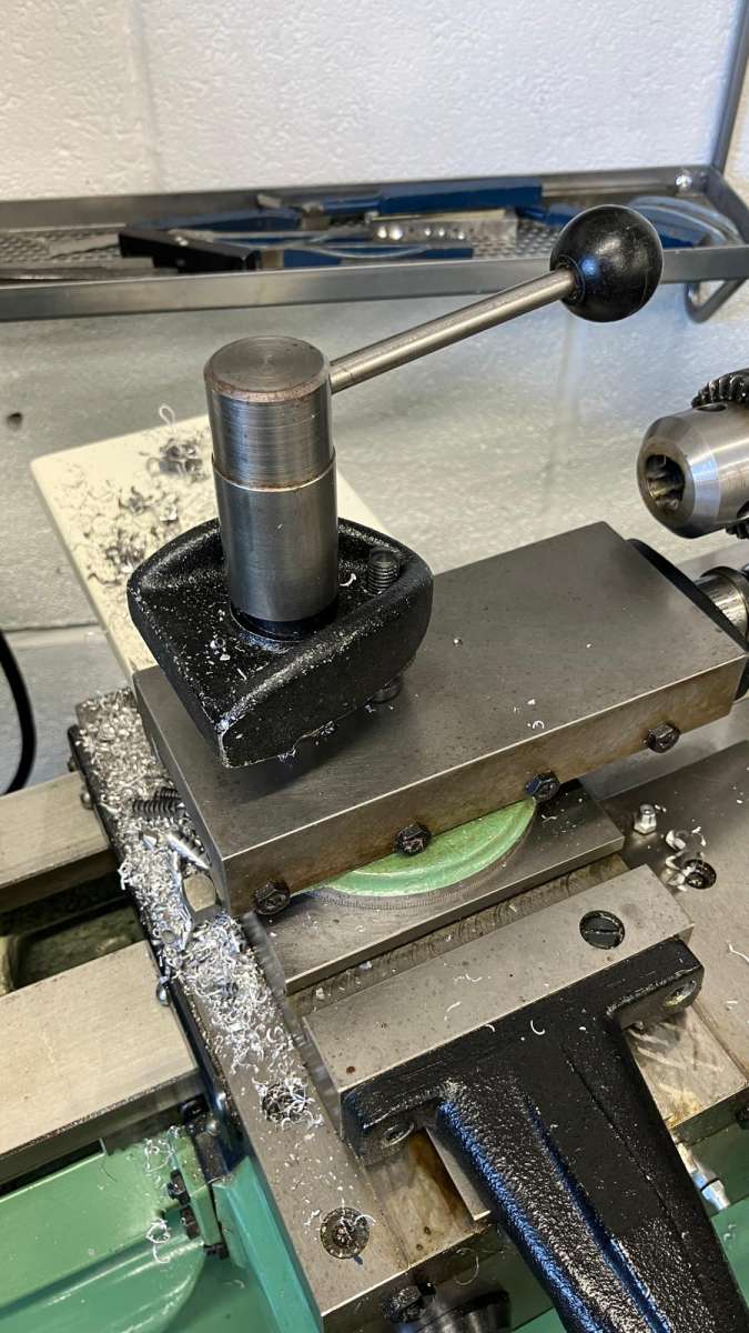

                  If it helps, this is my current set up.

                    I see that you have a very nice-looking late model with power cross feed which should mean the longer cross slide and, hence, the practicality of a rear toolpost as, eg, sold by Hemingway Kits.
                    I  suggest you search this site for further information generally.

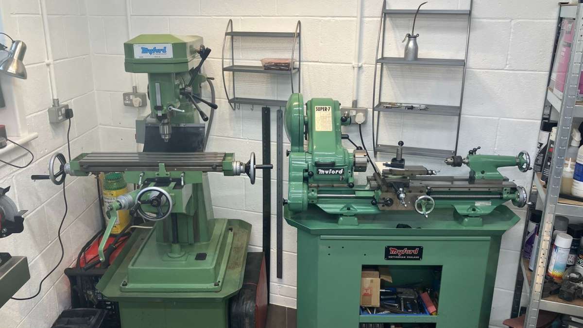

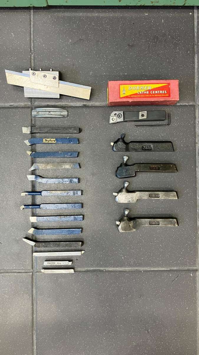

                      Thanks, it’s a nice machine that despite appearances, is not restored. I bought it, and the VMC fronm the original owner.
                      WhatsApp Image 2026-06-27 at 19.46.29IMG_6071

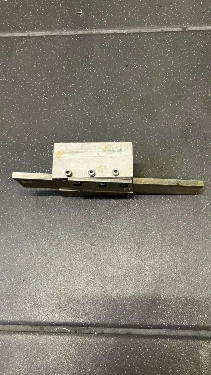

                      I had a rummage through the treasure trove of old oily cardboard boxes and plastic bags to see what smaller bits and pieces came with them, nd as luck would have it, there was a parting off tool in a custom made holder that nests perfectly under my quick heel clamp.
                      WhatsApp Image 2026-08-22 at 15.42.56
                      WhatsApp Image 2026-08-22 at 15.42.561
                      I just need to buy a thinner tool for it now.

                        you may find that that parting tool has a far too aggressive angle on the top edge.

                          Those blue tools are the Myford Quick setting type I mentioned complete with boat at top left.
                          Two superb machine tools but you need more space for the mill! Where is the lathe’s switchgear?

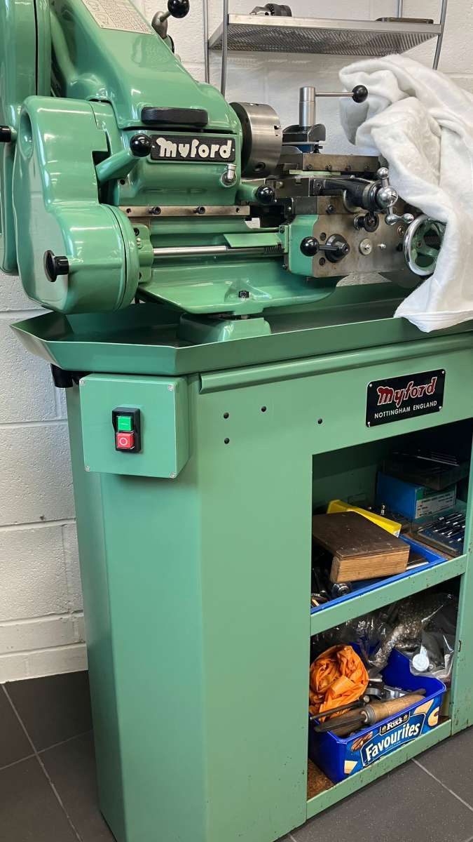

                          #861854
                          interferencefit
                            @interferencefit
                            No switch on the lathe, the motor is wired directly to the plug socket and I switch it from there.
                            The mill is tight, but it was the only place had room for them both. I get enough movement for the stuff I’ve needed to do so far.
                            If I need more, I have mounted it on polypropelene sliders, which with a good firm shove allow it to be dragged about a little without damaging the floor tiles.

                                Two comments, in the hope of not being thought pedantic.
                                Ideally, the lathe should be fed through a No Volt Release switch. Then if, for any reason, the power is removed, there is no risk of the machine starting up unexpectedly.
                                If you want to run the lathe in reverse, many use the old drum type switch (using this to switch the lathe on or off can cause the contacts to burn, so stoppong and starting with the NVT safegaurds this by ensuring that the drum contacts are only made/ broken with no current flowing).
                                Secondly, a parting tool with a large top rake is likely to be more prone to digging in, especially since you will be using it in effectively a front tool post. I fitted my ML7 with a Myford 4 way toolpost to make tool changing easier. (You could even make one from laminations of fairly thick plate, say 12 -15 mm)
                                My preference is to use a HSS parting blade, (Mine is 3/32″) with no top rake, and set on centre height. Usually moneral or soluble oil is drip fed with a brush to make life a lottle easier
                                Mine is mounted, inverted, in a rear toolpost. (I made one for my ML7, and it made parting off less fraught) Being inverted, the swarf is more likely to fall away, reducing the risk of jams.
                                HTH
                                Howard

                                    Thanks both – can you recommend or link to what switch I should buy as it is something I ought to set up. Would prefer period/Myford correct, but will go with the flow.
                                    I’ve ordered a RDG tools 3/32 parting off tool to see how I get on.
                                    #862188
                                    Howard Lewis
                                      @howardlewis46836
                                      You may be able to buy a No Volt Release switch as an aftermarket spare replacement from suppliers of bandsaws, such as WARCO or Chester, or possibly from someone like Home and Workshop Machinery.
                                      If you want to run the lathe in reverse, the reversing switch should wired between the NVR switch and the lathe, so that it can only be operated when the lathe is stationary.
                                      Either of these set ups should move the “On/Off” function way from the lathe so that you do not lean over rotaing parts to switch off.

                                        Just updating this for completeness. I ordered a NVR switch and a diecast aluminium enclosure to house it. I had some original Myford Green enamel paint that the original owner bought with the lathe back in 1989 that had never been opened, so I used that to paint the box for a more cohesive look.
                                        I’m quite pleased with how it turned out.

                                            old mart
                                              @oldmart
                                              Soft jaws when new are just square blocks of a machinable steel alloy which fit in place in the chuck body exactly the same as hard jaws. They can be set up and be bored to make holding difficult and delicate work exactly. With care they can be used many times before they are worn out. Even then they can be milled and drilled to accept shop made tops and that will extend their life pretty much indefinitely. Here are pictures of_IGP3492_IGP3475 soft jaws and of an old chuck with aluminium tops held onto worn out soft jaws with SHCS ready to have an extended life.
