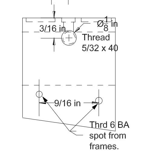

      I’ve just come across this symbol on an engineering drawing, a circle with three bars inside, can someone please explain what the three bars signify.

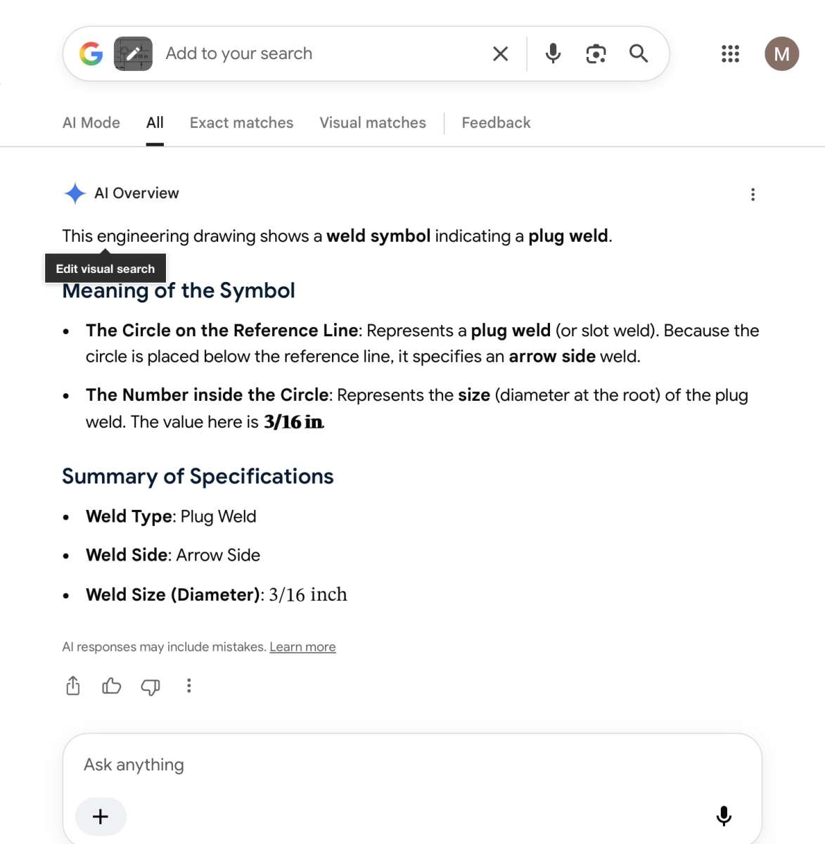

              I cropped your image to remove extraneous detail, and then asked Google Lens

                  Not sure the AI is correct here. I tried the same and got similar results about welds, but that seems wrong given the dimensions and object (a model steam chest). My impression is that the 3/16th dimensions define the circular feature’s position, not it’s diameter.
                  The drawing is part of a set by Keith Bucklitch of Charles a 16mm scale steam loco on the steammodelloco.io group, (I assume UK based ?) and no particular drawing standard specified on the drawing.
                  Another part of the drawing has a similar circle, but with more segments and is defined with a thread size, but there’s nothing specified on the steam chest drawing.

                    Please don’t shoot the messenger 🙂
                    I only reported what I found.

                              This is just my guess, I think the broken line is meant to be a circle. It would seem that the parameters chosen for the broken line in the CAD programme are producing straight line segments instead of a curve on small diameters.
                              Symbols for welding are completely different and are usually placed on an extended leader line.
                              It would be interesting to know which CAD programme was used to produce the drawing.

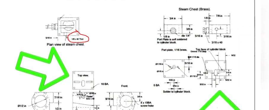

                              #860947
                                Quite obvious when you see another view of the chest, it is a hole threaded 1/8 x 40 as per top left, ringed in red. Hence my asking for the remaining views.

                                  So … if actually drawn correctly, those 3 short lines would be arcs concentric with the circle.
                                  Mmmm ! … Just as Neil A surmised.
                                    Quite obvious if you look at a different plan sheet !
                                    So the symbol is a threaded hole (with an unspecified thread on the plan I was looking at), but rendered differently to other threaded holes on the same sheet…… which are rendered the same as hidden parts…
                                    Thanks for digging that out.
