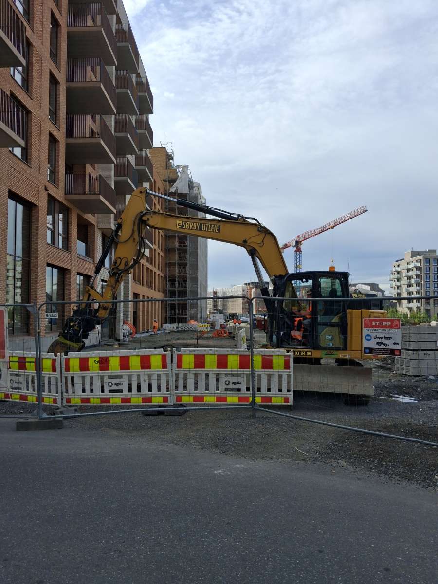

          In the broader scheme of things JCB are probably right, but here is a Caterpillar battery electric excavator in Oslo last week.  They are mandatory in the city centre.20260812_121059
