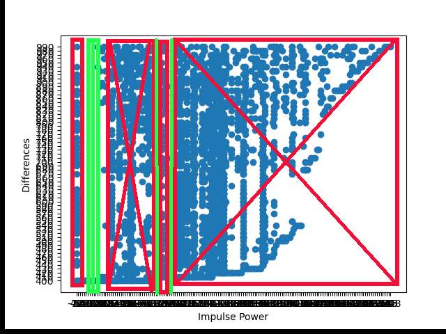

                            Not a good day.  Found a new bug in the starter.  The code I wrote to stop the pendulum makes things worse!  Interruptions and poorly again.
                            This scatter graph shows my attempt to find the optimum impulse power.   The clock was told to increase impulse power from too slow to too fast, and the effect on amplitude captured.   Shows differences between the period of successive beats, which is a measure of bad behaviour.  Ideally there should be no difference.
                            diffImpulseScatter
                            I’m very suspicious of the results for several reasons.  One is the scan was too fast a ignoring that it takes many beats for the bob to react due to inertia.  It needs time to settle.  The increase rate was aggressively, and I leaned on the table several times during the run.
                            Anyway, the areas marked in RED show the pendulum reacting badly.   Fairly obviously on the right, impulsing with too much force disturbs the pendulum.   As does not applying enough force on the left!  Disturbance at the low power end may be a fib – measurements taken before the pendulum had settled from a cold start.
                            However, the wide green area on the left shows the pendulum is less disturbed by weak impulses, not surprising!  The optimum running impulse is probably in this region.
                            More surprising are the good and bad bands in the middle.  Hard to explain.  Faulty experimental method, or perhaps the rod is twanging.  Conventional pendulum clocks impulse close to the suspension.  Magnetically impulsed clocks, including this one, usually apply force at the bob end, which might cause the rod to bend as it does the equal and opposite reaction thing.  Dunno. I’ll have to come back to it.

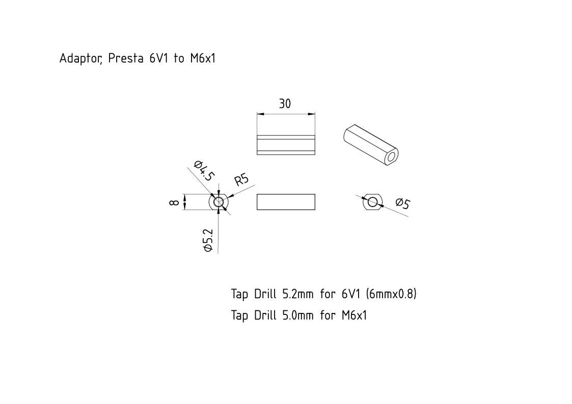

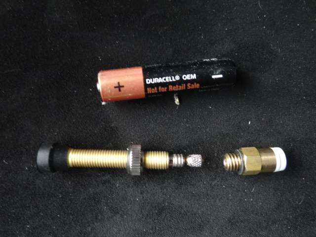

                                          As a change from software, I’ve started on the vacuum valve.  Plan A is a Presta Bicycle valve in reverse.   Needs to be connected to a 4mm diameter plastic pipe, for which I have a connector.  Presta and tube connector shown below, AAA battery for scale:
                                          DSC06973
                                          An adaptor is needed.  The tube connector is M6×1.  The Presta thread is new to me: it’s ISO4570 6V1, 6×0⋅8, which isn’t a standard metric fastener thread.   Fortunately taps are available so I don’t have to make one!
                                          adaptorPresta
                                          To seal the adaptor, propose to:
                                          • cut the threads for a tight fit
                                          • fit with plumber’s goo on the threads
                                          • then dip whole assembly in latex rubber.
                                          I shall test the valve on a small cylinder before fitting one to the clock.  If it doesn’t work, Plan B as suggested by Michael G.
                                          How to seal the pipe and electrical wiring where it passes out through an 8mm hole is another worry.  I’m thinking hot-glue or latex because proper vacuum sealing compound is expensive – £107 per kg.

                                            For a pendulum in air, I would think that the”pointy eliptical” one would be best, but with the body curved to match the pendulums radius. The best shape for a body moving in air is the teardrop, but it is limited to one direction and a pendulum has to reverse ti work. Densimet tungsten alloy uses tungsten particals sintered with iron as a binder and it machines very well. It has a relative density of around 18, I have made several lathe tools for holding carbide inserts from it, very good for boring bars as it is stiffer than steel, denser and not brittle like solid carbide, it is magnetic, but less than iron.
                                            #822863
                                            Robert Atkinson 2
                                              @robertatkinson2
                                              Hot glue will work OK for vacuum seal but even better is is good old fashioned sealing wax as used on letters. It’s good even for high vacuum but ideally use solid bare wire through it as the insulation or stranding of flexible cable will leak more than the wax.
                                              Robert.
