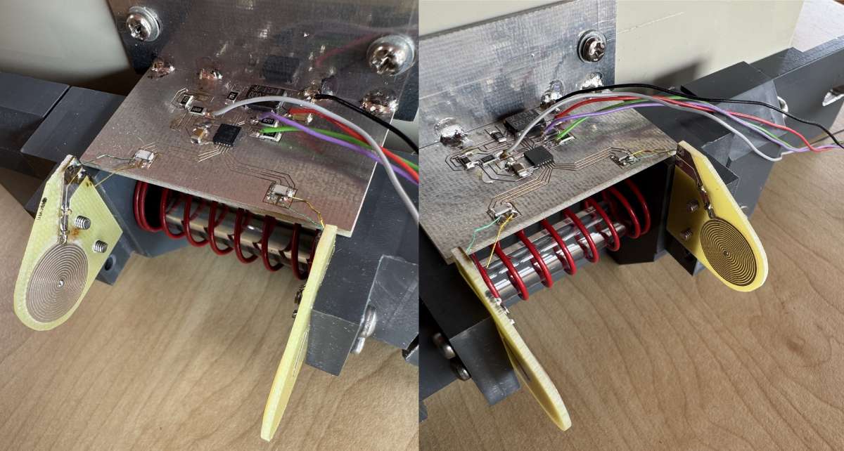

              John, your second elevated photogate serves that purpose correctly, but using the BDC photogate measurement of the flag width is not appropriate. All else being equal proper amplitude control then relies on that flag width measurement, which is simply a measure of the quartz clock, or drips or water, or the kitchen clock…whatever the clock being used to time the passage of the flag. That is infiltration.
              I use the Capacitive angle sensor to measure the actual angular displacement of the pendulum. I measure that with an AtoD and then compare that to a setpoint and adjust the drive accordingly. In my case, I do not pulse the pendulum, but drive it with a phase shifted version of the sinusoid coming from the angle sensor. These are all analogue paths only. Yes, the A to D is driven by a microprocesser, which needs a clock, but I could just as well use an analogue VOM, get the reading of amplitude, and twiddle a pot to change the drive signal to the pendulum.
              Yes, I use a very accurate clock to measure the flag width at the BDC photogate( hence amplitude), but it is a measurement only, to find the error of my ways, not used in any control path.

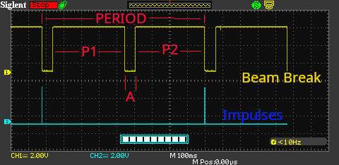

                        As a sub-sub project, here’s another example of how the clocks microcontroller can easily do other useful measurements.
                        For various reasons the clock is physically levelled.
                        1. in order to fly straight the pendulum suspension shouldn’t be twisted right/left or fore/aft.
                        2. Alignment at a right angle to ground maximises stability and reduces structural distortions and vibration by taking forces directly to ground.
                        3. the rod (or vane) that breaks the infrared beam should be aligned with the opto-sensor at bottom dead centre.
                        First step is to level the clock with a builders bubble. Don’t believe it need be highly accurate to fix right/left alignment, and it gets the vane close to BDC.
                        Close positioning of the vane relative to the opto-sensor is desirable.  My design provides two ways of improving on the bubble:
                        1. the whole pendulum assembly can be slid fore/aft from the top.  Bit fiddly because the pendulum wants to swing.  Adjustment could be improved by moving the pendulum top assembly on a screw.  Or, much better, by screw adjusting the position of the opto-sensor stand at the bottom, because that’s less likely to wobble the pendulum.
                        2.  by tilting the whole clock using the rear levelling screw, but it’s difficult to see when the vane occludes the opto-sensor correcty  Fortunately the microcontroller can measure it.
                        This graphic shows the pulse train detected by the sensor when the pendulum is swinging.  The yellow trace is the opto-sensor output.  The image is annotated in red to show period, transit time A ∝ amplitude, and the length of the pulses each side of the transit, marked P1 and P2.
                        mk2sensortrace
                        The ratio P1:P2 gives the level.   1.0 means the vane is correctly positioned relative to the sensor at BDC.  Less than 1 means the clock is leaning forward, greater than one means it’s leaning backwards.   The clock’s microcontroller is easily programmed to measure Period, P1, R2 and A, and to calculate and display P1÷P2.  Voila, this clock measures level!
                        To position the pendulum BDC, set the bob swinging and switch on display P1÷P2.  Then adjust the rear level adjusting screw until it reads 1⋅000.
                        Made a mistake.  Should have used M12 fine to make the levelling adjusters, not M12 coarse…  Bit clunky, I can live with it!

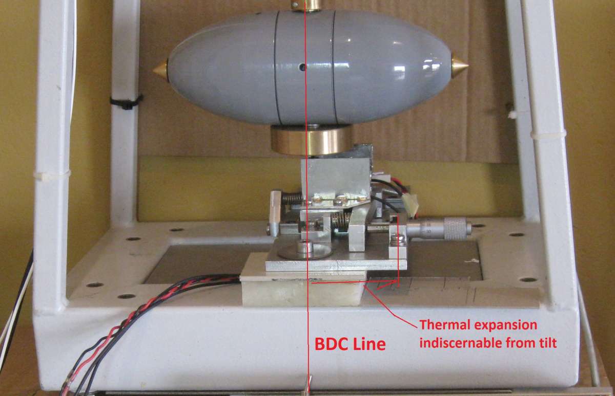

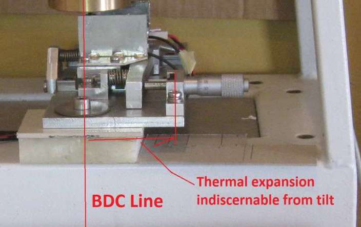

                            Joseph Noci 1
                              @josephnoci1

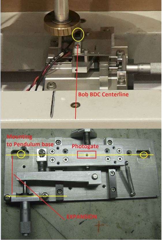

                              Correct, except when it’s not..
                              As is being painfully pointed out to me on another forum, there are many things that cause a measured delta between odd and even beats, not only tilt. At least two other culprits are the rise and fall time of the signal from the photogate ( and any ambient lighting it is exposed to), and worse, how the photogate is mounted.
                              Scope Photogate
                              For example:
                              The photogate in these poor photos is ringed in yellow – it is mounted more or less in the center line of the micrometer sled that carries it. That sled is mounted more or less in the centerline of the bob’s BDC. The photogate sled has a micrometer, with a 7:1 lever arm, to adjust the photogate to BDC. 1 micrometer division (0.01mm) gives about 20us delta in the odd and even beat values.
                              Photogate expansion
                              The problem is that the micrometer is some 35mm away from BDC, so that section of Aluminium expands and contracts with temp, moving the photogate left and right – this looks like tilt and it is not..
                              This may not be important in your scheme of things – My setup can discern 8 micro-radians of amplitude variation, and interpolate down to 3-6 micro-radian, and any ’tilt’ is an issue if you are sensing amplitude in a peak manner, as opposed to peak to peak, As John indicated, there are ways of doing that, but not just with a BDC photogate.
                              And if your whole pendulum ’tilt’ can be adjusted by a ‘leveling screw’ , then that screw is a big culprit – it has a tempco which will translate into tilt. No free lunches anywhere with a pendulum, much to my chagrin..
                              Photogate sled1

                                      Joe first.  His platform is precision engineered in metal, including a micrometer head.
                                      joeplatform
                                      • Pro. Solidly made, Capable of fine adjustment, in both axes. Best practice mechanical reliability.
                                      • Con. Expensive to make. Though the effect is tiny, dimensions change with temperature, and reduce performance.  Tiny matters!

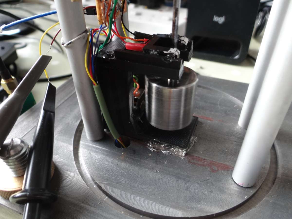

                                      Mine is crude!  It’s 3D-printed in PLA, and not adjustable.   It’s aligned and positioned using scratch marks in the base and hot-glued in.  The Sharp sensor is aligned between printed rails, accuracy ±0.1mm ish on a good day,
                                      DSC06976
                                      • Pros.  Cheap and the design is easily changed, simply alter 3DCAD Model and re-print.  Hot Glue fixing makes the part easy to remove and replace,  good for experimental work.  Flexibility has paid off, there have been several versions of this part.
                                      • Cons. The thermal coefficient of PLA is 5x worse than steel.  (A mistake – I got the numbers the wrong way round, believing PLA expanded less than steel!)  Replacing PLA with steel ot Titanium is on my todo list.  Titanium is better than steel.  Invar best, but hard to find in big lumps.
                                      So, what I’ve done suits me at the moment, but PLA may prove a bad choice in future.  Or maybe not!

                                              I am chasing sub-microseconds, and micro-radians – and timing measurement methods that are rigorous and can withstand scrutiny -I am not sure what you are chasing. I am far from that point still – I don’t see a smooth road ahead for your approaches.
                                              For your comments 2,3,4
                                              I really think these tangents are counter-productive and each new one just adds to the uncertainty of your measurements.
                                              Polling anything that is time critical is fine for measurements where critical encompasses a week.
                                              Interrupts are better but not for example, to measure directly the flag width, or the ‘instant’ that an event occurs.
                                              There is always latency and jitter. To cope and cater for that you have to go and analyse deeply each such process, understand what the interrupt delay might be, and if associated jitter affects the result detrimentally. That in my book is a waste of analytical time – you will never be sure. Again, because I do not know your definition of accuracy, and what your target is, maybe 1msec is good enough for you…
                                              Using more than one processor – I don’t see why this is as complicated as you put forward. They do not need to be synchronous – if they do , you have made some bad choices in system engineering…
                                              There are very few process that require ‘absolute’ timing discipline . Vane of Flag width is one. Use the hardware in the uP- don’t use software – a capture timer that captures the number of (accurate..) clocks between rising and falling photogate edges does it all. let the falling edge then interrupt you so you can at leisure go and read the timer – after all, you have a second to do that..Use a second timer to measure the time between rising edges , in the same way, and you have odd and even beat values.( Or use Tom’s picPET..)
                                              If your uP is stressed, and it should not be with this approach, offload menial tasks – reading the environmental sensor ( pressure, temp, humidity..etc) – put it on a serial link to the ‘main’ uP – or to your R-Pi…they do not need to be synchronized at all, nor do their clocks need to be the same. They also do not need to communicate – you only need to collect all the data in one place for belated analysis. The more the system is over-complicated the more it will bite you. For local real time control of the pendulum, feed only the relevant data into the ‘main’ or controlling uP – the other data is analytical only.
                                              Regarding sensor choices.
                                              How would you use sound in your setup? No tick to listen to, possibly in a vacuum.
                                              Optical – well, we all know that one, and the fact that most use it probably speaks to its ease of use and good performance. But there are other optical types too – encoders, etc.

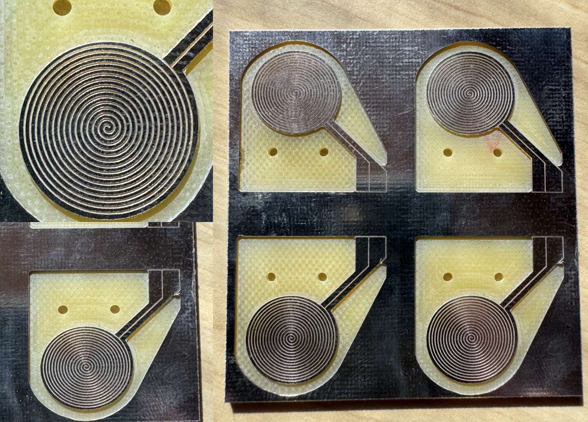

                                              Capacitive/inductive.
                                              Well, that covers such a wide range that you would first have to define what you mean. I presume you mean proximity sensors only?
                                              I use a capacitive sensor to measure Semi-arc, but it is stretching the term to say its a capacitive sensor it use a system of vanes and excitation paltes and pickup loops…The output is a DC voltage proportional to pendulum position – 2v at TAP, 0v and BDC. It works very well, can discern angle down to 8micro-radian, but took months to engineer it so that it’s tempco is better than the pendulum’s. A basic capacitive or inductive  proximity sensor, say at bob TAP, is not great at all, they all have , for this application, poor tempco’s – from a few PPM to many tens of PPM
                                              That said, I am testing an inductive sensor based on the TI LDC1612 – a 28bit resolution proximity sensor. It has some neat features, apart from the good resolution, in that the tempco can be completely nulled out.
                                              It can cater for 4 sensor coils – I use two, and when the bob is in proximity of the one, the reading of the other is use to check the value against an initial reference value – any delata is temp shift – deduct that from the next time ( 1 second..) the bob is there, and the tempco is gone…A small Aluminium disk moves with the bob and approaches each senss coil in turn. the values are summed, the tempco-vs-ref subtracted, and you have PP swing reading – these have shown to be as good as the Capacitive angle sensor. I am going to fit a Renishaw partial arc optical sensor early next year – this gives a count of around 100,000 per 1deg of swing, so 200,000 counts for my 2deg swing pendulum. ANd that is pretty absolute, except for the expansion coef. of the optical grating.
                                              So, beware when generalizing WRT sensor types..
                                              And, yes, this sensor has its own arduino nano, via a serial link to the main STM processor – data is sent leisurely between swings and likewise collected by the main STM (Nucleo) processor, whicjh in turn send all callected data ( timers, environmental, etc to the host logging PC..
                                              It is so much easier to analyse compromises, and odd values, if the system is compartmentalized and if each function is independent and does not rely on polling or interupts for timing. I speak glibly – I have suffered to get this far, and all it has taught me is that I am still on the start line..
                                              Not sure I have anything more to contribute here, so may bow out again..If it seems I am speaking from authority, scrap the idea right away. On the other forum I post on, I am proved to be at the very bottom of the pile – I have just had a few very good tutors.
                                                  0.003s per day.   Problem is you’re dipping into a project mid-stream and haven’t seen the rationale or goals, which date back two years.  My fault:  I’ve already noted the need to write an up-to-date statement. I did define accurate at the beginning of this topic though, my target is the Shortt-Synchronome, yours might be Burgess Clock B?
                                                  Screenshot From 2025-11-06 11-17-04
                                                  Nor do I expect it to be.   I’m trailblazing!
                                                  Yes, thread drift.  The tangents are a response to Duncan’s question, not what I’m doing.
                                                  … Again, because I do not know your definition of accuracy, and what your target is, maybe 1msec is good enough for you…
                                                  I agree, and it’s why I don’t use polling.  Not guilty.
                                                  I actually said: perhaps by clocking both in synchrony with the same crystal.  I didn’t say the microcontrollers need to be synchronous – that depends on the Use Case! No bad choices in system engineering either – I’d be reluctant to go that way.  Possibly I made the point badly – I’m explaining why polling is a bad idea in this application, and why using two microcontrollers to overcome problems so caused is also difficult.  We agree – avoid!
                                                  There are very few process that require ‘absolute’ timing discipline . Vane of Flag width is one. Use the hardware in the uP- don’t use software – a capture timer that captures the number of (accurate..) clocks between rising and falling photogate edges does it all. …
                                                  Again, the backstory has been missed.  What Joe recommends is in the Mk1 version of my clock, and will be in the Mk2 too.  Not there yet, because I altered the clock mechanically, forcing some software housekeeping changes in addition to upgrades.  Though several upgrades have been implemented and debugged, I’m having bother with housekeeping, like reliable starting.   The clock will have PET capability, the code is written and tested, just not installed yet.
                                                  Sonar!  I only mentioned sound as a possibility, not because I think it’s a runner.  Was trained explicitly not to discount options without due process.  Never dismiss solutions just because they seem unlikely, and because relying on experience misses opportunities.  I haven’t assessed sensor options formally, therefore my choice may not be the best.  Actually I know it isn’t!  Over a year ago John Haine recommended a Sharp photo-gate.  Then illness stopped the project, restarted last month.  In the meantime, John has moved on, has a better approach, so I need to change again. Good suggestions from others too.  So here I am:  Mk2 working isn’t yet, and a Mk3 redesign is looming…
                                                  Hoped that was clear from the context: accurate detection of pendulum swings.
                                                  Really interesting thanks, especially “it took months to engineer”.   I share your pain!
                                                  We are in violent agreement!
                                                  Me too!  The further I go the more I realise how much I don’t know.
                                                  Snap – what’s the other forum?  I should be reading it!   And what you’ve said here is much appreciated.
                                                  I’m very impressed by your clock and the thinking behind it.  Wish we could meet face to face and discuss clocks over a beer!
                                                  Back to my clock now,  hit another silly time-waster yesterday.  Here am I trying to beat Shortt, with a clock that doesn’t even start reliably!   And I’m pretty sure the pendulum is bent…
