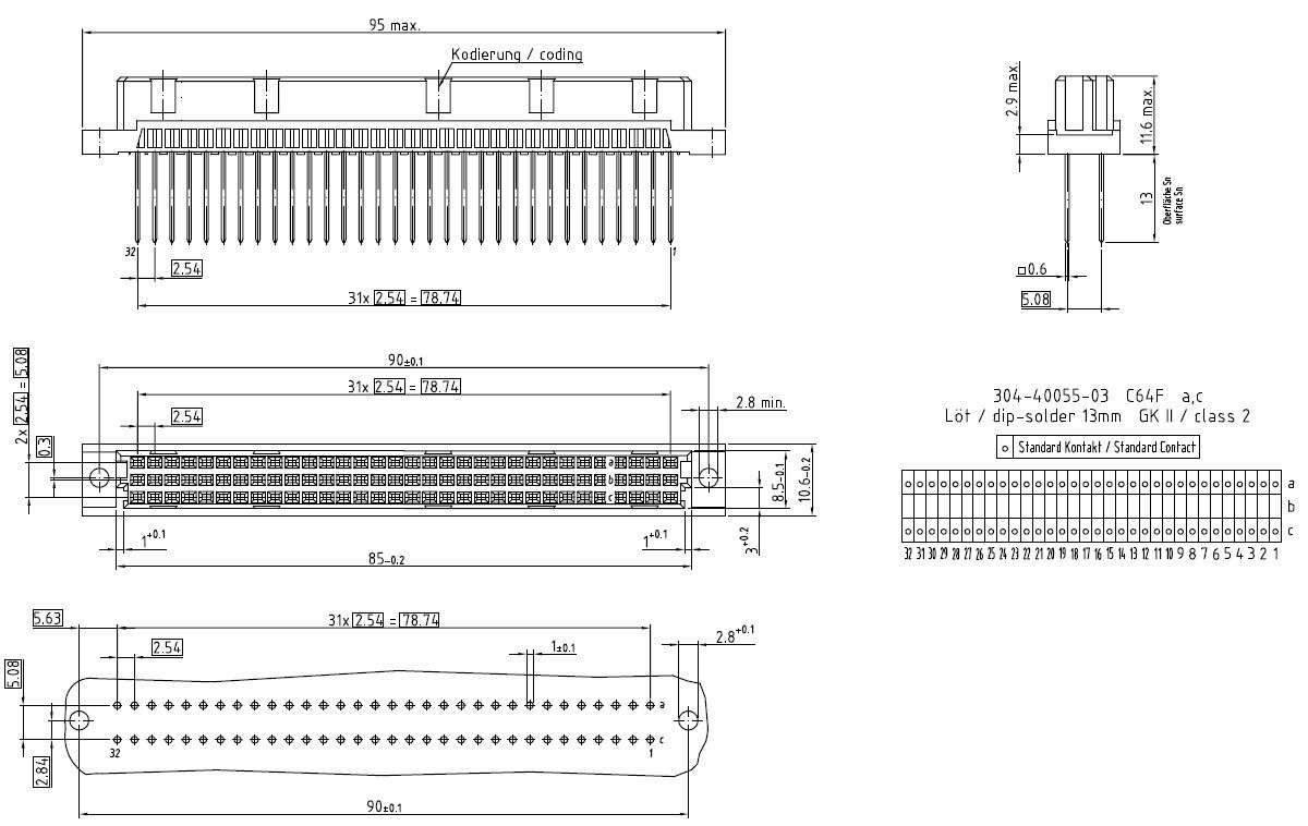

                  Having thought about how I would attach connectors to the boards that are spaced close together (too close) I have decided I need to obtain some DIN 41612 Connectors and put some ribbon cable between them. I can then plug out the boards, plug the board into the connector on the ribbon cable and plug the other end of the ribbon cable into the mother board. The boards can then be put  flat on the bench and all still plugged into the mother board.
                  Most of the boards have two 64 pin plugs. Four plugs will be needed per board, one plug at each end of the ribbon cable.   You could leave one (or perhaps two) of the boards plugged into the mother board and still have room on them to work.
                  Details of plug type on mother boar attached.
                  I need to get cracking.MOTHER_BOARD_PLUGS
