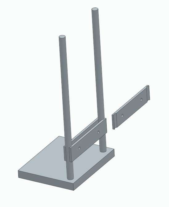

                  In the margins thought about stiffening the tower, and wonder if clamp on cheeks in between the fore-aft pillars would help.  Removable to allow access.  In place they inhibit fore-aft movement.  Could be few of them providing spaced out cross-bracing, or several could be used to wall most of the structure in creating a poor man’s box-girder.
                  Screenshot 2025-11-14 181037
                  The cheeks are grooved with an 8mm chord to grip the pillars, and could be glued with weak thread-locker. (Because they have to come off for access.)
                  Big problem is having so little space inside the vacuum chamber.
                  Is this idea worth the effort?

                      I think the first thing to do is find something solid to stand it on. It may well be that the clock frame is stiffer than the mount at present. It almost certainly is contributing less to damping.
                      Then some shear member connecting the top and bottom plates in a plane parallel to the plane of the pendulum  swing. Could be a bit of square bar bolted to the bottom plate between the uprights with a piece of sheet steel, say 1mm thick, 76 wide bolted to it and the top member. Friction should be enough to transmit the very low force.
                      Even strips bolted diagonally top to middle and middle to base, 2 X shapes one atop the other.
                      Sums to follow
                          Agreed.
                          On the to do list.  Requirements are:
                          • bracing must fit in the limited space available.   Adding cross-support would be a doddle if the pendulum wasn’t swinging inside a gantry and the gantry wasn’t a very close fit inside the vacuum chamber.
                          • bracing must be removable to allow access to the electromagnet, photo-interrupter, bob, and suspension.

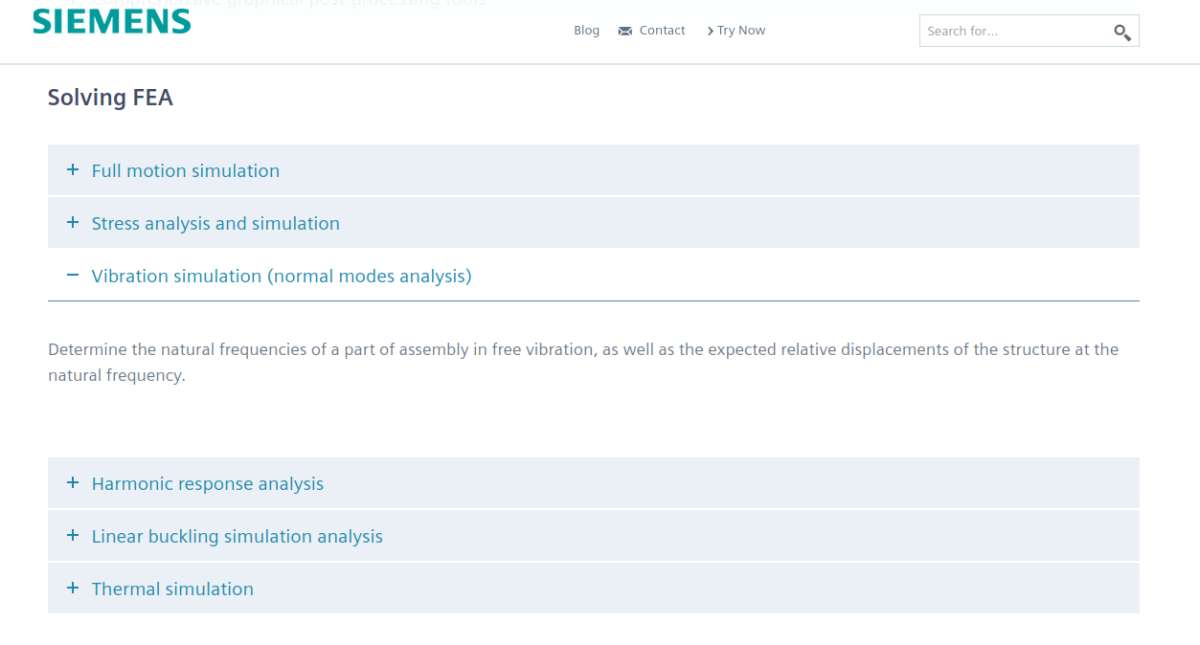

                              Interesti
                              On Michael Gilligan Said:
                              Given the design weight of 7kg, and the bottom-heavy configuration, it would be a relatively simple matter to suspend the clock ‘free-free’ using bungee cords.
                              Observing its behaviour in that condition would help highlight any mechanical issues with the construction.
                              Interesting idea, sort of naively done already by comparing Q on a table-top with Q on a solid-floor.  (My clock’s Q on a solid floor is almost double that on my dining table.  Shows there is a problem.)
                              But you mean something smarter I think?  Revealing how far the gantry moves and in what directions as an aid to minimising deflections inside the clock. How would you instrument the structure?  I have zero experience or understanding, and am pretty sure none of my engineering books cover it beyond saying it’s done.
                              Solid Edge can do vibration analysis so it might be possible to model it.
                              Screenshot From 2025-11-15 22-21-04
                              I can provide the model if you’re up for attempting the analysis.   Too much for me to take on, and I’d be starting from square one.  Ignorance is not bliss!

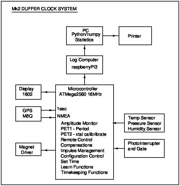

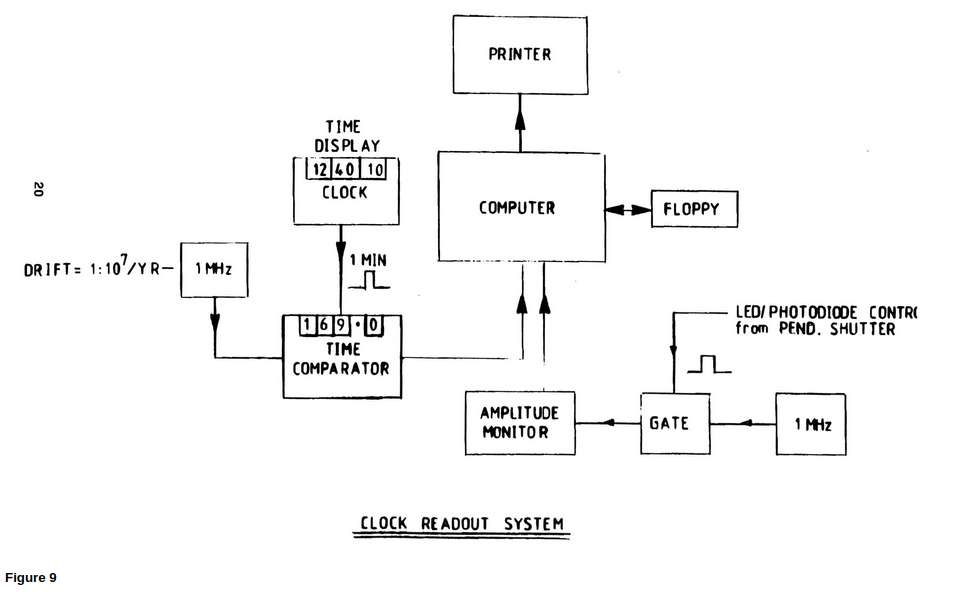

                                    For comparison, this is the Livermore Clock’s block diagram:
                                    Screenshot From 2025-11-15 23-34-00
                                    And my Mk2:
                                    clockSystem
                                    Many similarities, except Professor Hall’s clock is much better made and isolated than mine. That he failed is worrying, I’m doomed!

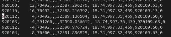

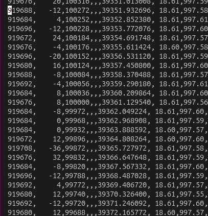

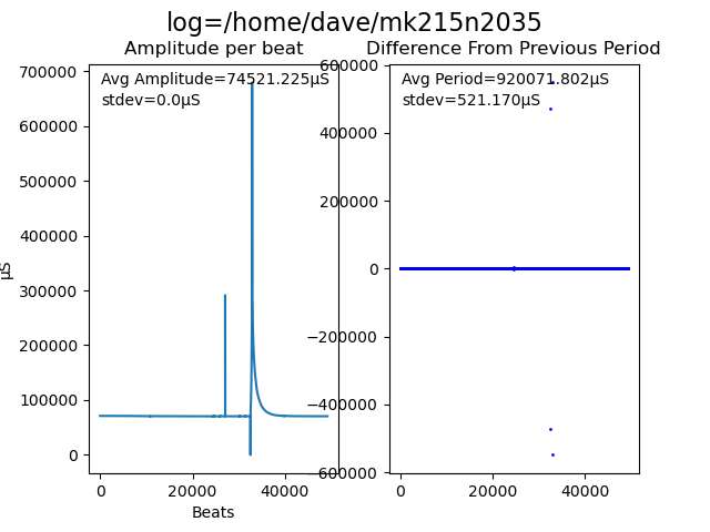

                                            Results from last night’s run, which is testing reliability not accuracy.   Had some bother setting impulse power so that amplitude neither rises or falls, and noted some odd racing and stoppages.  Almost as if the pendulum is tightening and loosening.  Could also be a photo-interrupter or software problem.
                                            There shouldn’t be any spikes in the left-hand graph.
                                            mk215n2035
                                            The first spike is a double counted beat, backswing and downswing both counted.   One error in 50000.  Hmmm,
                                            Next event shows amplitude dropping to zero (much too high), then decaying quite rapidly.  Then, for no apparent reason, amplitude slowly speeds up, and returns to normal.   Period isn’t badly affected by either decay or recovery.
                                            First glitch: amplitude jumps from to 70492 to 291260, then back to 70492μS.   A misread!
                                            Screenshot From 2025-11-16 09-21-04
                                            Second glitch: amplitude slows to over 100000μS. then picks up speed, up to 99688 on the screen, thereafter gradually accelerating back to normal.
                                            Screenshot From 2025-11-16 09-29-48
                                            I think the impulser may be getting out of phase with the bob.  It’s supposed to impulse on the downswing only: if the electromagnet impulses on the backswing, it acts as a weak brake.  If it gets back in phase, the impulse accelerates the bob, and it speeds up again.  Matches the data, but why?.
                                            Next step – see if it happens again. If it’s a software bug, there may be a pattern.  Absence of pattern suggests a mechanical or electronic problem.
                                            Measuring is double edged.   Wouldn’t have noticed this problem had I been clock-watching manually!  And if I hadn’t seen the graph, I would be happily turning and milling metal, not typing this!
                                            #824824
                                            blowlamp
                                              @blowlamp
                                              I suspect some of this could be due to slight rocking.
                                              Could you setup a DTI next to the clock (at the top) to see if it moves as it swings and if walking around the room has any influence?
                                              Martin.
                                              #824831
                                                Martin.
                                                Yes, though I doubt my 0.02mm dial is sensitive enough; maybe with a lever?  The pendulum is disturbed if I clump around the room.  The Mk1 version, with a similar pendulum, detected heavy traffic in the road, and the Moroccan 2023 earthquake.
                                                I wish you’d posted before I moved the clock yesterday! I put it too close to the wall, so now I can’t bounce a laser pointer off a mirror on to a wall 8m away.  Amplifies the movement, and Mk1 caused the distant dot to wobble, less than a millimetre.  Not tried it on the Mk2, but the mechanics are almost identical.  Thanks for reminding me!
                                                The glitches occurred at about 01:30 last night. Should have been quiet.  Maybe I was sleep-walking.   Or, this house moves as it cools overnight, various odd creaks.
