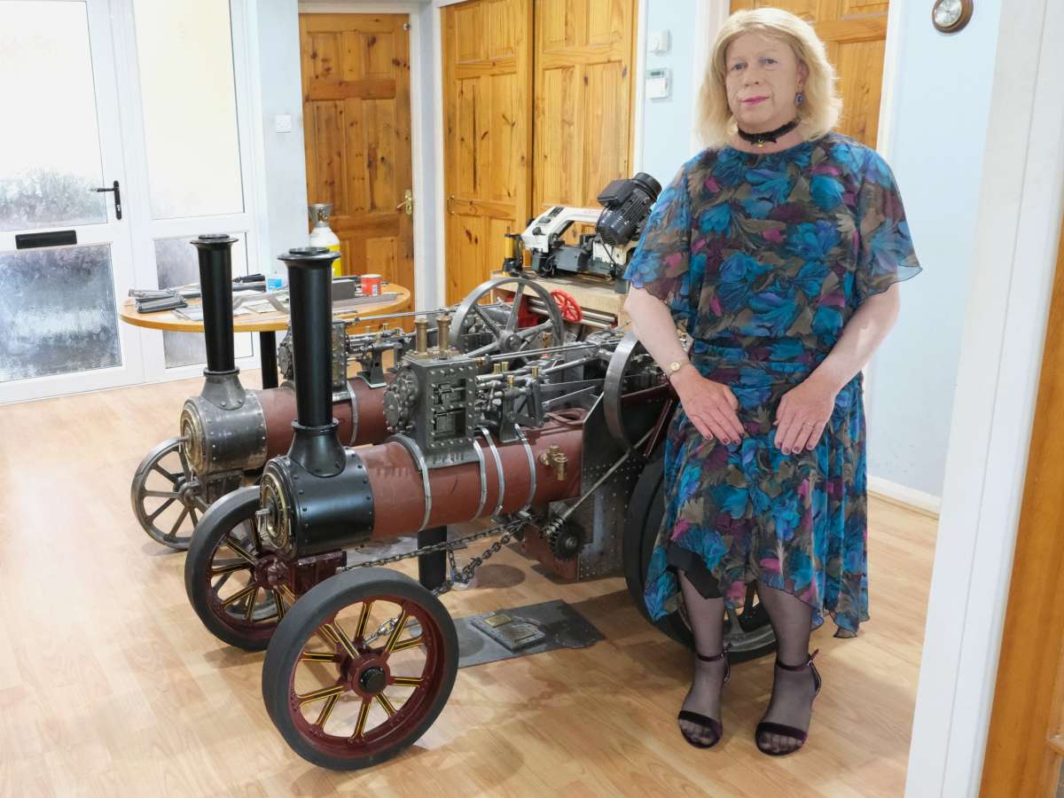

            Here are some pictures taken during a recent visit. The engines and yours truly:
            Julie - Engines

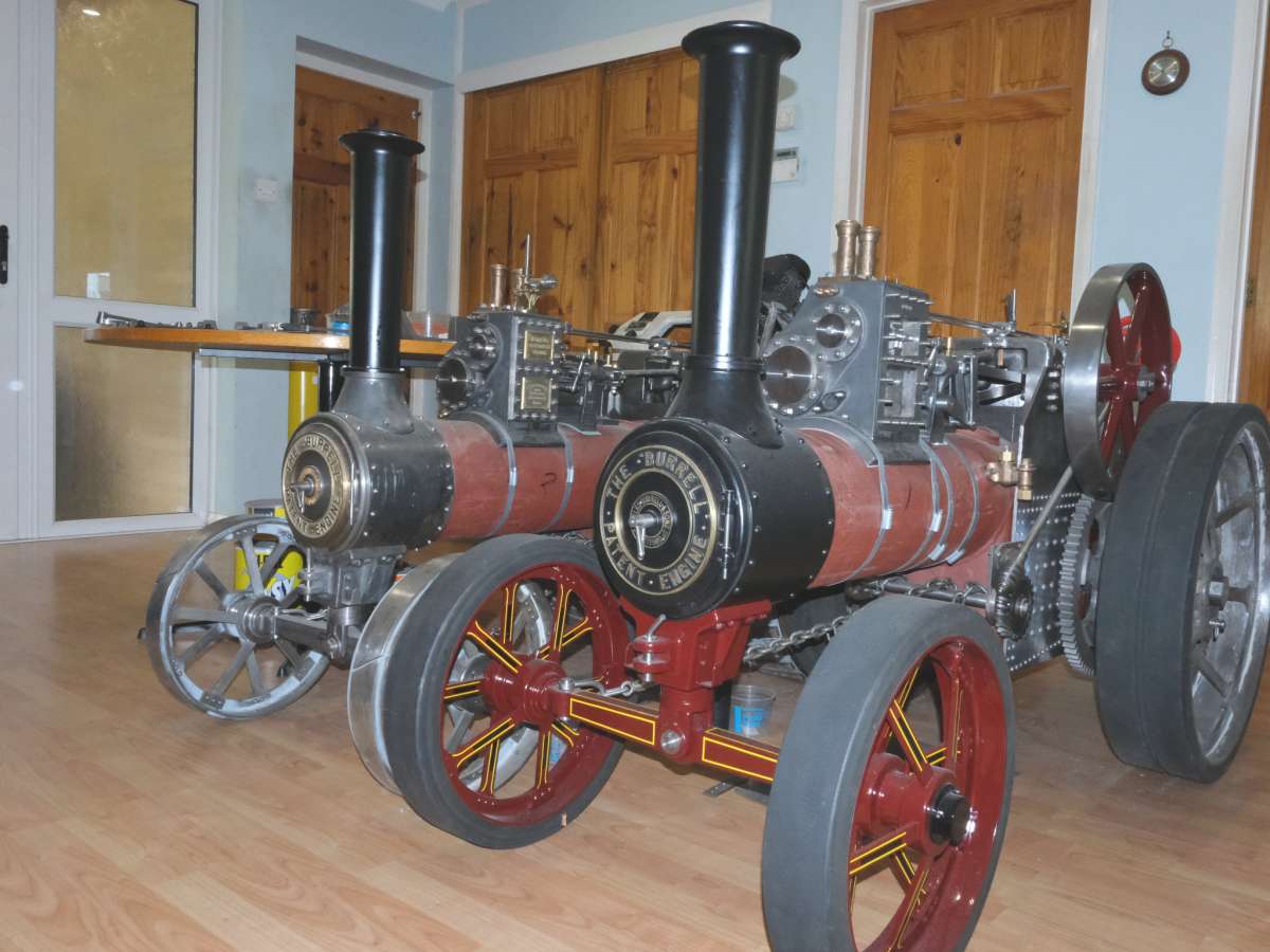

            The engines on their own:
            Engines

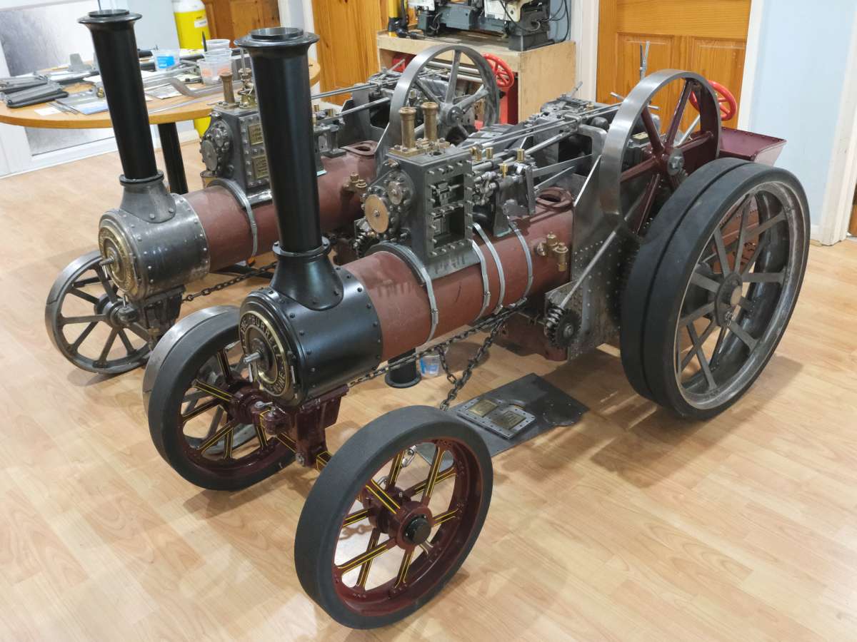

            The front end of one engine is complete:
            Engines - Front End

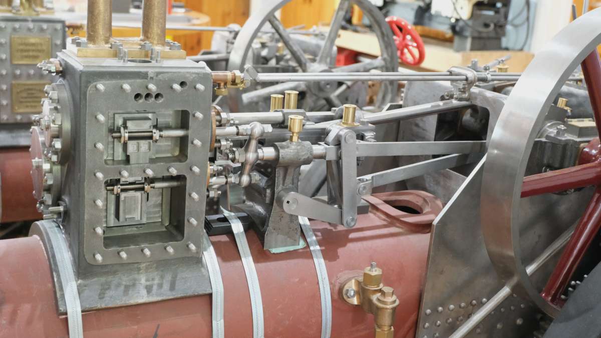

            The valve gear is complete, as are the steam/exhaust ports and the slide valves, all to his own design:

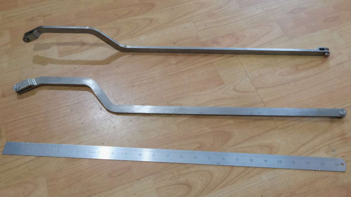

            Reach rods complete:

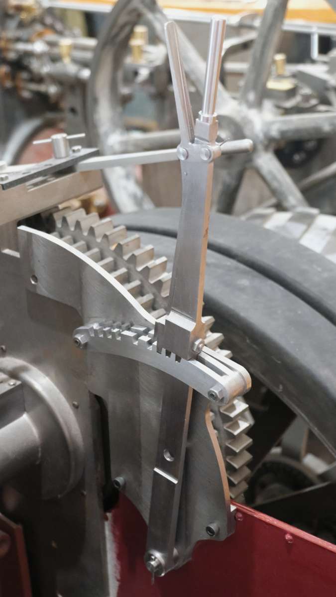

            The reversing levers are also nearly complete. Note the tapered slots, which are not radial to the quadrants but offset. As per fullside there is a small clearance at the bottom of the tongue. A side project is to make some small brass plates which go on the quadrant and indicate ‘Working Position’, which will be taken as 50% cutoff.
            Engine - Reversing Gear
