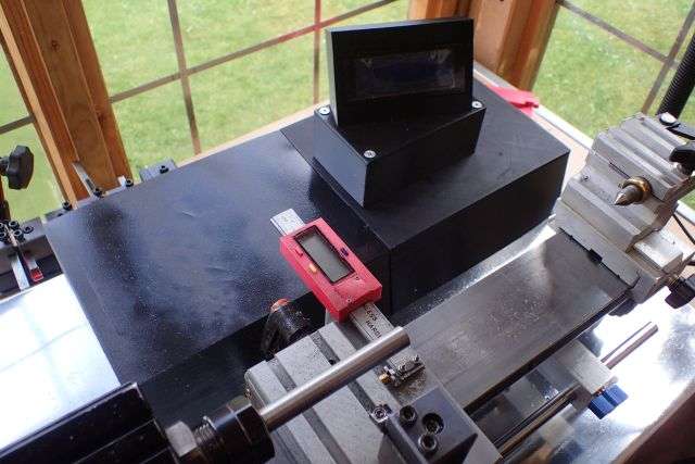

      I have just acquired a MS-272-100 Digital Linear Scale from M-DRO to fit to my little lathe. Having tested it, it reads inverted to the way I would prefer, i.e I would like the readings to go positive where now they are negative.
      Does anyone know if switching the slider round relative to the read head  will alter the direction of reading?
      I have asked M-DRO and they don’t know but will ask the factory.
      The other way is just to try it, but I thought I would ask here first.DRO image

                  It’s a very small lathe, and the new scale is intended to replace this one
                  DRO Image184
                  which is a five year old lash up based on the inners of a set of very cheap callipers and some 3D printing. It’s getting tired and a bit cranky, and it reads sideways. However it does read positive values as the tool moves into the work, and negative if the tool moves out.
                  For size reasons I need to mount the head of the device behind the carriage (as the existing one) and have the cross slide move the slider.
                  Unfortunately, with the head mounted so that the display is correct, moving the cross slide into the work makes for negative readings while moving it away produces positive ones.
                  But I am sure I will get used to it.
                  With hindsight I could have bought one of the kind with a separate display, and simply turned the scale round, but that would have meant wires and more hassle to mount the display. So I will prersevere.

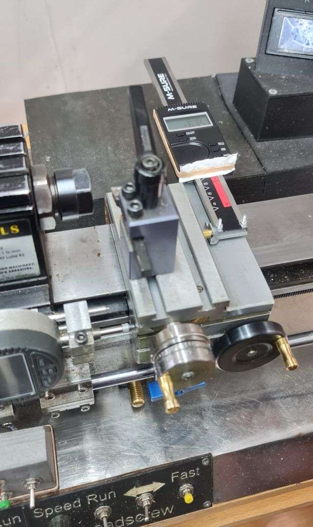

                                Peter Cook 6
                                  @petercook6
                                  Thank you Michael for the kind words. All installed after making suitable new brackets, complete with custom scale wiper!!
                                  New DRO
                                  Probably going to have to cut a bit off the scale to stop it catching on the display – but that can wait until I have to.
