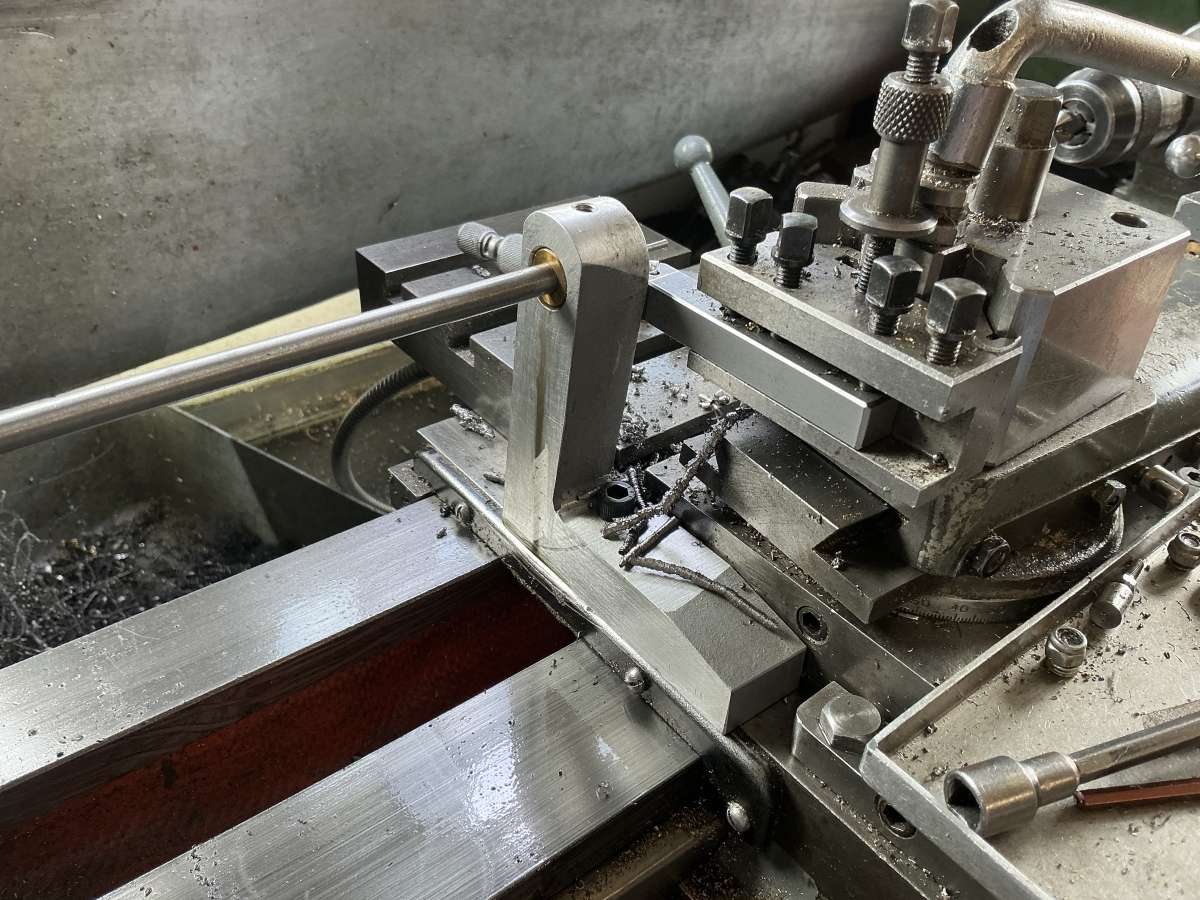

      Farm Boy again.  Making the valves.  3/8 dia valve head with 1/8″ dia x 1.4″ long stem in stainless.
      Lathe:- Boxford 9″ dia
      I have some stainless which turns OK but trying to turn the long stem as the workpiece flexes is giving unacceptable run out.  Do you step turn say 1/2″ to diameter plus 0.001″ then turn the next 1/2″ until required length, then burnish with emery cloth?
      I think 1/8″ is too small for travelling steady.
      Ideas please.
      Bob

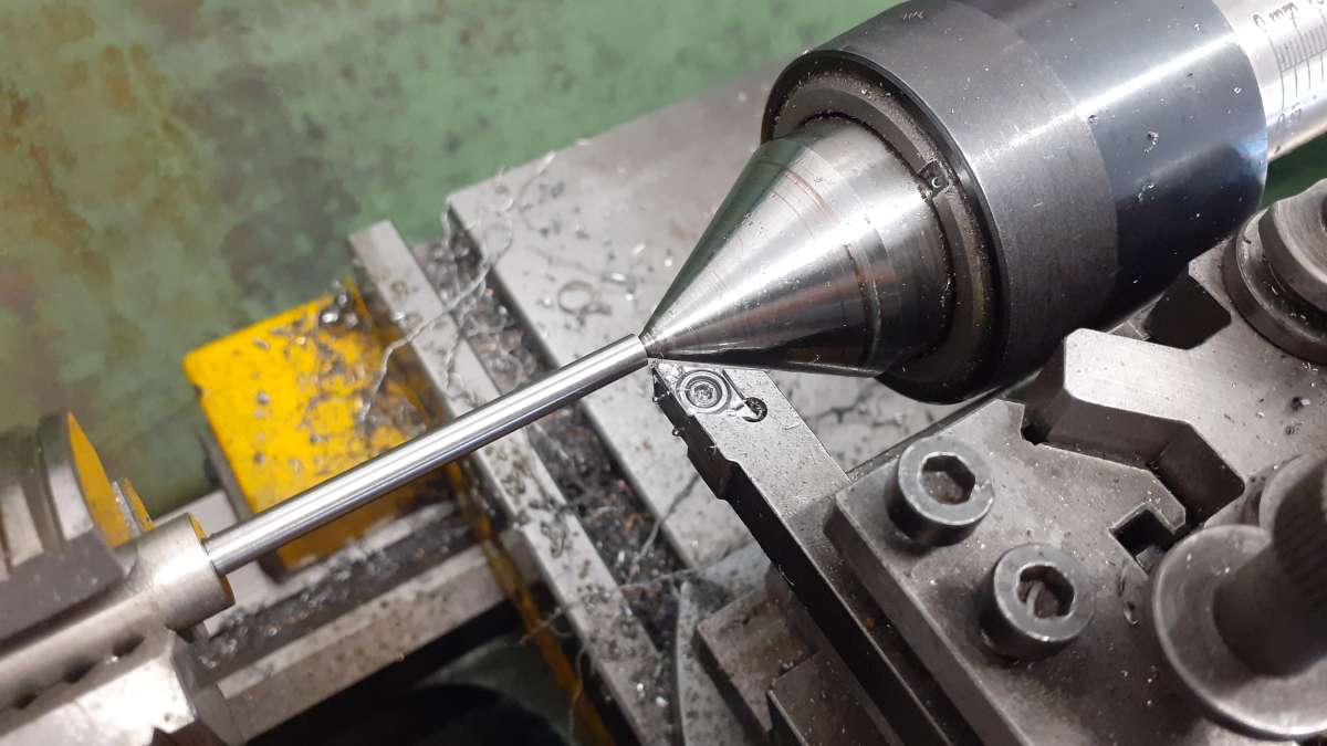

        I just use a BS 0 ctr drill and put a very small hole in the end so I can turn valve stems between ctrs. Never had a problem with them not sealing. Use 303 stainless

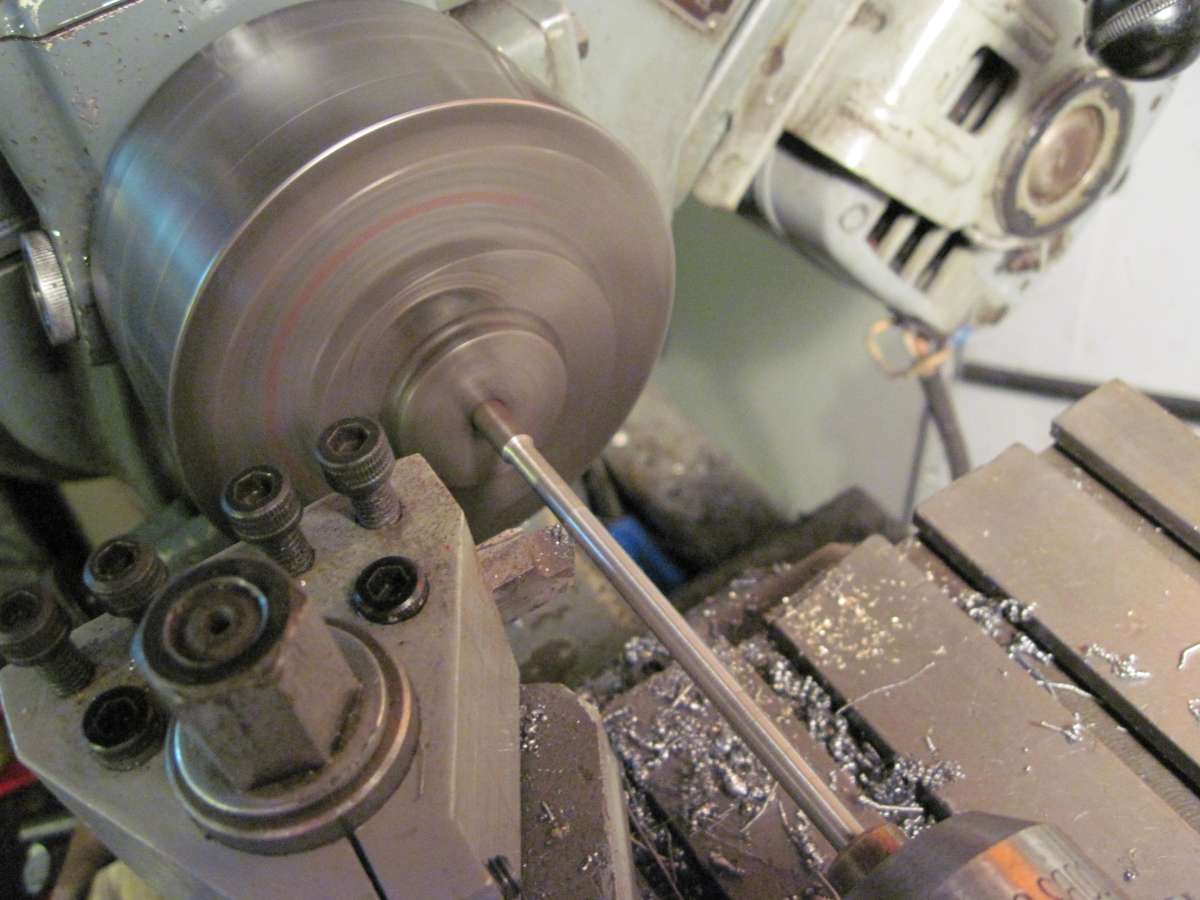

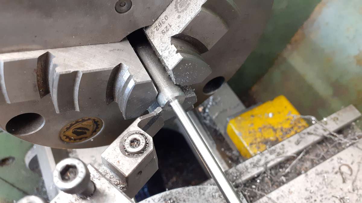

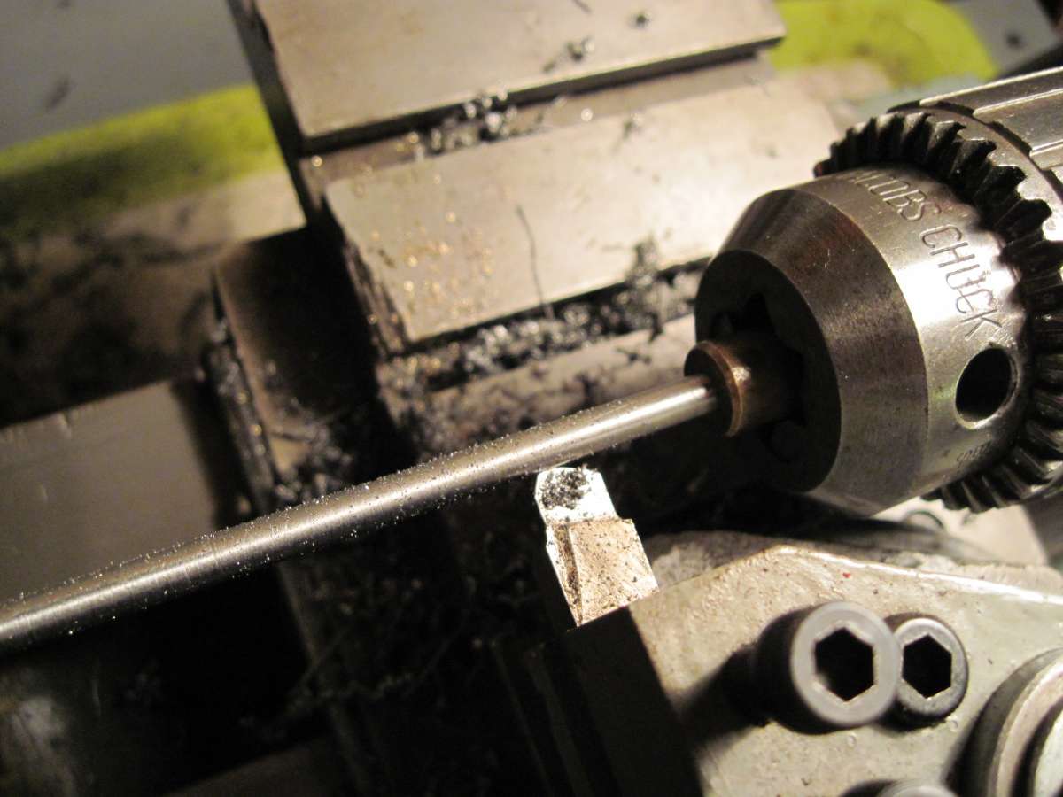

          In the past I’ve drilled a small bushing held in my tailstock drill chuck to the materials diameter and used that to support the material…a form of between centres turning.  I also have a tool-holder with a ‘guide’ that can be drilled to the (un-machined) diameter of the piece and where the cut happens as the metal is fed through. Can’t recall ever using it though. Seemed useful when I purchased it!  🙂

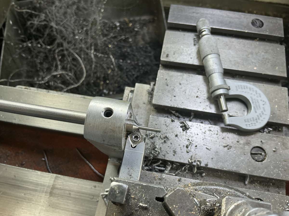

                small dia turning tool, easy to make
                #861168
                duncan webster 1
                  @duncanwebster1
                  Here’s one
                  I’ve also seen one with a brass block with a vee cut in the end so you can adjust it to different diameters. Basically it is a turning tool with a built in travelling steady. As others say, you go from full diameter to finished in one cut.
                  Hemingway do a kit as well, which looks a bit easier

                        +1 for IanT’s use of a bush in the tailstock chuck. If you’re turning slender diameters, using a centre can impose significant buckling loads on the workpiece – and it’s likely to get hotter as the cut proceeds if you aren’t using flood coolant. A bush gives exactly what’s needed – radial support. Some lubricant on it is a Good Plan, too.

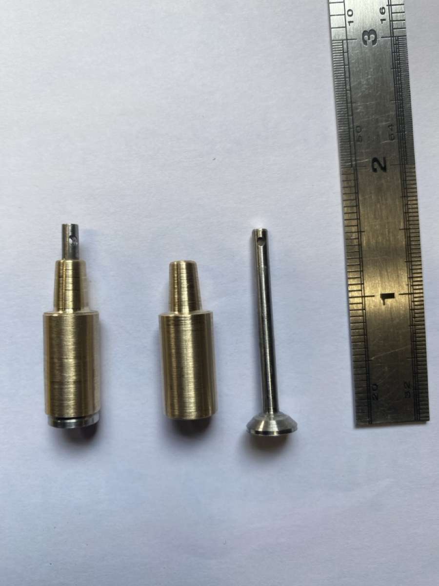

                            Mission accomplished, I followed Jason’s advice by turning up to a centre.

                              Good job did you remember to make one a little longer than the other

                                Yep, 0.10″ – need to machine the ports in from the sides of the cylinder head without bogging it all up!
                                As to the cylinder head, I went for M4 cap head screws and as the top screws came mightily close to the screws which hold the Water Hopper, placed them 40degrees either side of the vertical (instead of 45), and made pockets in the head such that the head of cap screws are sunk level. I that makes sense.

                                  #861549
                                  bernard towers
                                    @bernardtowers37738
                                    This is using the simple tool from Hemingway. 0.250 down to 0.0625, the tool is dcgt tipIMG_4146IMG_4145

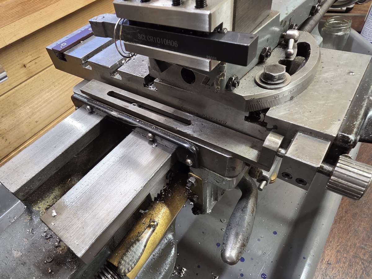

                                    #861562
                                    ega
                                      @ega
                                      bernard towers:
                                      Is that a cross slide lock that is seen in the bottom right of your second photo?
                                      Presumably, the tool tray is “just visiting” ie not a permanent fixture?
                                      #861596
                                      bernard towers
                                        @bernardtowers37738
                                        blimey your observant yes its a crosslide lock, block of steel with two holes vertically and two custom bolts to replace the myford items and a threaded hole horizontal to the fixing bolts with a socket grub screw and brass pad, verypositive as its on the plain dovetail side not the adjusting screw side. The bits and bobs tray is in MEW somewhere and yes its a slide in slide out item.
                                        #861599
                                        ega
                                          @ega
                                          On bernard towers Said:
                                          … its a crosslide lock…
                                          Thank you for elaborating that. I can see that it is more positive than the alternative and probably more accessible depending upon the position of the topslide. Not an obvious option for me as I have a full length wiper between saddle and cross slide where your lock sits.
                                          Another candidate for this position is the ingenious click stop described by the late T D Walshaw.
                                          #861665
                                          bernard towers
                                            @bernardtowers37738
                                            My son has the TDW version on his trileva, when I can get to him I will post a photo as it doesn’t seem to be avail on the net.

                                              #861719
                                              bernard towers
                                                @bernardtowers37738
                                                Is this what you are looking for ega20260821_195248-1.?
                                                #861745
                                                ega
                                                  @ega
                                                  bernard towers:
                                                  That is indeed a version of TDW’s screwcutting depth stop as described in WPS 28.
                                                  Your son seems to have taken good care of the bed on his Trileva. I wanted one rather badly before my Super Seven came along but having since added a VFD I suppose I shall now manage without!
                                                  I noted the neat ball handle lock on the topslide.
