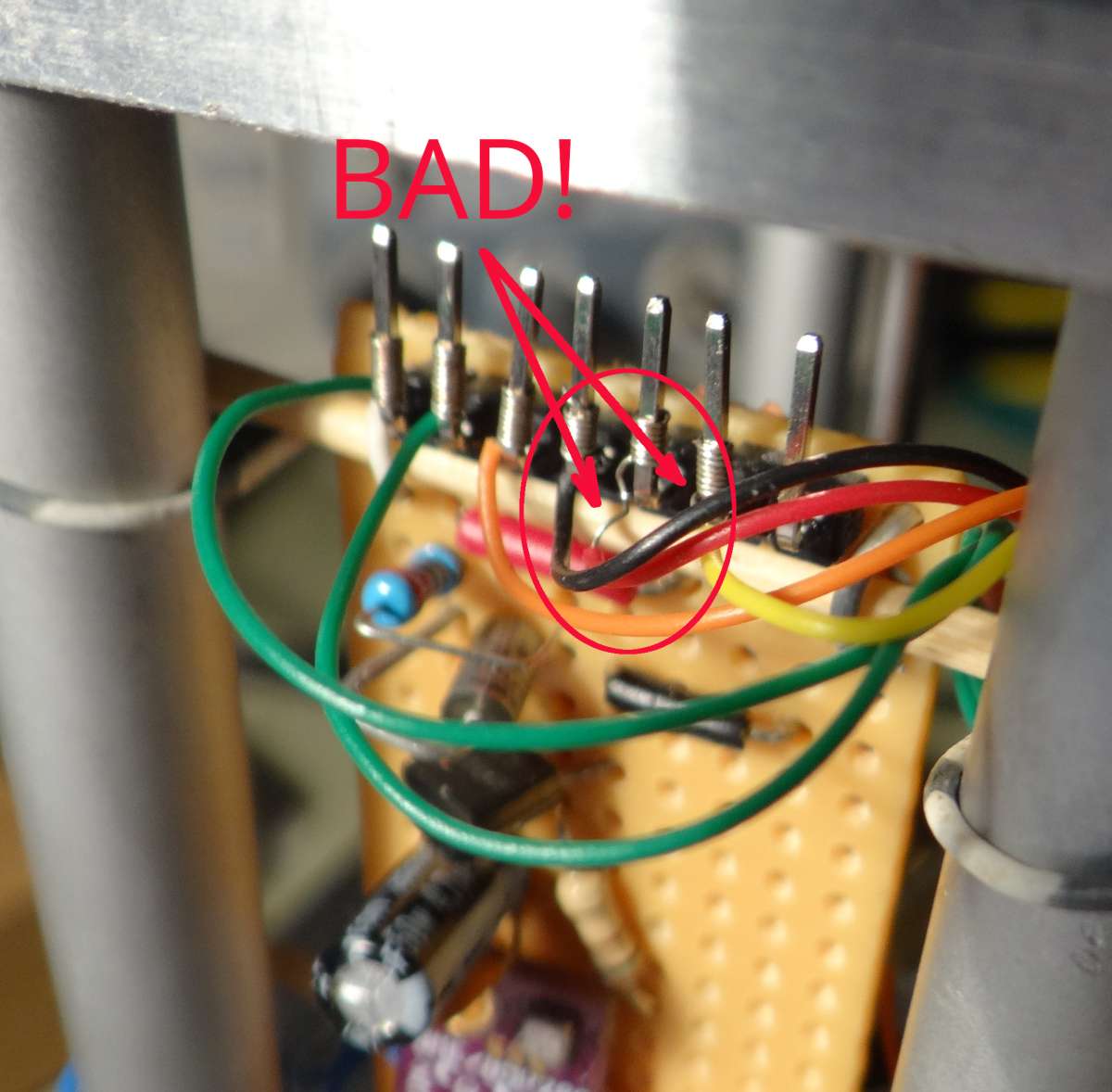

            • The flashing LED problem isn’t software, it’s faulty wire-wrap! When installing the revised magnet holder pulled on the wires, it left red and yellow touching intermittently.  Red is 5V to the opto sensor, yellow is it’s output, chaos!  Really annoying, I’ll have to rewire the lot.   Perhaps a good thing – was forced to use some too short pins, and have longer ones on order.  And a few other mods need the clock to be dismantled.

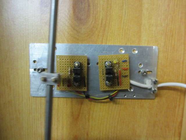

                  I’ve come to the view that opto-interrupter type photogates using devices such as the Sharp “GPA…” (which I have recommended in the past) are actually not that good because of the ambient light problem and the rather large gap. A better approach in my view is to have a deep narrow horizontal slot in a block with emitter and detector below and above – the narrow slot helps to keep ambient light out, and having the detector look down minimises direct ambient light falling on it.  Then use a horizontal blackened vane attached to the pendulum with a narrow slot in it to let light through at BDC.  Again the vane helps to keep ambient light out.  The IR LED and IR photodiode mounted in holes in the block with small apertures.  The slot in the vane then can also be sensed by another emitter/detector pair offset from the first to sense when the amplitude gets too high and inhibiting the impulse.  Or better perhaps, reducing the impulse amplitude until the amp sensor is triggered on alternate swings.
                  Gravity escapements don’t have to have pallet friction – Arnfield’s gravity detached escapement shows how it can be done.  Though I’m “locked in” to magnetic impulsing for current clocks, I think you have to use amplitude control based on actually sensing the pendulum amplitude for precision (rather than the photogate time). There’s too much variation in drive current and magnet strength with temperature otherwise. I’m toying with the idea of a gravity escapement on Arnfield lines but using opto sensing  and a stepper to reset the arm.

                    Apart from having the vane blackened, that’s pretty much what I’ve got. The vane is a bit of ally soft drink can, slot width is 3mm I think, but it’s a long time ago. I make no pretence to precision, but it only gets put right when the clocks change. If I make another I’ll make sure both LEDs are pointing up, I think less likely to be affected by outside light. I used thin ally as less likely to damage the sensors if the suspension gives way, but it’s ben running for 20 years or so. First attempt was plasticard, but it didn’t seem to interrupt the beam.
                        Cruel world, this upgrade uses a Sharp GPA… on your recommendation! Performs better than my first implementation, a modified Arduino distance detector plus narrow slots!  But I’m sure you’re right, a deep narrow slot would be better again.  For the time being I’ll stick with the Sharp.  Might be accepytable – ambient light isn’t be a problem in my clock because the pendulum swings inside a light-proof pipe.
                        Similar to my thinking, which is a relief.  I have a blackened vane, and the clock is ‘levelled’ to trigger at BDC, or at least as close as I can get with an oscilloscope.  The clock is first levelled with a bubble, but then tilted slightly on the adjusters so the rod plumbs BDC.
                        Noted thanks.  I’ll carry on with the photo-gate approach to see how stable I can get, but this may be next.

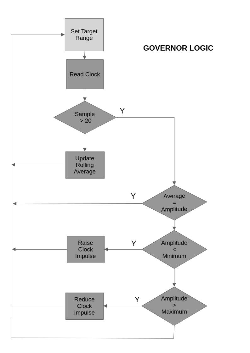

                            Mmmm, what do others think?  I’ll carry on for the moment. Done in software so easily switched off if the jury find me guilty.
                            The goal is minimising the difference between beats, requiring two steps:
                            • Finding the optimum amplitude (not done yet – I guessed)
                            • Writing a governor that maintains amplitude near optimum by tweaking impulse power. The governor works.  Here’s the flowchart:
                            clockGovernor

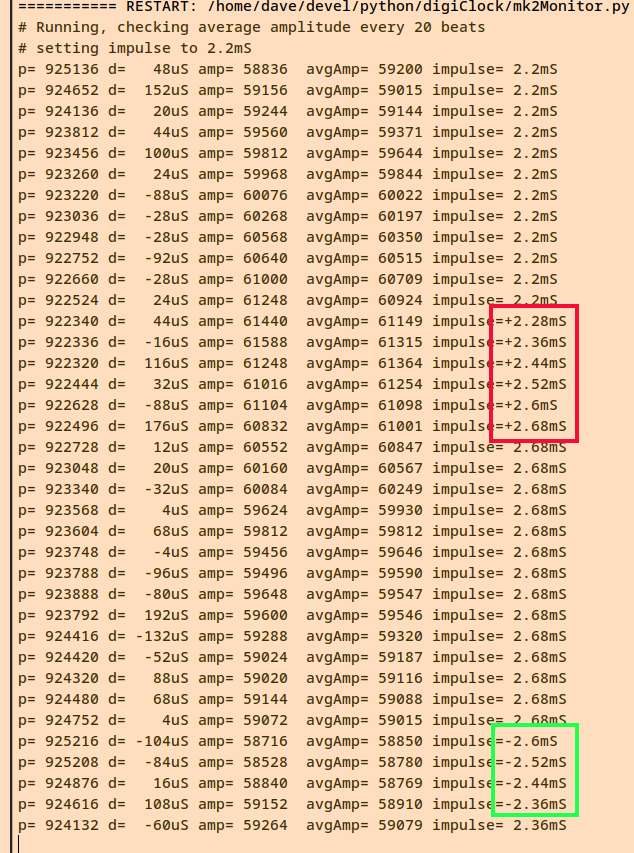

                            The governor samples 20 amplitudes and then compares the rolling average is within the target range (60000 ±1000uS).  If the rolling average is below the lower limit (amplitude falling), the clock is ordered to increase impulse by 0.08mS.   If above the upper limit (amplitude rising), the clock is ordered to decrease amplitude, also in 0.08mS steps.
                            The log shows a 2.2mS impulse keeps amplitude within range for  240 beats, but it’s not strong enough.  So the governor increases impulse over 120 beats up to 2.68mS.  It finds that to be too strong after 280 beats, and then reduces impulse in 6 steps over 120 beats down to  2.36mS.  Changes highlighted in green and red.   Considerable hysteresis.
                            governorlog
                            At present all the parameters are arbitrary.  Target range, impulse increment, and sample size, all guesses.  I don’t know how to set them logically.    Inappropriate settings cause the governor to hunt or fail to get a lock, or to respond too violently, or too slowly. Needs more thought.
                            As implemented, gut feel is it’s too slow.

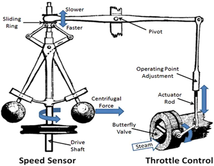

                            It’s behaviour is analogous to a mechanical governor, where the balls are replaced by the bob mass, gravity by a magnetic field, the drive shaft by a rolling average,  the operating point adjuster by a target range, and the throttle valve by impulses.
                            Schematic-representation-of-James-Watts-steam-engineer-flyweight-governor-See-text-for
                            Does anyone understand how to design governors?  I’ve exceeded my understanding and have no experience.  More swotting, and I’d rather watch telly.   Doesn’t help that James Watt was much smarter than me!!!
