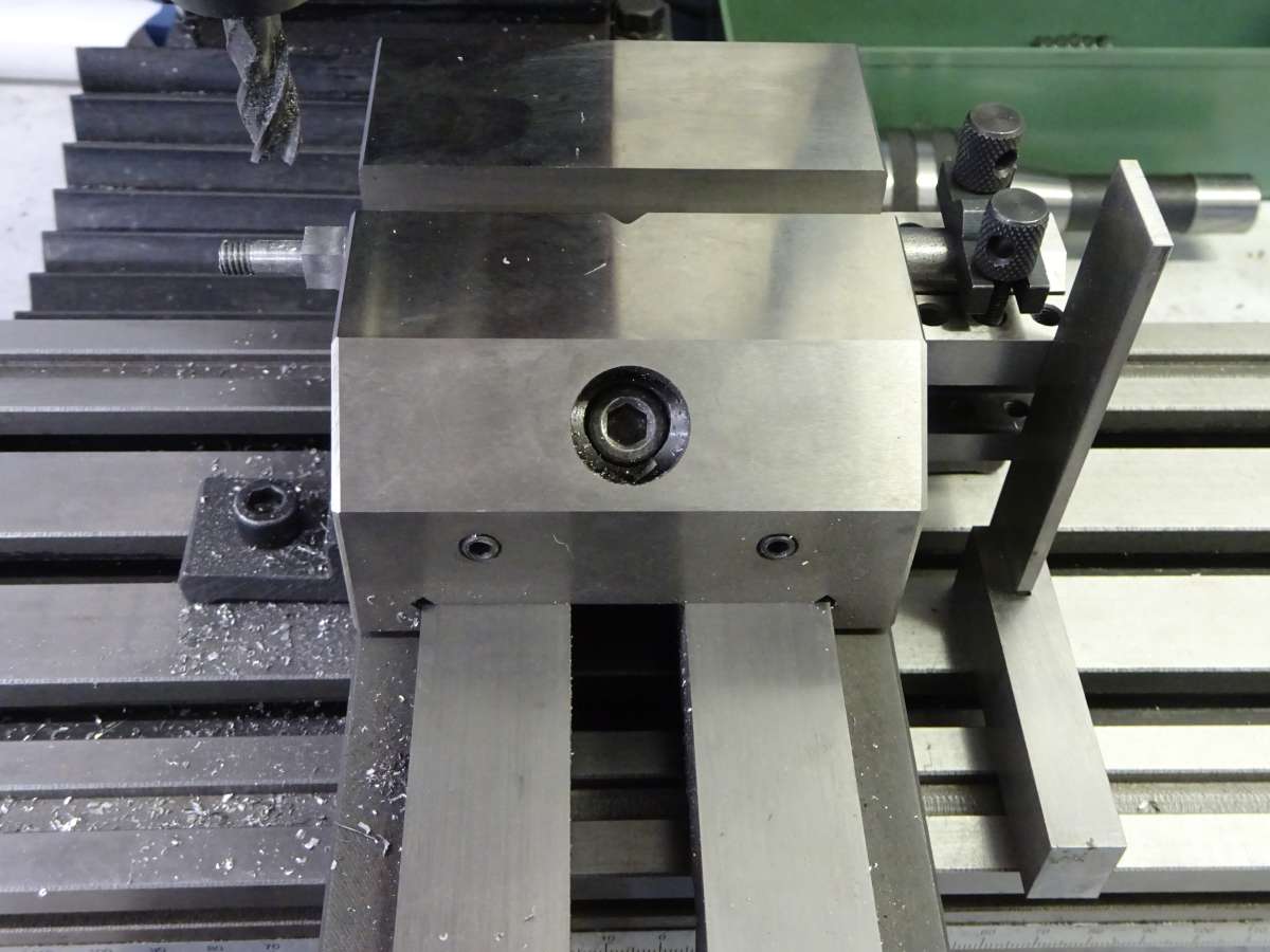

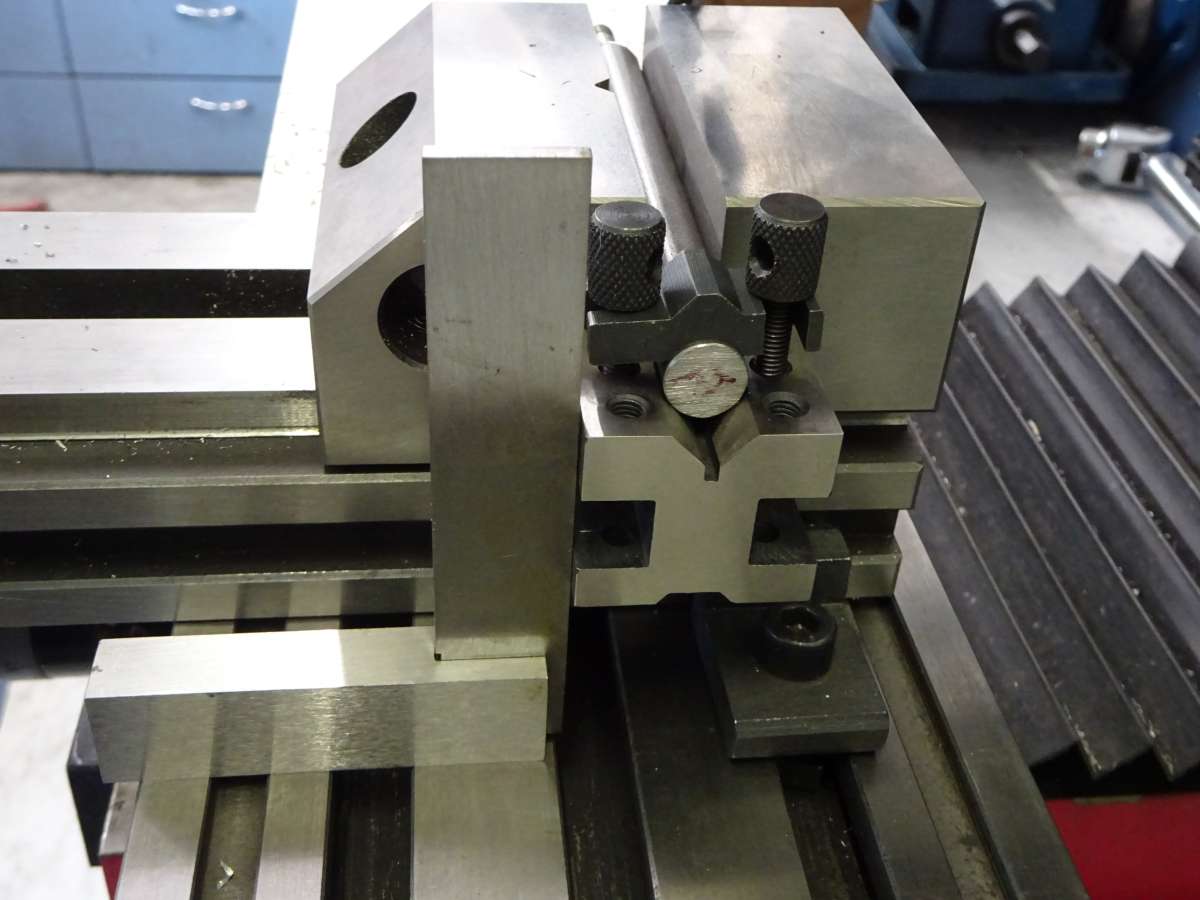

                    I have got to make two special 7BA hexagon headed bolts with a 3mm diameter fitting area in the middle. Not an off the self item! I shall have to machine them myself, but finding a small length of 0.170″ hex bar is a bit of a problem. Kennions have the bar but with the postage costs it becomes expensive.
                    If I had an indexing fixture it would be no problem, but I haven’t. I think I shall have to put a hole down the centre of hexagon bar to hold a piece of round bar so I can use it to index the six sides on the round bar. Now, have I got a piece of hexagon bar big enough? Never stops !!!

                    DC31k
                      @dc31k
                      What you haven’t is that you haven’t thought through the problem.
                      I suspect you have at least a hundred suitable indexing fixtures in your shop.
                      Superglue a hexagon nut to a piece of round stock. It does not need to be concentric. Set one side of the nut vertical using a square to the bed of the mill. Cut a flat on the round stock. Repeat five more times. The stock of the square will move fore and aft on the mill bed at each indexing, but who cares?
                      #861266
                        Wot a bit like this, substitute a plastic 60/30 set square for the tri-square

                        #861399
                        Neil A
                          @neila
                          Of course, you are all quite right, I am completely over thinking the problem. There are many very simple ways I can go about this, but thank you all for your ideas. Yes, I do have enough bit and pieces in the shop to complete my task, I had just failed to keep it simple.
