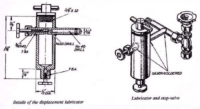

      I wish to make a couple of displacement lubricators to the above design. Main body is 7/16″ diameter, smaller bottom section is about 5/16″. There is a cranked handle drain plug in the base and a drainage hole just below the chamfer, marked with a blue dot. I really need some assistance please with working out how to engineer the drain plug so that when you partially unscrew it it allows the condensate to drain out the small hole. My brain just isnt getting there! Any help/sketches would be much appreciated. Thanks in advance, Chris.

        Stepped hole in bottom of body, large one for thread small one for valve seat. valve is reduced dia to allow condensate past and out the drain hole which is just above the threaded portion. you could investigate the stuart turner design.

          Hi Chris,
          Is it something like this you are looking for?
          DisplacementLub
          Just above the arrow pointing at the 7BA drain plug there is a small drain hole.

            Thank you Bernard. Great thanks, I understand that! (-:
            Yes I have actually made missing drain plugs for the Stuart design, but could not translate that method in my mind to the required design.
            Thank you Thor, yes that looks simple enough for even me to machine, the diagram is perfect! (-:

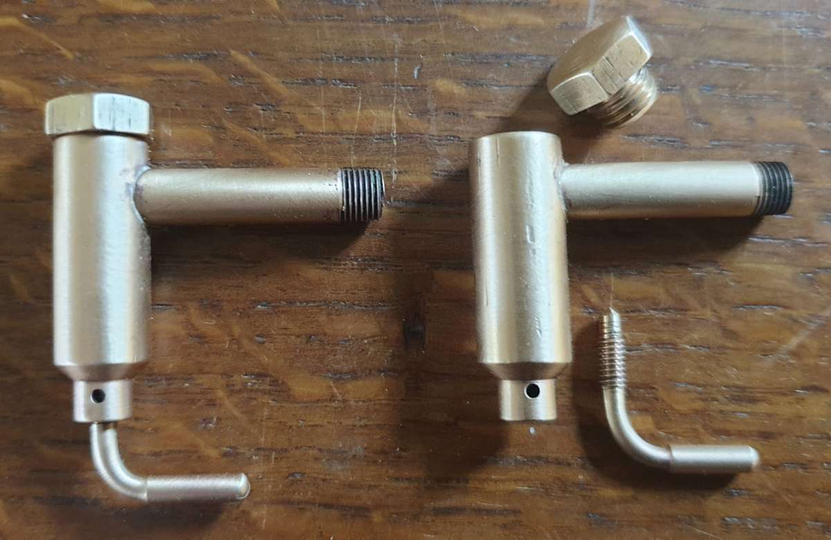

              Boucher LubricatorsFinally, after more than two years I got around to making the lubricators. Helpful chap in the USA supplied me with many measurements and even the correct threads to use, so thought I best have a go. I got them nearly right (-:

                Hi Chris,
                Your lubricator looks good.
                Thor

                  Another way is a small groove like a miniature keyway down the thread, being careful not to cut into the coned part.
                  #861517
                    The groove tends to blow water and steam onto your fingers if you are not careful, with teh hole it blows it away from you.
                    I have used the slot for oilers where the oil runs down the slot to the conical seat.
