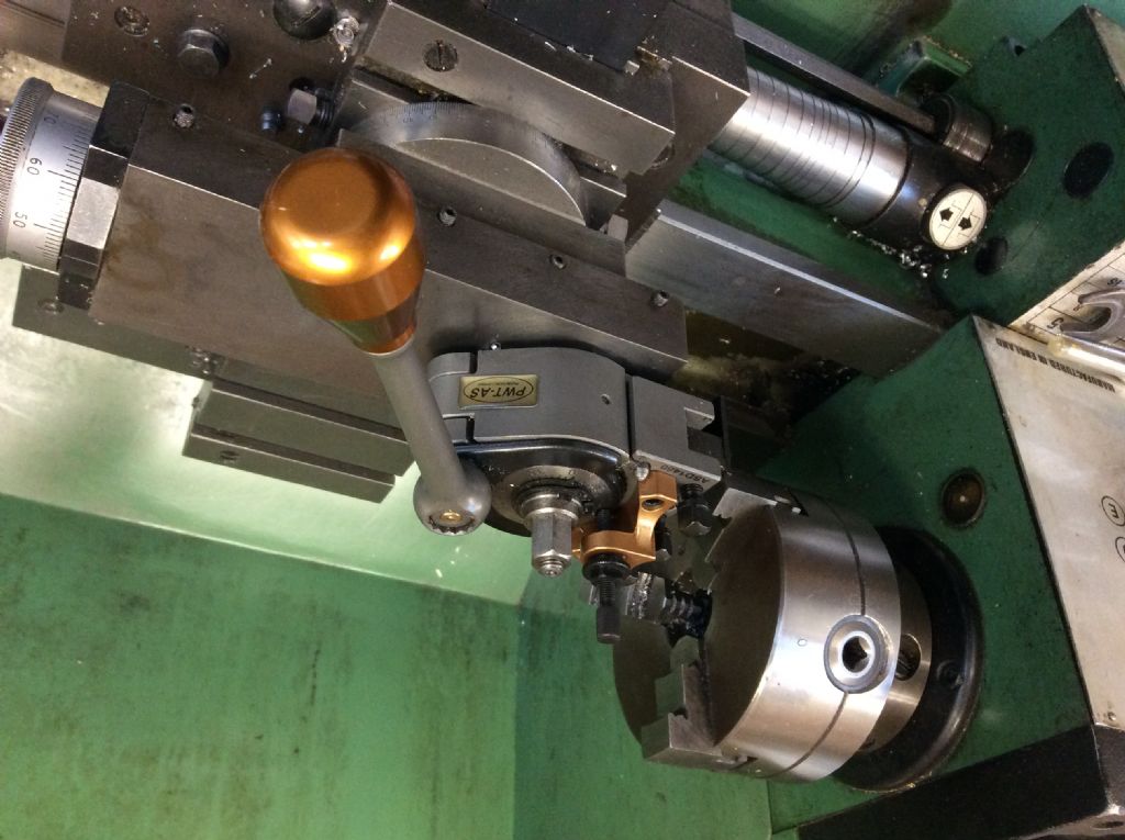

                  IanH
                    @ianh
                    Here is my 254 with PeWe Tools size AS.
                    personally I wouldn’t bother with a rear tool holder for parting off, can you not just modify the tool to suite the tool post?

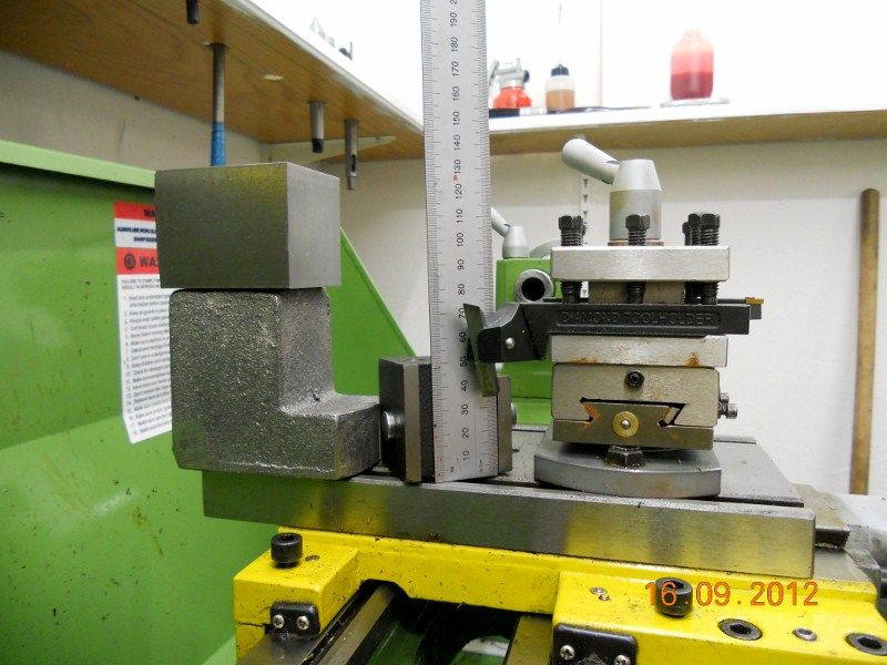

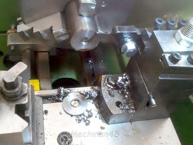

                                        mechman48
                                          @mechman48
                                          I made a rear tool post from the Hemmingway kit, it works well but you have to be aware that the tapered side doesn't leave much room for centre height adjustment. I reverted to the horizontal slot side, using another type of holder placed upside down & run the lathe in reverse, bolted on chuck I must add, on a Warco WM250.
                                          It has now been relegated to 'for use later; maybe' as most of the small stuff I part off can be done easily with front holder under power / hand feed without any concerns.
                                          Casting kit…
                                          Establishing centre height
                                          Assembled tool holder
                                          Test cuts…
                                          Look in my album 'Rear tool post' for more pics.
                                          George
                                          Erratum.. '& run the lathe in reverse', should read 'run in normal rotation'
                                          Edited By mechman48 on 22/04/2021 12:01:53

                                          Dave Wootton
                                            @davewootton
                                            Thank you for posting that George, it is extremely useful, particularly the shot with the rule included! I can now make a decent judgement on whether it would suit my lathe. I'm a little concerned that a rear toolpost may get in the way for normal turning, the cross slide is shorter than on my previous Bantam, the post I made for that overhung the back of the cross slide slightly. Even so one always had to be mindful of not running one or other of the lathe tools into the chuck or work.
