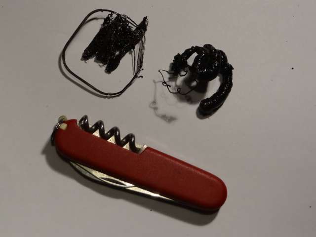

      Horribly derailed yesterday.  I modified the electromagnet holder in Solid Edge and designed a box to hold the LCD Display. When I tried to 3D-print the part that supports the Sharp Opto-sensor, my printer went wrong.  This was “fixed” previous thanks to an earlier thread, but I only cleaned up rather than fit new parts.   Done several perfect big prints, but this one isn’t quite right…
      DSC06961
      Problem seems to be the filament drive slipping and friction in the Bowden cable.  Now it’s been removed, the Brass drive is more damaged than I realised, not a good photo, worse in real life:
      DSC06966
      Mid-way through putting new parts on the printer, visitors arrived, so I’m still delayed.

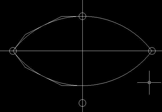

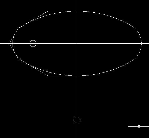

                          An approximation using 120 degree cone, 60 degree truncated cone and a parallel bit you can grip.. You can increase the number of cones as much as you like. Basic ellipse is 2:1 drawn using arcs of circles approximation (which is very close)
                          Screenshot 2025-10-28 115116

                                  On SillyOldDuffer Said:
                                  ……..because the centre of mass changes during the swing.
                                  Sounds right to me.
                                  Eh?
                                  To my mind the advantage of sphere is that it doesn’t have to have its axis aligned with the direction of travel
                                  Heres a pointy one  from cones
                                  Screenshot 2025-10-28 162923

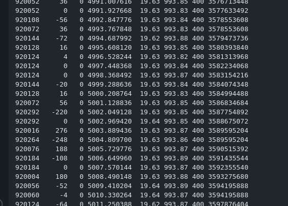

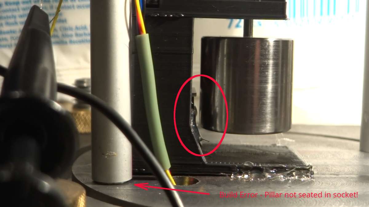

                                          Massive improvement after moving the electromagnet closer to the bob.
                                          Previously the clock started unreliably when set to deliver one hundred 450mS beats, now the bob crashes hard into the electromagnet when the starter is set to only six 4mS beats!
                                          The run pulse is much smaller too, previously staggered along on 80mS.  Now the run value is somewhere between 1.62mS and 1.8mS.
                                          Nothing is ever easy!
                                          1. I want to adjust the impulse so the bob gets up close and personal with the electromagnet without quite colliding.  Gap about a millimetre.   Mild collisions can just about be heard as slight ticks, but better to see.  So I took a video and went through the frames.
                                          Near miss:
                                          bobMagnet
                                          Other side:
                                          bobAntimag
                                          2.  Now realise should have made the magnet drive and sensor output available as test pins on the front panel.  An oscilloscope is handy for setting up with the lid on.  Also, a multicolour LED would show more status info.
                                          3.  A LED flashes on the front panel when the clock is ticking.  Worked perfectly before, now flashes erratically even the the oscilloscope shows the impulses are correct.  Software bug.
                                          4.  The Arduino is programmed to log results to a PC and to accept commands; I can change the impulse.  The log looks like this:
                                          clockLog
                                          First column is the period in microseconds.  Second column is the time difference between beats.  /  Third column is GPS HHMMSS, zero because the module isn’t plugged in.  For the same reason col 4 is counting plain seconds rather than UTC – the clock isn’t set yet.  When GPS is plugged in, I can command the microcontroller to synchronise within microseconds of UTC, way more accurate than setting hands!  Cols 5 and 6 are temperature and pressure, needed for compensation,  Col 7 is the impulse value; the number is a counter timer setting, where 400 is 1.62mS,.  The last col is the difference between clock and GPS time, not working because GPS isn’t connected.
                                          Ideally the beat difference should always be zero. Therefore next job is to write a PC program that reads the beat time difference value and tunes it to near zero by sending the clock ‘changing impulse’ commands the optimum is found. Beat difference can also be used to govern the clock set to beat several times between impulses.  Rising differences mean the bob is losing amplitude.
                                          Better accuracy, I hope, from a clock that can optimise it’s escapement and – potentially – stabilise amplitude on the fly.  I don’t believe either is possible mechanically.
                                          Diito temperature and pressure compensation; done by calculation based on a statistical analysis, not mechanically. Seems to have advantages, but the idea may be unsound!   This the next experiment.
                                          5. Have to sort out a vacuum valve.  Unless someone has a better idea, I’ll try a Presta bicycle valve connected backwards.  No ides how to connect it to the plastic 4mm evacuation pipe – probably have to make an adaptor.  Then seal the pipe and the access hole.  Liquid gasket and hot glue maybe.   Whatever, I’m sure it will leak!
