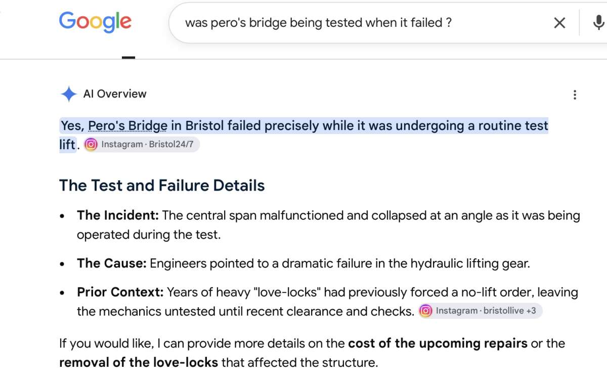

                                                  Looking at peak4’s link, if you place a brick or something else solid between the upwards pointing teeth, the teeth will lift out of engagement and the bridge will then have no horizontal constraint as it rolls, allowing it to move forward as can be seen in the first video
                                                  #861927
                                                    Duncan
                                                    Although your analysis makes sense … one would have hoped that ‘test engineers’ would have checked for foreign objects before commencing their work.
