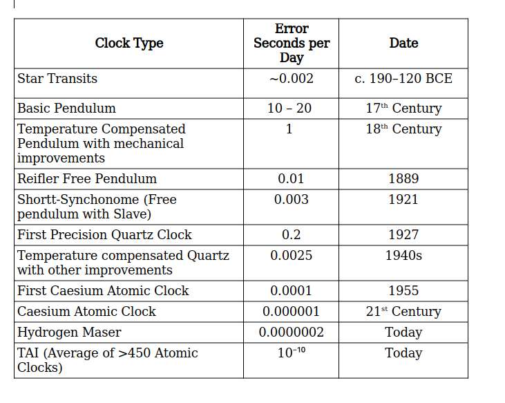

      Roughly speaking, the Shortt clock is just accurate enough to detect astronomical time varies. A good Quartz clock circa 1945 definitely sees planet earth is wobbling, and an atomic clock sees more discrepancies.

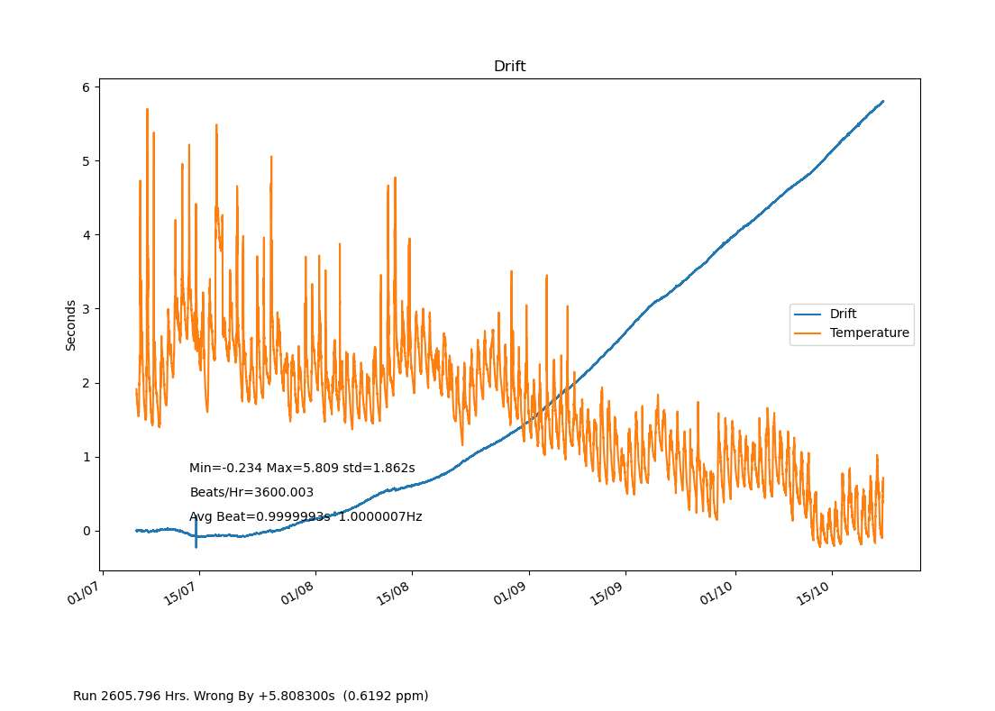

      Anyway, having built an Arduino PET, and able to exploit NTP, I thought it worth testing both against a moderately good electronic clock, one I built using another Arduino fitted with a Temperature Compensated Crystal Oscillator.  No data-sheet for the TXCO, but it turned out to be fairly good. Gained 5.3 seconds over 108 days, noticeably better than my domestic quartz clocks and wristwatch. The wristwatch  keeps good time because body heat keeps it close to constant temperature and they all come with a specially ground crystal.
      Why is my TXCO clock drifting? I don’t know! It ran without significant drift for about a month, and then began to gain at a roughly constant rate.  There may be a correlation with temperature, but if so it’s slow acting. The yellow temperature line shows temperatures peaking at 37C during July, and then the average slowly dropping as the planet tilts away from the sun as we approach the winter solstice. Average 30°C down to average 18°C, and falling!  Sadly, I had to stop the test before the central heating was allowed on to keep the TXCO cosy.   Ideally the test would have run for more than a year. Might set it going again in an unheated spare room on a UPS and come back to it in a year or three. You can’t hurry time measurements.
      Here’s the graph, plotting temperature and time:
      digiCloclGraph
      The yellow temperature line shows wide daily swings that don’t seem to affect the TXCO at all, so the effect may not be temperature related. Maybe the crystal is aging due to mass transfer (dirt inside!) or stress. Stress includes movement of the structure supporting the crystal and the crystal itself due to temperature changes, and these would accumulate consistent with the graph.
      My electronic clock’s error is about 0.049s per day, twice as good as anything made before Reifler’s 1889 Free Pendulum clock,  But that expensive beast beats me by a factor of 5.  The reason Quartz ousted pendula is that they’re immune to vibration, gravity, air-pressure, mechanical problems and other factors that upset pendulums. And can be improved in many ways not limited by mechanical difficulties.
      So there we have it: an electronic clock that outperforms most pendulum clocks is defective!
      In the month before it started to drift, I doubted NTP time was fit for purpose. NTP shines in the long term by resetting the computers internal clock periodically, but that means the computer’s clock can wander between NTP corrections. Some are better than others.  Less frequent synchronisation is one reason raw Windows is more likely to be off than raw Linux. Linux isn’t perfect: the NTP software is being replaced by chrony, which I have yet to evaluate.   Also, the clock I’m measuring doesn’t do leap-seconds, whilst I’m comparing it with one that does; Unix CLOCK_REALTIME is UTC. Maybe I should switch to CLOCK_TAI, which ignores the planet entirely and just counts seconds. Except the last leap second was added in 2016, so not that!  And TAI currently differs from UTC by 37 seconds.
      Any ideas about what might be causing the drift or spoiling the measurement?

          I’d suggest a failing TCXO. Probably drifted outside of the available compensation range or the temperature sensing circuit has drifted / failed.
          By the way crystals are not immune to gravity effects. I can easily see a frequency change in realtime as a good 10MHz OCXO is rolled through 180 degrees (2G change).
          I suggest you get some OCXO’s. At least 3. There are some ex-telecom used ones available from China at very low cost. The come as just the OCXO or assembled on a PCB.

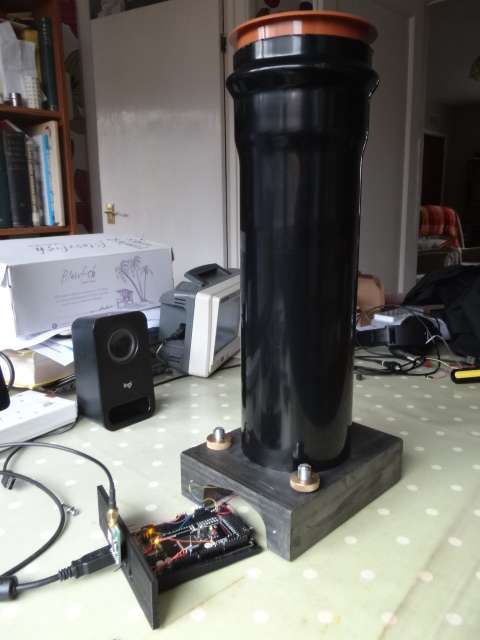

            Ah yes, but I’m trying to outdo Shortt’s pendulum clock with my pendulum clock.
            DSC06955
            The soil pipe can be evacuated once I’ve sorted a vacuum valve.  Unlikely to hold a hard vacuum, but it might do 0.8bar.  After going for a PVC pipe I realised the plastic will probably gas, and pull out the plasticiser, causing wormholes.  I’m sure the pipe will hold 2bar but a vacuum is different because gas molecules are smaller than water.   We’ll see!  A friend has a length of Aluminium pipe that might replace it, but sealing the top is too much trouble at the moment.
            The green module plugged into the front panel is a Ublox M8Q GPS: it’s used to set the clock accurately, and then find the pressure and temperature compensation values.   Then it’s unplugged and the pendulum keeps time on it’s own.   A display can be plugged into the same socket to show time, and time is also logged to a PC via USB.   The PC can send commands to the clock, so I can experiment with impulsing the bob on every beat, or allowing it to swing several times between impulses.  In air I found it best to impulse on every beat, but may be better to impulse less often in a partial vacuum.    Also possible to change the software without touching the clock.
            I’m sure it’s possible, not least because Shortt didn’t have access to reliable electronics.  But I also have to prove my pendulum clock really is better than his.  Hence my need for a high-end way of measuring precision pendulum clocks, ideally in the 0.0002 second per day region.   Not possible with the original gold standard (star transits), but achievable with GPS, and an OCXO might do.  Or I could buy an atomic clock.
            As I write, the latest rebuild of my Shortt basher is reluctant to start, and only runs for about 20 minutes. The previous version started and ran reliably, but though good by ordinary pendulum standards, it was considerably inferior to Reifler, leaving me to improve it by about 20x to get up to scratch.
            Made several changes causing new problems.  Why the clock doesn’t start and run reliably might be the subject of another thread.  I’m hoping the bob is too far from the electromagnet, and I can fix it by installing a fatter bob.  My understanding of the relationship between the bob’s inertia and the strength of the magnetic field needed to move it is poor.  The strength of a magnetic field decreases with the cube root of distance, which I thoughtlessly increased.  Result, adjusting the impulse is incredibly finicky, and I’ve not found the happy medium.  The bob either crashes into the structure or loses energy and stops.   Being a little too far from the electromagnet would explain the faulty starting too.  Not the end of the world because I can change the holder to bring the electromagnet closer if need be.  Fortunately, the holder is a Solid Edge 3D model that can be reprinted in a few hours provided I get my act together! Making a bigger bob on the lathe is an easy job, but the mass may be too much for the electromagnet.
            All very annoying because the planned improvements and parts needed to have another go were put in a box when illness forced me to stop last year.  When I opened the box recently it was empty!  And I’m only semi-remembering what needs doing.  Arghh!

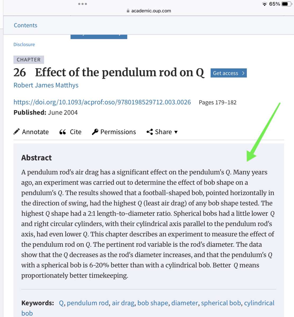

                            Best shape for bob is reputed to be like American football, but I can’t find reference.
                            For ally tube, try combi boiler flue suppliers
                            #821880

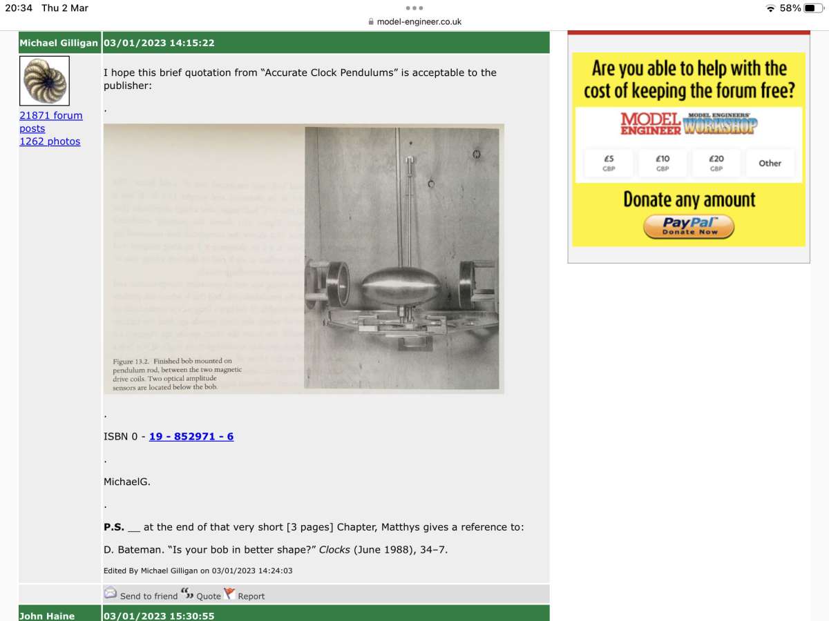

                              Almost sure it was Matthys, Duncan
                              … I will check later
                              Ref. __ https://www.researchgate.net/publication/344573673_Accurate_Clock_Pendulums

                                No, Doug Bateman.
                                #821892
                                  You’re right, of course, John
                                  Matthys cites Bateman’s experiment
