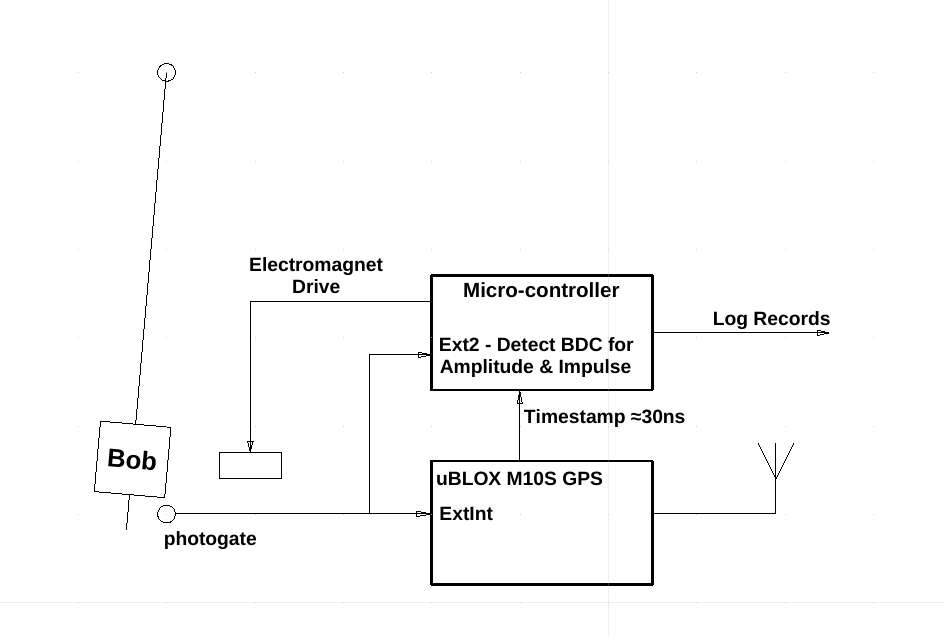

                As I’m making agonisingly slow progress, Martin’s video was just what I needed for a laugh.   Never take a hobby too seriously, it’s meant to be fun!
                The BME280 was innocent.  Problem was 3 bad connections.   The clock was on the floor in a tight corner, and, rather than lift it out so I could see what I was doing, I crawled in and badly wire-wrapped the duff joints by feel.  They were all loose, yuk.   If a job’s worth doing, it’s worth doing well.
                Now working on a GPS timestamper, and just getting to the exciting bit – will it work?
                Screenshot From 2025-12-14 19-09-14
                uBlox GNSS chips can be configured to output timestamps rather than navigational data.
                When a signal is received on the EXTINT pin, the uBlox sends a timestamp to the serial interface.   The signal comes direct from the photogate, which is also connected to the microcontroller.  The microcontroller uses the input to measure amplitude, to trigger impulses, sensor readings and to log results.  The GPS timestamp will be added to the log record, allowing period to be measured ≈30ns, and the pendulum clock’s timekeeping to be compared directly to a UTC clock accurate within 30ns at all times.
                I’m struggling to get anywhere near Shortt performance from my pendulum and it’s mildly dispiriting that a £40 GPS module is about a million times better than a Shortt.  Shortt is good for about 30ms per day, compared with 30ns from GPS.  And GPS doesn’t drift, and isn’t upset by vibration or changing temperature and air-pressure.
                Is it simple?  No.

                    Still slogging away at this, with a major delay caused by uBlox introducing a two layer security check that stops me activating their uCenter application (used to set the GNSS), reading their documentation, or contacting support to be let in manually.  A smart phone is needed, which I don’t have.  Can’t think why ublox have introduced extra tough security – seems OTT for protecting an ordinary account.
                    Not having access to ublox meant wasted time looking at modifying available code for earlier GNSS modules, before finding an Arduino library that does the job.  Unfortunately, too big to fit on the AT-Mega 2560 that’s in my clock.  So I switched to a Teesny4.1, which is new-to-me, and ported the code.  Many differences: Teensy is a 32-bit computer, and the 2560 is 8-bit, resulting in many changes.   Then I struggled with the code needed to capture timestamps due to a 3-way bug.   Had to write a simplified timestamp program to pin down the causes, which were simple fixes – just had to do all of them at the same time.
                    The Teensy is by far the most powerful microcontroller I’ve worked with, but has disadvantages.  Quite expensive and being physically long and thin makes it hard to fit inside the clock with the GPS module and other electronics.  So, having got the code straight on a Teensy, I ported it to a raspberry Pi Pico, which is much cheaper and, being shorter, will be easier to fit into the clock.
                    The pico port was straightforward except I typed a 1 instead of 4, causing a strange timing error I assumed was interrupt related. I painfully investigated several obscure possibilities, before noticing a simple typo had throttled the GPS.
                    Results good.  Fed the Pulse Per Second output of a Optronics M8Q GPS module into a pi Pico and Sparkfun MAX10S arranged to timestamp every other second.
                    _                          Min                Mean                           Max                 Range   STDDEV
                    GPS Period:       1.999999969  2.000000000026845   2.000000025  56.0ns  11.4111ns
                    I.e. timestamping measures a 2 second GPS period correct ±28nanoseconds with a standard deviation of 11.41ns.   The numbers aren’t entirely trustworthy because they’re pushing the limits of floating point representation.  Most calculators and spreadsheets think 0.000000000026845 is zero.
