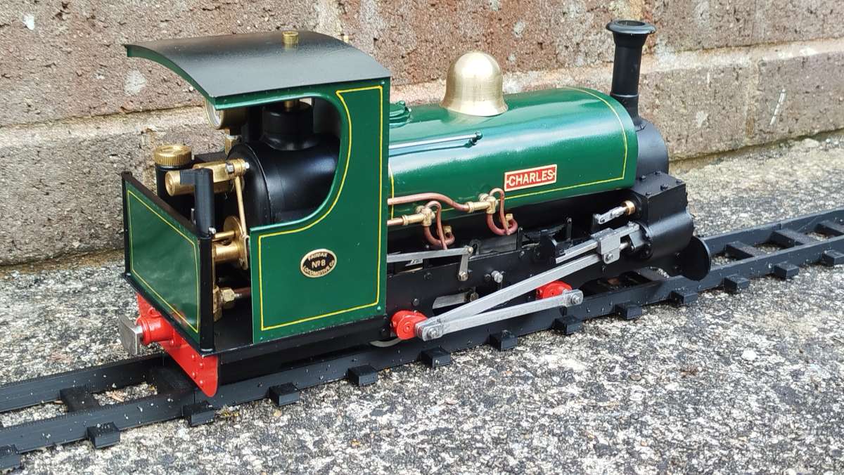

            Engine Builder
              @enginebuilder
              Paul, I have built this model. One thing I did was make the cylinder slghtly longer than drawn.
              If you check the stroke and piston length it is the same as the cylinder length meaning the piston will touch the
              covers.
              My model has inside Walshearts valve gear and RC .
