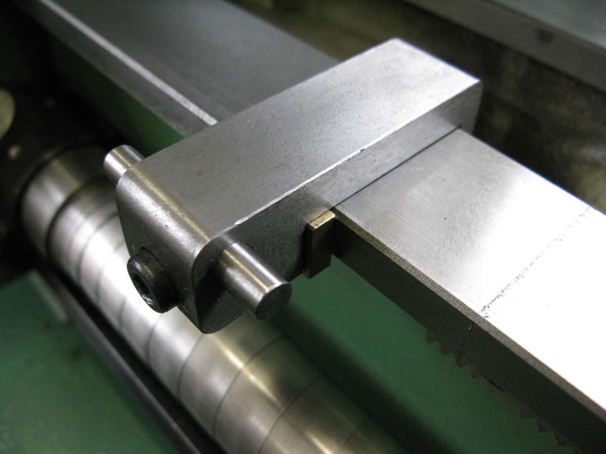

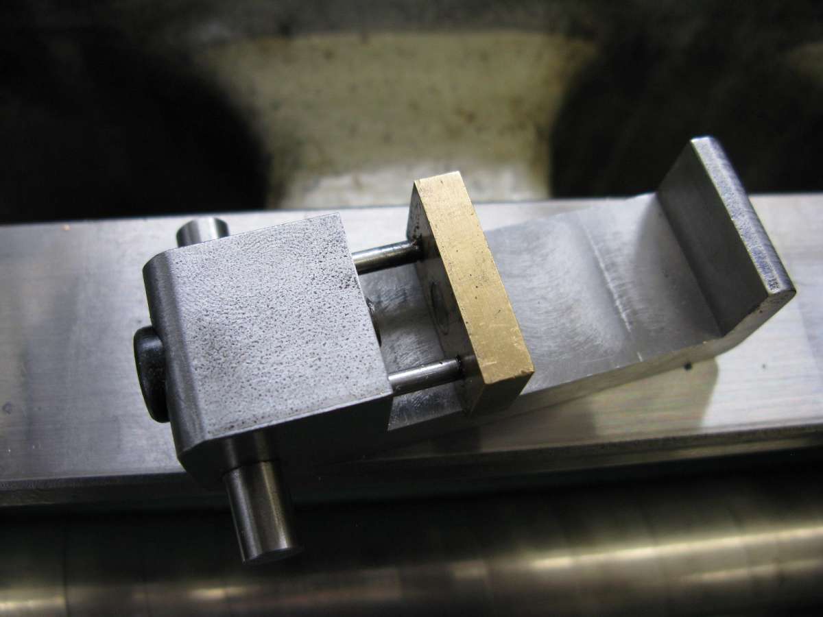

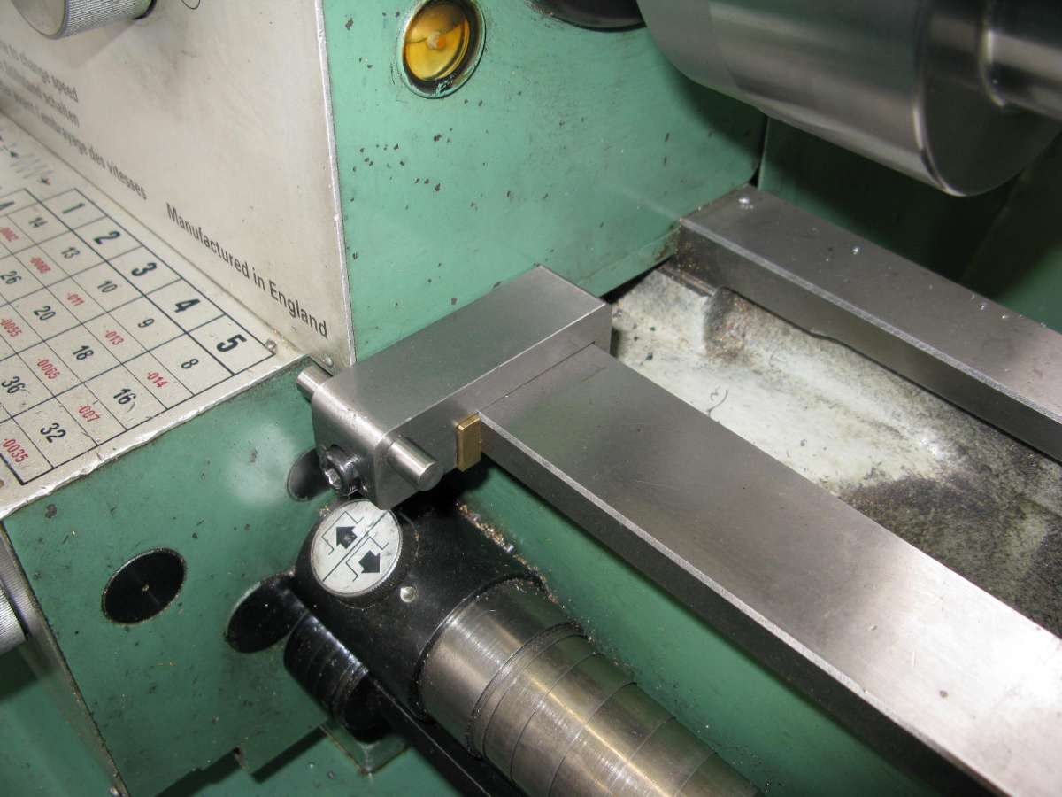

                        #861272
                        Dave Wootton
                          @davewootton
                          IMG_1076IMG_1079Hopefully pictures self explanatory, just milled from an offcut of BMS, with a little brass pressure pad retained by the two sliding pins, and a commercial cap head. If I were to make it again I would make the two silver steel stop pins sticking out of the side a bit longer as swarf does build up ahead of the saddle when removing serious amounts of metal and gets a bit jammed in front of the saddle before it contacts the stop pins, never actually caused a problem in use but a worthwhile mod. One of the pics shows how it stows out of the way against the headstock when not in use. hope this is of use. i could attempt a drawing but it would be in crayon not CAD!  IMG_1084
