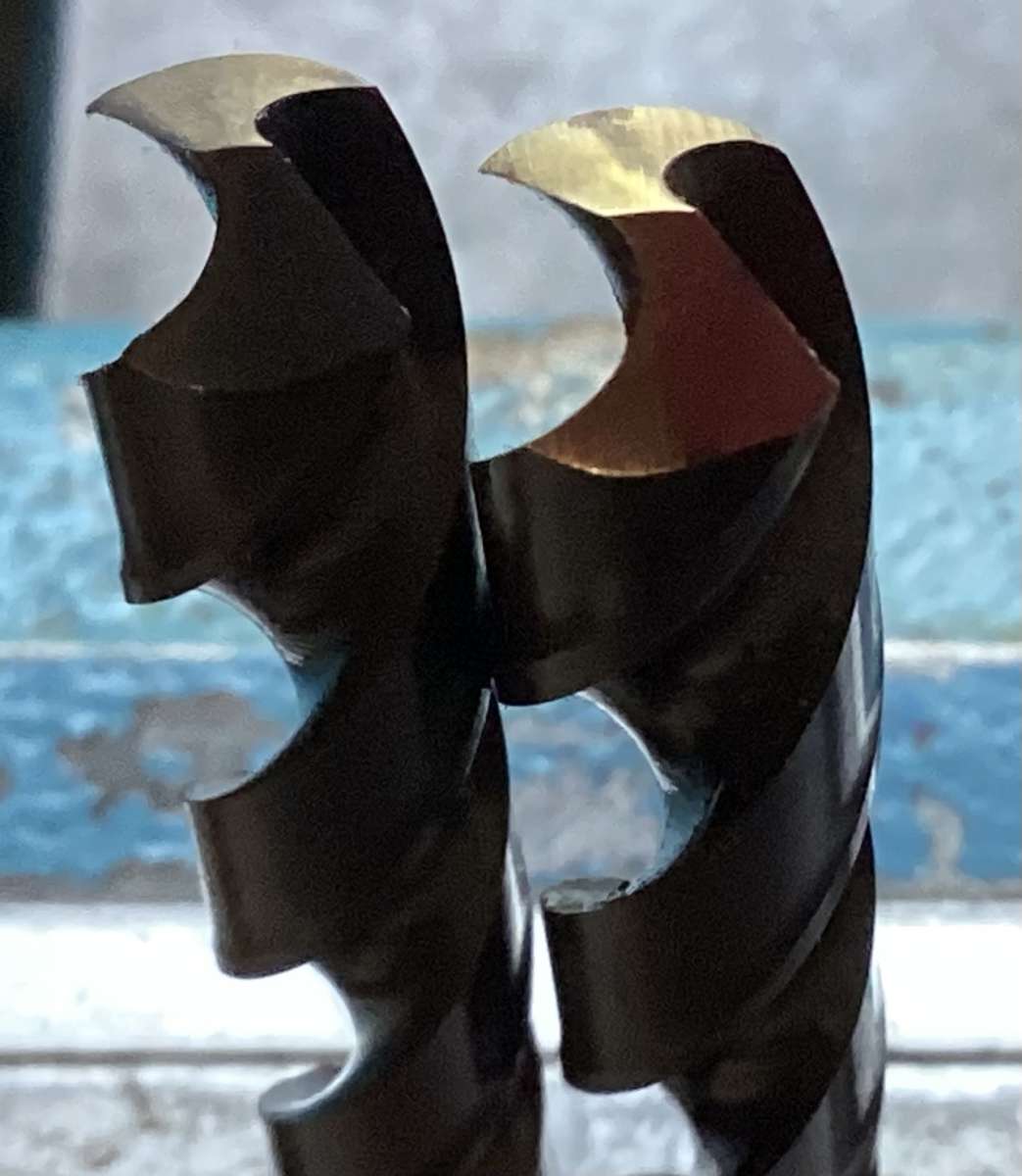

      I currently use a Picador drill sharpener with a 4” diamond wheel. It works very satisfactorily on drills up to 1/2” when all you want is a standard grind (i.e. no split point et al.)
      I’m considering getting a machine with greater capabilities and capacity, for example a DG20M, but I’m not totally sure what they’ll do and won’t do.
      Ideally I’d want the machine to be able to:
      1. put a standard grind on straight shank twist drills and spot drills from 60-135 degrees, and also on taper shank drills, up to 20mm.
      2. Create a split point and the associated back grind on the trailing edge;
      3. Thin the web where necessary.
      The DG20M appears to do everything but the last*. The only machine I’ve seen in fact that has a separate function for thinning the web is on Stefan Gotteswinter’s channel, where he shows this on a Motom BSM13 Duo. Even the much more pricy Darex V-391 doesn’t appear to have this web thinning capability, though I couldn’t say for sure at this stage.
      Sadly, I do not have room for a Clarkson or Brierley, which is why I’m exploring smaller options for now.
      *edit: its smallest angle is in fact 90 degrees.

                  Clive, I get your point about enclosed devices. I suppose what might redeem them is if they do permit viewing of the drill/wheel contact zone and have enough adjustability to give you at least some of the freedoms that come with typical fully-exposed grinding systems.
                  Interesting that you mention wheel availability in these enclosed types. What I think would disappoint me is if surface finish on the grind was always somewhat rough because of the wheel’s low grit count and a higher grit count wheel was not available as an optional extra.
                  I knew nothing of the Kaindl machines until you mentioned them. They certainly seem to fit the bill functionally speaking. I will look into them.
                  Edit: the photo shows the surface finish I get with my (notionally 400G) diamond wheel using the Picador. 9.5mm drill on the left is the factory grind: 10mm drill on right sharpened on the diamond wheel.
