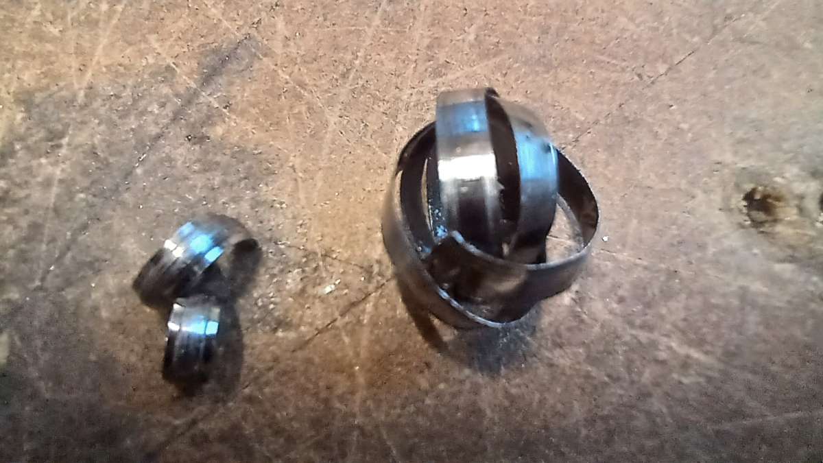

                      I also like the 2.2mm wide GTN-2 inserts, this is a bit of 30mm EN3 on an Amadeal 210E lathe, nicer swarf than Rods😉😉
                      20250702_104501
                      Same tool on the Warco 280 cutting a 1.5mm slice off a 70mm diameter iron casting

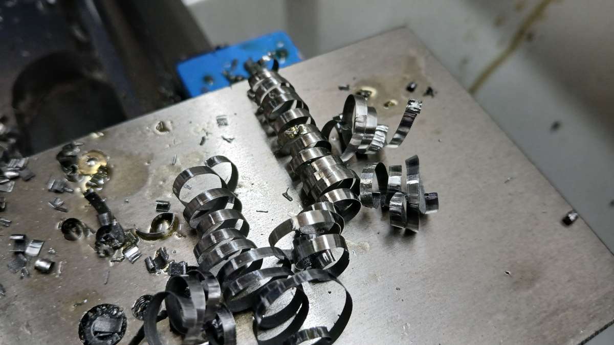

                        The swarf shown by JasonB looks a bit odd. I would have expected a parting off insert to form the swarf into a curved shape of narrower width than the insert. Thus reducing the risk of jamming. This is the steel swarf I get from my 3mm insert parting off blade:
                        Parting_Off_Swarf
                        Another factor rarely mentioned is feedrate. With parting off inserts I never go lower than 0.1mm per rev, otherwise the insert chatters. I always part off using power crossfeed.

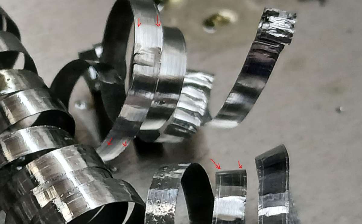

                            If I blow the image up I can see some fold lines where the edge has been turned in. Likely the finer feed I was using on the less powerful and less rigid machine combined with having to feed one handed and no power feed has an effect on how the swarf is shaped.
                            It curls more on the Warco with it’s power feed but that won’t take a 0.1mm feed unless the diameter is quite small but on that sort of diameter I’m more than likely to use a 1mm wide insert.

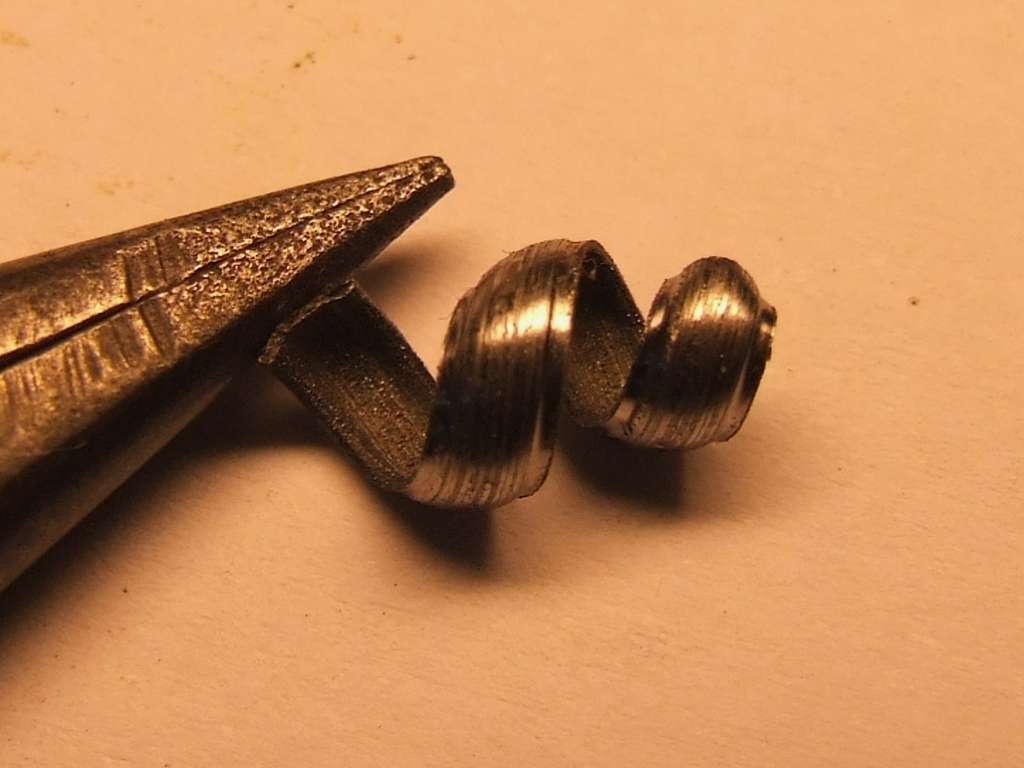

                              I just braved the hot workshop, hopefully this not very good photo will show th edufference feed rate can make.
                              1″ EN1A, 250rpm, GTN-1 Insert.
                              On the right was a fine power fee dof 0.00075″ on the left the feed was double at 0.0015″ which has not only been folded far more but also broke up into smaller pieces.
                              20260813_200924
                              I would expect a heavier lathe like Julie’s to fold the swarf even more
