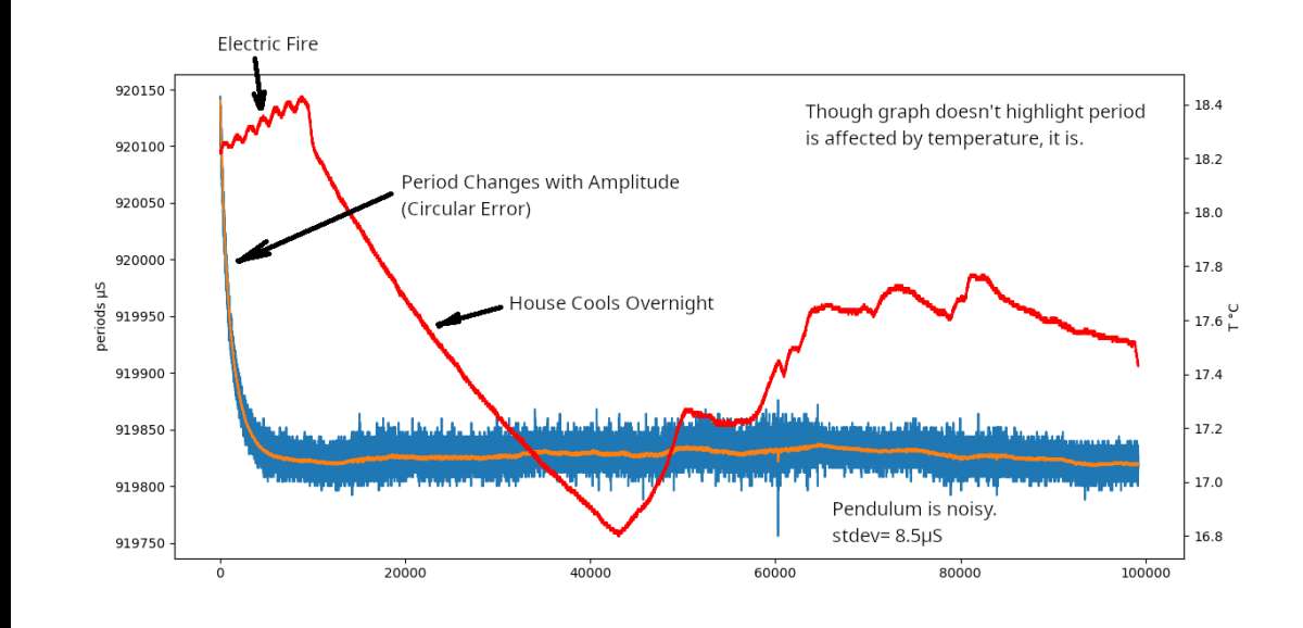

      As this graph shows, my pendulum is also noisy but for different reasons to the Livermore.
      The chart graphs the clock making a cold start.  The electromagnet pulls the bob on to the pole piece, and then releases it, causing a violent swing.  The microcontroller waits for amplitude to subside to a reasonable level before impulsing.   Takes about 80 minutes for the period and amplitude to settle.  Circular Error during startup is very evident: period changes as amplitude falls because pendula are not truly isochronous.  (Therefore a good clock should keep the bob swinging at constant amplitude.)
      clockgraph1
      The graph is misleading in that temperature doesn’t obviously affect period, a naughty fib.  It’s there if you look closely enough. Partially hidden because the microcontroller’s uncompensated crystal oscillator moves the other way from the clock’s uncompensated pendulum, so they cancel.  Two bads don’t make a good.
      The clock’s temperature sensor detects the electric fire I had on instead of the central heating.  The zigzag is the fire’s thermostat kicking in and out.
      The pendulum is noisy, standard deviation 8.5μS.  Slightly misleading because the microcontroller’s bog standard clock has a resolution no better than 4μS.  The Precision Event Timer code isn’t installed yet: it’s resolution is 64× higher.  Likely cause is mechanical defects in the pendulum and suspension, fixing which is work in progress.  The pendulum will be more sensitive to vibration after it’s been improved, and I’ll be very happy if it’s ever sufficiently sensitive to detect tides.   Like as not never will because my home vibrates so much that tides are buried by the racket.

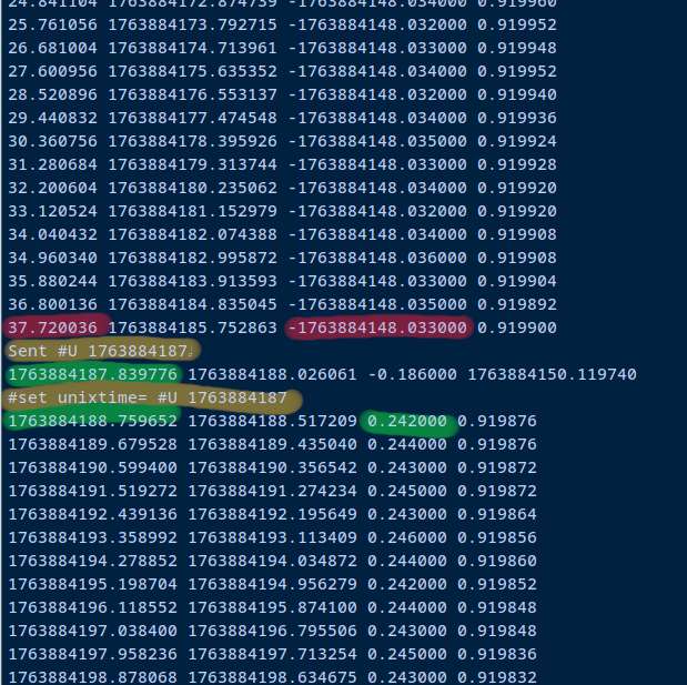

                In parallel with battling to improve the mechanical clock, I’m also fighting the software.  Three tricky problems:
                1. Making sure the bob is never impulsed on the backswing by ensuring the electronics stay in phase with the pendulum. Fixed, fingers crossed.
                2. Fixing the code that finds the impulse power needed to achieve a given amplitude.  Problem was the algorithm sometimes overshot and hunted unsuccessfully forever.  Reason, inertia: the bob takes time to respond to impulse changes.  Fixed with an algorithm that homes in more slowly as the bob approaches the target amplitude.
                3. Setting the clock accurately to UTC given that pendulum ticks cannot be synchronised with UTC ticks.  The pendulum is always part way through a swing when the clock is set.
                Setting to UTC is done numerically by noting the time in microseconds when the set UTC command is received, and applying a correction relative to UTC on the next pendulum tick.   It nearly works:
                Screenshot From 2025-11-23 08-08-41
                This is another form of measurement.   A Python program reads the clock’s output and, after allowing the bob to settle, orders the clock to set UTC.  The clock is sent a UNIX timestamp, which uses it to set the clock’s counter seconds part, and zeros the microsecond count after noting the last value.  Then, on the next tick, the microcontroller applies the maths needed to align the clock to UTC.
                In the example above, the clock started by being wrong by 17billion seconds compared with UTC, which reduced to 0.245s after the clock was set.  0.245s is still a massive error, but the error is constant.  The maths is wrong rather than the logic, and it’s the logic I was struggling with.
                The clock can be set by sending it UTC from the PC, or by telling the microcontroller to get UTC from a GPS Module.  GPS is much more accurate than the PC.

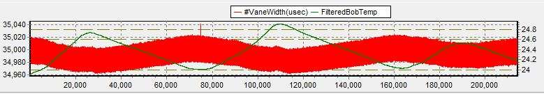

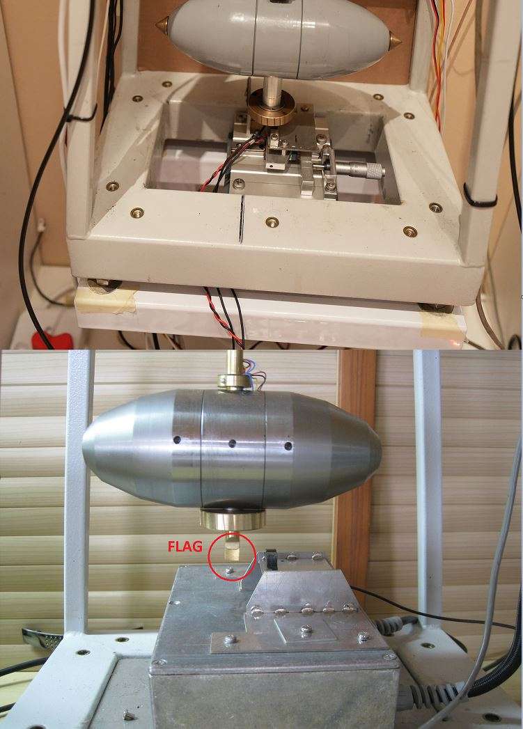

                  Can you show a chart of Flag vs the temp curve in you chart above?
                  #826013
                  Joseph Noci 1
                    @josephnoci1
                    Can you show a chart of Flag vs the temp curve in your chart above?

                      Hi Joe.  What’s Flag?
                      #826110
                      Joseph Noci 1
                        @josephnoci1
                        The interrupter that passes between the pillars of the photogate – with a measurement in us of the interrupt time ( ‘velocity’)
                        Flag
                        #826127
                          Of course it is!  I call it the vane.

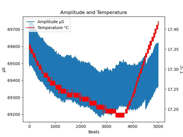

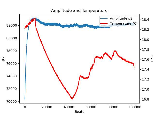

                            Dave, I would hazard to say that graph shows some issues..
                            You have around a 250us variation for a 0.15degC Temp delta – that is rather large, like in huge…
                            My pendulum currently gives around 20us change 1degC delta – and the objective is to get amplitude a stable as possible.
                            Your top graph shows a 1.4degC variation – The flag measurements would change by more than 2ms… Thats massive!
                            Are you sure this chart is correct?
                            I also find it odd that Velocity increases with falling temp – I have to think about that one.
                            VW vs T
                            #826146
                              Whoops, wrong log file.   Highly misleading – it’s from a very different test run.  This looks right.

                                  Also, why the big delta in amplitude between the two graphs? ( 69000us vs ~83000us)? Different Flag size, or much lower amplitude?

                                      The microcontroller has 5 different strategies that the operator can apply to manage amplitude, or not. Don’t take the graphs too seriously because the build is incomplete, I’m still wrinkling out mechanical and software issues, and the test runs aren’t consistent.   The trials meet development needs, and aren’t representative.
                                      The two test runs used different strategies.  In the first test the clock ran with a fixed impulse, set experimentally for reliable running.  In the second, the clock was set to run at a lower amplitude to reduce circular error, but is more prone to stop.  Stoppages are due to known mechanical and adjustment faults, for which reason the pendulum is being rebuilt.
                                      Too early to say but it appears the best strategy is to maintain amplitude within a range.  Below about 4° the range can be quite big without before circular error intrudes.  But the Precision Event Timers aren’t installed yet and the clock is otherwise unready for a controlled experiment.  Debugging and development have priority.

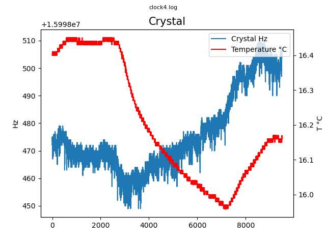

                                                    I’ve implemented the clock’s two built-in Precision Event Timers.  They and GPS are only used to establish the temperature and pressure compensation coefficients when the clock is in learning mode.  They, and the microcontroller’s quartz crystal are not used when the clock is time-keeping.
                                                    1. PET1 counts the number of pulses the Arduino’s crystal oscillator outputs per GPS second, which reveals it oscillates near 15998503Hz rather than nominal 16000000Hz,  Not a surprise, CPU oscillators don’t normally need to be accurate so the crystals are just bunged on the board, no finesse.
                                                    2. PET2 counts the number of CPU crystal pulses per pendulum beat, and this needs to be accurate.  So the crystal’s actual frequency is determined by GPS, which also covers frequency drift due to temperature change.
                                                    To test the PETs are working, I measured and graphed crystal frequency vs temperature and got an odd result!
                                                    Mk2_Clocktempweird
                                                    With a bit of imagination the graph shows a loose correlation between temperature and frequency, but that frequency changes before temperature.  Appears the clock is controlling the weather, which can’t be right!   Noticed this delayed correlation before and put it down to coincidence.  Not so!
                                                    The Mk1 and Mk2 clocks are different.  Mk1 had the microcontroller and sensor exposed to open air, i.e at the same temperature.   The Mk2 clock encloses the sensor inside the vacuum chamber and locates the microcontroller  inside the cast-iron base.  They are at slightly different temperatures and out-of phase.  Both matter:
                                                    • The sensor lags behind changing room temperature because it’s insulated inside the PVC tube
                                                    • The microcontroller is warmed above room temperature because it’s in a cosy cavity inside the base.
                                                    So I need two sensors: one to measure the temperature of the pendulum so it can be compensated when time-keeping, and a second to measure the temperature of the crystal oscillator so it can be compensated whilst learning.  I guess the difference is a degree or two.
                                                    Second problem:  I’d “fixed” an earlier issue whereby the pendulum occasionally got out of phase with impulses apparently because the photo-interrupter was triggering incorrectly on the backswing.  Should have looked closer!  PET2 showed the same fault, due to a code omission.  To ensure clean signals the photo-interrupter needs a pull-up resistor.  Could be part of the electronics inside the vacuum chamber, but I intended to implement it inside the microcontroller by setting the microcontroller’s pendulum detect pin as INPUT_PULLUP.  Except I left the line out, leading to slightly erratic triggering, reducing the accuracy and reliability of the period and amplitude measurements.
                                                    Fingers crossed the photo interrupter works properly now, but it means the code I painfully wrote last week to fix the backswing problem is an unnecessary complication.  Removing it is more work!  Three steps forward and two back.
