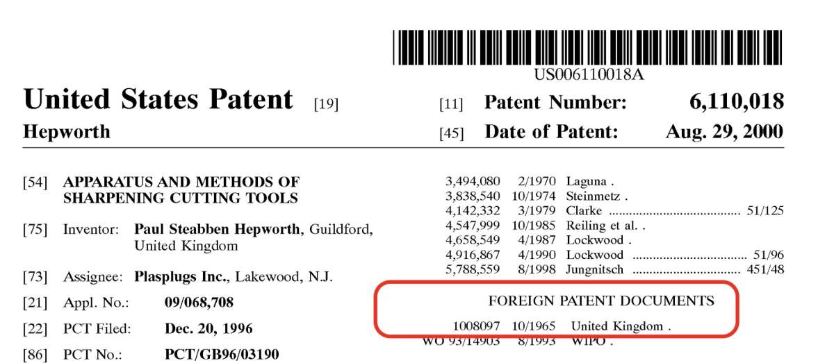

                                                [ Rabbit Hole ]
                                                The referenced Foreign patent is VERY interesting !
                                                IMG_1919
